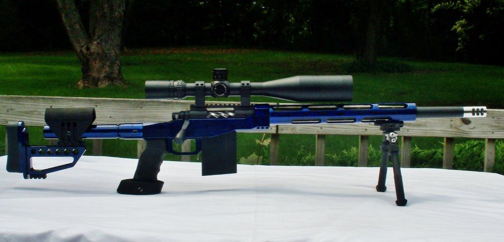

Heres my newest edition to the family...
-Phoenix Machine/Defiance Long Action
-Bolt and knob fluted/coated by Kampfeld Customs
-Rock Creek 5R 1/9.4 barrel finished at 24.5" with SSG V Port Brake
-Jewel Trigger (1 lb)
-Nightforce 20 MoA base
-AD Recon mount
-Nightforce NXS 8-32x56 (NPR-1)
--Chambering work all done by Phoenix Custom Rifles
Mate! That mount is exactly what I am after!!
Which of the Recon models is it?

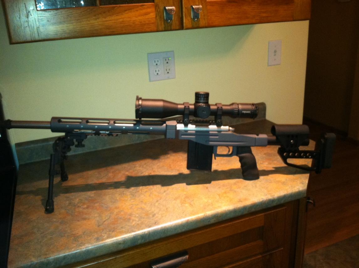

Figured It was time to post up a pic of my setup. Got this put together back in April, nothing fancy, just a basic setup. IOR scope, Harris bipod, ken farrell steel base, and a Savage 10fcp-k barreled action. After a little load development, she shoots pretty well. Third shot was all me, but still not too shabby for an all stock gun + a chassis. Groups is about .750" with the flyer @ 200 yards.
What brand and height rings are you using?
