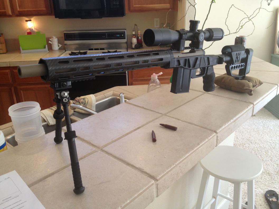

Has anyone noticed if their hand guard slightly off center? My barrel seems to sit a little low and left, but not sure if it's a chassis issue, or an action not being completely true. When I say a little, I mean about 1mm low and 1mm left, not enough to bother me that much, but enough to tell that it's not completely lined up.
I actually let it set since the morning and Im not sure if just settled in or what but it sure looks pretty damn centered now. Maybe I just needed some caffeine to see correctly.

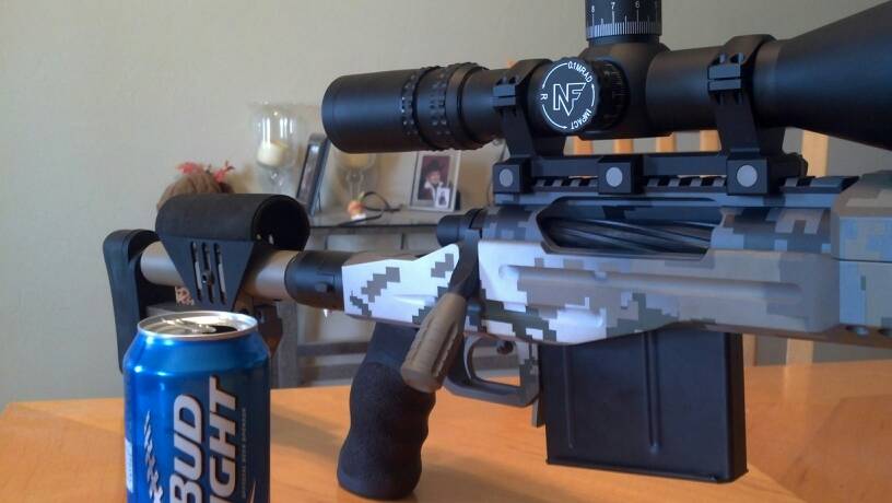

Heres the finished product. It came out very well and seems to be very very solid. Hopefully I can get some ammo together for it thia weekend.
Savage 12lrp in 6.5 cm , xlr tactical, ken farrell 20moa steel base, nightforce med-high rings.

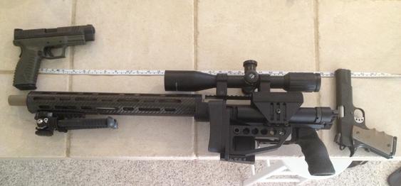

Untitled.jpgMy XLR Carbon on a Savage S/A .308 with a new 18 inch barrel... I love it! And it is only 28 inches foldedphoto.jpgphoto 4.jpg

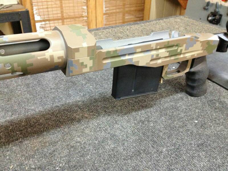

Phoenix Custom Rifles is doing a complete build for me on my XLR chassis and Keith has gone crazy on the cerakote job! Here's a little teaser, full build pics coming tomorrow:

Picked my rifle up from Phoenix Custom Rifles today. Keith REALLY outdid himself. Pics just don't do this thing justice, but I'll try...
TAC338 action, bartlein 338 9.5 twist at 29", chambered in 338lm, APA Fat Bastard brake, LRA bipod, Jewell trigger, my own bolt knob, nightforce ATACR:

Beautiful rifle! Keith is awesome. He had sent me a pic of your build while we were discussing camo colors. You certainly picked a winner. Congrats!

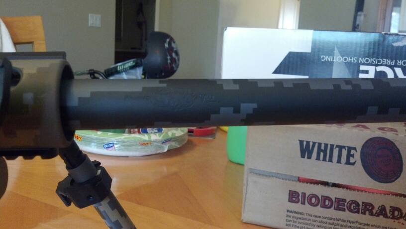

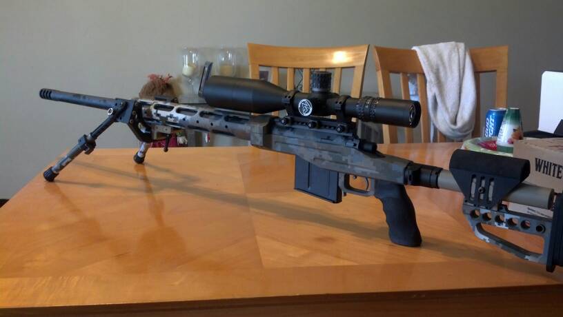

While I'm waiting for my higher rings to come in, I decided to pull it all apart and paint it. I'll post pics when it's done. Can't wait to shoot it.

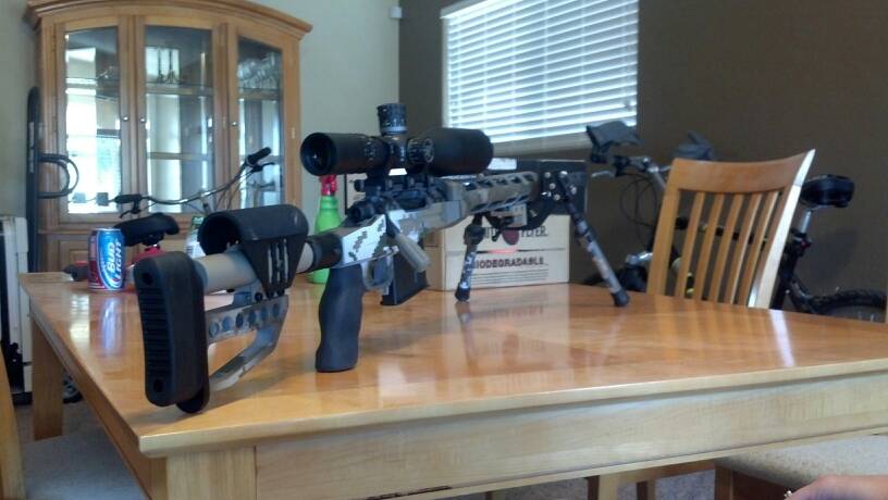

I got my XLR Carbon Chassis painted and installed on my R700 SPS .308 and I love it! Fits like a glove, the machine work is incredible, and I see no problems with it. I did need to switch out to high TPS rings and using a 20 MOA base, there's less than 1/8" of space between the scope bell and the hand guard. I'm hoping the scope caps Im getting will work, if not, I'll modify them to work since I like a low scope. Also I think I might add a folding stock mechanism just for cleaning. My cleaning rod goes under the cheek riser, but I have my butt plate raised real high and the rod will scrape it where it is. The rifle fits me the best with the butt plate high. I've also canted the whole stock about 5 degrees and it feels the most comfy there. I love the almost infinite adjustability of this chassis. I can't wait to shoot it!
Thanks again Kyle!
Edit with a new pic of the folder
