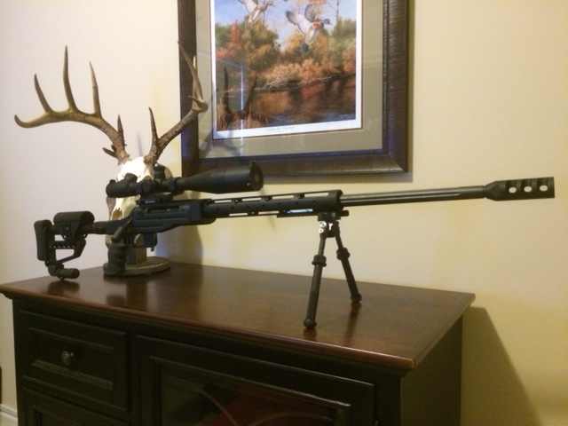

A while back (okay, maybe a *long* while back) someone asked about pics of rigs with long (30" or more) barrels and it didn't seem like there was a whole lot of response. Figured I'd throw a couple out there for anyone interested.
Savage 12 F/TR w/ 30" Kreiger heavy Palma contour 1-12"barrel, 2013 USFTR chamber, XLR Carbon chassis with the Heavy Duty/ bag-rider butt stock, sitting on a Center Shot carbon fiber bipod and Edgewood rear bag, wearing a Nightforce 15-55x Competition (2013) scope in extra high NF rings. Also swapped out the Ergo fat-grip for a Sierra Precision grip.
How long is that handguard and what does the set up weigh?

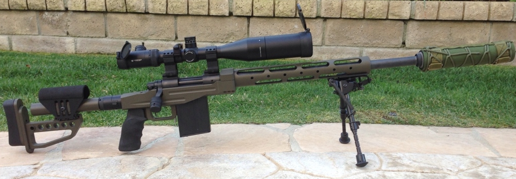

Here's my carbon. It's cerakoted in graphite black and sniper grey. The handguard was coated in cerakote air dry clear. I also added some relief to the magwell with some hand files and sanding before coating. I don't have the barrelled action yet, but it will be sniper grey. (Defiance deviant, bartlein 22" M24 contour, 6.5 creedmoor. Just waiting for my turn with Marc from Spartan Rifles) I've got a set of ARC M10 rings and an ATACR ready to top it off.
http://i.imgur.com/ZUzePEl.jpeg
http://i.imgur.com/KpR6bDe.jpeg
http://i.imgur.com/t7x09Oq.jpeg
http://i.imgur.com/FowDrav.jpeg
http://i.imgur.com/1nUCTD1.jpeg
Some things I learned along the way... If you're ordering one of these and plan to get it cerakoted, ask Kyle to

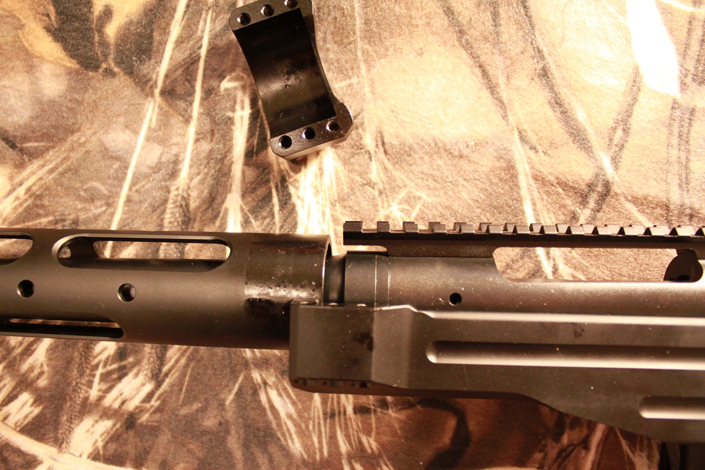

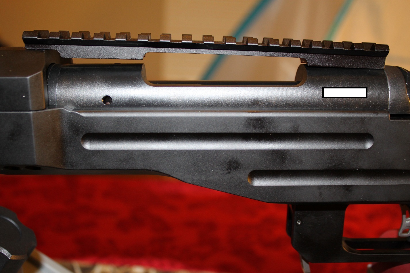

I have Savage 10T, and I found the EGW rail that comes with the rifle extends 1 inch too long into the barrel. That causes trouble to install the handguard...
Question - I can cut the EGW a bit to fit, but does anyone know if there are any scope base (pictinay) would be short enough to fit Savage 10 (short action) and XLR without having to be cut?
Thanks for the help.
Kyle will do it for free. I simply trimmed mine with a Dremel.
