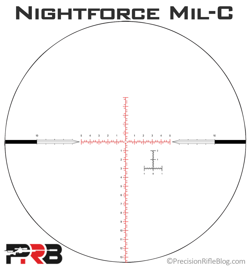

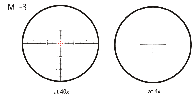

I am quite happy with the reticle in my March Genesis:
Very uncluttered, and in the unlikely event that I need to holdover (it would only be at crazy stupid 2.5+ mile ranges), it is well suited. Additionally, the center of the reticle is wide open, making dialing for ELR/ULR targeting a lot easier. Holding for wind is really only for target-width adjustments. At .05 mil on the turrets, I dial anything where I have to move off the target as the reticle has no markings close to the center. It is precisely that openness, however, that makes this reticle VERY easy on the eye at extreme range.
If I had to have only one ELR/ULR reticle to cover a wide variety of ranges, it would be the NF Mil-C:
I'm considering getting an ATACR for my 300 and putting my Steiner on my upcoming short action build.
