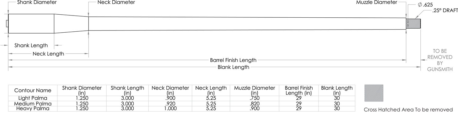

@bohem
When I spoke with Ben, he said that as long as you have the drawings, you guys could do the custom contour.
However I'm not 100 percent clear on what constitutes a drawing that is good enough to go off of.
Here is an example of a barrel profile that may work for some of us that are wanting something lighter, but without the worry of having 5/8 threads and enough shoulder. Would this be possible and does this constitute an acceptable drawing?
Reactions: wind gypsy
@bohem
Yeah, that's something I can work to. The question becomes what do we call it?

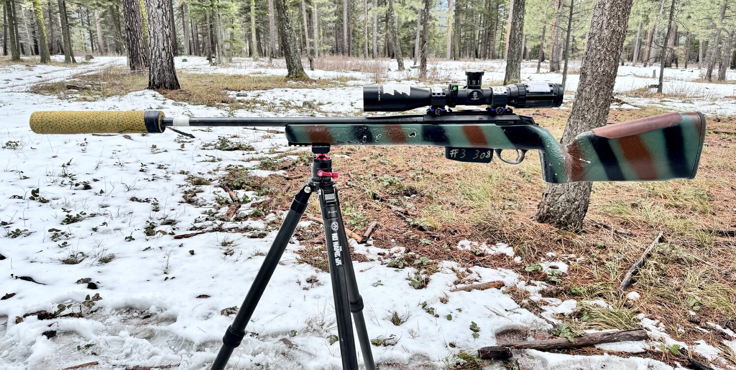

It's the Taperless 750 from Preferred Barrel Blanks. My weight goal for an 18" 6 CM barrel is 40 oz.
One particular example on Rokslide using this countour from PBB is the following:
.750 taperless, 24in, 6.5mm bore. straight flutes and chambered
43.25oz
That's pretty easy to call it. Sounds like we should just make a couple of taperless options in different size muzzles for the hunting community.

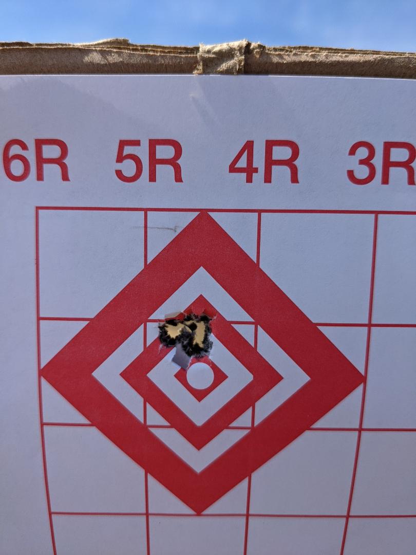

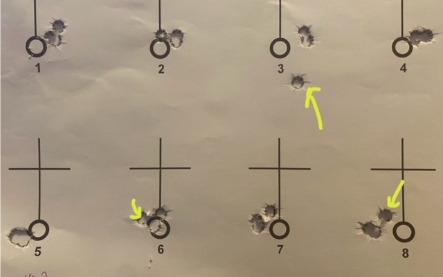

I did the break in process one rainy day last week on steel (or near it anyway lol).
Today were my first rounds on paper. 100yds. I fired four mismatched orphan left over mystery rounds to foul the barrel and zero it. Then shot these two 3 shot strings. (6.5cm)
Virgin brass, two different bullets I've never used before. A guessed at OAL for both and a rough "ladder" of loads.
I was having an awful day on the trigger. I made the mistake of shooting something else with it, with a completely different feel and heavier trigger. So I had lots of "oops" shots. I marked some of those, there were more of them but I couldn't remember for sure which they were.
I thought to myself... "Uh yeah, okay. If it never shoots any better than this, it's still a good deal better than what it replaced."
Reactions: lash

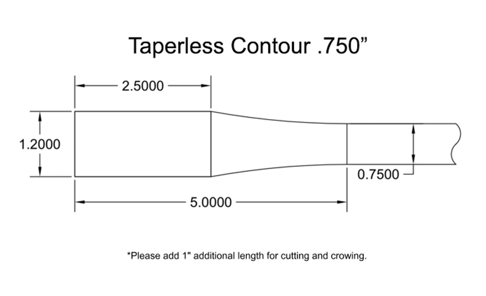

So I added the 0.680 and 0.750 Taperless options on the website. They're both 1.2 for 2.5" and a 2" taper down to the taperless size.
Most of the #(x) Brux and Bartleins have a 3.25 or 3.5" long taper from shank to the barrel acreage.
