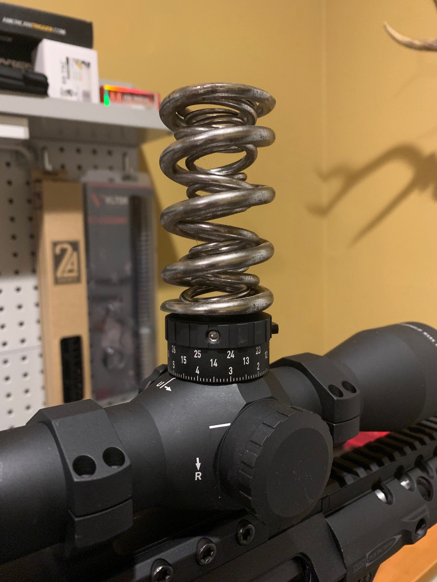

This has already been said, but there are huge numbers of cars and trucks on the road that use leaf springs. This includes heavy duty tractor-trailers that see literally millions of miles without failure. Leaf springs are MADE to bend over and over again, it’s EXACTLY what they were designed to do. Can they fail? Sure, just like a coil spring or an airbag can fail. When they do, it’s either due to a worn out/defective part or misuse/abuse. If this was a problem, something else would be used for the application in the first place. It is NOT a problem.
Reactions: lash and Tokay444
6mmPRC seriously thank you!
l needed a good laugh. @Tokay444 :ROFLMAO:
I think I have your solution, but it's going to take some serious effort to get it installed.
That is a valve spring. You have a bunch of them in your car. At highway speeds each spring is opening/closing (about 10mm) 20 times per second at 2400 rpm. That's 1200 cycles per minute & 72,000 per hour. Each compression generates heat & there being cooled by oil that's 230 degrees F.
Once you've put 150,000 miles on your car the spring will be a little tired. They will have 166,104,000 cycles on them.
So yeah the premise of the OP question is udderly ridiculous:ROFLMAO:
Lets say you have a scope with 3m elevation adjustment at 100m. This gives you an angle of about 1.7° from top to bottom.
I don't know how long the typical erector system is but lets just say 200mm. In that case the erector would be moved about 6mm in height, from top to bottom. (Edit: That is a very simple calculation leaving out many factors, so nothing more than an a approximation. For a 150mm erector it would be 4,5mm of total travel)
But isent it misuse/abuse dialing the turret back and forth fast many times in a row? I dont think the erector spring was made to handle that? It was made to handle being dialed, but not back and forth, back and forth alot of times in a row.
This is not abuse for the erector spring. It just like pressing a few buttons simultaneously on your keyboard a few times in a row.
Here’s the simple way to explain what everyone is telling you:
You can’t have the opinion “I think it will do this” and also have no idea of any of the science behind it.
Well, you can, but that is not the logical or intelligent way to go about it. Your theories are incorrect. Move on.
