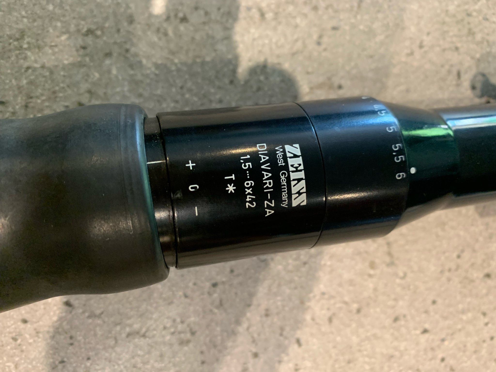

I have a Mauser SP66 with a Zeiss Diavari-ZA 1.5 -- 6x42 T* scope. It shoots about 12" high at 100 yards and I do not know how to set the elevation.
Here's the gun
Here's the scope

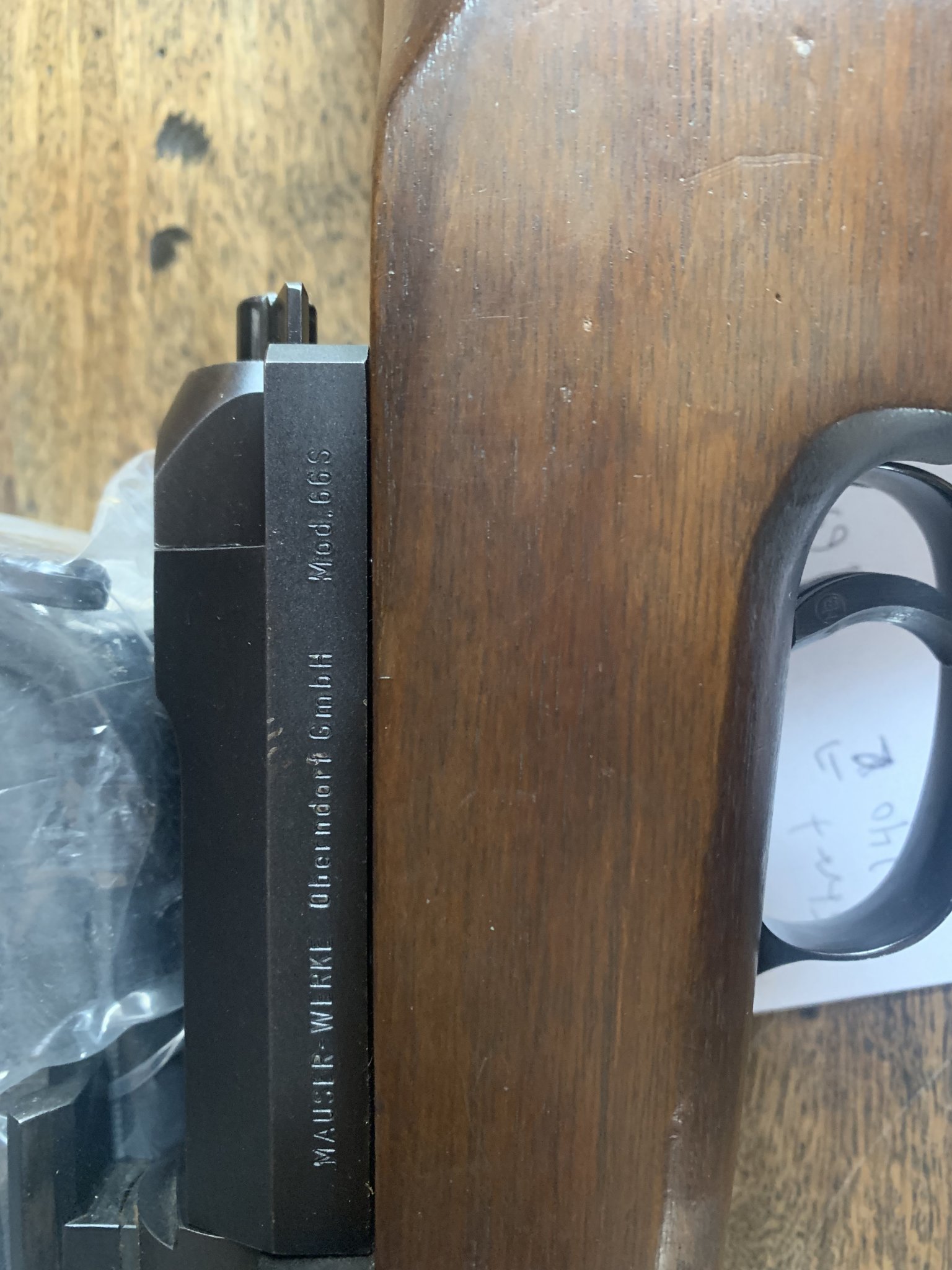

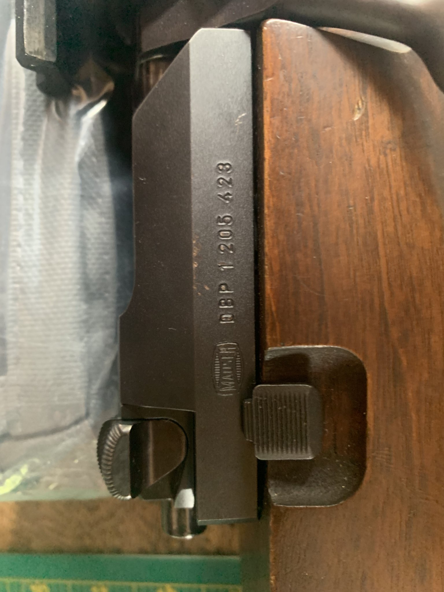

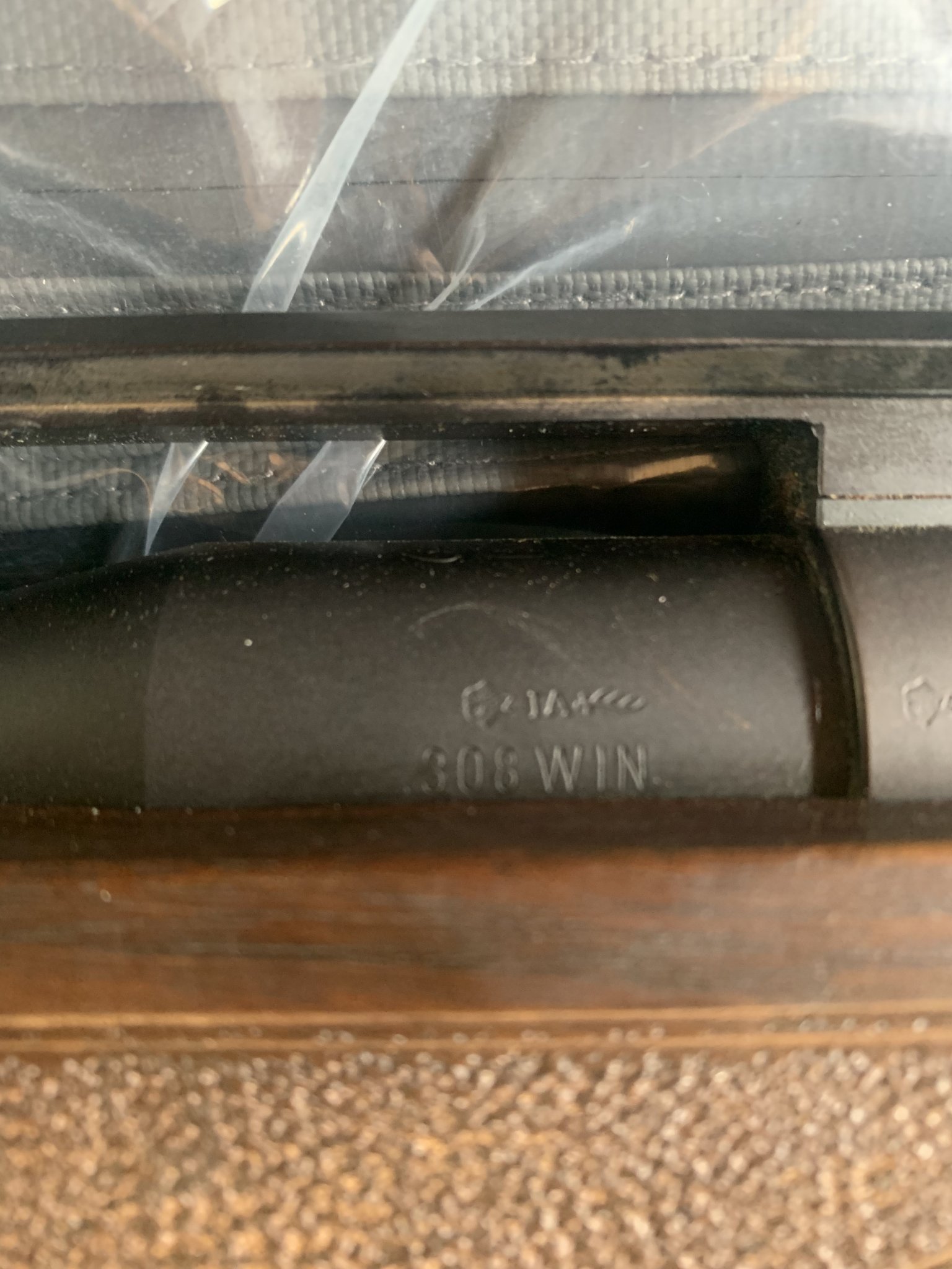

Here's the caliber stamped in 308 Win and the proofmarks. I would have thought these rifles would have been 7.62 instead of 308 given German make and military ties, so that's a little surprise. I don't know anything about proofmarks.
Here's Mauser's factory stamp on the receiver left side.
Here's another Mauser mark on the right side. There's a number there that's not a serial number.

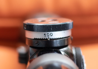

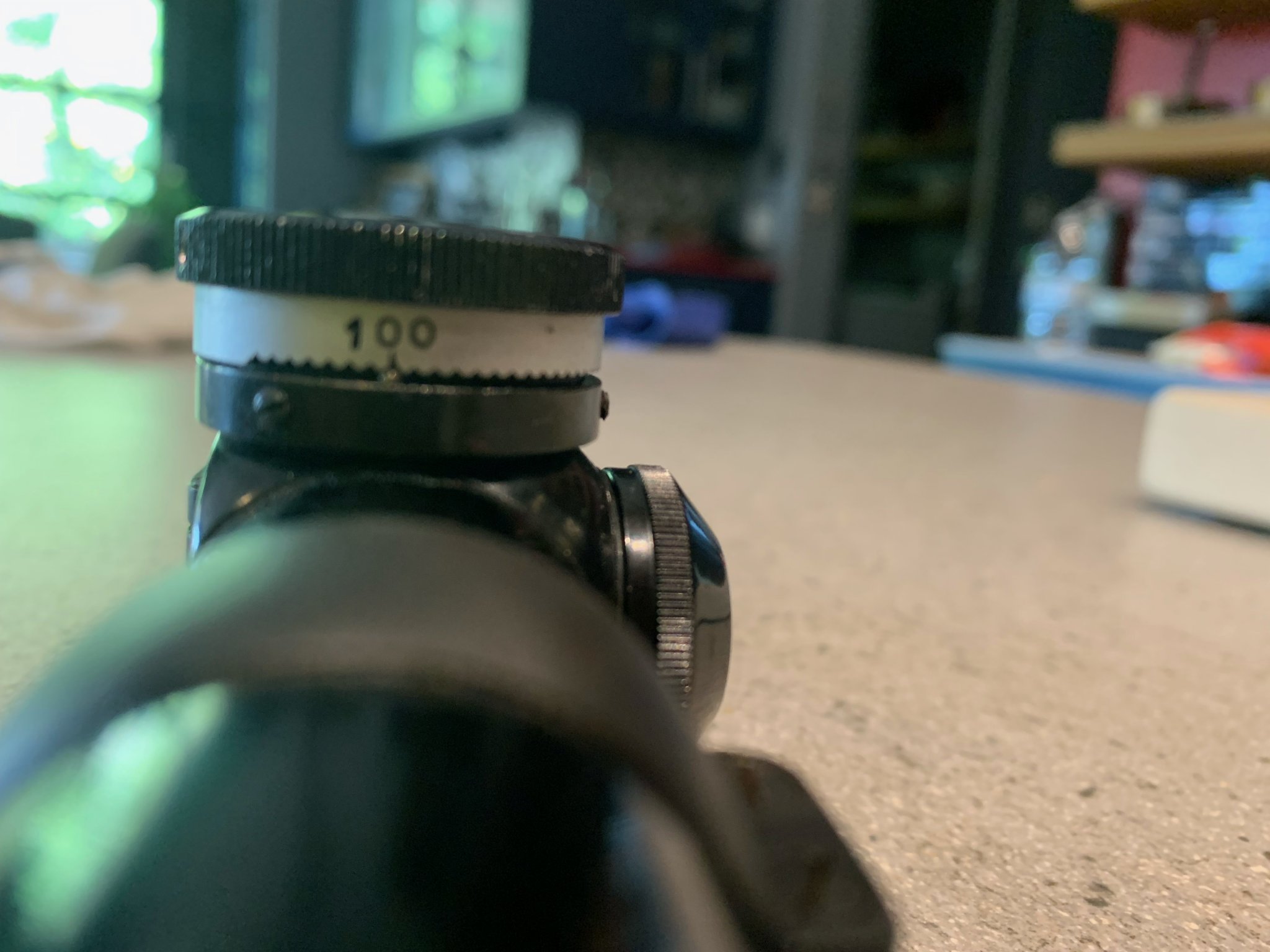

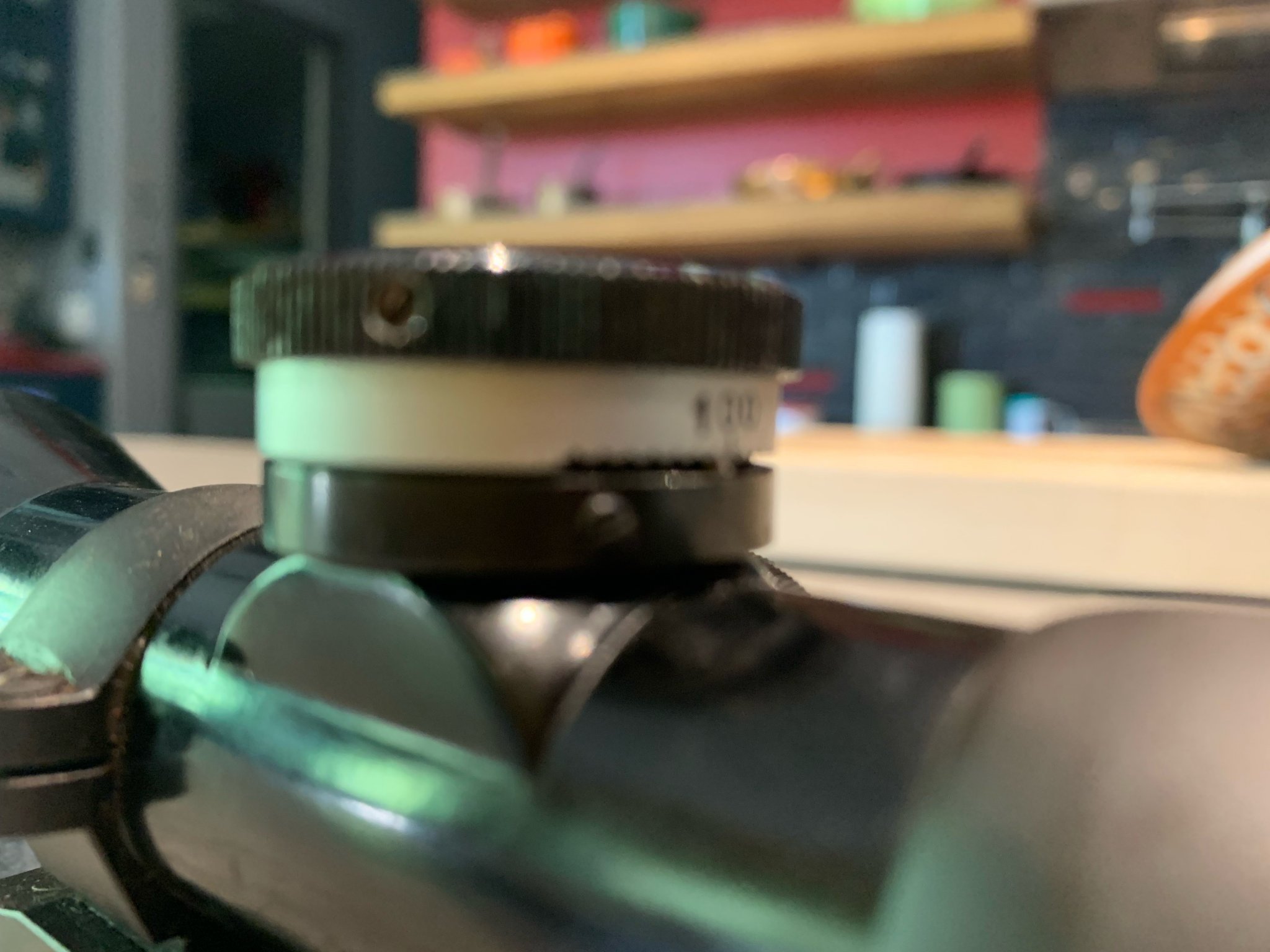

Contacting Zeiss is a god idea. Here are some better close up photos.
From the front you can see the elevation turret is made of three layers. Once you zero the rifle the 100m mark will most likely not be centered, so there must be a way to rotate the turret to line up the 100m mark. The elevation turret does have only 45 clicks of adjustment. There's a mechanical hard stop when the end of the silver center serrations (visible to the left of the 100m mark) contacts a bump located in the bottom layer (not visible). Interestingly you can see a small ball bearing at the 100m mark. The ball bearing sits in a small notch and advances the turret in equal distances as you turn it and the bearing passes each serration on top.
To adjust the turret you most likely need to loosen the small screws visible on the top and bottom turret layers, as well as the screws recessed in the turret top.
Here's a top view where the two screws are visible. I was easily able to unscrew these, which loosened the top two layers. I'm holding off on attempting to loosen the ring screws in case there's a specific order of operations.
Here's the windage turret. Pretty standard stuff. This says 1 click = 1cm @ 100m. If the top turret also moves 1cm/click I should get 45cm of elevation travel -- about 18" -- but I'm getting about 3". Either it's bound up or broken.
