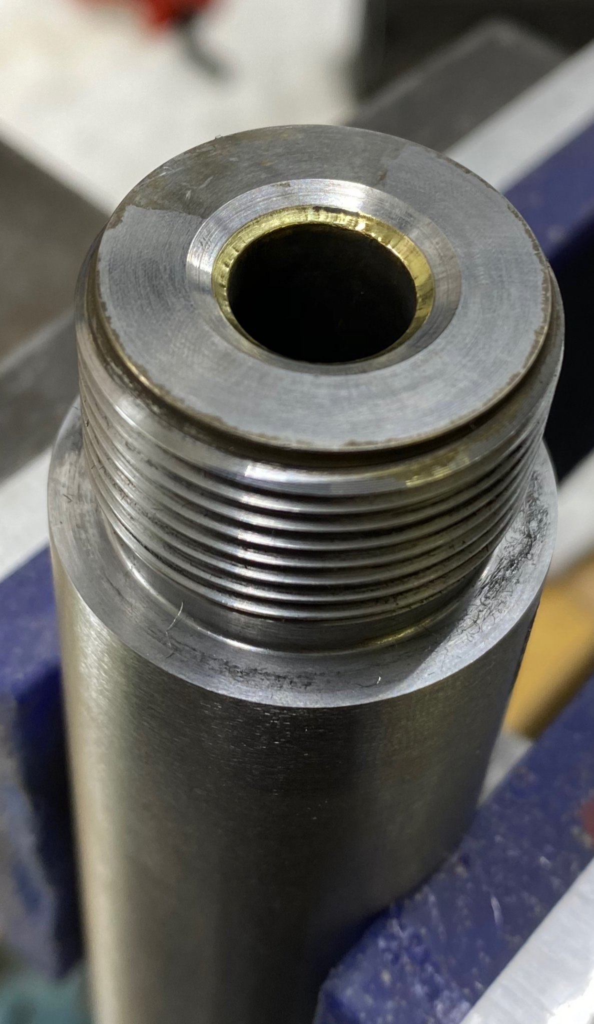

Yes. Sent the barrel back and they said everything was in spec. They set the barrel back an inch and rechambered it free of charge.
Alpha 6GT non OCD.
Pva barrel with non ocd dasher
Terminous prefit
Way more chamfer than terminous spec call for

Just skimming through this thread looking at pics- and my first thought was "wonder if they had some parts that didn't get treated correctly." Then noticed the powder mix up-- I was guessing that would have put it over 100,000psi but never would have thought it would be that high. That's impressive it only looks that bad.
Now for the question..... I would think the action would be compromised after that even if it held together. For example when they use to do proof loads.... yes the action survived- but couldn't the higher pressure of the proof load create a problem that wasn't there before and now just waiting to happen?
reubenski- props for owning it. Lots of people would have sent that back with a "don't know what the hell happened." It's cool that they want to check it out and see what they can do-- but expecting them to fix it would have been wrong.
