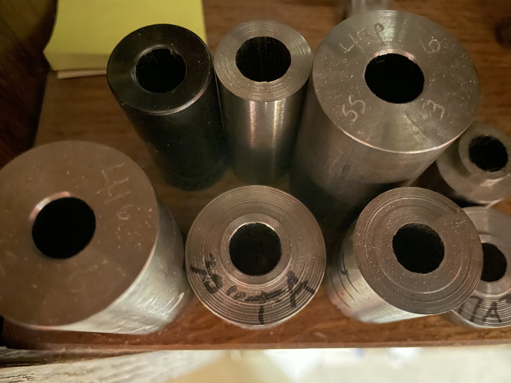

Would you be able to explain this? Keep, machine and engrave barrel slug for bullet sizing - $45

I believe its a chunk of the excess barrel from when it gets cut to length. Then you can send it in to swing lock to get a full form bullet sizing die made from it. This shapes the bullets to your rifling when you size them.
Somebody can correct me if I have this wrong. Kind of came up with this conclusion on my own research.
The 1” piece of barrel needed to make a SwingLock bullet sizing die is called a barrel drop.

The drop is slightly longer for the swinglock, and it needs to be machined perpendicular and each end deburred like a crown. It also needs to be traveled with the barrel, it cannot be mixed up with anything we need to ID it and track it.
Hence the cost addition.
