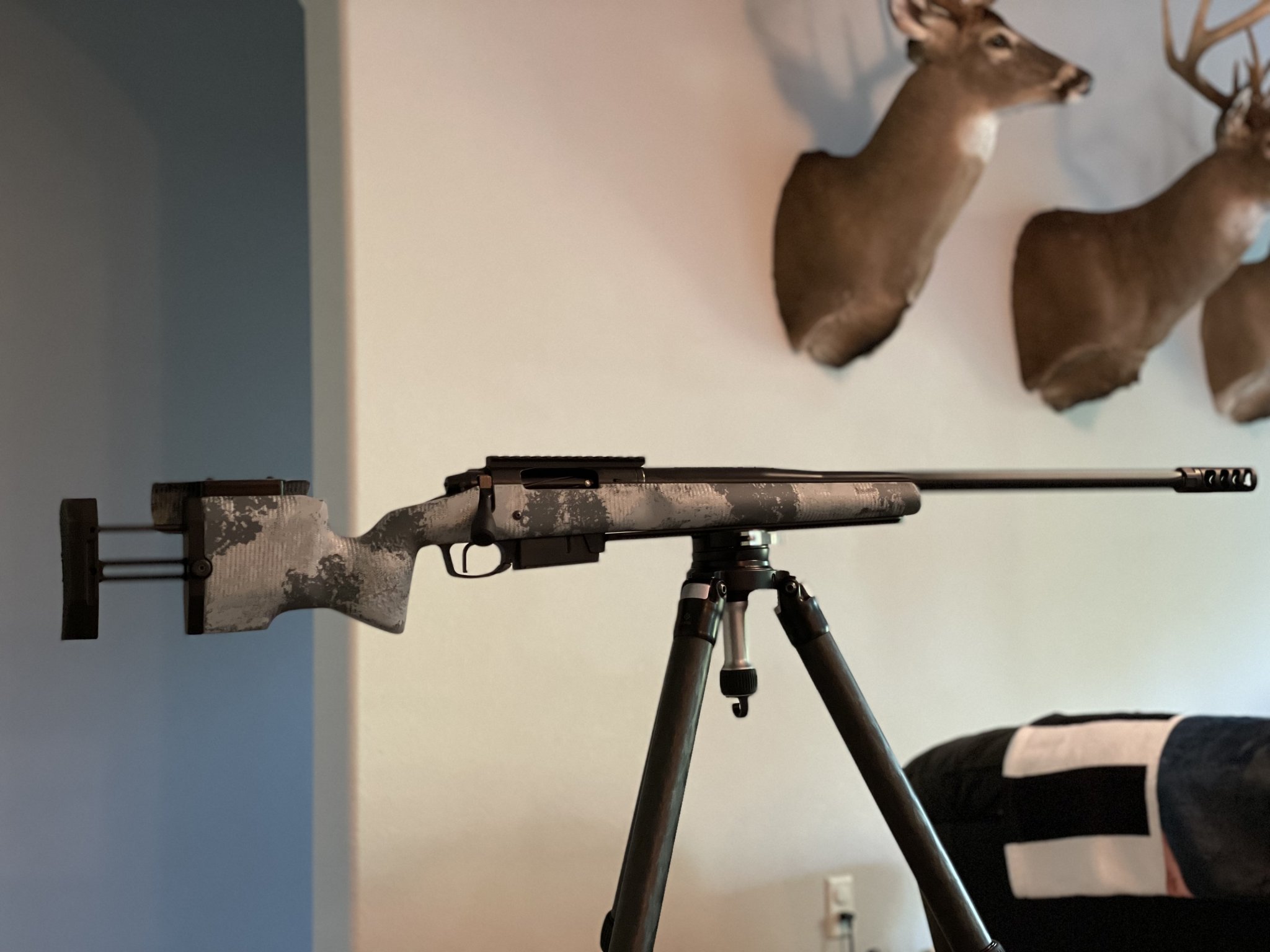

took mine to the range today.
I started with some 300 XLD’s from Luke at ASG, per his recommendation. I also picked up his 3 piece rod and load through funnel for the shockwave. I already had a smooth sizer and lee hand press from a mcwhorter muzzleloader I used to own. I threw 30 charges of each (just in case) of the following 68 gr of 4198, 70 gr of h4198, and 100 gr of h4895. This is out of a 25” medium Palma with a shockwave. Most groups hovered around 1” or less at 111 yards with a 14-20mph 30-50 percent value wind in Kansas at 91-95F and 1350ft. Chrono data is from a lab radar and 5-6 shots, I didn’t record the decimal place on the SD’s for you attention to detail nazis.
68gr H4198 = 2751 fps ES 5 SD 2
70gr H4198 = 2791 fps ES 28 SD 12
100gr H4895 3044 fps ES 15 SD 5
The recoil difference from 68 to 70 is significant. I think the most accurate was the 68gr, but in Kansas I’ll take a little over a 1” group if I can beat some of that wind. So I settled on the 4895, against my shoulders wishes.
I found the best method to get the same seating pressure, which seems to make a big difference on muzzle velocity, was to run a 45 cal nylon brush down the barrel once between shots. The 4895 doesn’t burn as clean and most likely isn’t completely burning. But I don’t care because I’m getting better velocity out of a muzzle stuffer than my 338 RUM with a smaller bullet.
disclaimer - use load data at own risk, those work for me, they may not for you.
ETA: I used CCI 250’s primarily. I tried FGMM215 and the accuracy fell off.

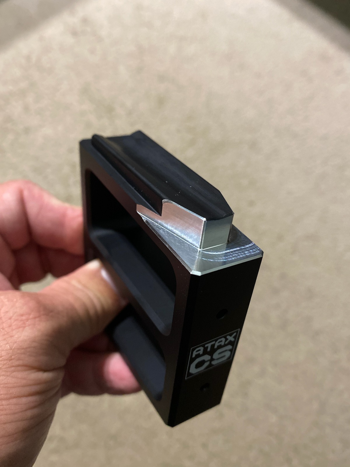

Had a few inquire about the single shot sled I'm running and info is below. Will also let you know if your TL3 is AI cut the AICS/CS sled will need modified and CNCSWERKS can make it happen. The sled they offer for AW requires no additional mods. Hope this helps.

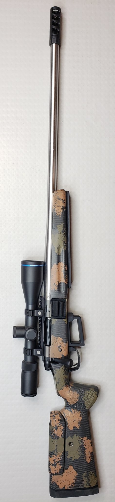

I can't add anything to the SML / Suppressor discussion, but I got out at the end of last week and shot my SML at 200yds and 300yds.
From a 100yd zero, using 68gr of IMR4198, 275gr Parker Black Max, 200yds + 2.0MOA, 300yds +6.0MOA. My three shot group at 300yds was about 2.75 inches. I'm very pleased. Unfortunately I don't think I'll be able to get in the woods for muzzleloader bear season. Oh well.
