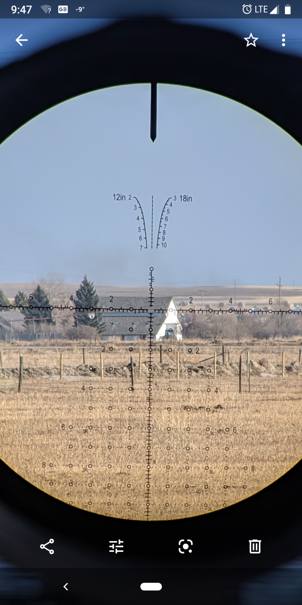

IIRC, this was on 15x.
The funnel is designed to work with four different target widths: 6, 9, 12, and 18 inch. If 12 or 18 inch fits the full width, read the range on the appropriate side. Half those widths, so 6 or 9, use the centerline as one edge. The centerline also helps to ensure the funnel is vertical with the target.
Ability to range four different target sizes with a direct readout gives it a much higher versatility. Hope that makes sense for the concept of the Fatal Funnel.

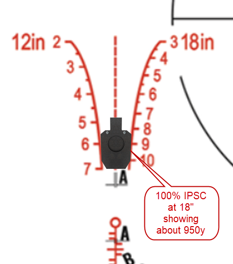

So like this?
Edit: removed image to avoid confusion
Thank you Nick, that helps, my eyes were immediately drawn to all the circles below, just not sure if I like that, but I do like that all the other dots tend to disappear, well I like that the vertical disappear but the horizontal also kind of disappear which isn't good for holds. Interesting design, but not sure if it's my cup of tea.
Any plans to offer a variation w/o the funnel? I can see value in the open dot, but at least to my eye in that field photo, the funnel is extremely distracting.

So Chrome was right, full size would be center across the whole width like the image below, I actually find that more confusing.
This is a very standard way of using a choke style rangefinder. These have been around forever and a day in Eastern block countries designed to range a human torso.
I have seen horizontal choke style rangefinders matched to the ballistics of a particular round, so that when you bracket an object of the right size between the lines, you just pull the trigger. Sorta like a combination between a choke style rangefinder and BDC.
ZCO sized it for competition targets, but aside from that there is nothing controversial here.
ILya
ILya
Got it, super helpful. Once the widest part of the target begins to symmetrically touch the boundaries of the uterus, crosswalk the middle of the target to the closest distance dilenation, and that is your final approx distance.
More learning has occured.

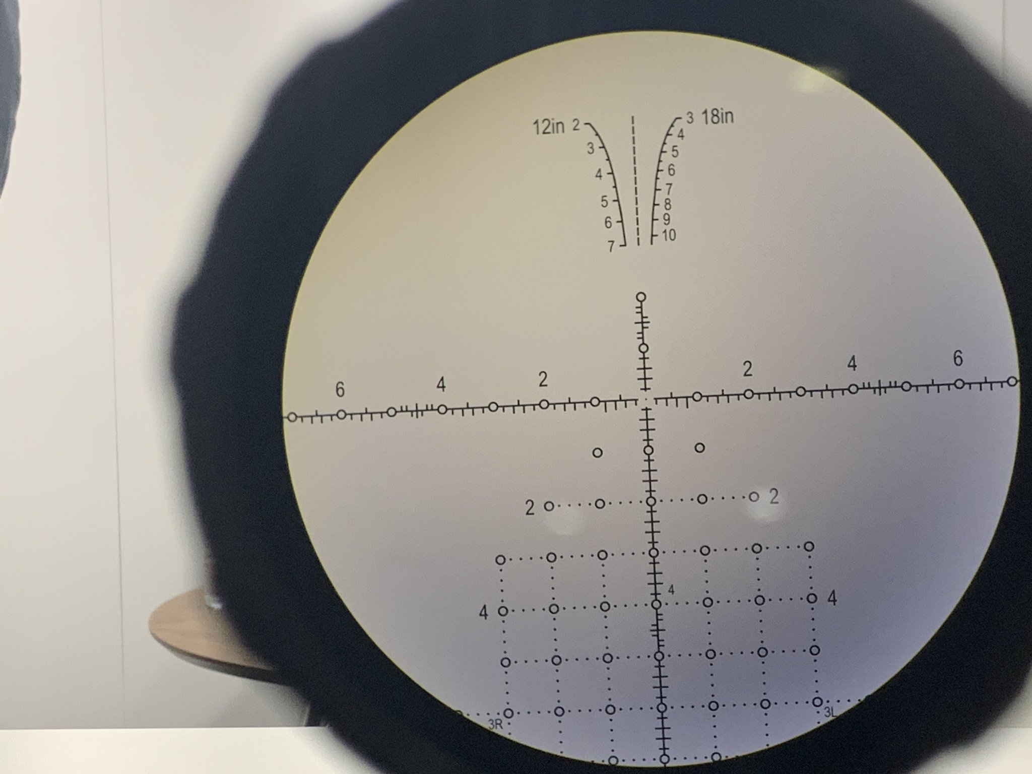

I have not used a hold over (tree) reticle for many years, that said I committed using one this year. I have been working with my Wife's MPCT2 this winter. After looking at the MPCT3 and thinking it though, I have ordered one for myself.
I was like many being very skeptical about how cluttered it appears on the paper, but through the scope I would say Nick was correct that it is less obtrusive than the 2 and the big open dots appear to be fast to find. I do wish they had left the 1.4 and 1.6 up on the horizontal, but I will learn.
I am going to go on a limb, I will bet this works very well and is fast, but with anything new, it will take training and practice will make it effective...:)
Nice work Nick

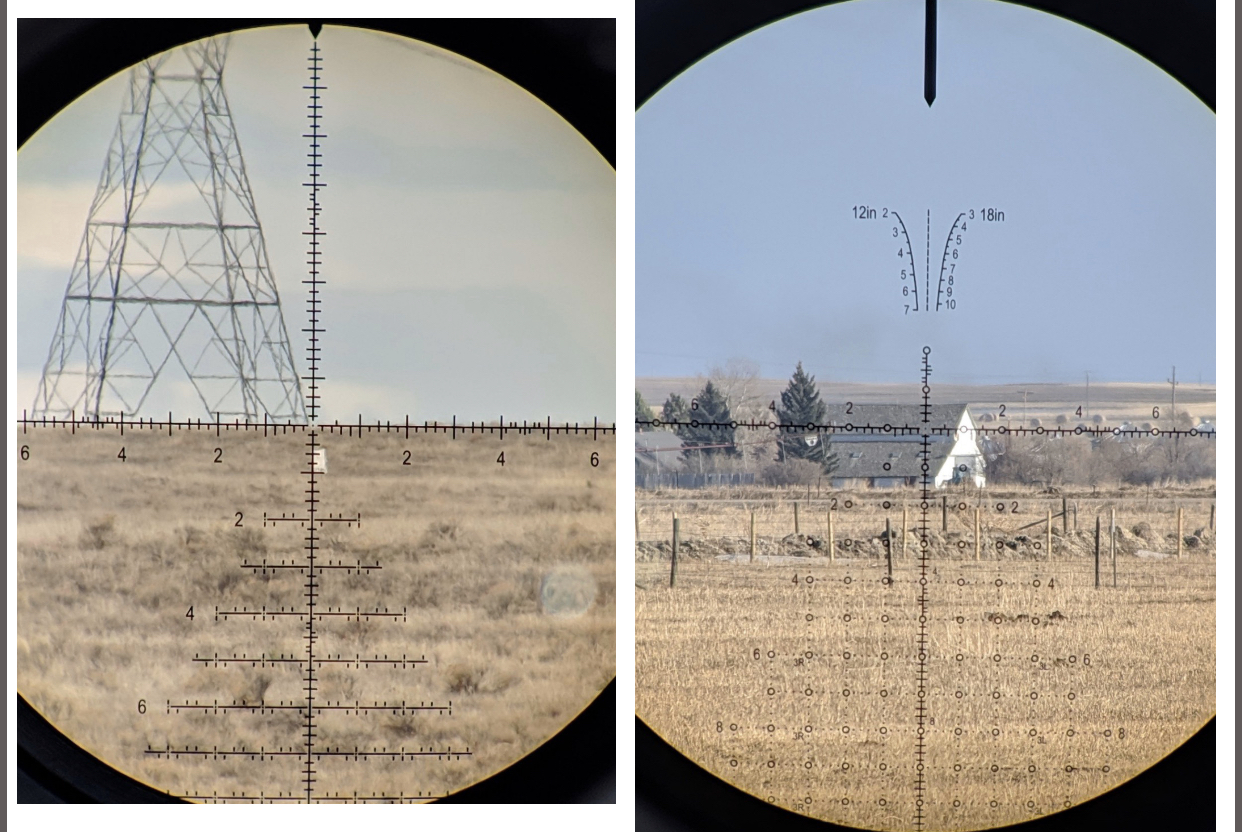

Here’s a side by side with pics currently available
Thanks for posting Dt, even though these are two different scenes it does help to see how the two reticles look in the field (literally). The circles just bug the heck out of me, while the overall reticle is less cluttered from these two images, those circles constantly distract me - will it make a difference in actual shooting, probably not, but as we all know reticles come down to usability and personal preference and for me the circles are an annoyance. Last year I kept asking ZCO for an MPCT3 with dots, but this MPCT3 was not what I was hoping so now I'm going to ask for the MPCT4 (or MPCT2e for enhanced) which would be the MPCT2 exactly, but instead of the solid horizontal lines and hash marks, just use dots like the MR4/Gen 3XR and eliminate the funnel and make the center dot a tad bigger. But the reality is I am a small fish in a large pond, regardless of what ZCO does with their reticles, the fact remains they make some phenomenal scopes which is impressive for a company only a few years young!
I’m the same with the circles. My eyes keep shifting from one circle to another all over the place.
This is definitely not a complaint, as everyone is different and it’s obvious this reticle appeals to people.
