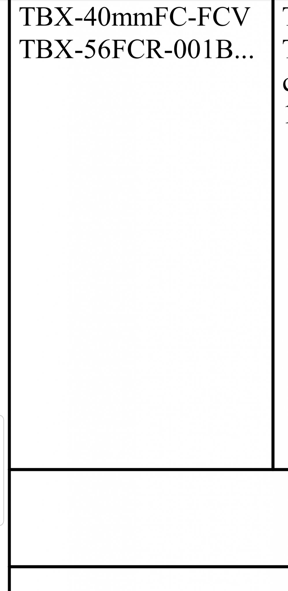

Thank you, going by that for the ZCO scopes we need either:
ZC527:
56FCR-001BK1 = 56mm adapter ring with flip-up cover
56ARD-001BK1 = 56mm Anti-Reflection Device
40mmFC-FCV = Ocular flip-up cover
ZC420:
50FCR-001BK1 = 50mm adapter ring with flip-up cover
50ARD-001BK1 = 50mm Anti-Reflection Device
