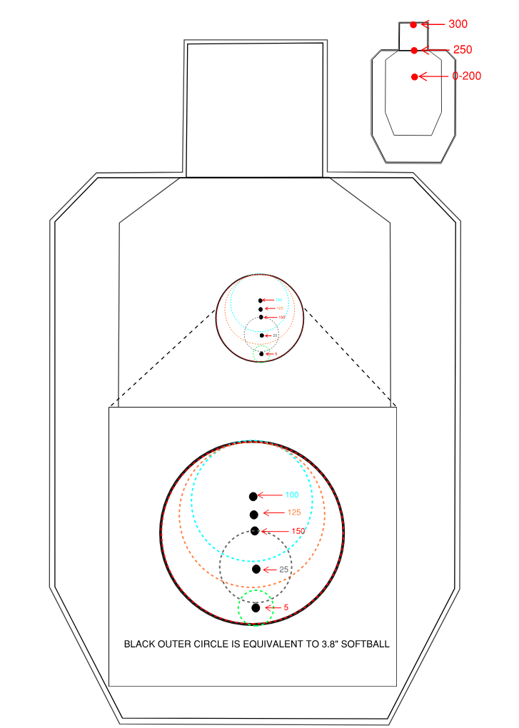

So check this out, this should help visualize the 100 yard zero on a target instead of columns of numbers. I don't know the velocity or accuracy of your 62gr ammunition but the next best thing I have to pull data from is some Hornady Frontier 62gr Spire Point that I shot earlier this year. It clocked in at around 2971 fps from a 16" barrel and shot about 2.5 MOA. So take a look at the diagram...
From 5-150 yards you're basically inside the area of a softball (3.8" black circle). The dashed circles represent a 2.5 MOA group at the corresponding distance, now there will be shots outside of that but you can generally expect to hit within that area. Holding the same point of aim, 200 yards will be just under the "softball but still in the center of mass of that BC-Zone. Need to push out to 250, hold at the neck and let her eat, 300 yards...hold top of the head.
That's GREAT...thanks so much. so you are under 4" from 5yds to 150yds....which is damn good for self defense I would think. AND...if one uses the bottom line of the Eotech reticle for anything 25yds and under....pulling up POI even closer to POA at those close ranges you really don't have to worry about anything until you are pushing 200+yds. So it is, basically point and shoot from 0 to 150yds, with 100 yard zero...with the understanding you are using two different parts of your reticle depending on distance.
This is what makes me lean toward the 100 yard zero over the 50/200 yard zero for 0 to 150 yards self defense type use.....unless I am missing something. It seems based an all this discussion that it gives me the least amount of deviation at that 0 to 150yd distance...and still allow some level of precision shooting from say 75 to150yds with knowing some type of holdover past that.
Am I seeming to understand this better now???

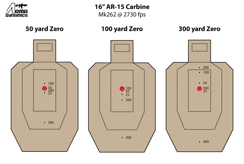

AR-15 Zeros and Trajectories
The 100 yard zero with a .223/5.56mm AR-15 carbine is a unique trajectory in that the bullet just “kisses” the line of sight at 100 yards and rides along it for approximately 10 yards before dropping back down below the line of sight. (Technically, the bullet does travel above the line of sight, but by only 0.010”; a fraction of the diameter of the bullet itself.)
For all other zeroing schemes, there are going to be two points were the bullet crosses the line of sight; the near-zero and the far-zero. For the near-zero, the bullet will cross the line of sight while traveling upward from the muzzle toward the apogee or “maximum ordinate,” its highest point of travel. For the far-zero, the bullet will cross the line of sight while traveling downward from the maximum ordinate.
Now, when assigning a name to a particular zeroing scheme, it would be helpful if that name gave descriptive information about that particular zero; that is, the name should give us information about the trajectory and how it is unique and differs from other trajectories.
As a point of reference, the Santose Improved Battlesight Zero is often referred to as a 50/200 yard zero, however this is incorrect. It is actually a 50 yard/200 meter zeroing scheme; and this is only with a very few particular combinations of bullet weight, barrel length/muzzle velocity and height of sights above the bore. As an example, a 20” barreled AR-15 A2 firing 62 grain M855 will not match the 50 yard/200 meter IBZ. Neither will a 16" barreled RECCE firing 77 grain MK262, nor a 14.5” barreled M4 carbine firing the 70 grain 5.56mm Optimized "Brown Tip" load. The same concept applies when people refer to a 50/225 yard zero. Only a very few specific combinations of bullet weight, barrel length/muzzle velocity and height of sights above the bore will match that description.
What this is all leading up to is this; except for a very few specific combinations of bullet weight, barrel length/muzzle velocity and height of sights above the bore, a 50 yard zero is a different zero than a 200 yard zero. For a 200 yard zero, we know that this trajectory will produce a far-zero in which the bullet will cross the line of sight at 200 yards in its downward travel from the maximum ordinate. (It is physically impossible to produce a 200 yard near-zero with any of the commonly available loads and barrels lengths used in .223/5.56mm AR-15s.) Other than for a very few specific combinations of bullet weight, barrel length/muzzle velocity and height of sights above the bore, the near-zero of the 200 yard zero will not be at 50 yards.
Conversely, a 50 yard zero tells us that this trajectory will have a near-zero in which the bullet crosses the line of sight at a distance of 50 yards in its upward travel to the maximum ordinate. For those who think that a zeroing scheme must be named after its far-zero, it is physically impossible to produce a far-zero of 50 yards with any of the commonly used loads and barrel lengths in .223/5.56mm AR-15s. The 50 yard zero can only be the near-zero.
Here are a couple of illustrations to aid in understanding some of the concepts described above. Lets start with the 100 yard zero as a reference point. As described above, with a 100 yard zero, the bullet’s trajectory just “kisses” the line of sight at 100 yards. Now, let’s increase the elevation setting of the sights/scope. As this is done, the near-zero can only move closer and closer to the muzzle. Concomitantly, the far-zero moves farther and farther away from the muzzle.
For the next illustration, we’ll start with the 100 yard zero again, only this time let’s decrease the elevation setting of the sights/scope. As this is done, the bullet’s trajectory can only fall away from the line of sight. The bullet will never cross the line of sight again; no zero at all.
Other than for a very few specific combinations of bullet weight, barrel length/muzzle velocity and height of sights above the bore, the far-zero of the 50 yard zero will not be at 200 yards; and for all practical purposes it matters not one bit. Whether the bullet crosses the line of sight for the second time (far-zero) at 189 yards, 200 yards, 215 yards or 225 yards will not make the slightest bit of difference in the practical application of the AR-15 as a defensive weapon. In each case we will be holding the same POA (beyond CQB distances) and know that we will be hitting within approximately 2 inches above or below that POA out to 200 yards (or farther depending upon barrel length and load.) You should have an idea what your actual far-zero is when using a 50 yard zero and confirm such at distance when possible, but again it’s most likely not going to be a 200 yard far-zero and again it does not need to be.
Choose your zeroing scheme based on the pertinent facts; not nonsense about “shooting through a cone.” When shooting at human targets, in the grand scheme of things there isn’t going to be any practical difference between a point of impact that has a negative deviation from the point of aim, (e.g. the bullet strikes 1.5” below the point of aim) and a point of impact that has an equal positive deviation from the point of aim (e.g. the bullet strikes 1.5” above the point of aim.) In other words, the absolute value of the point of impact from the point of aim (how far the point of impact deviates from the point of aim, regardless of whether it is a positive or negative deviation) is what we need to be concerned about. Therefore, one of the main points to consider when choosing a battle-sight-zero is this: What zeroing scheme produces the smallest absolute values for the deviations of the points of impact from the point of aim, over the distance that we reasonably expect to engage a human target in our intended usage?
The chart below illustrates the above concept. The chart compares the absolute values of the deviations of the points of impact from the point of aim (0.0 inches on the graph being the point of aim/line of sight) for a 50-yard-zero and a 100-yard-zero, using Hornady 5.56 TAP T2 ammunition.
As you can see in the graph above, from the muzzle (0 yards) to approximately 62 yards, the 50-yard-zero has a slight advantage over the 100-yard-zero. Between the distances of 62 yards and 165 yards, the 100-yard-zero has the advantage. From the distance of 165 yards out to the 250 yards shown in the graph, the 50-yard-zero has a distinct advantage over the 100-yard-zero. Choose your zeroing scheme based on the pertinent facts.

I'll attach the target I have found and will be using....unless someone has something better or more accurate.
I will use that target for:
1. Eotech HWS EXPS2-GRN & 2. Troy Ind. flip up Iron Back Up, Round/M4, sights for my 100yd zero
3. Streamlight TLR-2 HL GRN Laser will be up front under barrel and set at a "constant offset"...point straight out parallel to bore.
Thanks again you guys. I guess I am one of those very meticulous guys who leans toward trying to master things. Heck, it takes me over an hour to field strip and clean my handgun after every range outing...which is NOT NORMAL....lol. I was a competitive gymnast in my younger days....guess I get that from that!!!
  • red-dot-25yd100-mod1_1-(ar-15).pdf

For your purpose the 50y is fine, as it is for most. This isn't precision shooting especially with non magnified EoTechs or Aimpoints. At closer ranges, know where the hold is to a point where its reactive; if a target to me is 15y away, when I bring the gun up I'm instinctively aiming for the head/face area whereas most people will aim dead center and wonder why they are low.
There's also the sweet spot of awesome, where with the 50y zero and a head/face hold, you'll rock them square in the face.
You dont need a magnifier for a carbine for longer distances as the zero 'system' helps with that; the mentality is you're looking to suppress them well (i.e. not just randomly shoot ammo, but get it in their direction/very close) while moving or when its your turn to be the cover man during F&M/displacement. It's a balance of speed and accuracy you're looking for and the 50y zero helps with that so you're not stuck adjusting shit or trying to figure out ranges or whatever. You're shooting at a target, unknown but guesstimated range, and the 'system' of your zero and the rounds' exterior ballistics really help each other with that.
Reactions: KM1
Now you got me rethinking this.
I was working off a 100yd zero...not 50. My thought process was that this would minimize the deviation of bullet travel between 0 to 100yds by simply aiming 1" high 0 to 50 and 1moa dot right on 50 to 100.....done. This, if I had figured this right, would put any shot POI around 1" or less to right on at 100.
With a 50yd zero I would be under below 25yds and over 2" or so at 100yds. Both an under and an over. With the 100yd zero you are only under so a slight rise with the 1MOA dot to 50 would minimize that under keeping that ribbon of deviation very small. Point and shoot. That was my original thnking after reading all posts and looking at the ballistics of the rounds I am considering through a 16" barrel.
No need to overthink, and you basically said it according to Molon's charts; with a 50yd zero, you'll never be more than 1.4 inches (2 inches) either way of the zero out to 200.
And seeing as how we're not trying to hit the bullseye, why make anything more difficult than it has to be?
Up close defensive distances - aim for the lower face.
Past 50 out to a perceived 200 - aim center with the dot/reticle.
Past that, aim for the face.
