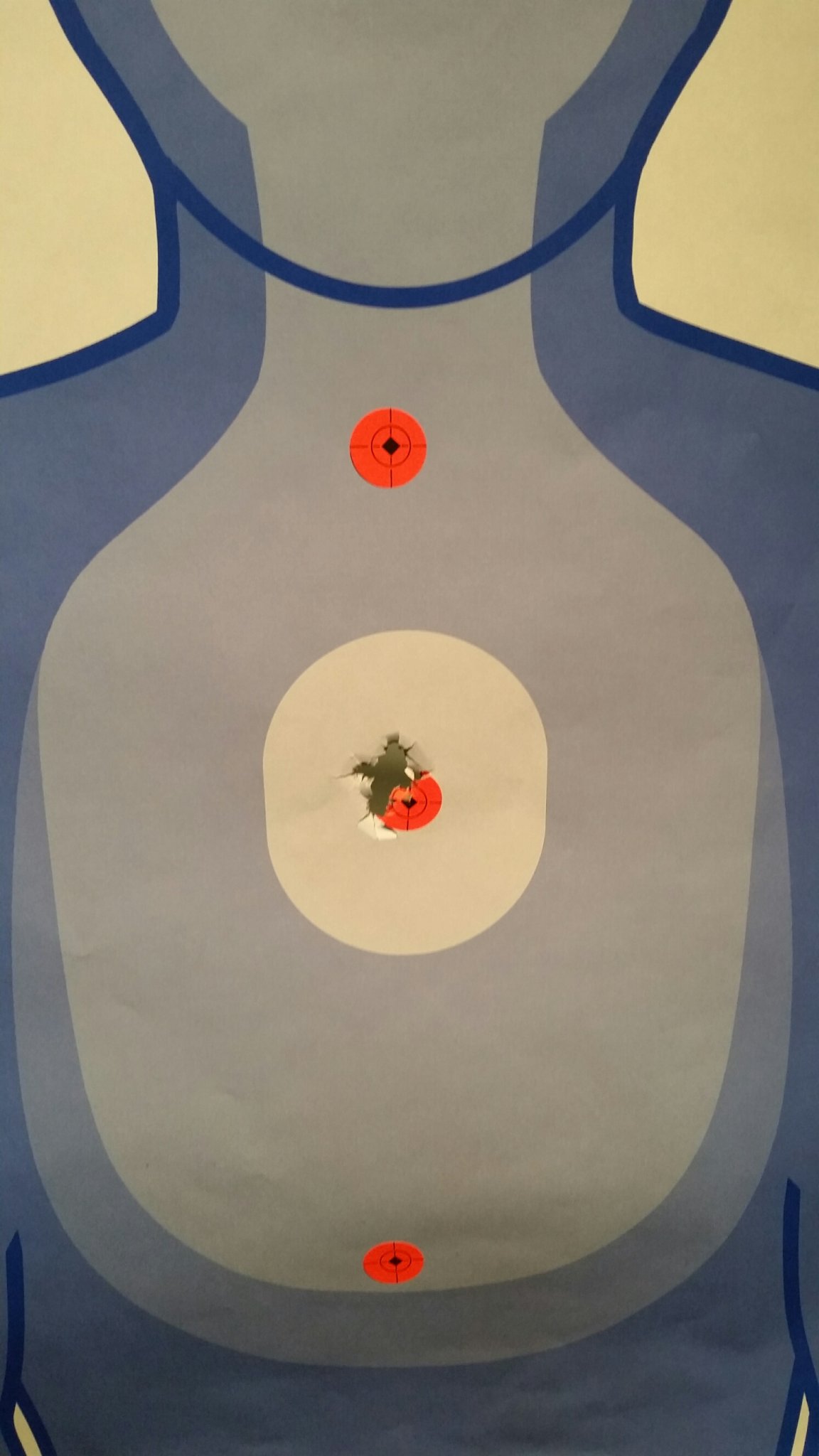

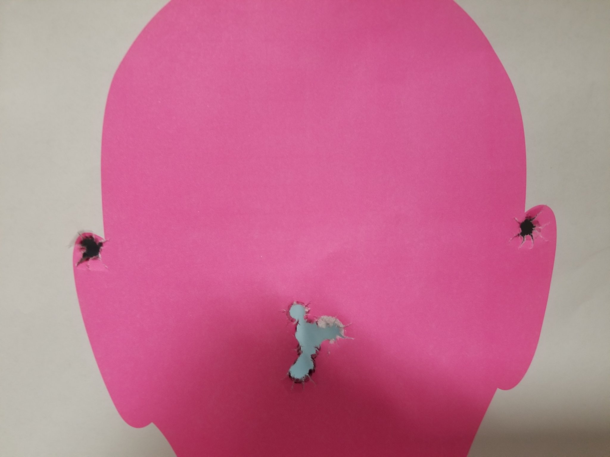

A couple pics of handgun practice, on good days for ya. Keep in mind this is slow fire, trigger controlled, stationary target, seeking solid sight picture....NOT draw from concealed, point and shoot, where the spread does have significant increase over these pics.
Firearm: Sig P229 w/combat sights (Sig XRay) 9mm
Training Ammo: 9mm Speer Lawman 124grn TMJ
Self Defense Ammo: 9mm Federal Premium LE Tactical HST HP (I believe same as you)
First pic is 5 training rounds at 25ft Center Mass
Second pic is 5 training rounds at 25ft...+2 cartilage piercings, LOL.....Head Shots

Those pics I posted are with using both trigger pulls. Takes time to learn....but can be done.
