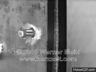

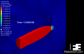

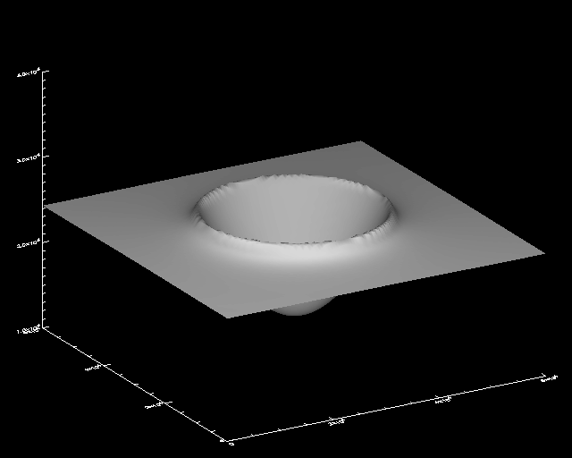

During high impulse events, solids may exhibit properties more akin to liquids.
For instance, a bullet cratering on impact resembles the propagation of a water droplet…

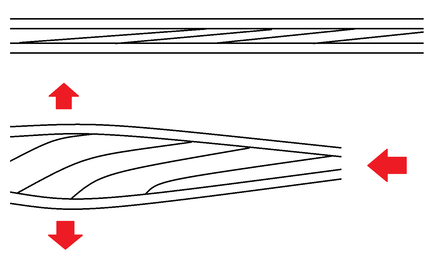

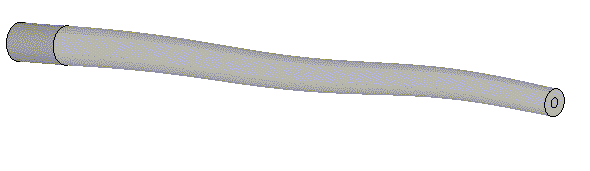

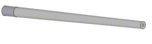

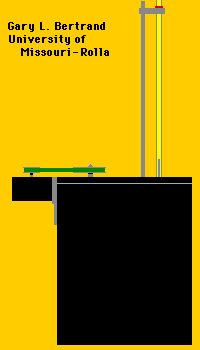

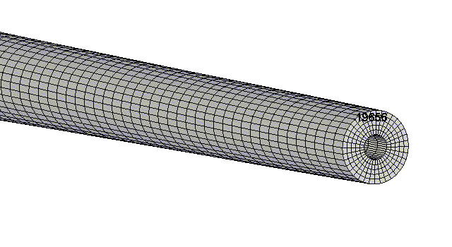

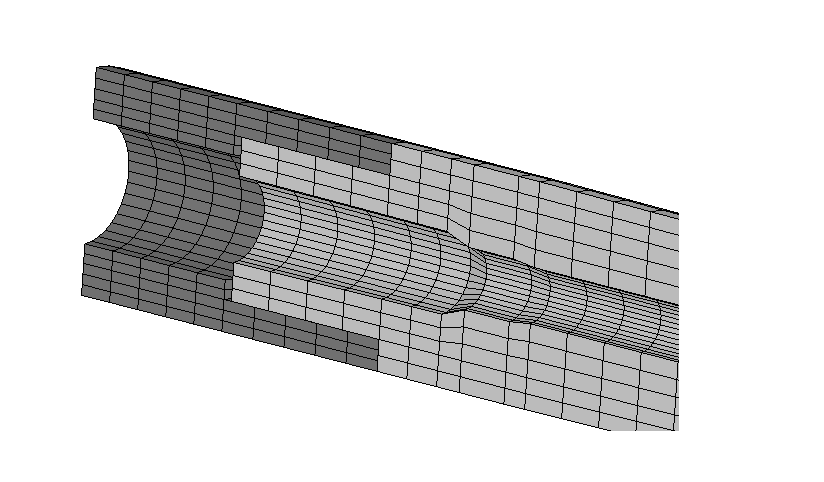

Another video suggests that the typically imagined “OBT Harmonics…”
…a phrase I casually throw around despite my really superficial understanding of it all…
…does not occur the way we suppose they do.
Perhaps this model’s a better representation?

There does seem like a lot of discussion about using bullet speed to time the its exit at the top or bottom of a vertical oscillation (OBT). But, with a round barrel, if there were any oscillations that actually exist, I can't imagine any reason for them to be in solely the vertical plane...yeah, a vertical vector component and a horizontal vector component summing to some sort of movement at some angle.

Let's say that there is some vertical component - "barrel whip" or whatever one wishes to call it. The action isn't symmetrical about the horizonal plane, so this is bound to arise. Having agreed upon that, what do we think is the magnitude compared to the vertical displacement induced by the rest of the system - namely the interfaces between the action and the stock, and the stock and the shooter?
We know that the combined effects of the barrel's intrinsic flex and the motion between the action and the stock is relatively small; 0.010" is usually considered enough to float the barrel. That's tiny compared to the displacement at the muzzle that can be observed from a shooter with less than optimum fundamentals.
I'm not suggesting that we discontinue pursuit of incremental gains at the margins because human sport is filled with success stories of exactly that type. Let's just make sure we're attacking the problems with the largest surface area first. Ultimately, I'm less concerned about barrel displacement in general than I am about displacement that isn't consistent shot-to-shot, and solving for the latter problem would typically require breaking down the problem to its fundamental elements to understand the variation and contribution of each. A large undertaking, for sure.
