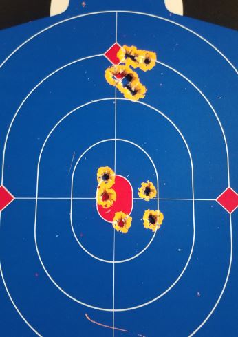

Get behind the gun as much as you could, absorb the recoil as much as straight down the body as you could.
Bang, hold, and reset after recoil keeping an eye on the front post and call your shot. Take note where the rifle settles back. It should be back to your sight picture and just requires slight centering. If the rifle settles back at a different spot after firing, adjust position, buttstock placement, NPA, sling, or forward elbow position.
