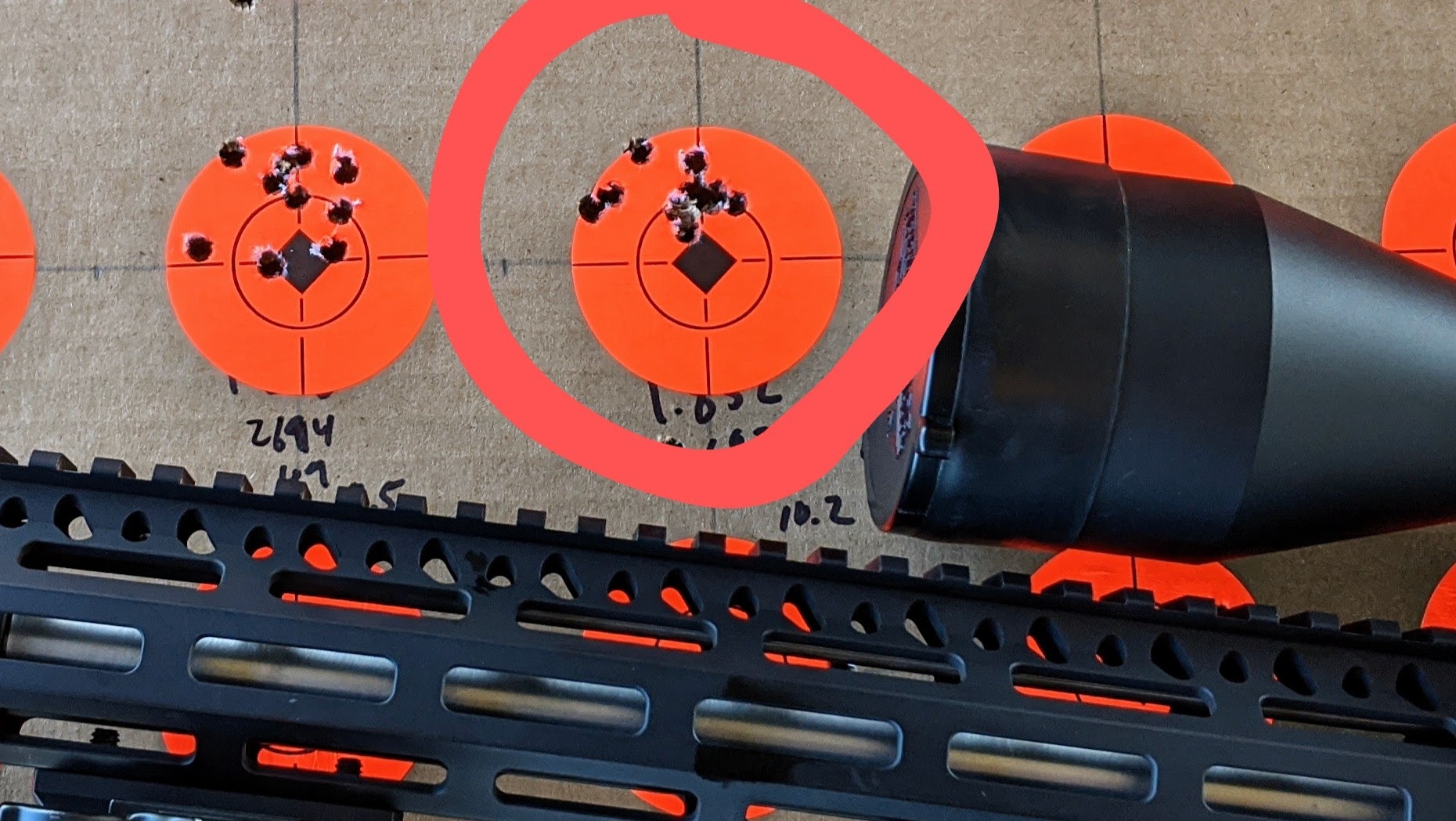

I bought my first AR-15 a while back. I'm not a huge AR-15 fan, but I wanted one for the experience. I bought a Core Rifle Systems M-Lok Scout in .223.
The trigger was not exactly a Timney, so I stuck a LaRue in it. Not a match trigger, but more pleasant than mil-spec.
I had seen Internet people shooting this gun well. I picked up a bunch of Australian Outback 55-grain Sierra Blitzking ammo, and I shot prone at 100 yards. The target I am posting shows what happened. I quit and went back inside, wondering what was going on. I thought maybe the scope had come loose. The first 5 shots went into the bottom-left target, and they were pretty clearly sub-MOA. Then I shot another group, and the rounds went all over the place.
It sure looks like the gun can shoot, and I have no problem shooting sub-MOA with my RPR, so I don't think I'm hopeless, but obviously, something is amiss.
What on earth can I be doing wrong to shoot two groups this different?
I was not expecting insane accuracy, but this is horrible.
you didn't tighten scope and barrel and shoot another group?

No. I had few tools with me, and at that time of year, I was having a problem with rain starting just as I began shooting sessions.
I checked the scope and barrel later, and they seemed fine.
I was using a cheap sheet metal magazine that appeared to be scraping bullets on the way out, so I ordered Magpuls, and I also ground some relief into my cheap magazines. I don't think bullet scraping is the problem, though, because I got that nice group.

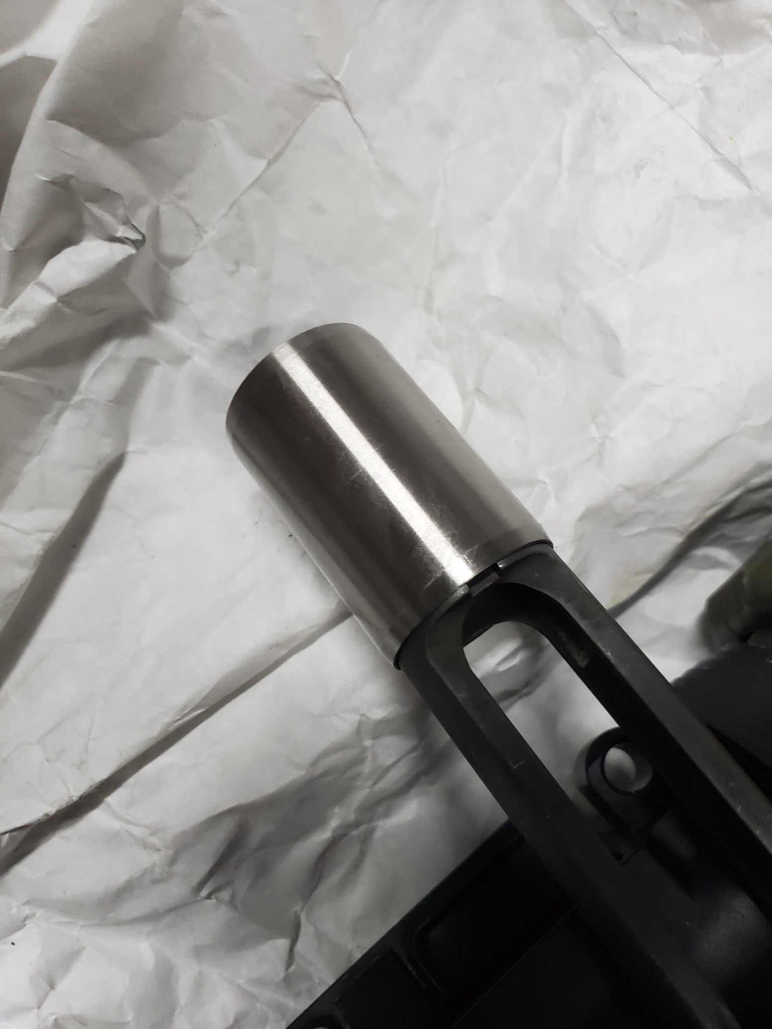

Should I look into some kind of filler between the barrel extension and receiver?
Must be a cold bore shift, the barrel was shooting good all day, and i had 10 rounds left out of 50 for the day, decided to dry fire a bit and noticed how much the crosshairs jumped when the hammer dropped. I found that by firmly gripping the stock with the left hand side to side, I minimized how much the crosshair moved when the hammer dropped. My group went from 1 MOA to that 1/2 MOA (minus the first 3 shots).
probably not. generally "free floating" barrel is more accurate and if your shots straighten out, doing anything could make it worse.
so many others have more experience maybe they have some ideas i haven't heard.

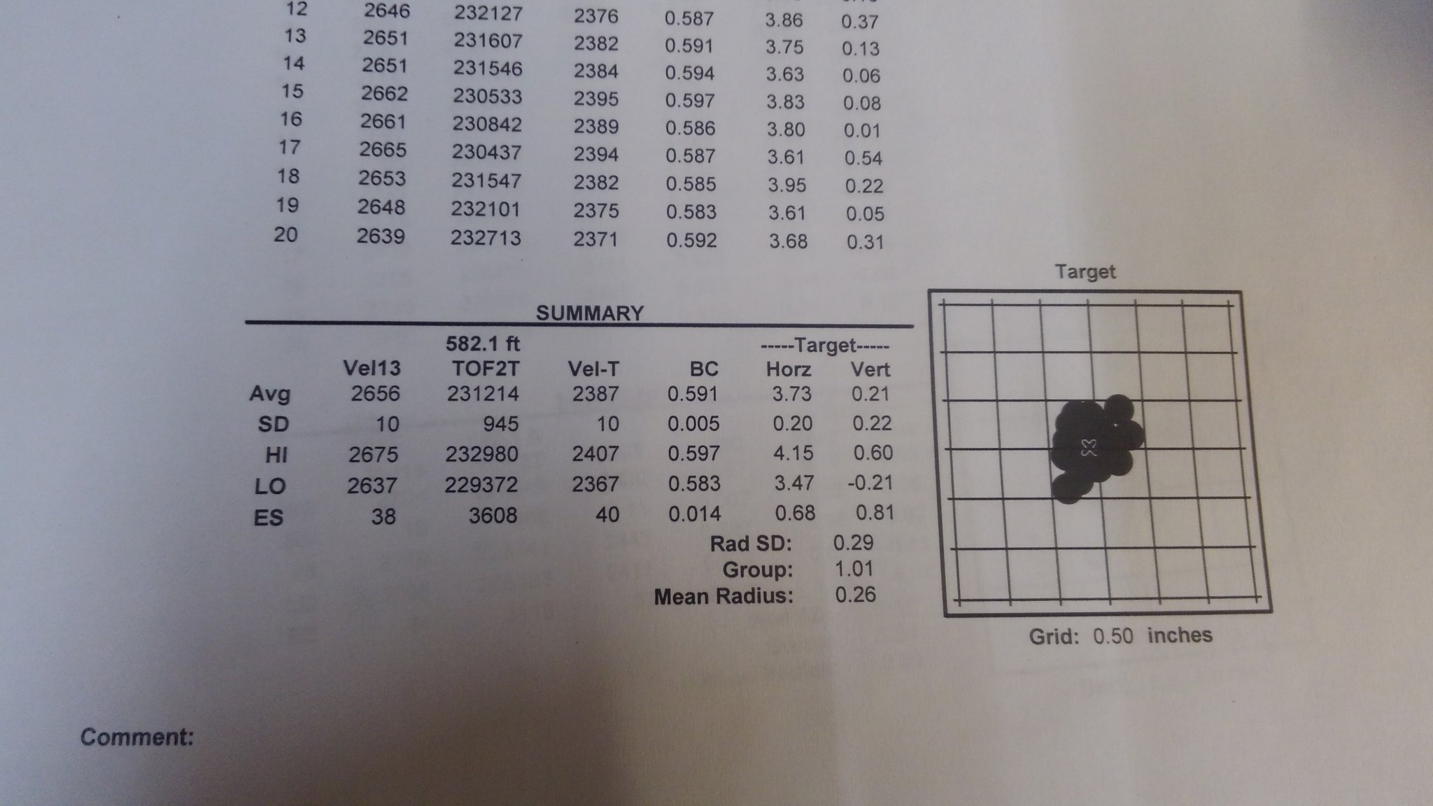

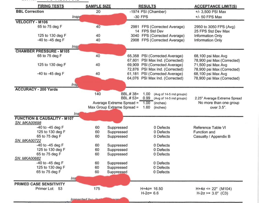

Is this an acceptable sample? 140 rounds? MK248 Mod0. Found this in the errornet.
Reactions: Ledzep
My experience, however, is that rifles that are truthfully and consistently sub 1/2 MOA are much less common than the internet might suggest.
Nah, they grow on trees..............just sayin.
But if it makes you feel better, Jack Leuba from KAC appears to agree:
From an article he wrote titled "Let's Talk Accuracy" which originally appeared on M4carbine.net
"So what is a 1 MOA gun?
A true 1 MOA rifle would be capable of consistently placing the center every round fired in a 1" group at 100 yards, for multiple groups, with the same POA for all groups, with the only changes to POI being made by environmental factors.
Like I have said before: there aren't too many of those rifles in the world."
MM
Ledzep,
Good data. Says what I've been saying. Rifle averages .5 MOA for 5 shot groups with no correlation of MPOI between groups, but also shoots the occasional 0.8 MOA 5 shot group.
So 1/2 MOA +/- 0.3 plus whatever extra dispersion is present when you correlate the POA vs POI of each 5 shot group.
Rifle averages .5 moa on a 5 shot group, probably has a total cone of fire from that 70 rounds (per barrel) in the 0.9-1.2 MOA ballpark. Again, the only reason I make the distinction is when it comes to hit probability and effective range. "Averages 1/2 MOA on 5 shots" does not mean "will hit 3/4 MOA target every time". As can be seen above, even not referencing the MPOI of each group, one of the groups was .8 moa...

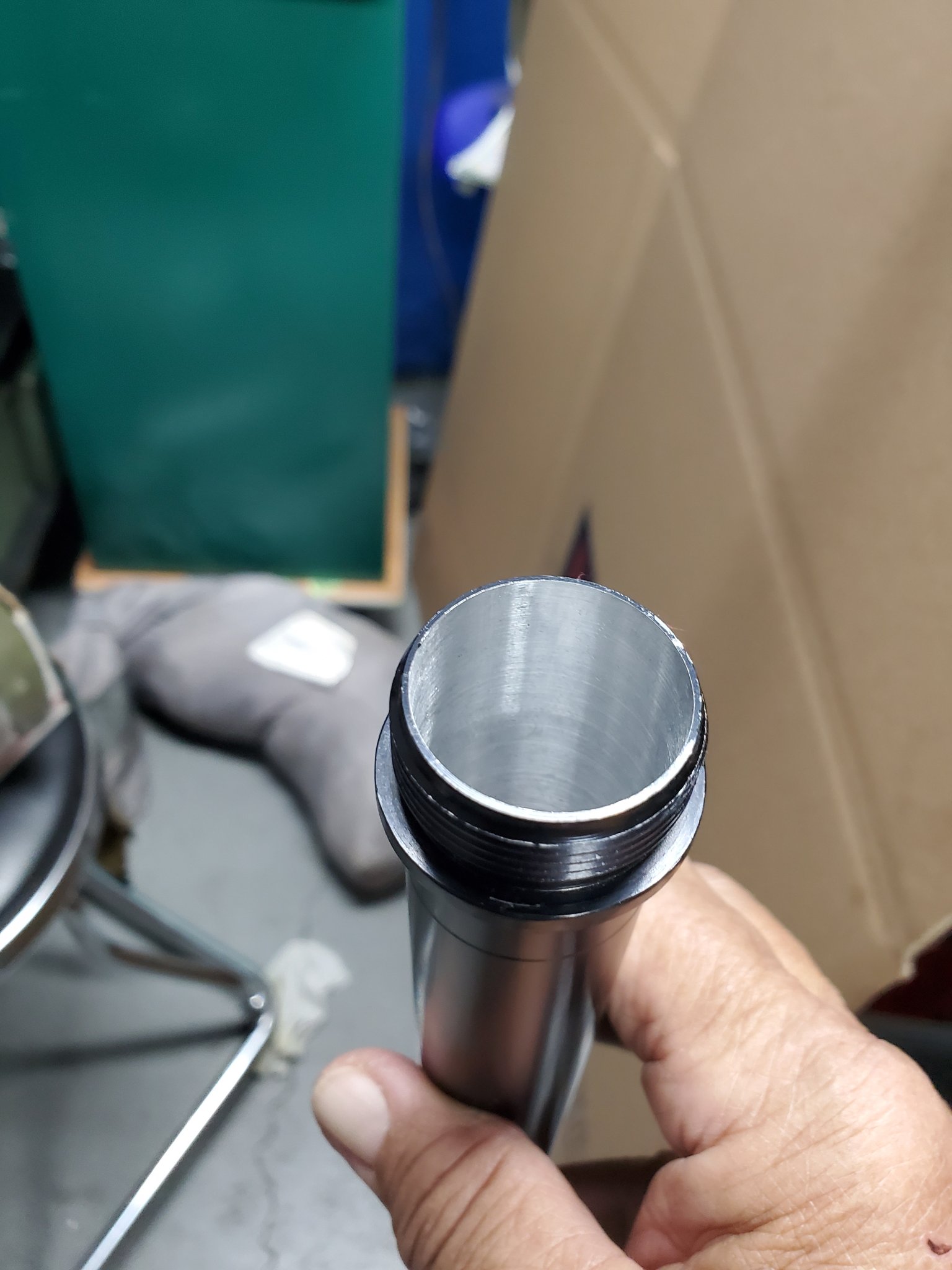

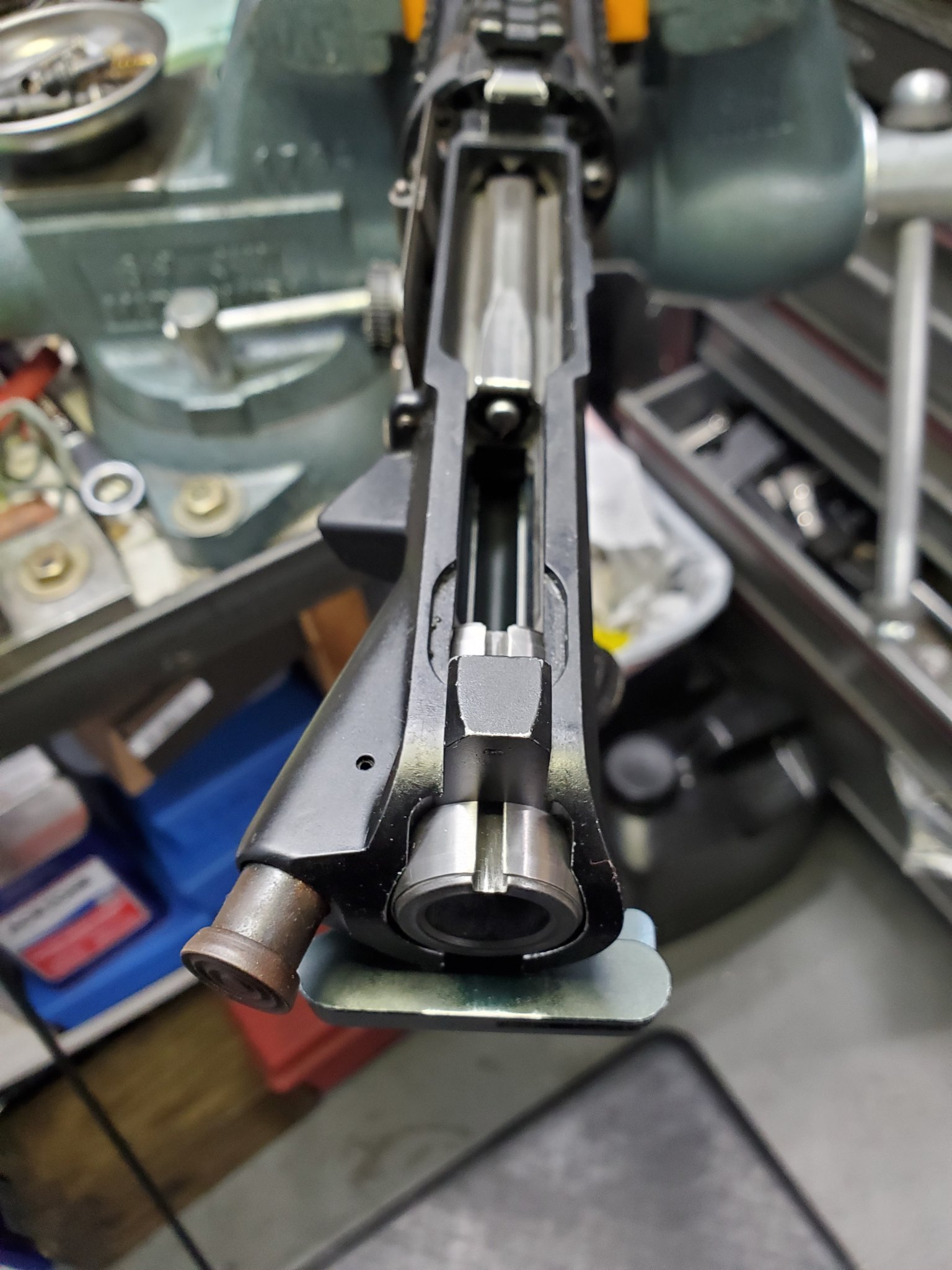

I agree there are some issues with BE to receiver fit, a few upper manufacturers addressed the fit, but not the strength, then there are some who addressed the strength, but not the fit. In high power we are restricted to the standard configuration, no fat oversized receivers. To that end for AR15 we have been using mostly the Bravo company offerings. For the big brother, the JP Enterprises is a good one. JP calls theirs heat to fit. I have encountered Bravo uppers that I have to heat up the upper thread area and cool the extension to fit, but mostly just heat to fit is fine. BE's back when BAT machine were making them, I order a batch quite often with 1.0000 OD. Whiteoak Armaments had special BEs that are 0.300 longer, but the section inside the upper remained the same.
Joe Carlos addressed the BE to upper fit back when he was supporting a military team. Here is the link to his work, scroll to the bottom
Articles by author: Carlos, Joe - Free Online Library
He also addressed the BCG tilt. You can read that in his articles. I addressed the same issue with a different approach. Here is mine.

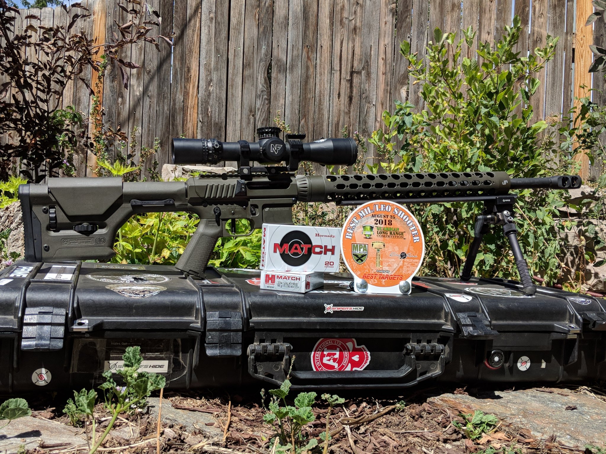

Guardian Long Range with a Semi-Auto Valkyrie, Came in 12th, new gun, 88gr Hornady dropped the week of the match I had to zero at the event. Seems to be a Top 15 showing that would contradict a lot of the claims they don't work. I wasn't in a class by myself, I shot alongside everyone else, funny how that works.
Frank is right, the trigger lock time in gas guns gives up to the bolt guns, but it is not insurmountable. Trigger time is the key. 10K rounds a year will get you there.

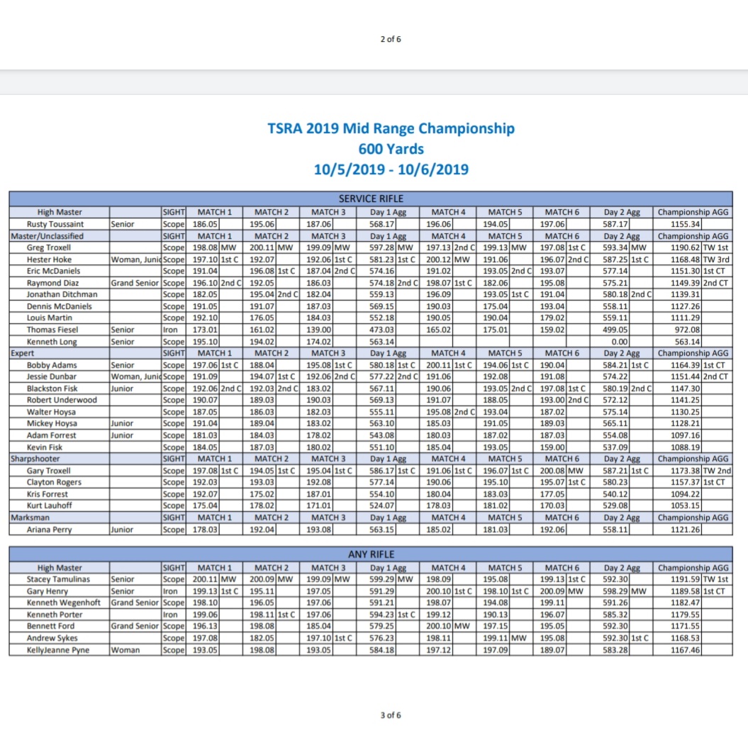

A properly built gasser behind a seasoned shooter can hang with bolt gunners. 2019 TX Mid Range Championship I had my service rifle (20 inch barrel topped with 4.5X March scope) ready along with 250 rounds of 80 VLDs, but my Asthma kicked my butt, so I handed my rifle and ammo to Greg to shoot. Two days of 600 yard shooting, Greg placed 2nd among all sling shooters. The any rifle any sight winner with his bolt gun and higher magnification scope posted 1191-59X besting Greg's 1190, but Greg posted 62Xs. Whenever a service rifle can out Xed bolt gunners at 6, it is worth noting. Greg also shoots with the state team, whom I support with barrel work.
Note: The 3rd place winner in the service rifle category was a 14 year old in our program. How she shoots well is no accident, she puts in time on the range on a weekly basis. I venture to say she has more rounds downrange than most. Hers is 10K plus with gas guns. Now at 15 she is just a few points away from getting her rifle distinguished badge.

This is a 200yd target, 6.5 Creedmoor.
I've never said it's impossible. I've done it. I just know what went into finding what does it and I'm fairly confident most folks aren't there. I know how many strings started out at 5 or 10 rounds sub 1/2 that definitely didn't hold it together for 20, 35, 50... There is a very distinct difference between averaging .5 MOA for 5 shot groups and getting 20 or more shots to Never exceed .5 MOA. All I wanted to know is how many shots you shoot to call a rifle/ammo combo "1/2 MOA capable"...
Please. Lol.
How was that shot (machine rest, benchrest bags, etc..? Setup and range details?
That ammo is certainly dialed in for that barrel.

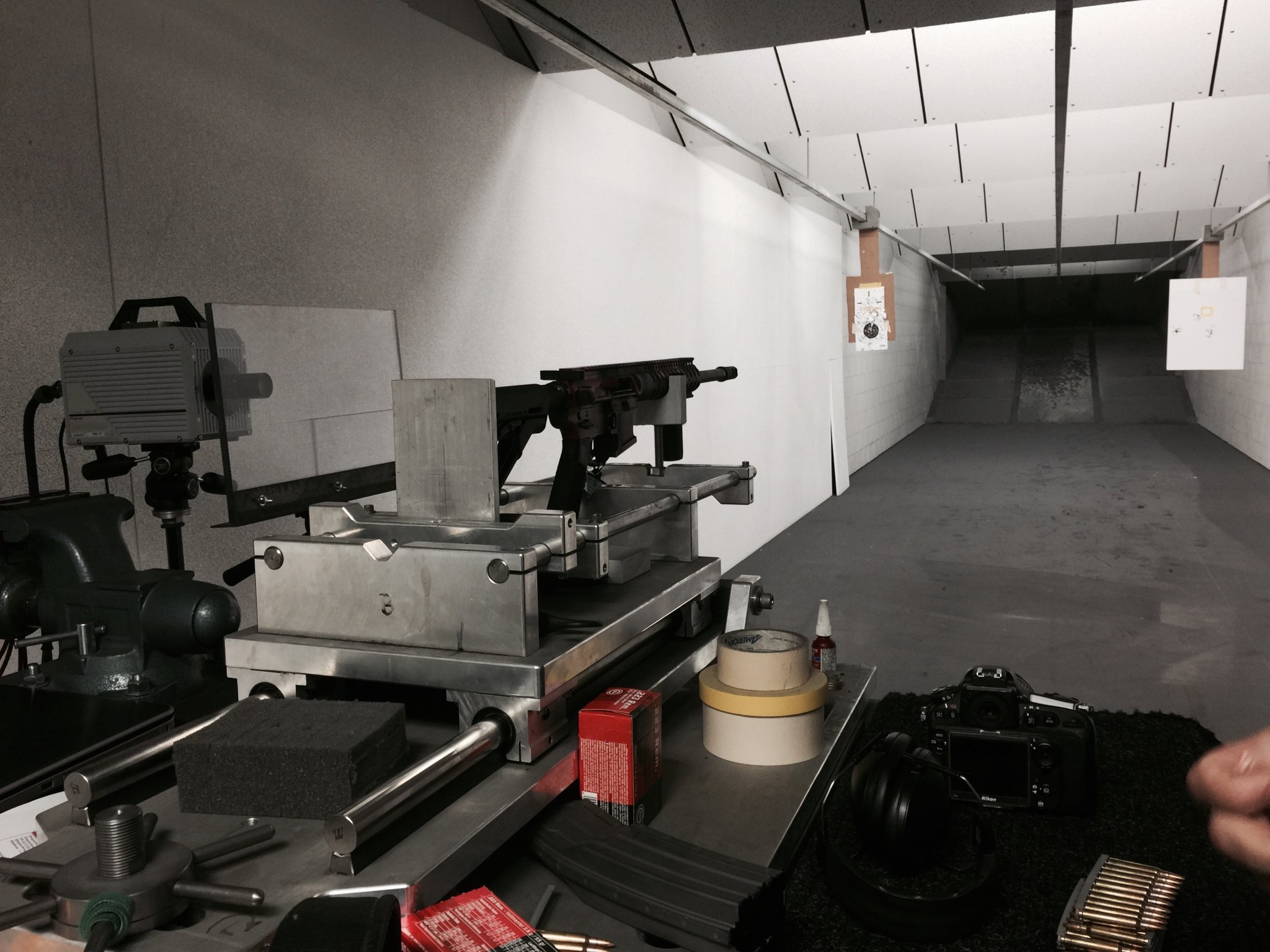

If you want to TEST A RIFLE use a fixture,
Eliminate the shooter, high round groups are testing the shooter if they are not put in a fixture. A rifle is a dumb machine left to its own devices it will do the same thing over and over again, we are the wildcard.
People are smart enough to know this, which is why "Accuracy guarantees" are given the leeway they are because of the Human Factor.
Funny when I was at Hornady they use a test fixture, not a person ...
In fact most big manufacturers I have been to remove the shooter in all their testing rooms opting for fixtures vs people.
