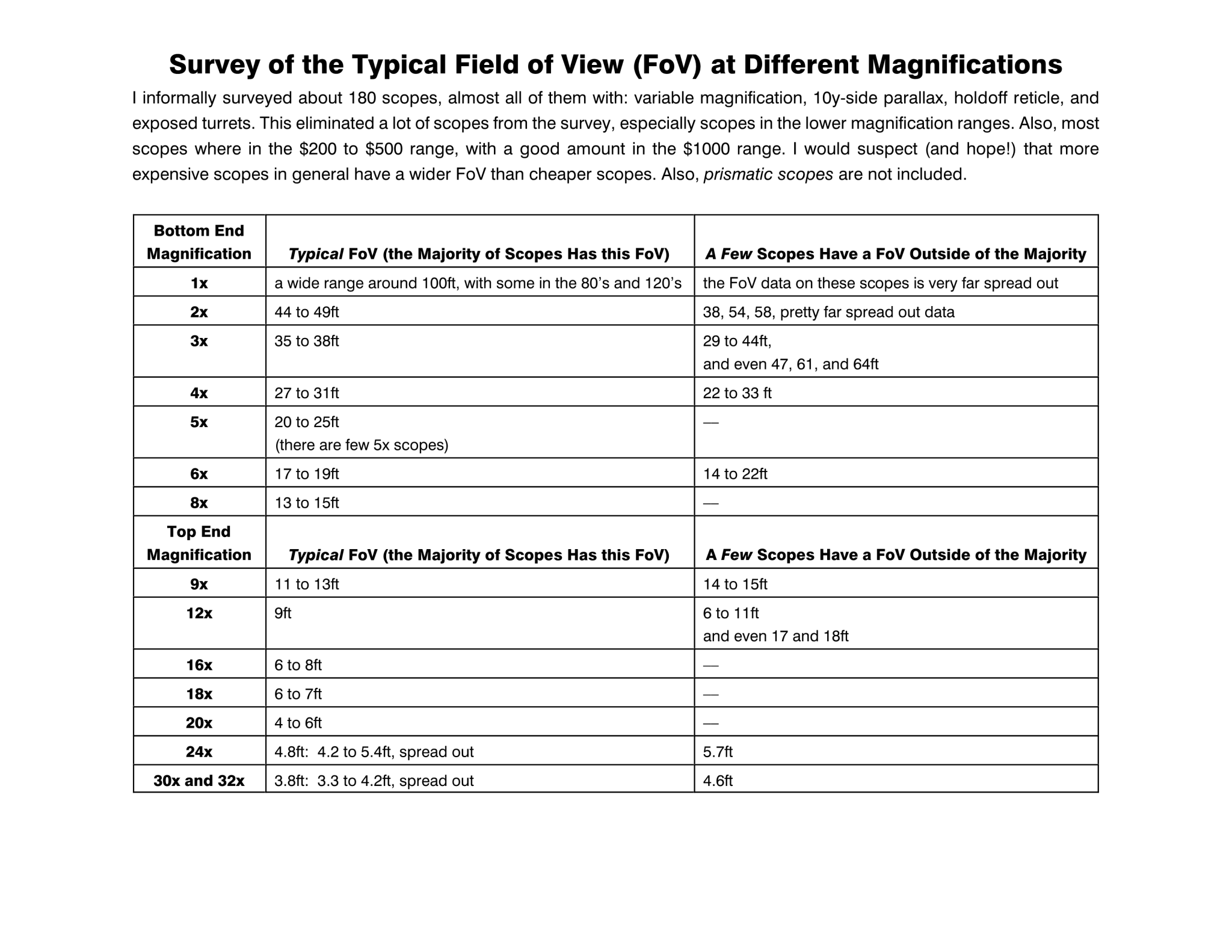

❓ How can you determine what the FoV of a scope is — at magnifications other than the minimum and maximum values given in the manufacturer's specs?
Besides the obvious, of course 😉:
"Buy the scope, set out a tape measure, record, caluclate — done."
➧ But, before I bite the bullet and type my CC number in the field.... — I'd like to know what FoV I can expect at different magnifications.
Because to me FoV is a big deal. To March it was so much that they developed their Wide Angle scopes.
🔶 Just to see what FoV are typical — I did a little survey of manufacturer published FoV (min. and max. magnification). The table below shows the data I found.
Matthias
