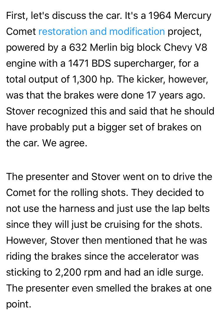

1,300HP Mercury Comet crashes due to owner stupidity

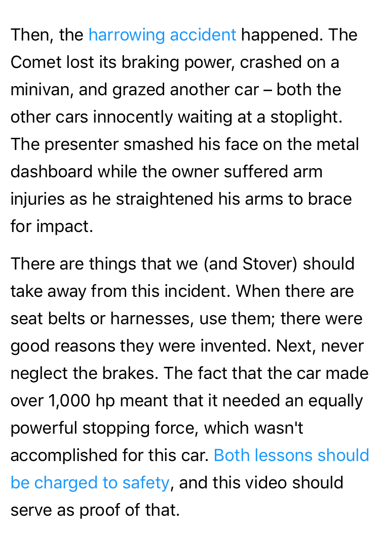

Just want to say... Brakes are kinda important and seems to be a seriously overlooked component of a hot rod. I see a lot of cars who spend tens of thousands of dollars on engines turbos and transmissions basically stock brakes.

I was joking based on the drivers actions. The brakes failed because he was riding them the entire time they test drove. The cars idle combined with power output was making them go too fast on the street, so the driver stayed on the brakes the whole time. They did a simulated descent down a steep incline road while riding the brakes. They overheated and failed combined with a sticky throttle on a 1300hp engine.

For how much time and money he had in that build, a pimp daddy front 6 piston 4 rear, and new throttle cables would have been a rounding error, like a good bit less than the paint job.
Lots of work to be that short sighted
