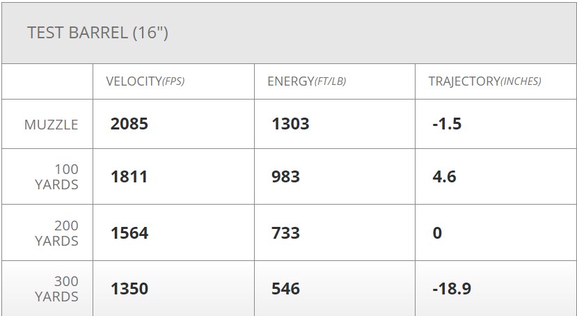

    Reactions: rlsmith1 and Tex68w

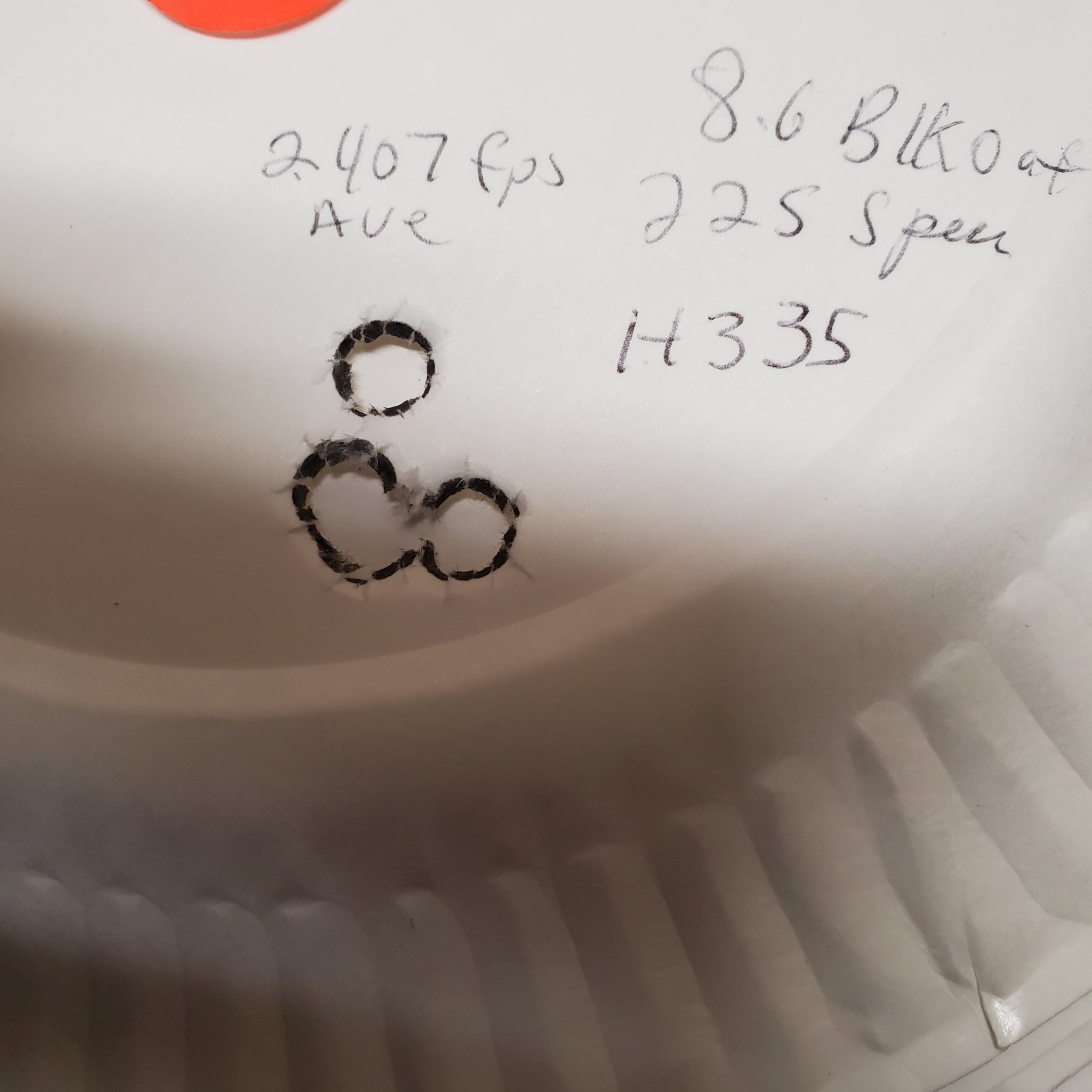

    Have you thought about doing like an 8.6 blk or 375 raptor?
    Yea, not interested in adding any new calibers and I don't reload so it takes a lot of the niche stuff out of the running as well.

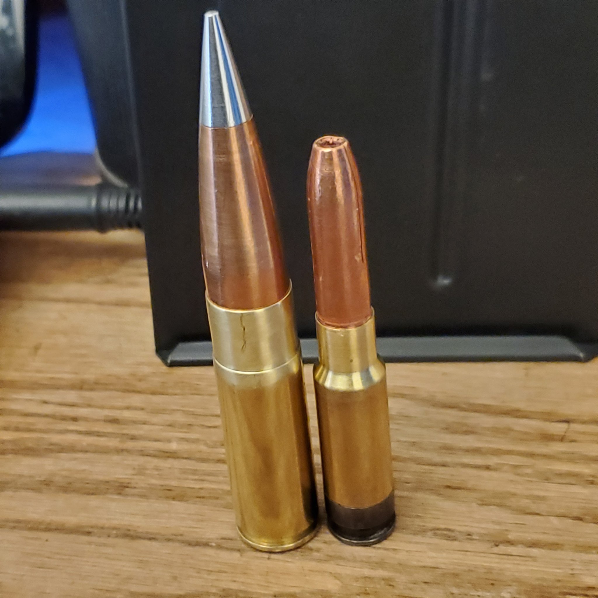

    The big boys, A picture of the 8.6 BO 350 gr Maker vs the 510 Whisper with 750 gr Amax.
    The 510 W can shoot 1002 gr bullet at just 1100 fps with 2700 ft/lbs at the muzzle and arrive at 1000yds with 2000 ft/ lbs of energy, a 1.175 BC, helps.
    Or the 510 350 gr copper Cutting Edge HP bullet with 4700 ft/ lbs or the 750 gr copper segmented Maker...lots of choices, and energy with the 510.

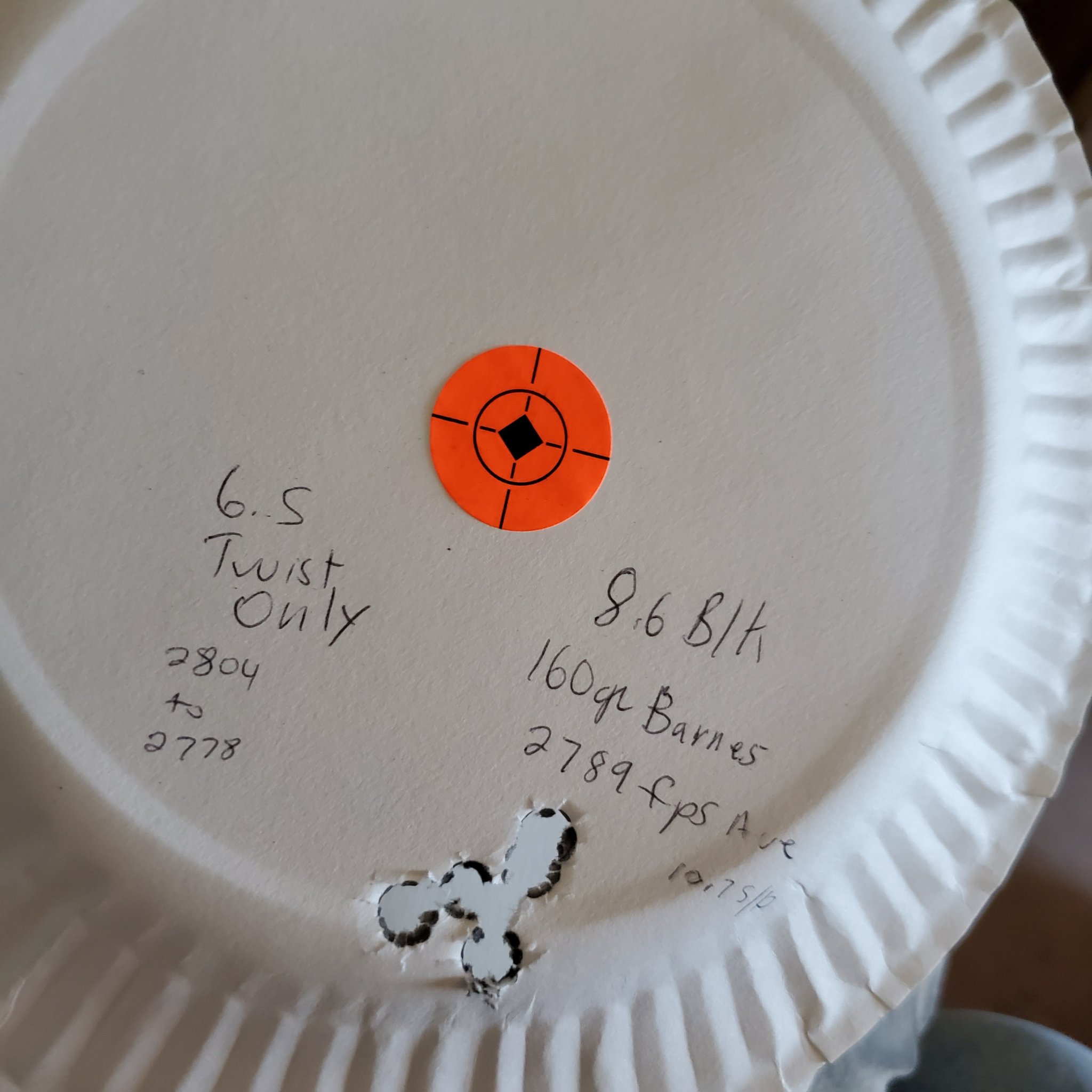

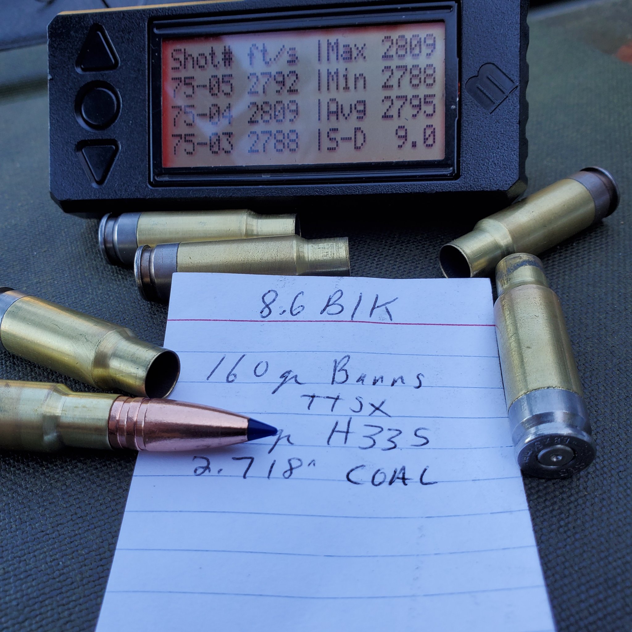

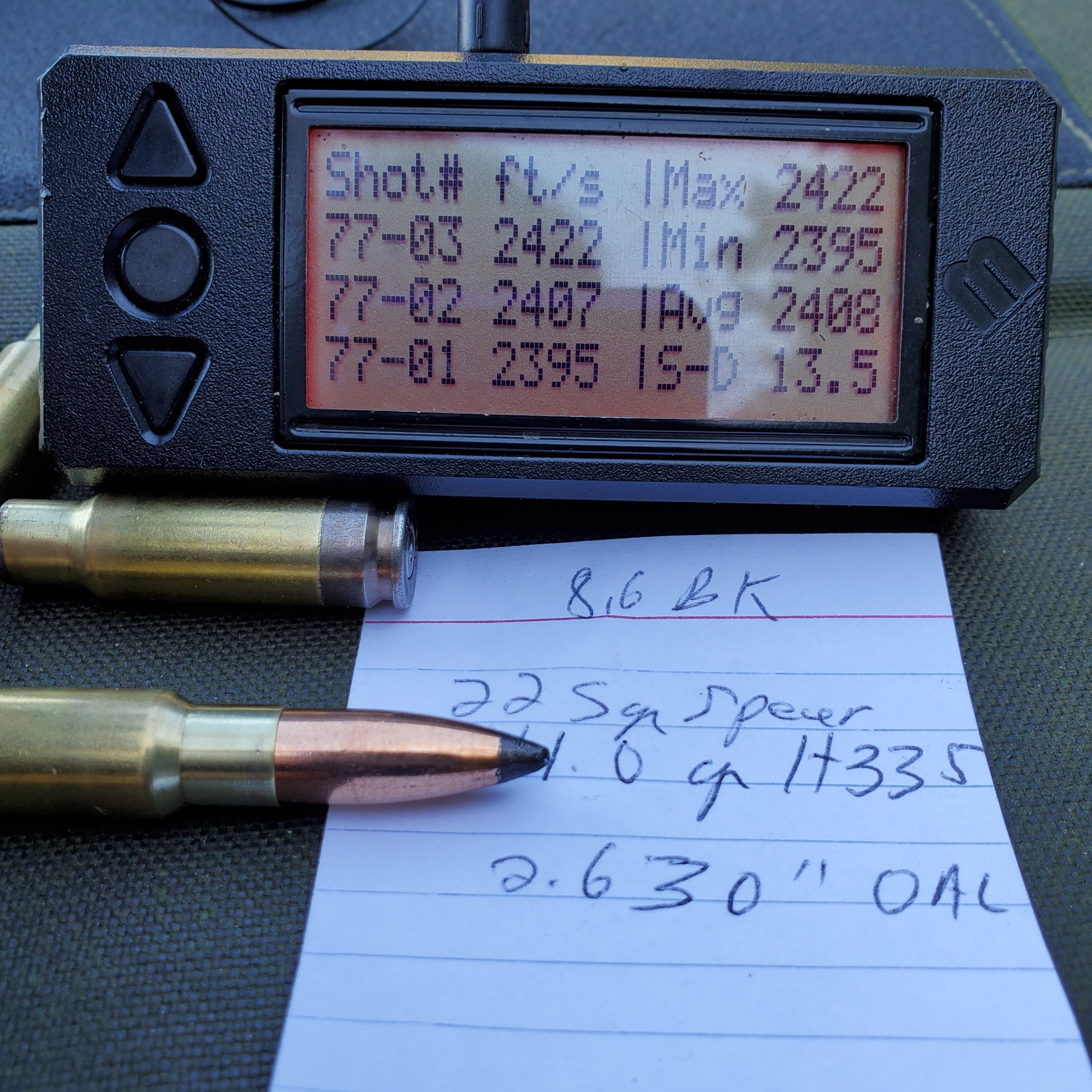

    What barrel length are you getting 225 gr @ 2480 fps? Have you tried the 230 ELD x?
    I'm running a 24" on a bolt gun with a 6 5 twist.
    My rough Faxon 3 twist was hitting max pressure like 3 grains below the 6.5 twist.

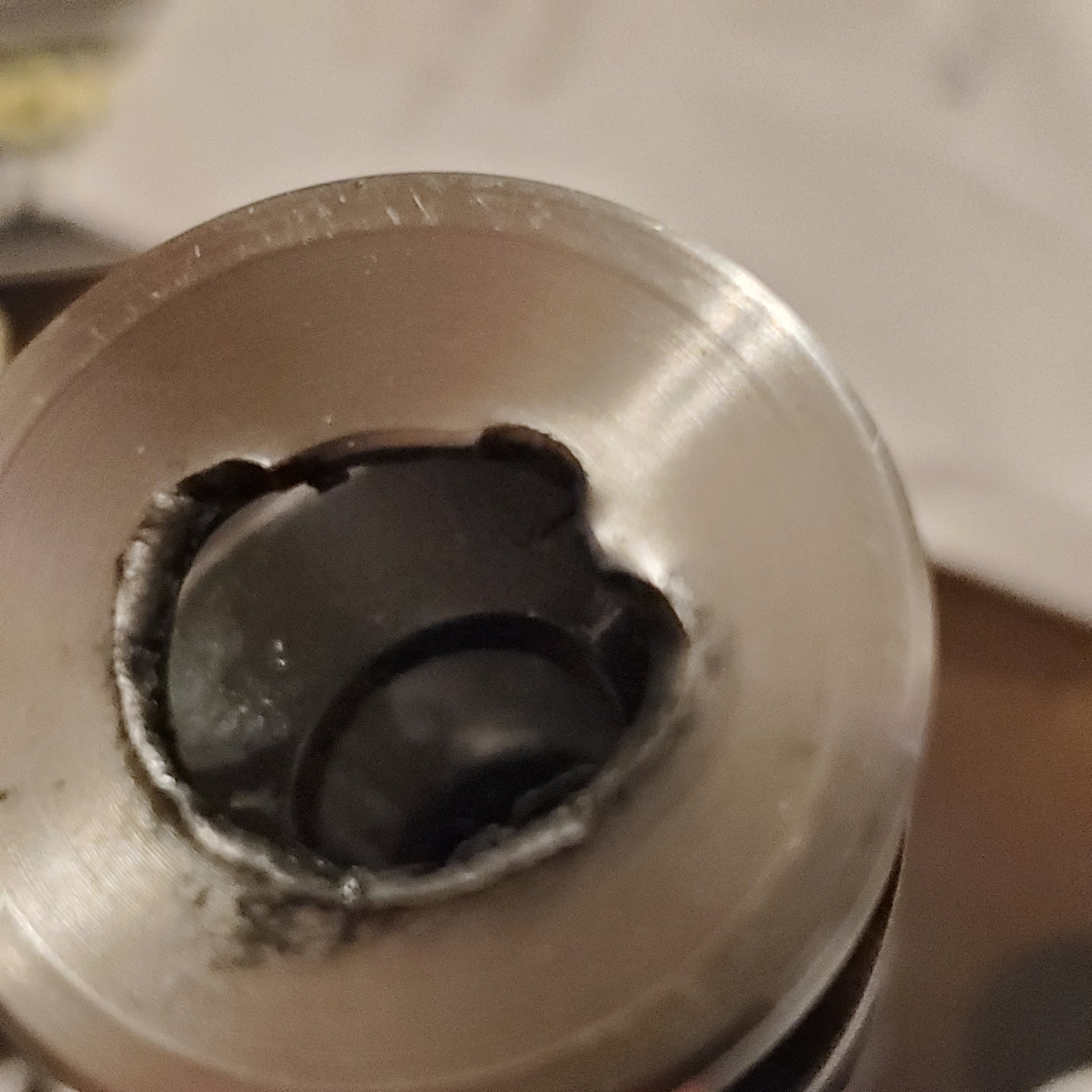

    plus one can not run lead bullets and Maker 350 gr past 1000 fps and be safe with muzzle devices.
    Yes I've run the, 230 gr eldx, 250, 225, 200, Speer, 160 Barnes, 300 gr SMK and Berger, and the 350 Maker.
    The 3 twist has damaged my magneto speed bayonet and muzzle brake in one shot...have nothing but disdain for the Faxon 3 twist...but didn't give up on the 8.6 BO ordered a 24" 338 6.5 twist and chambered it , for a Rem 700 reciever.
    I can go high velocity or subs with no fear of bullets coming apart ...with good accuracy.
    My load data for supers is way over max in my Faxon 16" 3 twist. Example the 350 gr copper Maker is 1000 fps to 1050 max. velocity according to the manufacturer in the 8.6, but i run tbem at 1700 fps in the 6.5 twist, or 1100 fps.
    My opinion if one chooses the 8.6 Blackout
    get the 6.5 twist barrel it is dual purpose like the 300 BO, and not so limited and inaccurate as the 3 twist.
    Some load development with the 6.5 twist with 100 yd accuracy.
