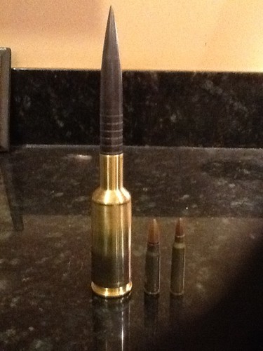

When I saw it, I just thought maybe... if bartlein soon makes 3" thick barrels and BAT 3" thick actions. lol 😂
Any thoughts on this? I have read that the cartridge push a 750 grain bullet over 4000 fps.

I always wondered what long range potential this round has. Seems like it would be pretty potent. Quality of brass would be the biggest issue I can think of.
Edit: I was thinking of the 14.5x114mm round. I didn't realize someone was necking it down to 12.7mm.
It is a waste of time cartridge was never designed as a precision cartridge just for slinging lead very poor standard deviations and low pressure cases that when pushed to the limits will cause function issues when reloaded. The the sop cartridge was proven as a failure so will this.

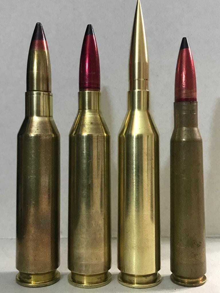

That’s a realllly big 6BR lol
Neck is entirely too long. A lot of missed opportunity for additional case volume having the same cartridge AOL. Bullet will never stabilize properly way more than 6 calibers in length bearing surface is way too long and for every groove cut in that bullet you're losing massive ballistic coefficient the whole thing is backward thinking backward technology. All just to have a really fat cartridge. if a guy had a desire to have some insane sectional density. Should have just went with a bigger caliber
yes the 14.9SOP was a failure and it's an ugly cartridge but it was based on 20mm shell. 12,7 x 144 is based on 14.5x144mm. i don't want talk about barrel life because all cartridges in thoses calibers are barrel burners.(375/50, 416/50, 458 goliath, 416 destoryer...) i can not belive that someone get a long barrel life with these cartridges. Everyone complains that the 14.5x144 wasn't designed for high pressure and precision. But it would be a real challenge to design a cartridge that is accurate, built for high pressure and fires a 750 grain bullet at 4000 fps. Yes, it will require a special action and improved case and maybe even a better barrel alloy and some other stuff.

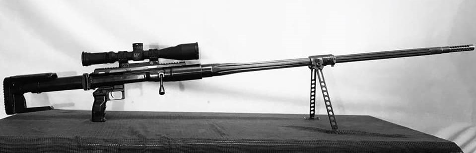

now back to 12.7x144. The 12.7x144 has over 400 grains powder capacity and even Ukraine managed to build a rifle capable of firing 12.7x144mm but i takes slow powder.
Ukraine rifle and ammo and one thing about the 50 bmg. It was never designed for precision but 50cal benchrest guys shoot 2 inch groups at 1000 yards.

Regarding the 12.7x114mm cartridge. It may need internal changes/modifications to the cartridge. It may need a new brass alloys, or the same alloy as the 420Blitzkrieg to operate at 90-100000 psi. It may need a speical action, hugh tenon und may even a 2.5" barrel.
(If I'm right, Bartlein even has 2.5" thick ammo test barrels) And yes, it probably needs some premium components and things I didn't even think of.

maybe it takes 50" barrel to get 4000fps.
I've even seen a 416Barrett with 50" barrel. By the way, the old 15.2x168 Steyr launches a sabot projectile at 4700 fps.

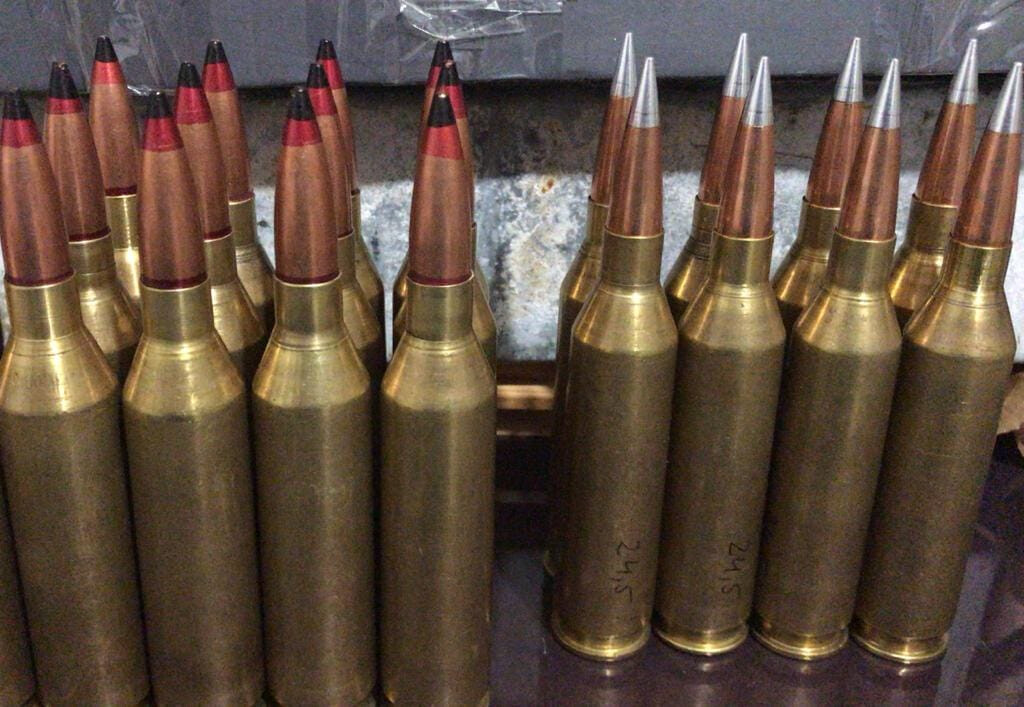

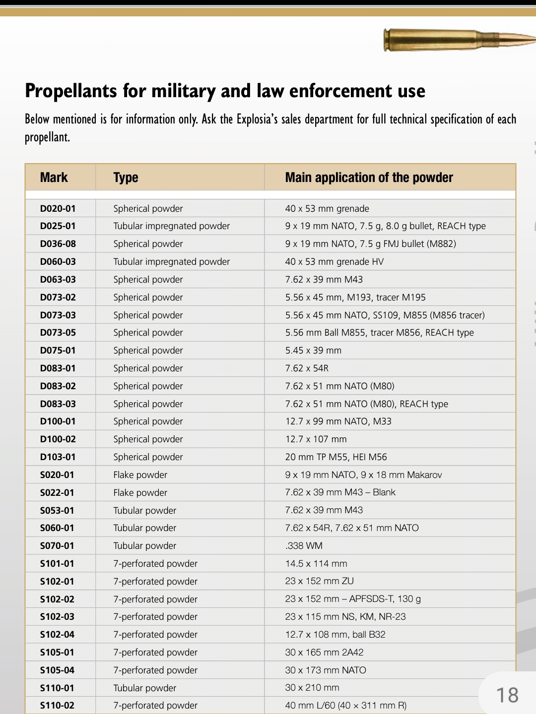

Very slow mil powders exist but getting enough powder in the case to make big MV numbers is an issue
That's the biggest issue of all, unfortunately. Not sure what to say. I saw the link and i read the posts, all.

the 20 mm case will not handle the pressure needed to push a bullet that heavy in a .510 bore. 4000 fps simple facts. i alread have build and design state of the art products and designs going backwords is not option for me. Hope the best on you sale. Good luck.
