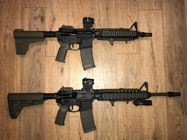

I have a pile of pic C4’s - love them. But if you want MLOK and FSB, can’t go wrong with this:
I know it’s not plastic, but you can’t go wrong here. I have two Noveske FSB builds I plan to use these on.
I personally like the pic C4’s best, but MLOK is the new hotness...
My travel “cheapies.” I plan to have the 16” Noveske FSB barrel chopped to 14.5” and P&W. They both have Black River Tactical inserts in the FSB to compensate for suppressor use, too.

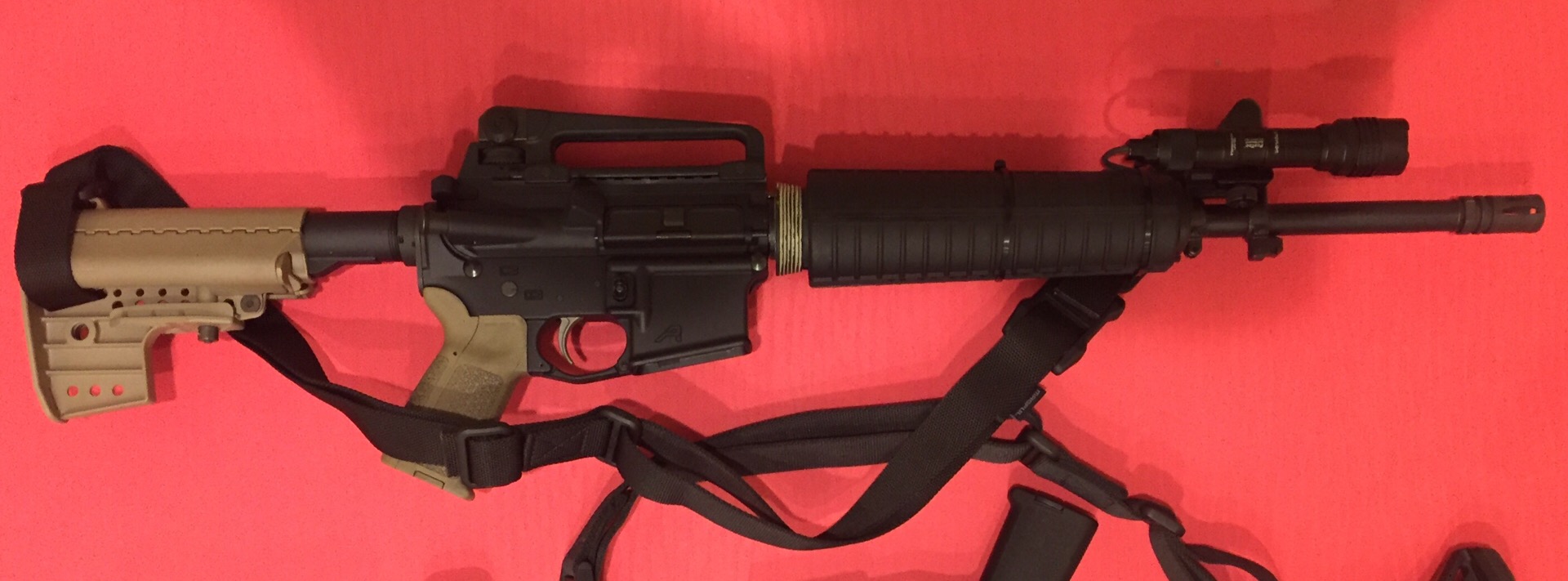

What made you choose a basic handguard instead of an aftermarket option? I like the colors
I tried a Larue 9.0, every flavor of Magpul, and the plain Jane handguards.
At the end of the day, the plain Jane’s won. The ribbing provides a lot more grip than I thought it would. The overall length puts my pressure switch in a very comfortable position. And even though I don’t have slots or rails, I mounted my pressure switch with double sided tape and zip ties and I’m not worried about it going anywhere.
