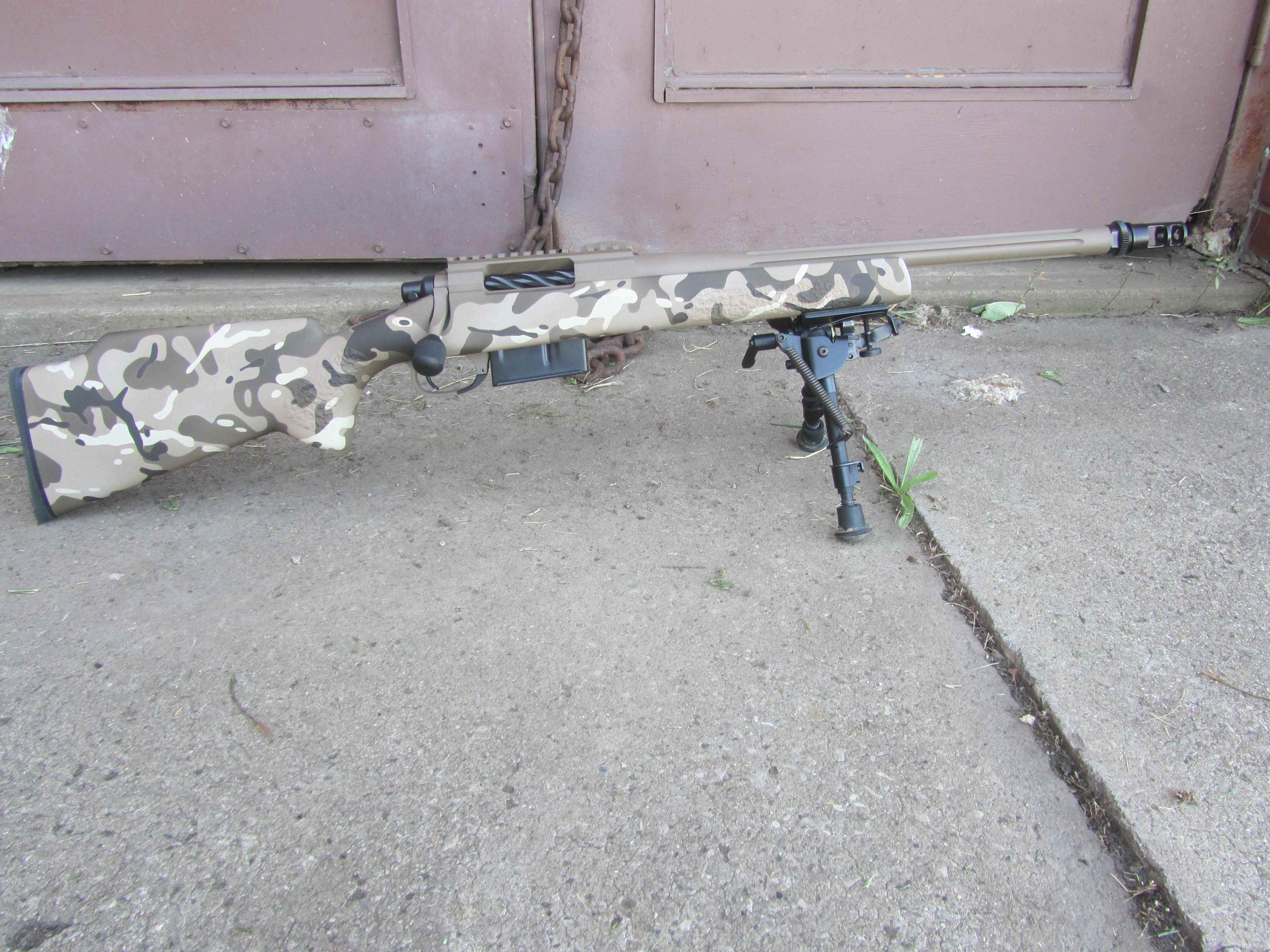

Got bored with the black, so figured the new Razor was a great excuse to tack on a cerakote job. Had FDE laying around so gave it a hit.

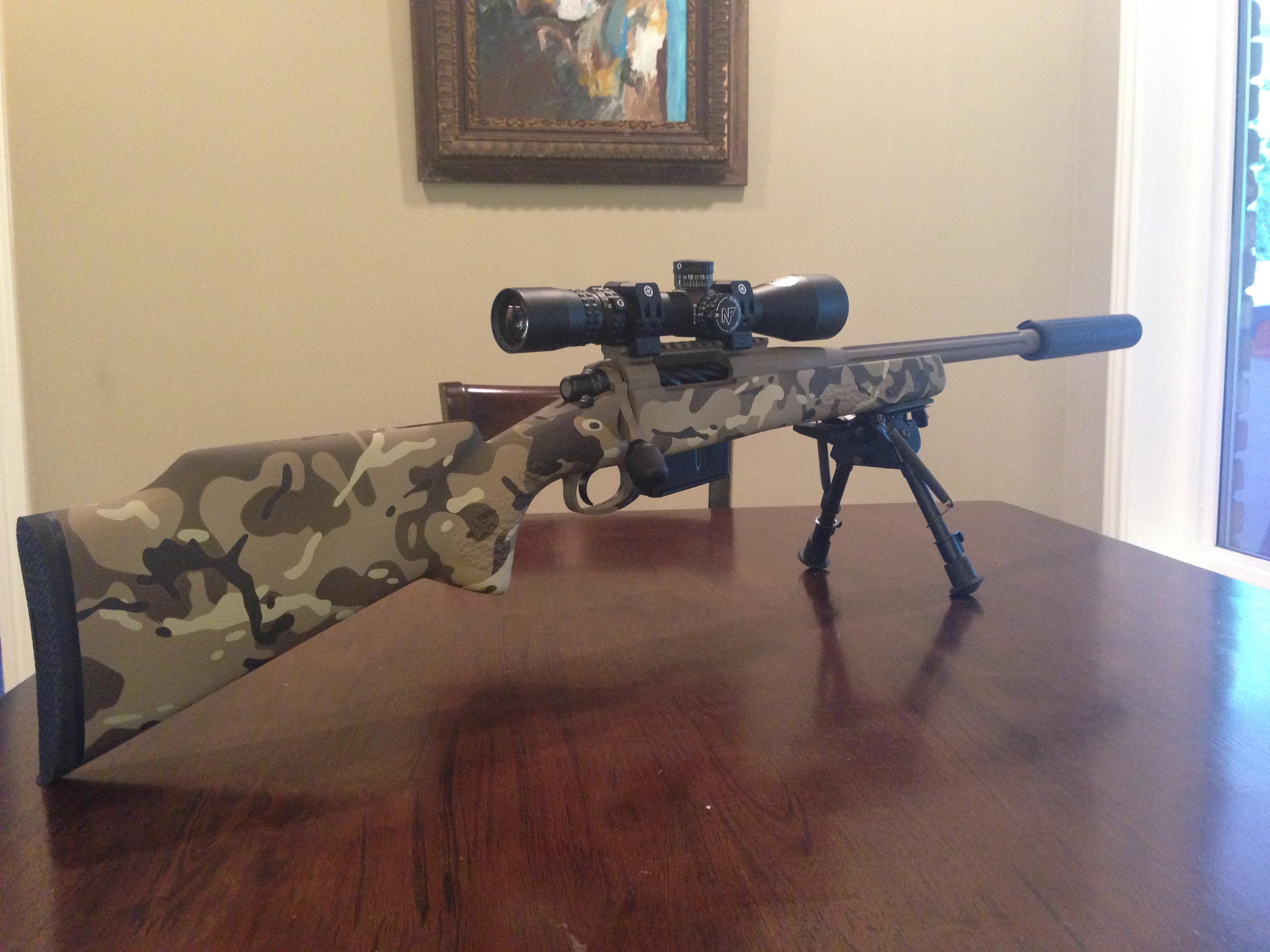

So many great guns here. This is the thread that first inspired me to build my first custom gun as a shorty so I wanted to finally contribute to the thread. Arrived last week but I haven't shot it yet. The gun was built by Mark at SAC and of course he and his team were great to work with and patient with my many questions. Stats are as follows:
Short Action Customs Alpha 11 action in short action
Bartlein barrel, 5R, 1 in 10 twist (I think), cut and threaded at 16.5 inches with AAC 51t brake installed
Chambered in 308
Barrel straight fluted and bolt spiral fluted by Kampfield
Bolt and action melonited
APA DBM bottom metal
Timney 510 set to 2.5 lbs
All metal cerakoted in Magpul FDE with black accents
Manners EH4 stock painted in "SAC multicam" by Branden at Custom Gun Coatings
Nightforce 2.5-10x42 compact NXS with MOAR reticle
American Rifle Co M10 rings, 30mm extra low (20mm) height
Can in the pic is an AAC762SDn6
Hope to get out and shoot this weekend. Cannot explain how pleased I am with how the gun turned out though. Hope I got the picture posting right.

Only the metal was cerakoted on this rifle. All the metal was done in armorer black. The bolt handle and shroud was bead blasted, bolt body was polished, and the whole bolt assembly was ion bonded. The bolt handle, shroud, barreled action, and bottom metal were then cerakoted. The stock is Manners elite carbon fiber eh-1 Black Forest. Yes, they will cerakote almost anything.
