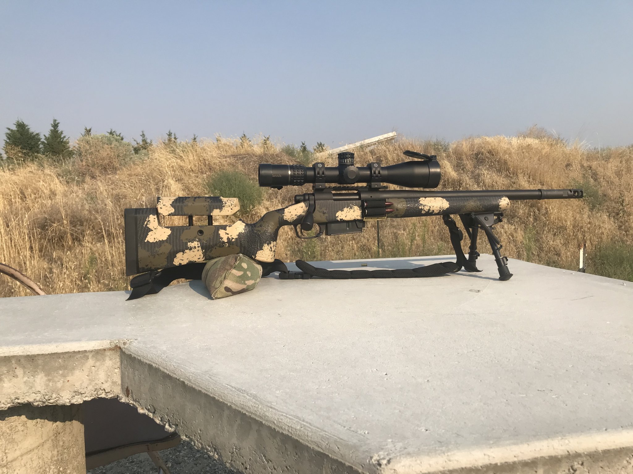

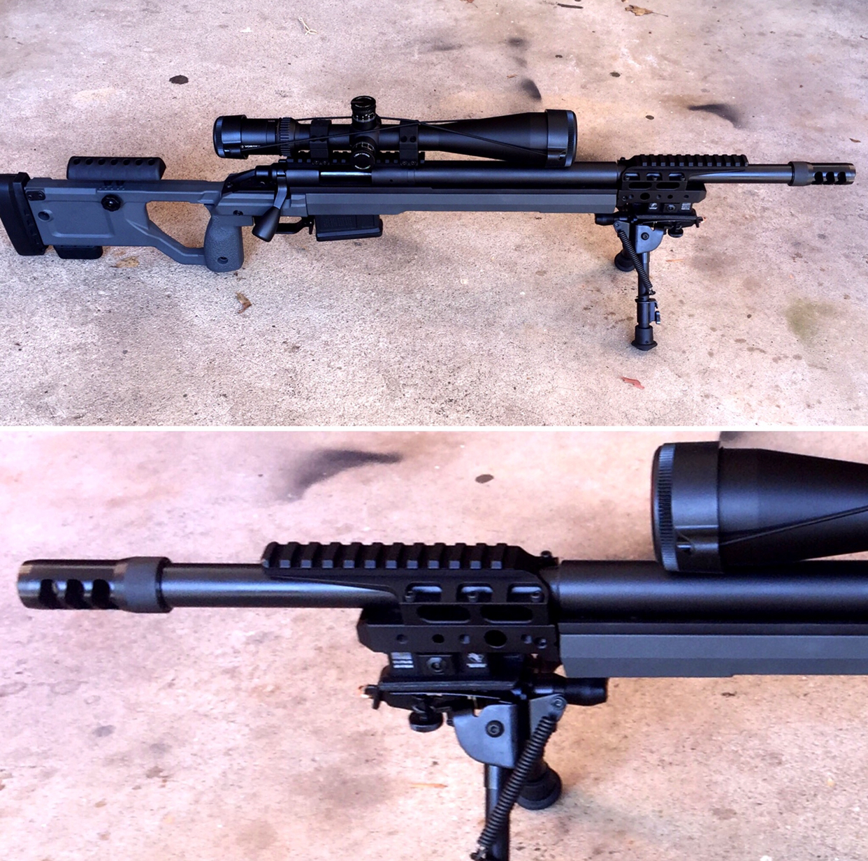

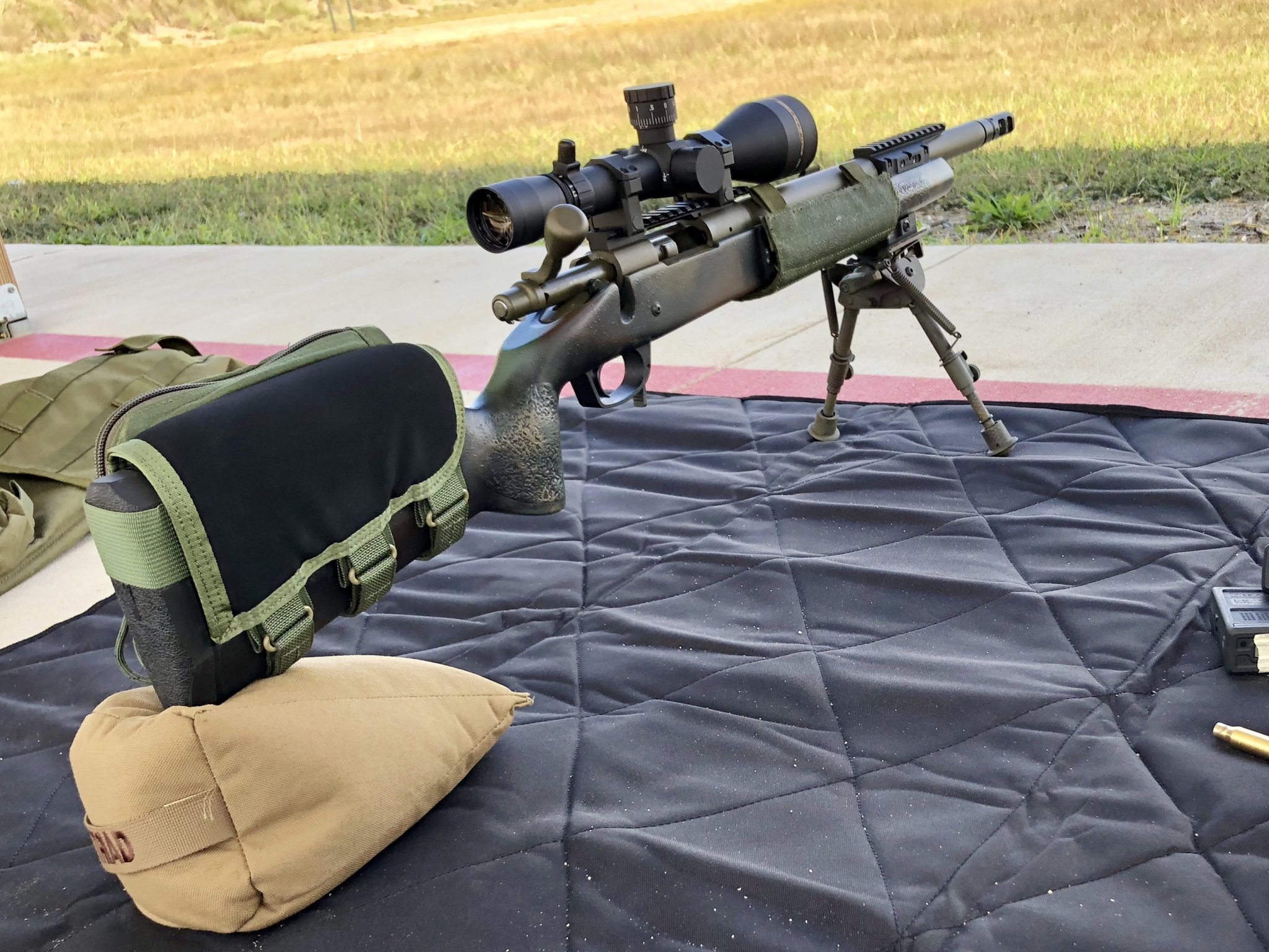

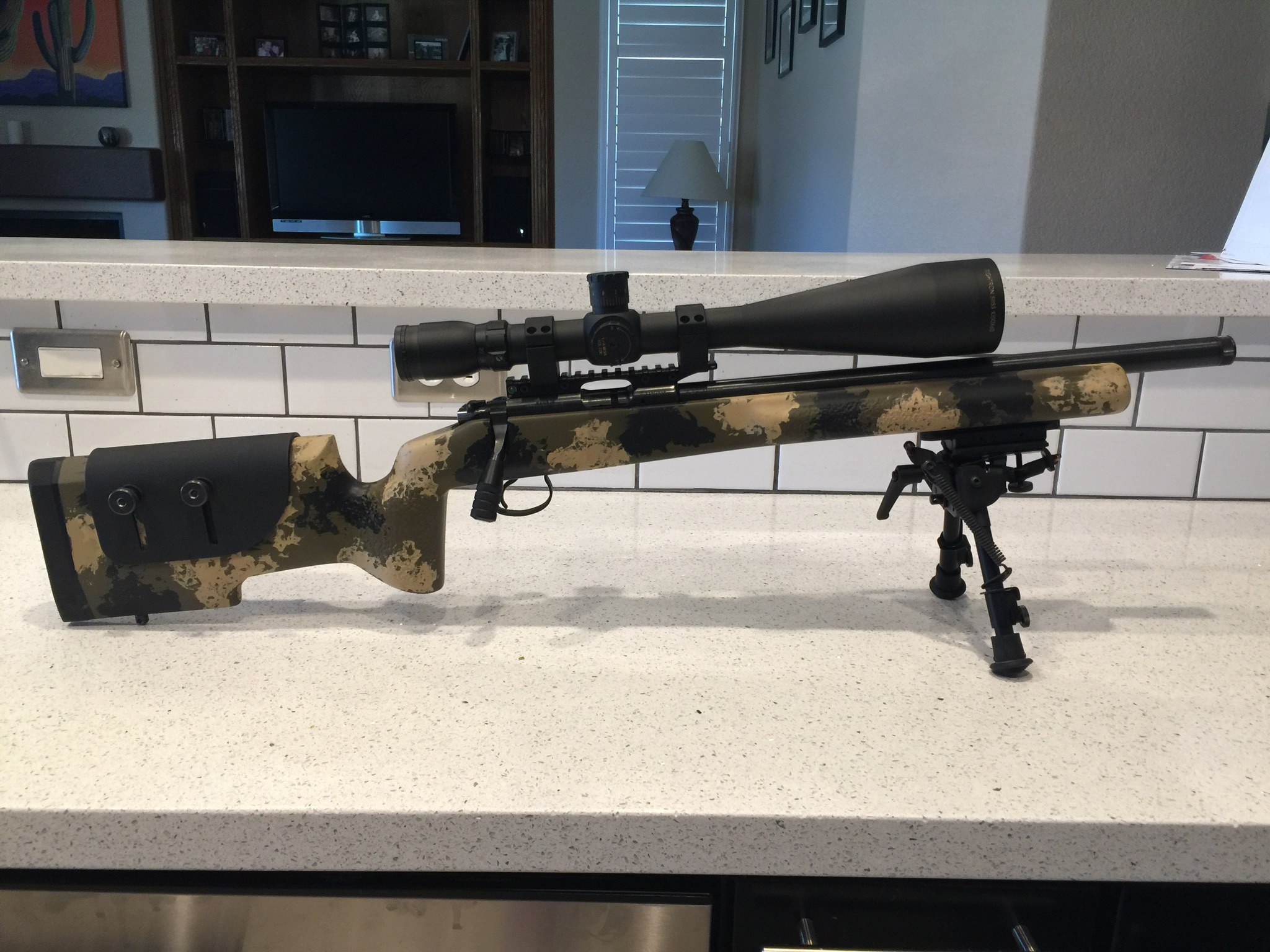

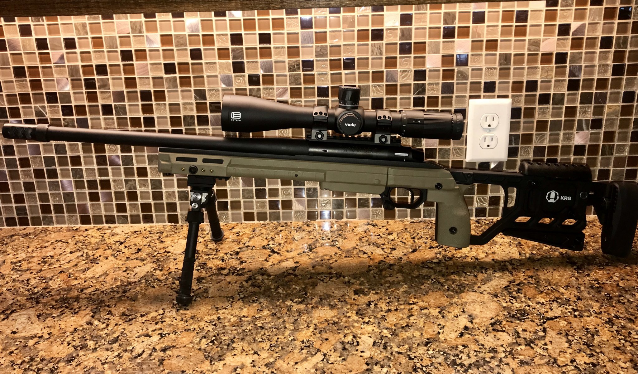

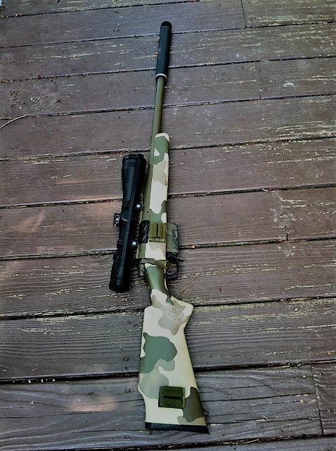

Here are a few of my 16" and 18" rifles. I have not shot the DT yet but this week I will be.
REM 700 308 Manner TA rifle stock Nightorce F1 and a Silencerco Omega.
REM 700 Bartlein Barrels 18" with a USO ST10 10x.
DT SRSA1 COVERT Rifle .308WIN 16", Premier Heritage 3-15x50mm, and Silencerco Omega.

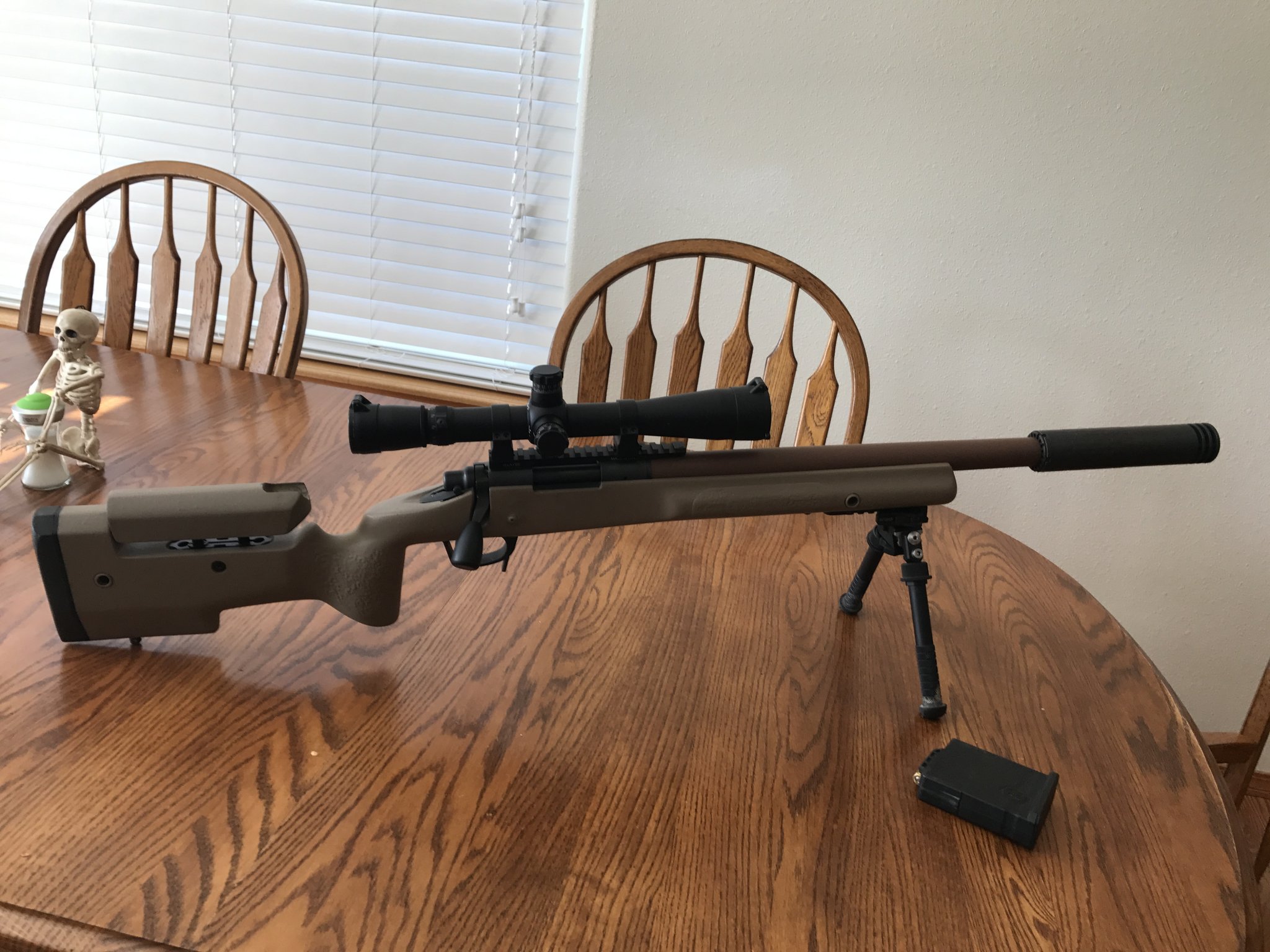

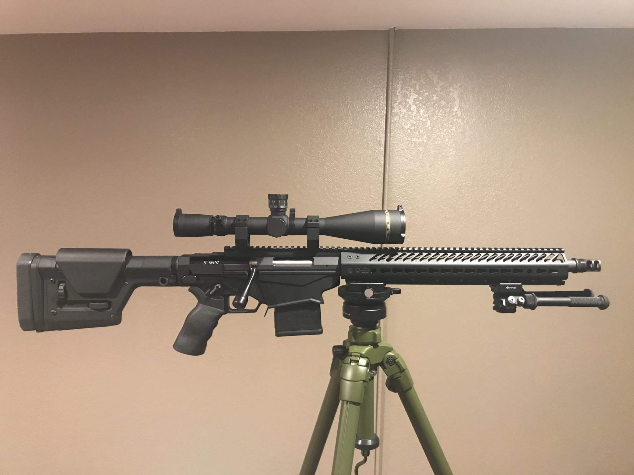

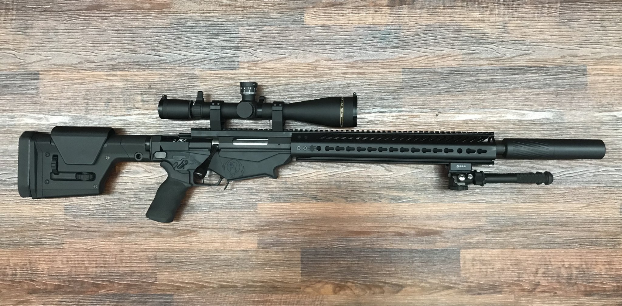

Beautiful!
is that a 18” barrel? What are all the specs on your rifle.
16.5". Only shot it a few times off a bench with factory Prime and Copper Creek ammo, and it does well. I've not worked up a load, and my groups are easy sub moa. I could probably do better but I'm only using a 9x scope. With a Ti can, this thing is still quite portable. Check weld is okay, but I recommend trying this stock for anything you'll spend much time behind.

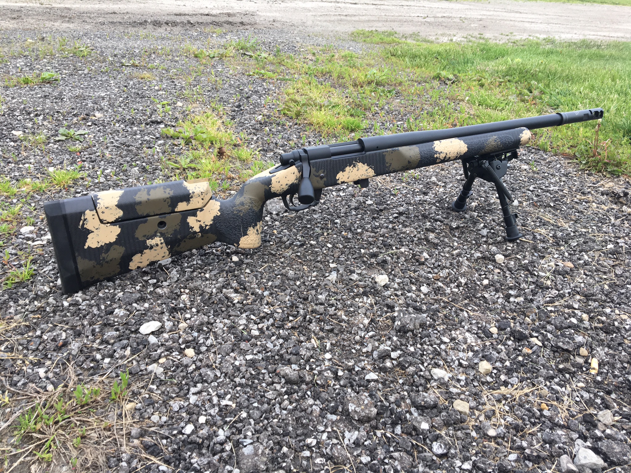

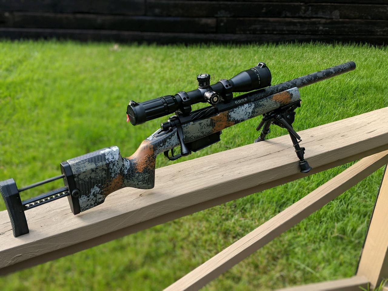

This is my hunting rifle this year. Specs below, it also feeds the factory ammo out of the pmags well, to save a few more ounces.
RIFLE SPECS:
  • Action: Defiance Machine Deviant GA Hunter
  • Stock: Manner Composite Stocks Compact Stock Elite
  • Barrel: PROOF Research Carbon Fiber 16.5" 6.5 cm
  • Trigger: TriggerTech Remington 700 Special
  • Bottom Metal: Hawkins Precision M5

What does the bare rifle weigh? Thinking of doing something very similar, but probably in 308win for a truck/deer gun.
