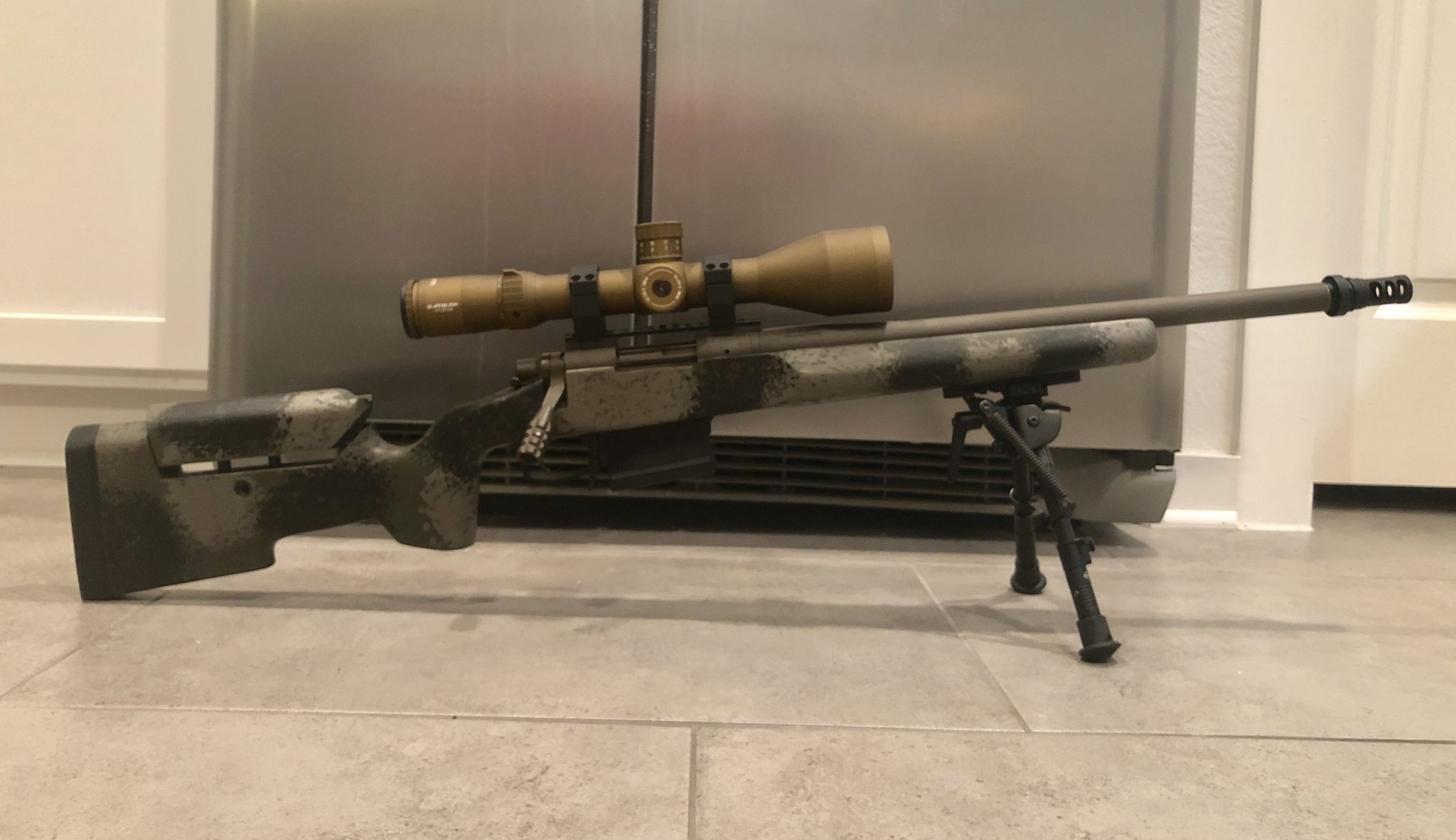

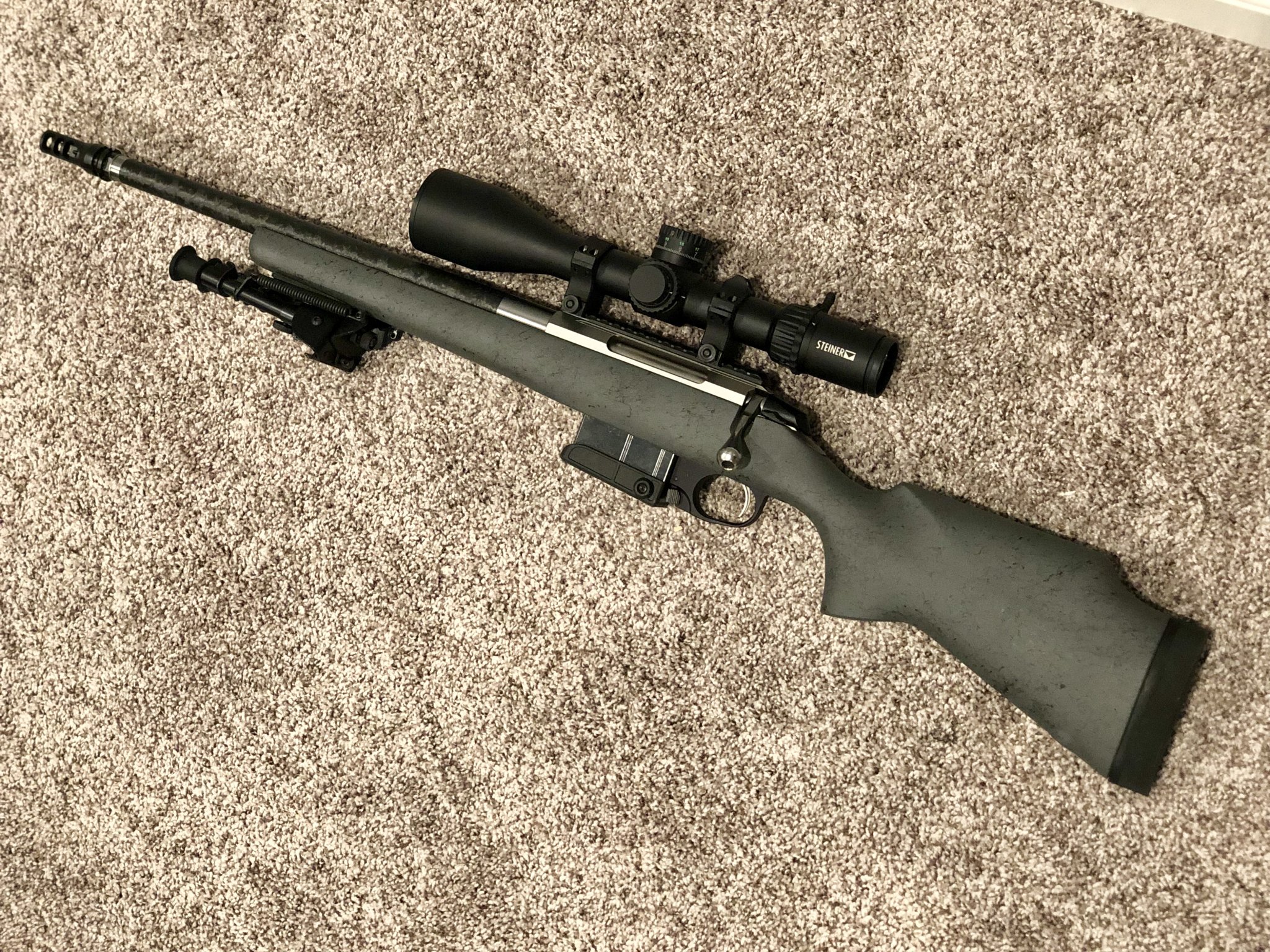

Here’s my shorty rifle. Tikka T3 stainless lefty action with Carbon Six 17” 6.5CM barrel in a Grayboe Terrain stock with CTR bottom metal. Steiner P4X 4-16 scope. Dead Air brake for use with Sandman-S.
I’m getting 2720 FPS shooting Federal 130 grain Bergers (suppressed) and 2560 FPS shooting Hornady American Gunner 140 grain (suppressed).
I’m really happy with this short fast handling setup.

Like that setup. When did you purchase the Terrain? Grayboe said they’d be available again for Tikkas soon months ago but every time I’ve checked their site it looks like terrains only for Rem 700.

Is that one of their prefits, if so, what contour and how does it shoot?
Yes, it is one of their shouldered prefits. Sendero profile. Torqued it into my action, checked headspace, and I was in business.
I haven’t shoot it a whole lot yet (<50 rounds). But it’s grouped ~0.50-0.75 MOA for me so far with those noted factory loads.

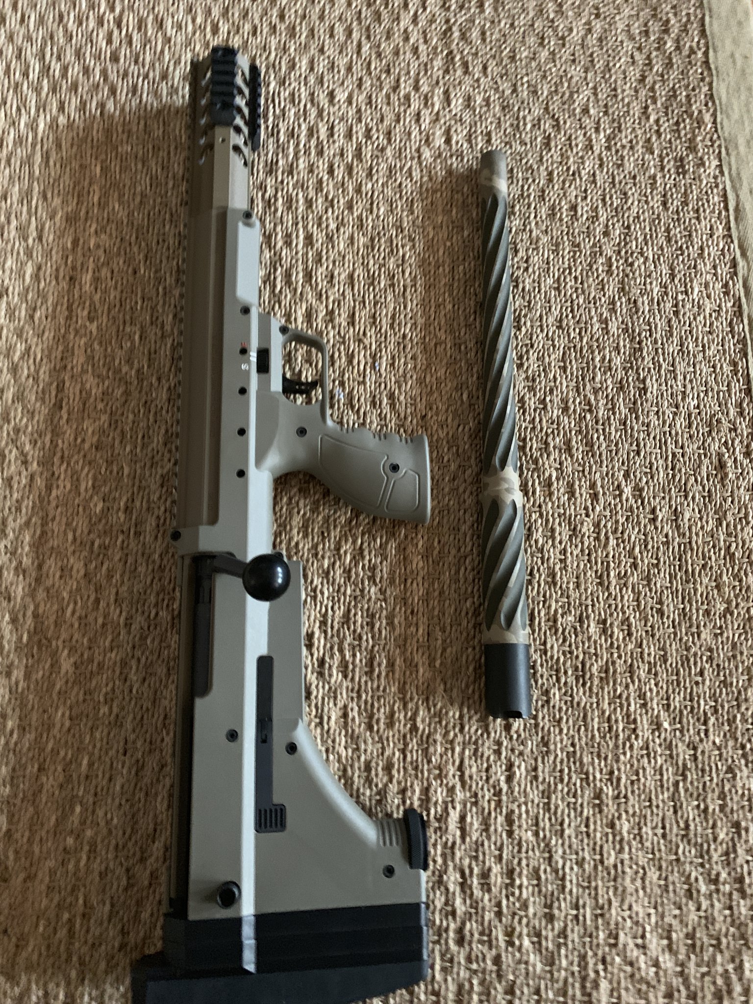

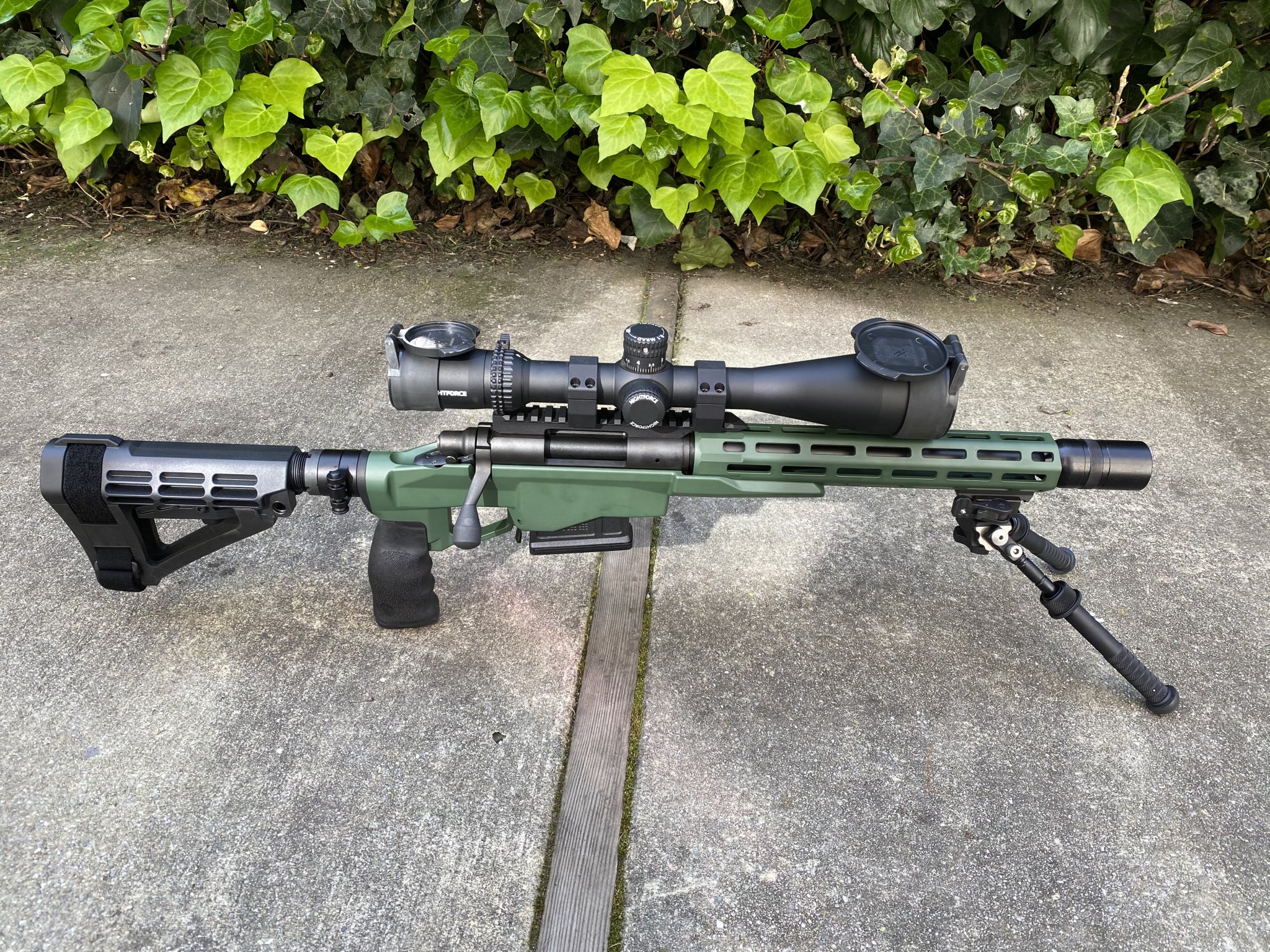

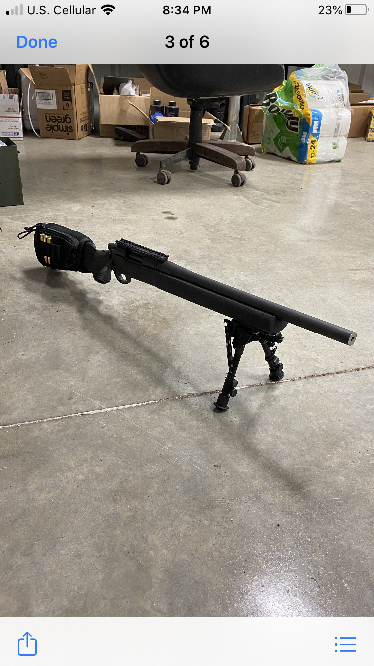

Here’s one I’ve thrown together still waiting on some headspace gauges so I haven’t shot it yet. Got thebarrel from a member on here it’s an 18” chambered in 22 creedmoor on a trued 700 in a manners t4a, should be pretty fun still need to get some glass for it. It will be ran suppressed mainly.

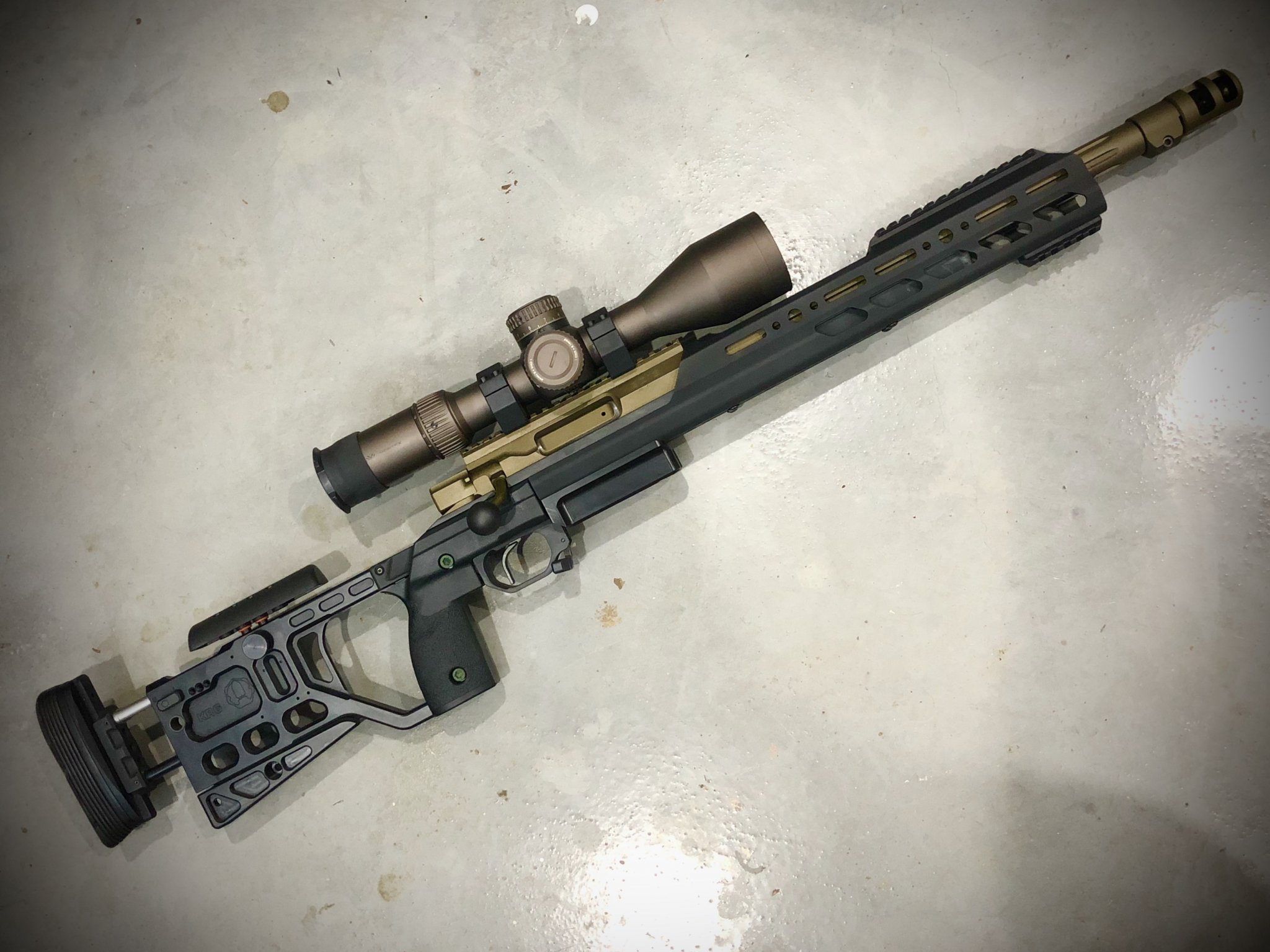

Nice rifle. Curious about the action though. Do you have any other custom actions that you can compare to? Definitely considering the 2013.
As far as own, I only have a pair of the old Ultimatum U300s to compare to (along with Tikkas and Rems etc), but I’ve shot Stillers, Pierce, etc actions.
The bolt lift may me sliiiightly heavier, but nothing like people like to imply. I used a trigger gauge to measure bolt lift weight between my rifles and it was marginal even between my Tikka and the Badger. Overall, it feels awesome, locks up like a damn vault, and generally just feels so much more robust than most others I’ve shot.
If I didn’t care about R700 stock/chassis interchangeability Id buy another in a heartbeat.

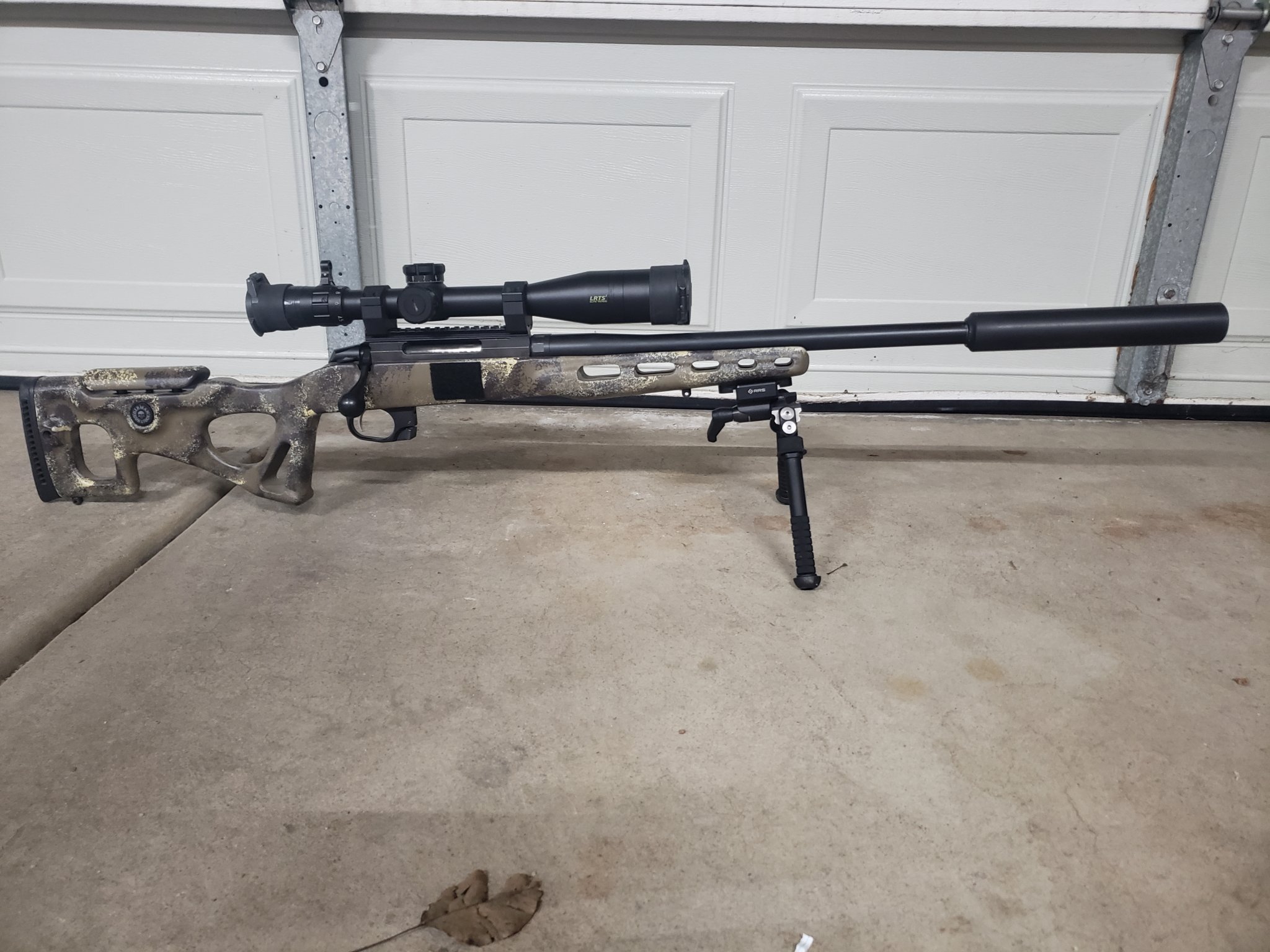

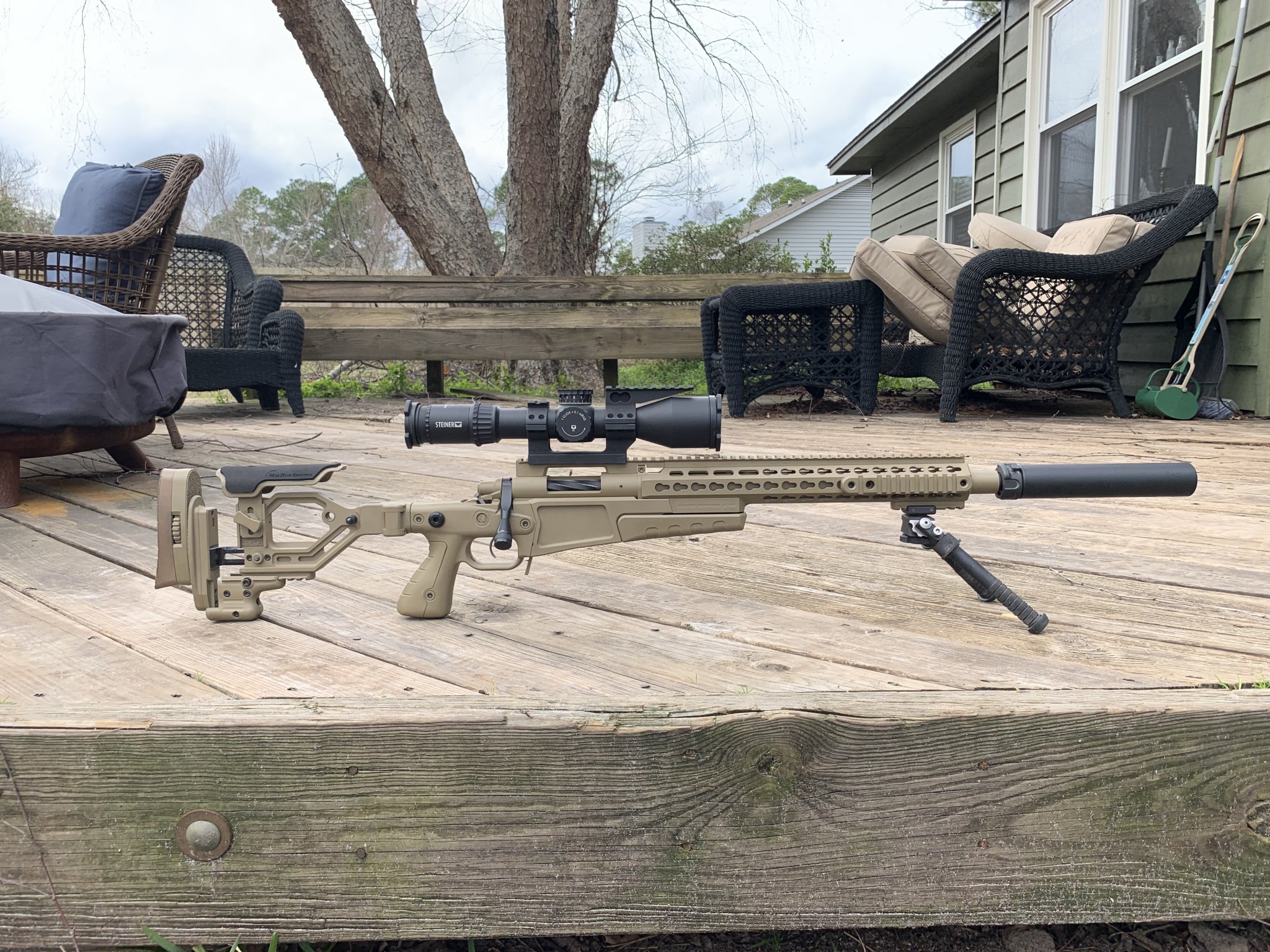

Cut down my 23.5" medium palma to 18". Went from 2830 fps to 2729 with 143 ELDX and 2815 to 2737 with 140 ELDM hand loads. Getting 2756 with older factory Prime 130s, 10 fps faster than the 20" CTR barrel that I used deer hunting. All shot with the TBAC 30P-1 that is in the pictures. German Gun Stock Ranger and Bushnell LRSTi 4.5-18

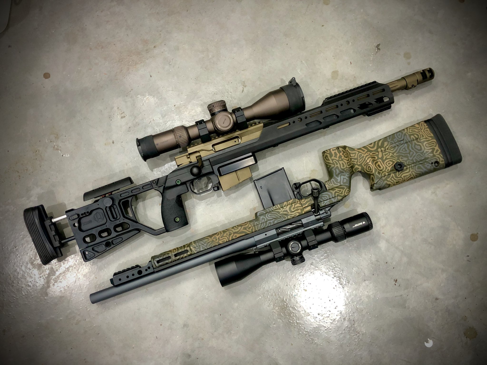

On topic, here are my two KRG shorties in the one pic. 17” 308 M2013 and 16” 223AI oh the U300.
