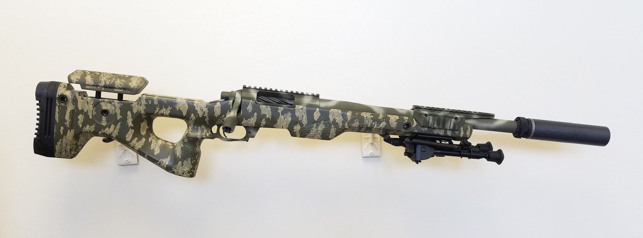

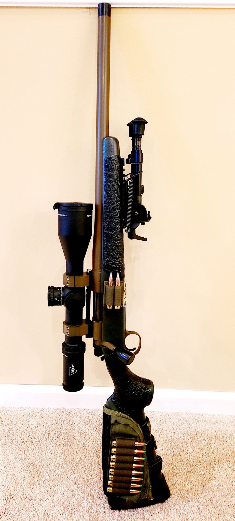

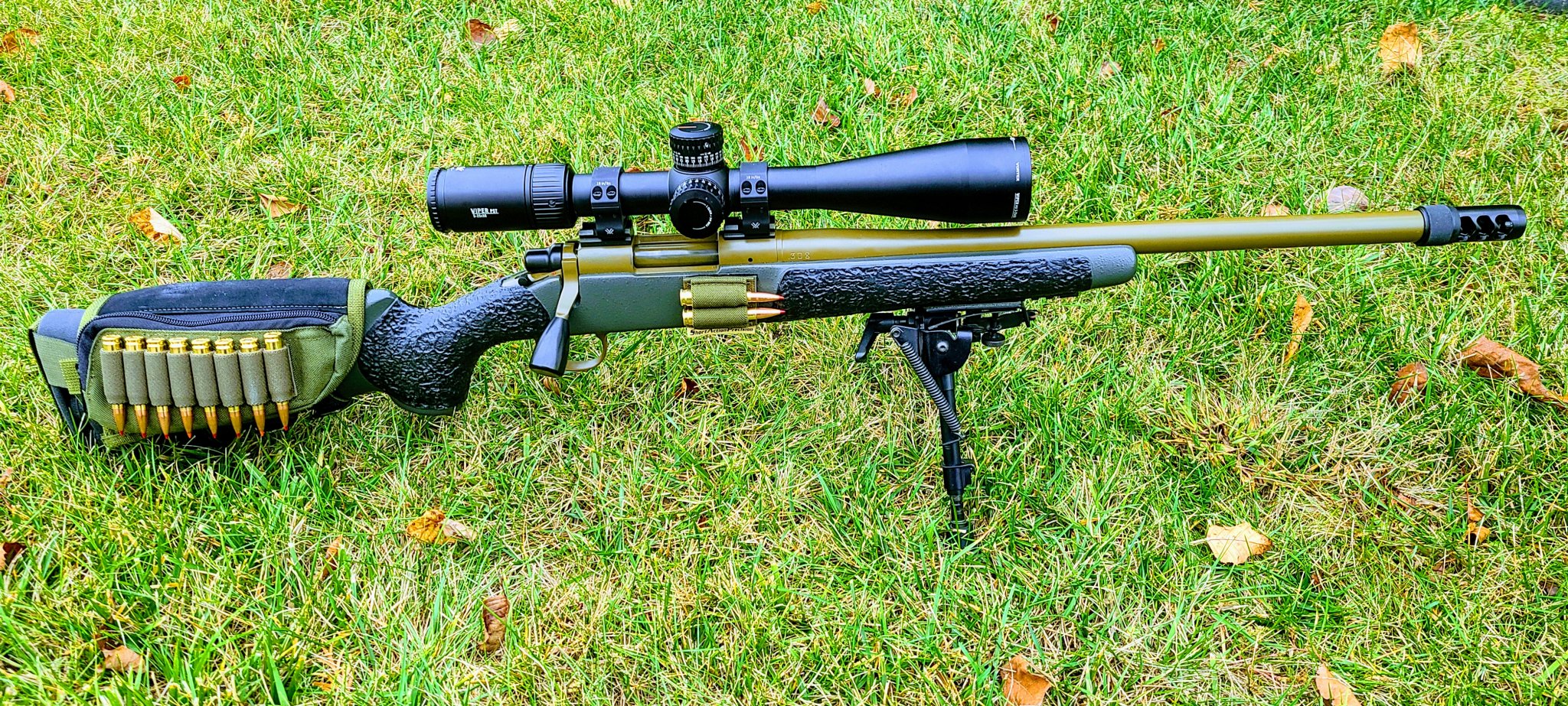

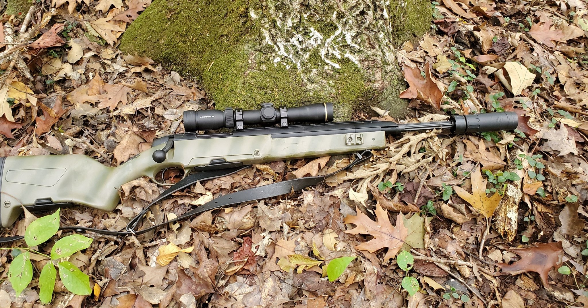

Steyr scout cut to 16", Rugged Micro 30 can and lots of modifications to the stock.

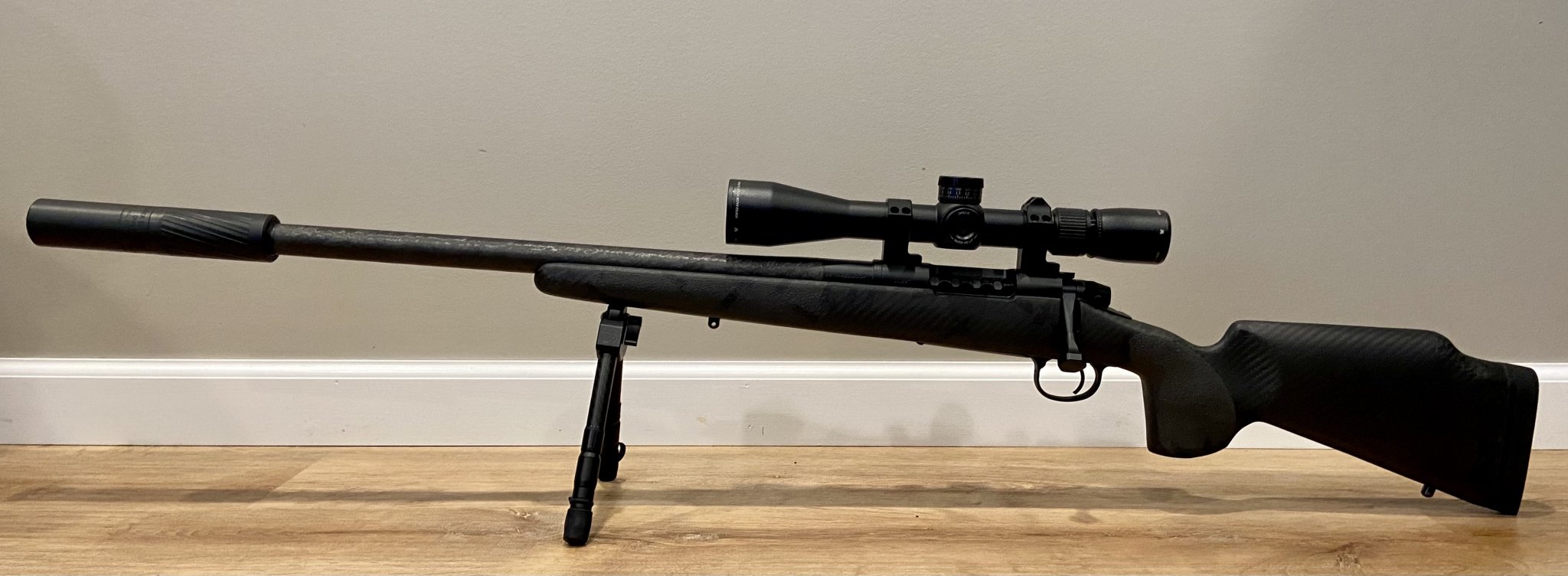

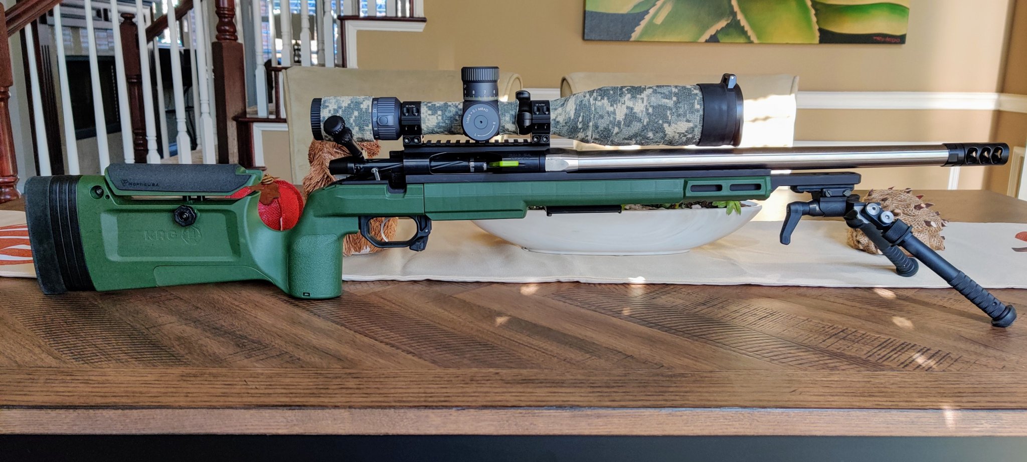

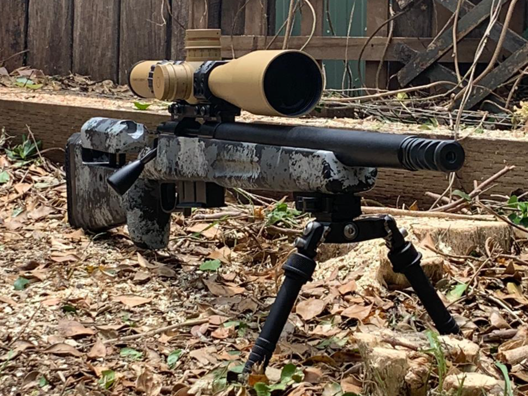

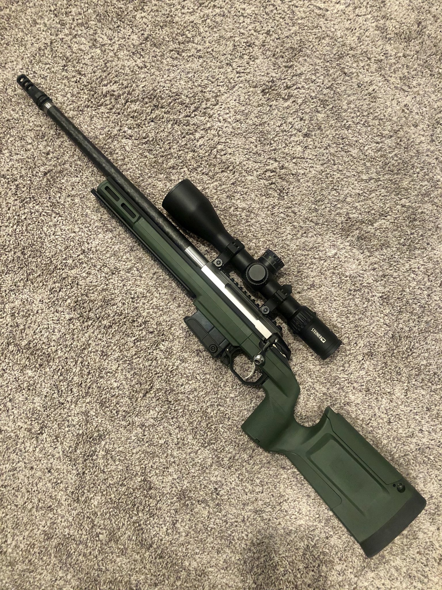

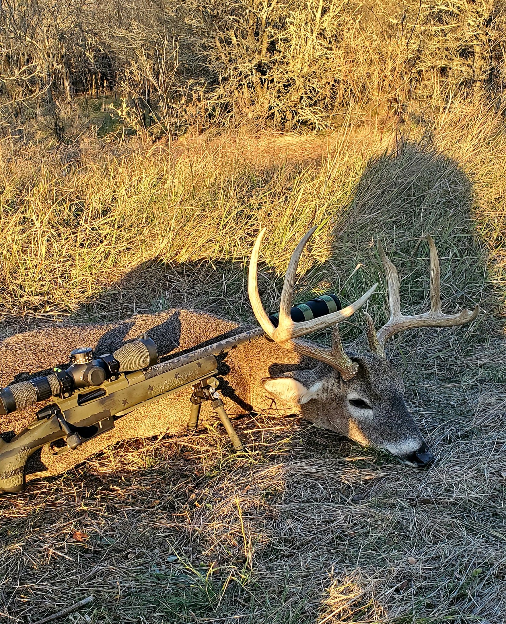

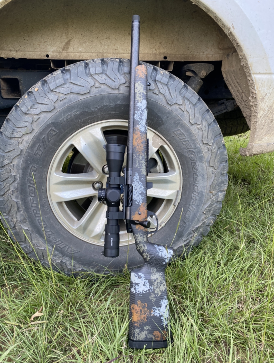

Are 20-inchers allowed to play? This is my latest build for backpack hunts on deer-sized game...
6.5" CM built on a Mesa Precision Summit Ti. Running 124 Hammer Hunters at 2900fps. Right at 8lbs total, scoped and suppressed with the Ultra 7.
I don't know if I'd call it a shorty but I love it ! 🤩👍
It's 8lbs, scoped, suppressed and bipod?

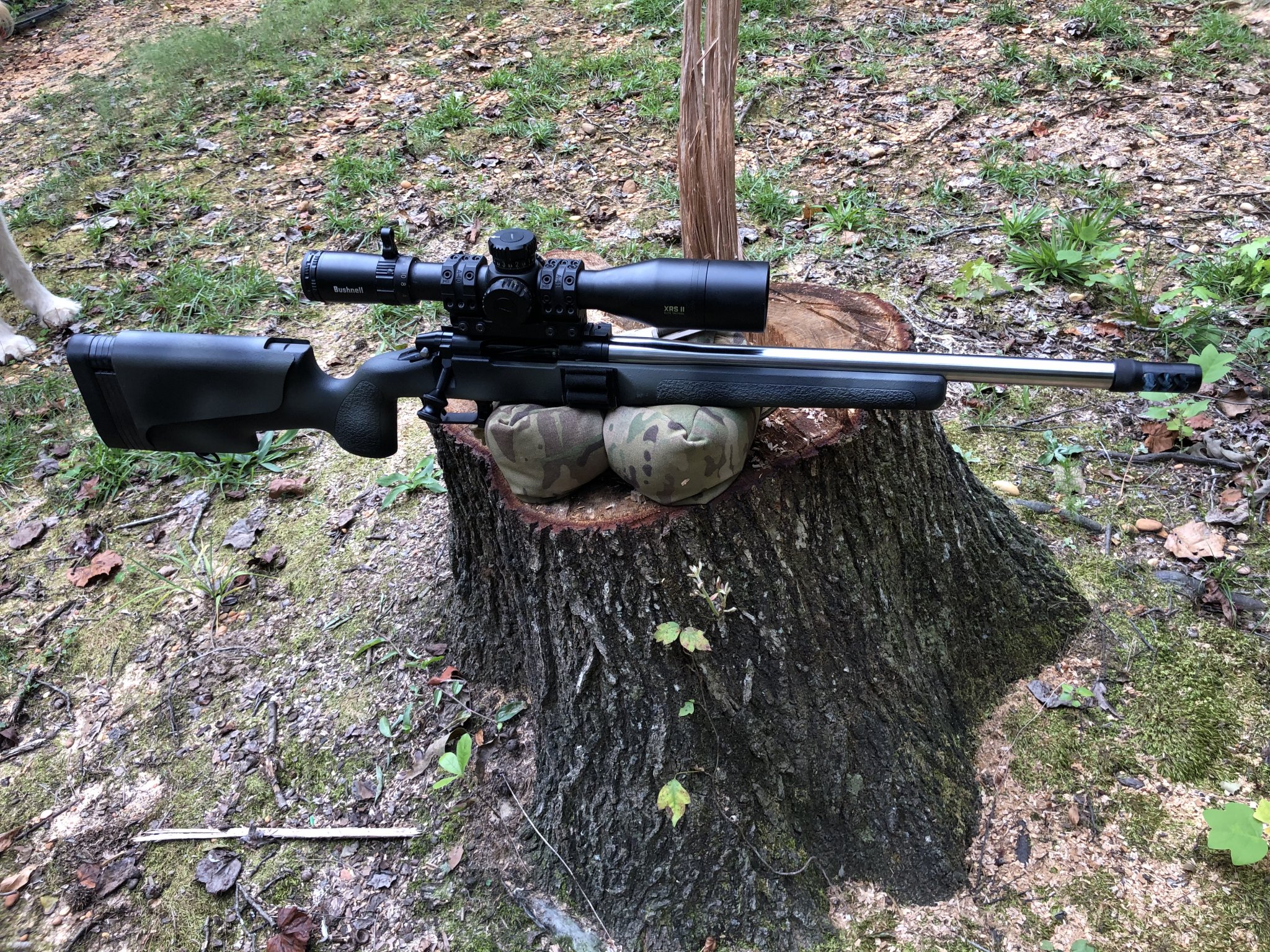

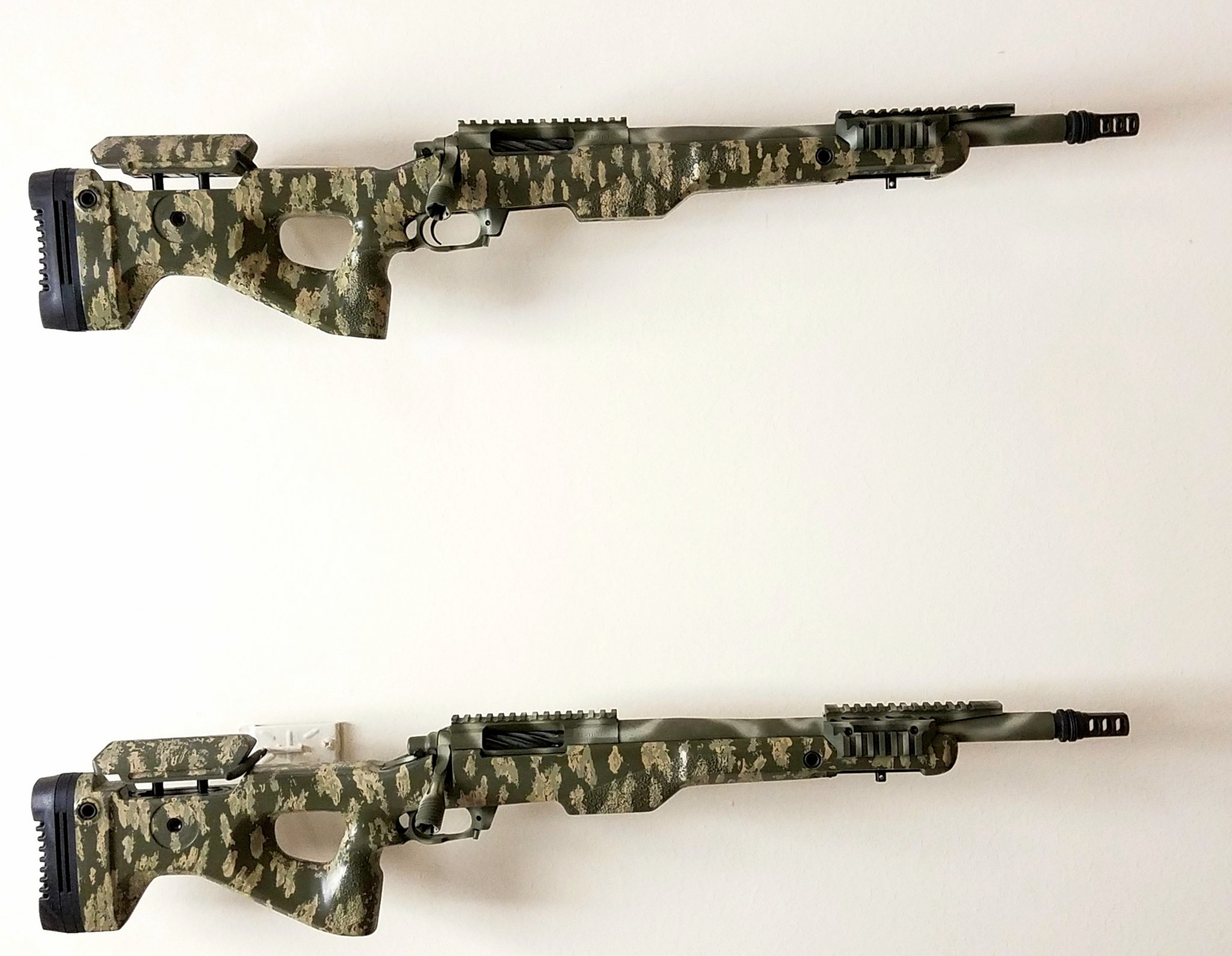

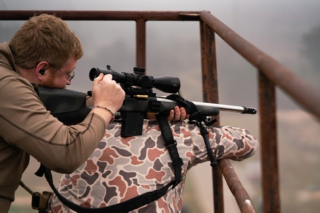

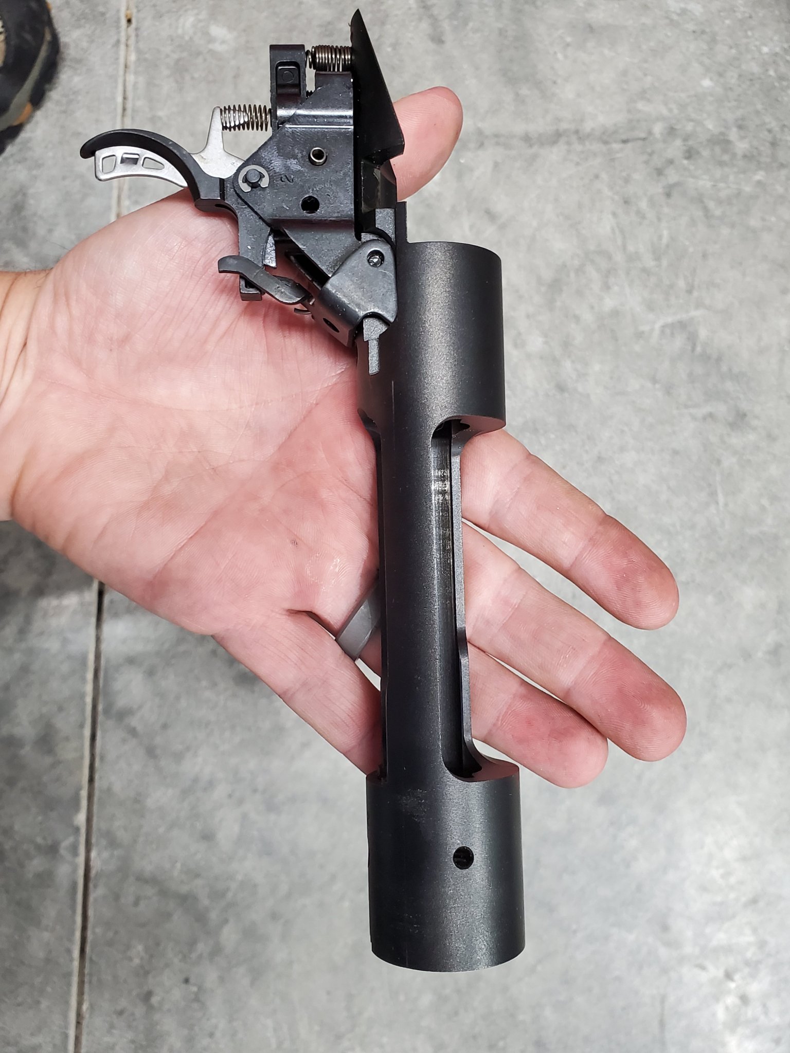

Here are some pictures and information on the chassis, if you want any particular angles or views let me know.
Follow Up Short Barrel 6.5mm Rifle | Sin City Precision
Mirage ULR prototype chassis | Sin City Precision
Are you interested in selling this Mirage Chassis?

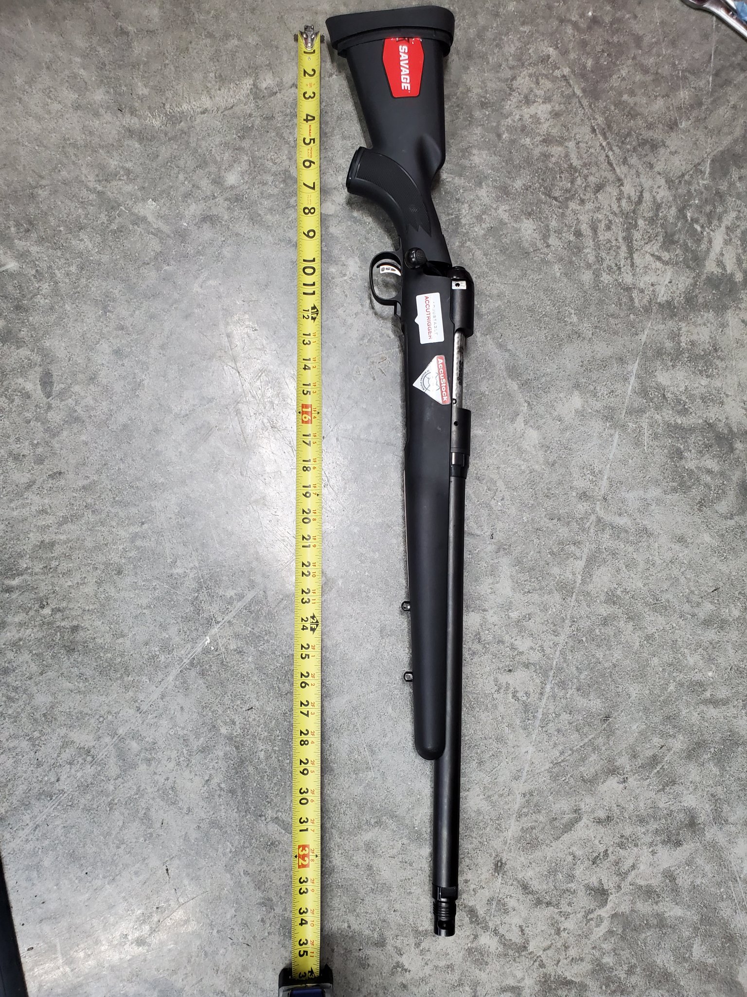

I'll be posting a pic soon of my project for my son's hunting rig.
It's a barrel I had cut from 24 inches to 16.5 in 6.5CM. With the season about to open I will be running factory Hornady American Whitetail (wish I still had some leftover 129 SST.) After that I am gonna work up some loads with some old 120 AMAX then 147 ELD-M with IMR 4451 behind both. There will be my 9 inch form 1 can hanging off the end and stock shortened up for his length of pull.

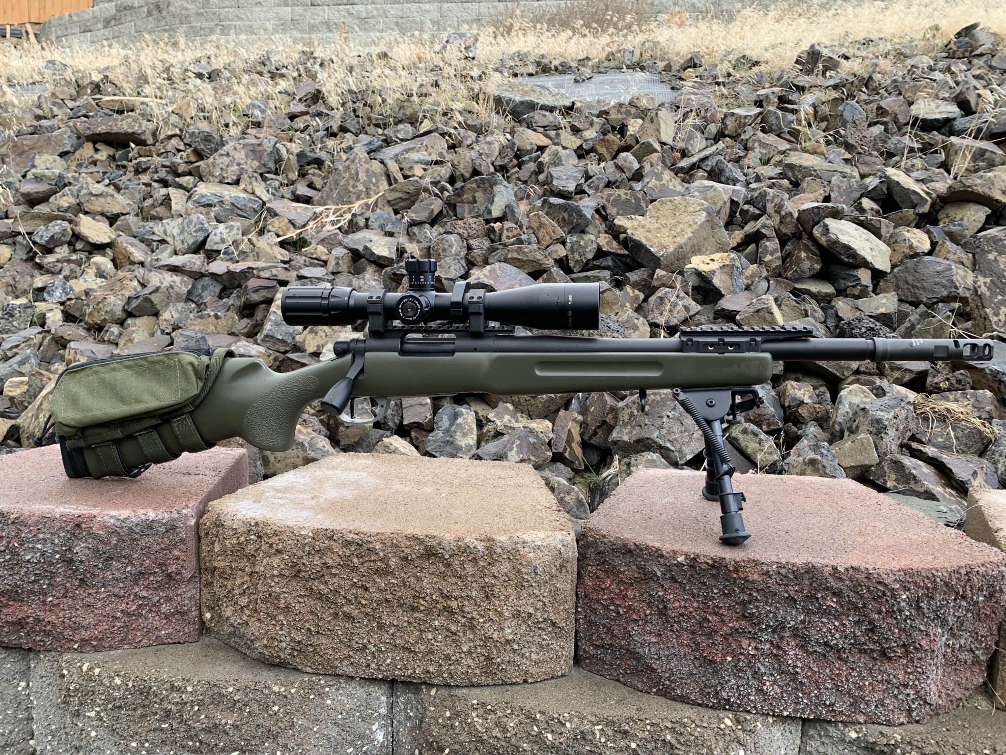

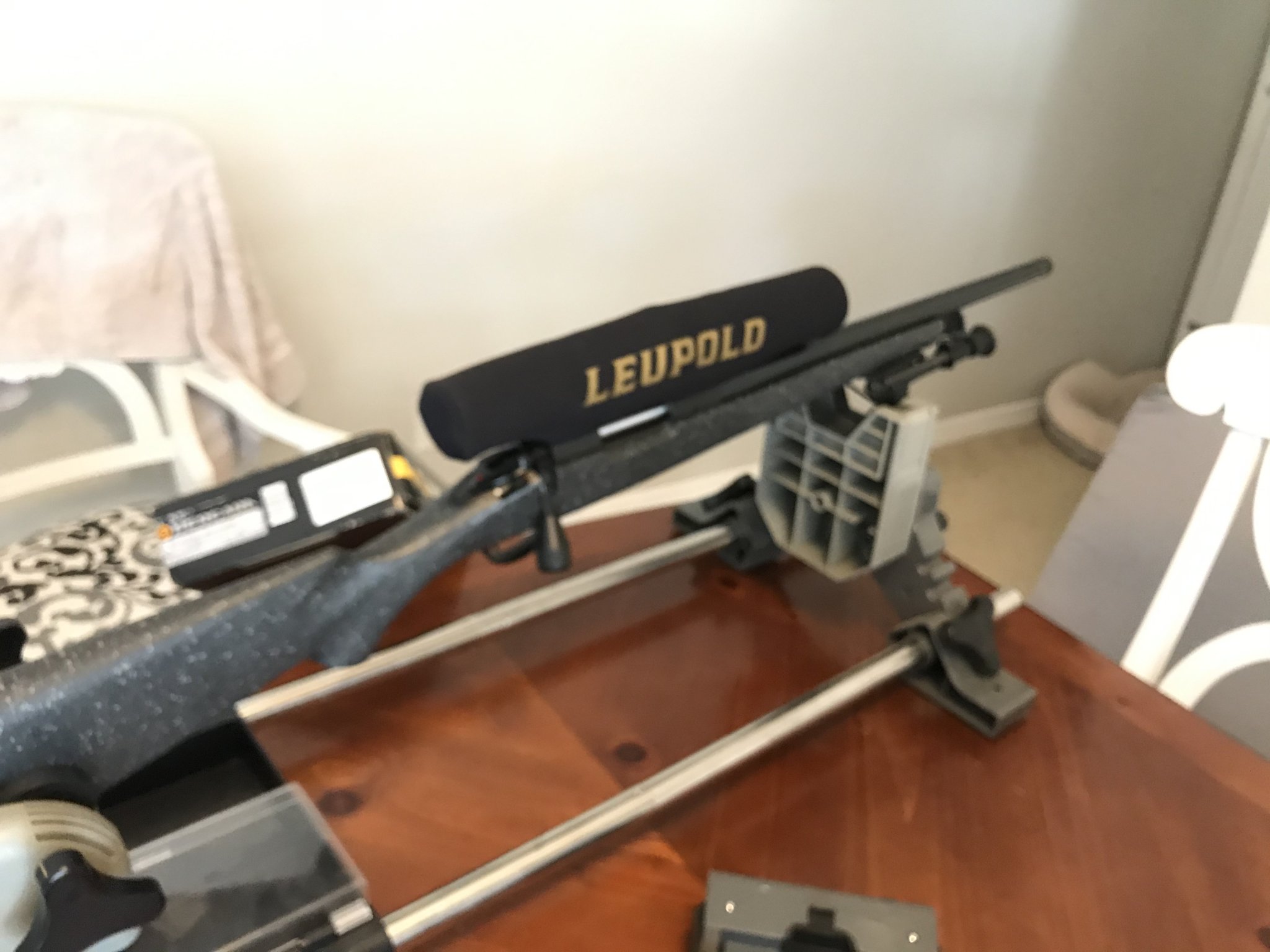

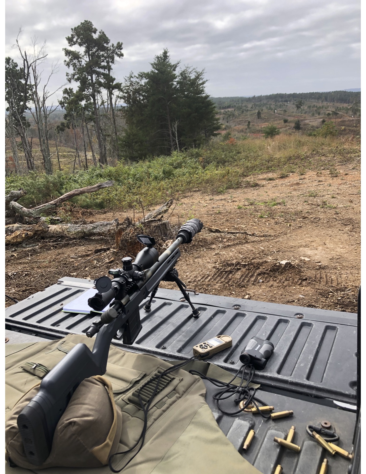

Here's how this morning was rolling after I disassembled factory rifle

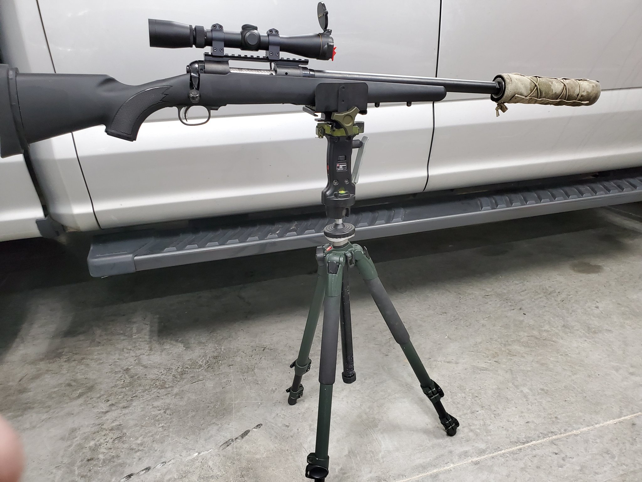

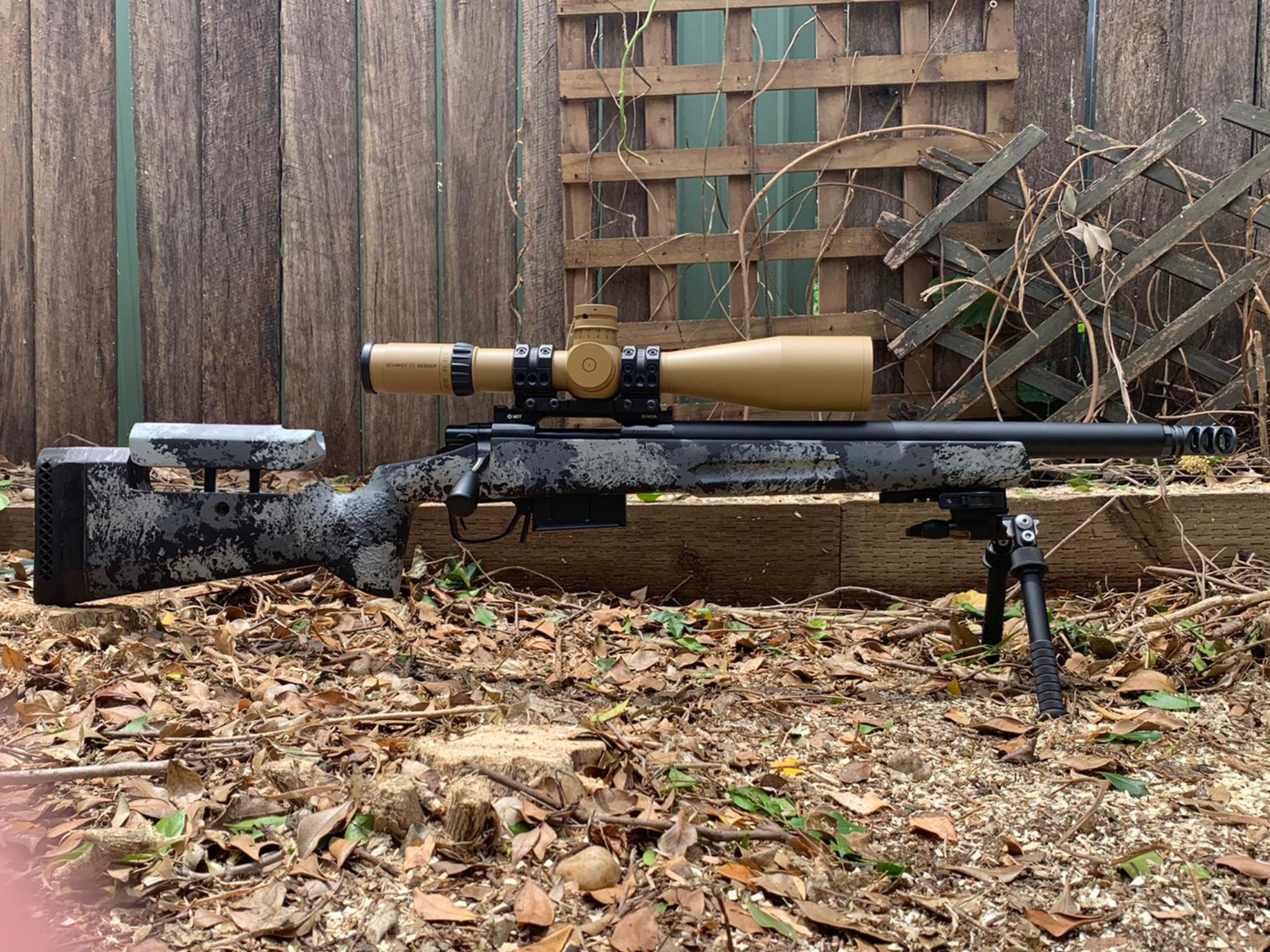

Ended up with this, all assembled then test fired/zeroed today

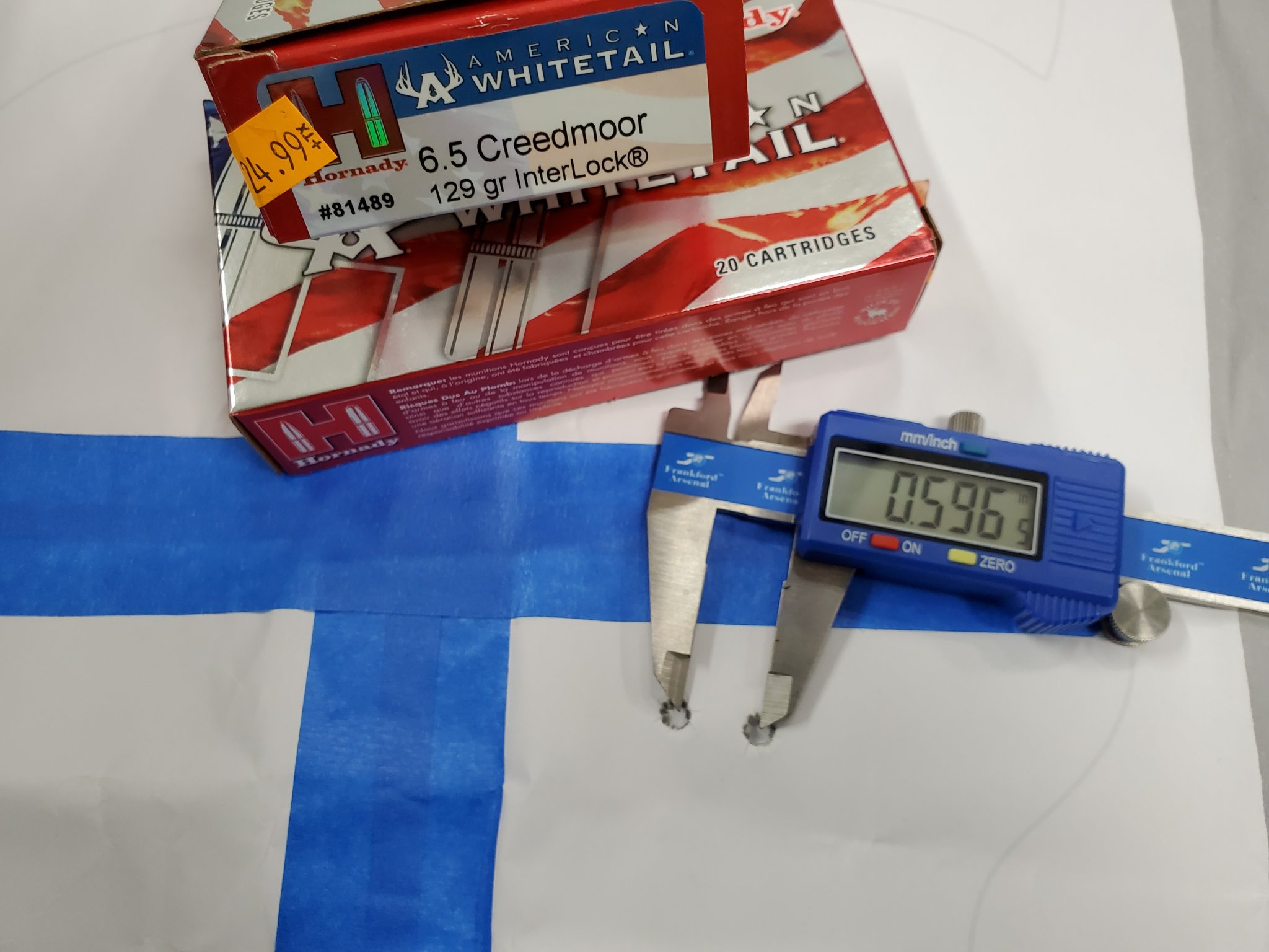

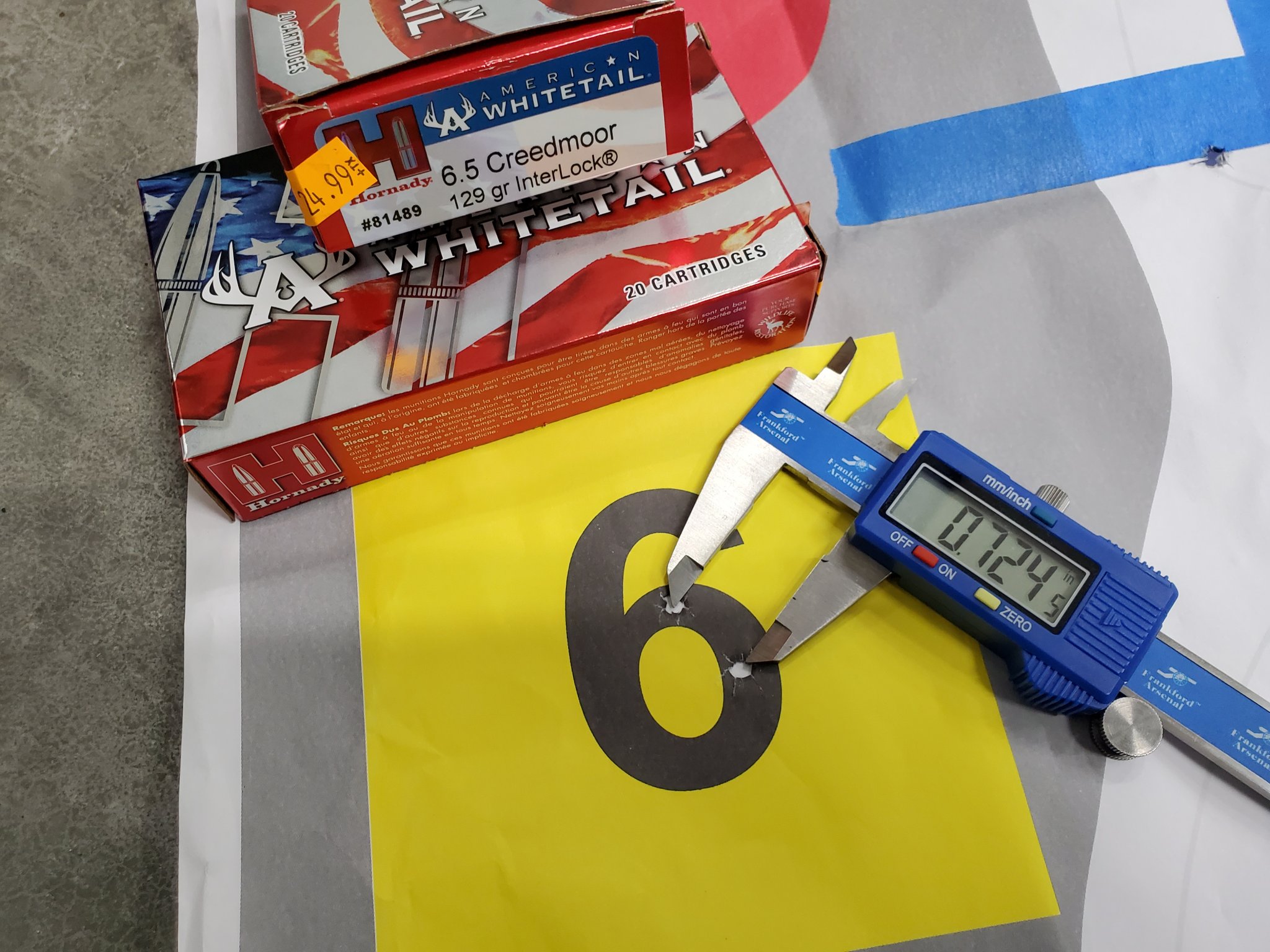

Life has been crazy so I haven't had time to reolad, so I snagged factory Hornady American Whitetail 129grain
After dealing with a bad scope at first, a friend stepped up to the plate with awesomeness and we slapped this Leupold on and zeroed.
I was running low on ammo, hence the 2 shot groups.
Just posting data collected
This is for my 7 yo son. I'm thinking about posting a DIY thread just for informative purposes since I have seen a lot of talk about youth setups leading into hunting seasons.
Ended up shooting as seen above at night........WOW 🤩🤩🤩🤩🤩 even without NV....just awesome. I see the value and purpose of XM-3 program now (not claiming mine is anywhere near the level of that system)
I'm officially addicted to shorties now !

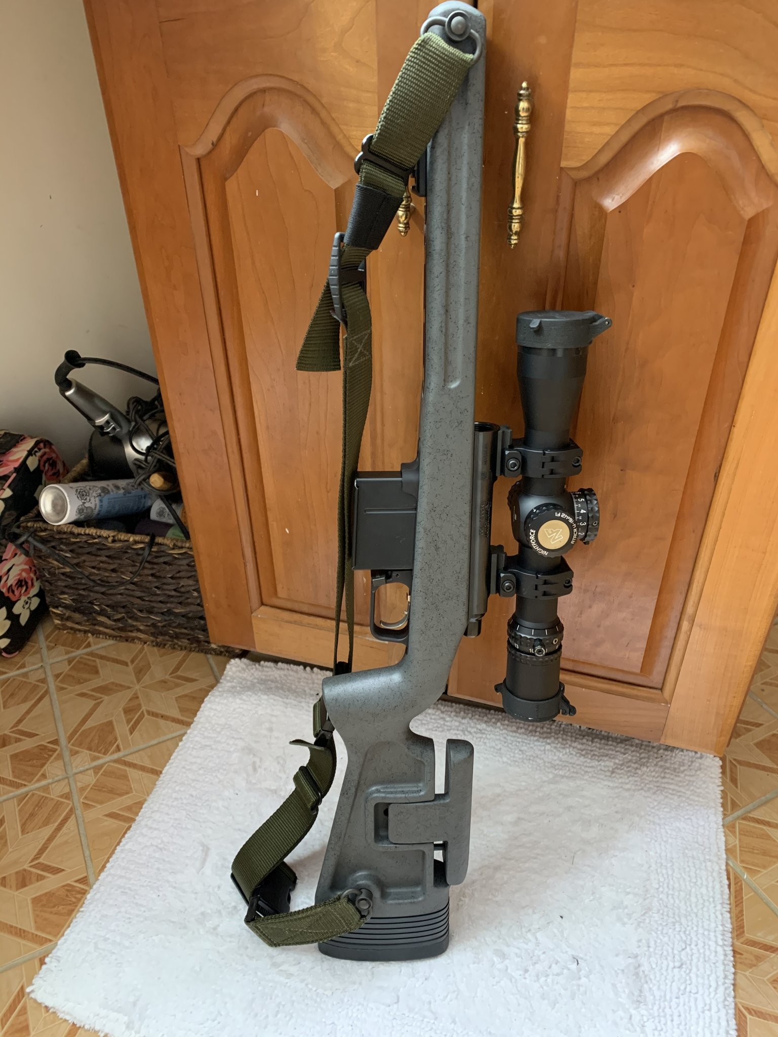

Rem 700 SPS tactical cut to 16" and threaded. Timney trigger, magpul hunter stock/DBM, Leupold MKIV 4.5-14x40 FFP TMR reticle, Sico Omega,KRG bolt knob. When the wind is manageable she will get out to 1000 yards no prob shooting 175 SMKs.
