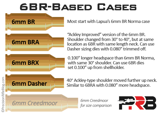

Mind sharing what kind of velocities you've gotten so far? And what's the difference between BRX & BRA?
I don't have ammo loaded yet for it. It is a reamer of my design... nothing really special. .246 neck and 85 fb. It was a .260 fb for the 95skm and it LOVED them. I hope to shoot the 75 eld right at 3k with r15 or varget. Quick loads says I should be able to... I will know in a few weeks

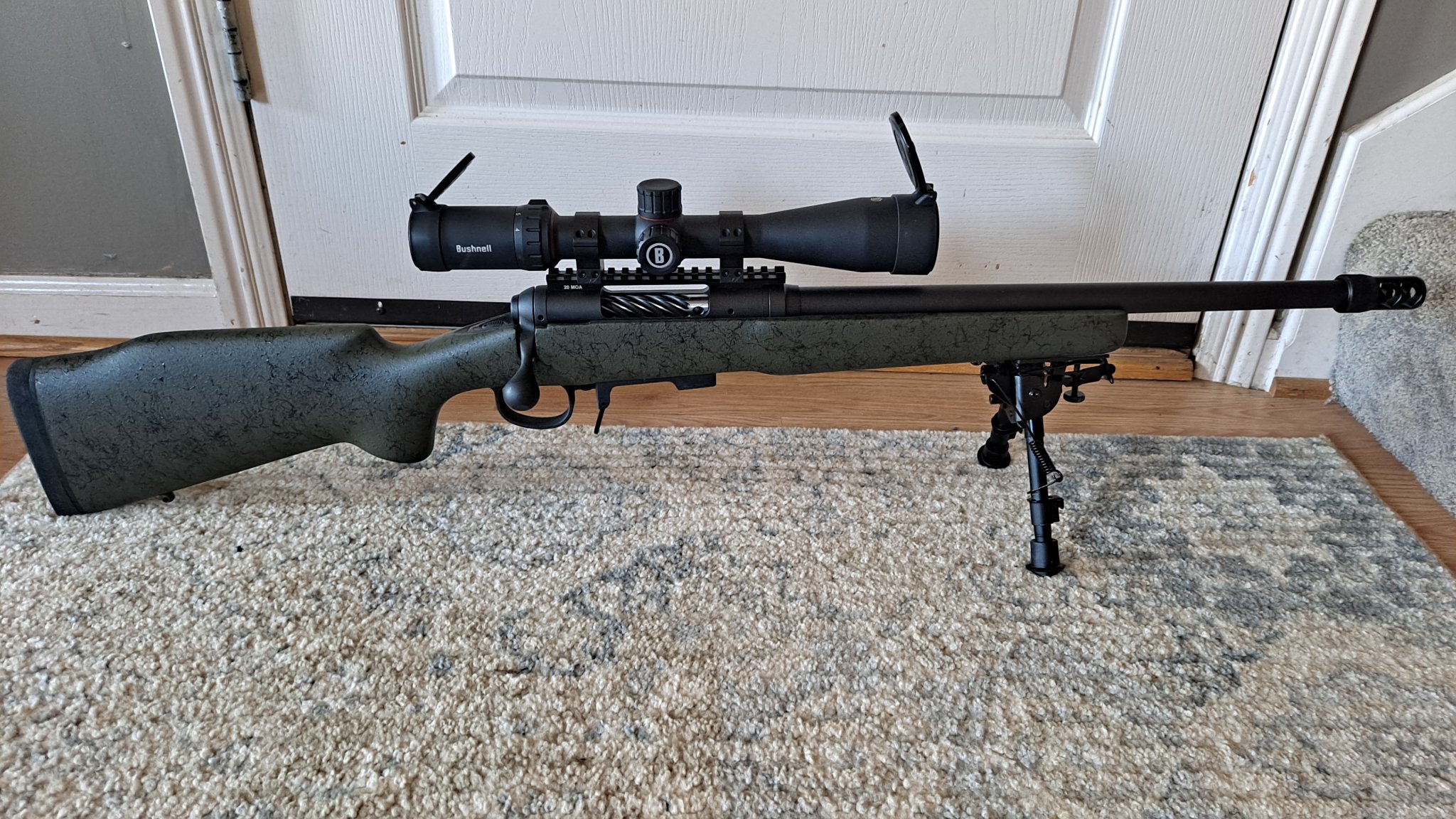

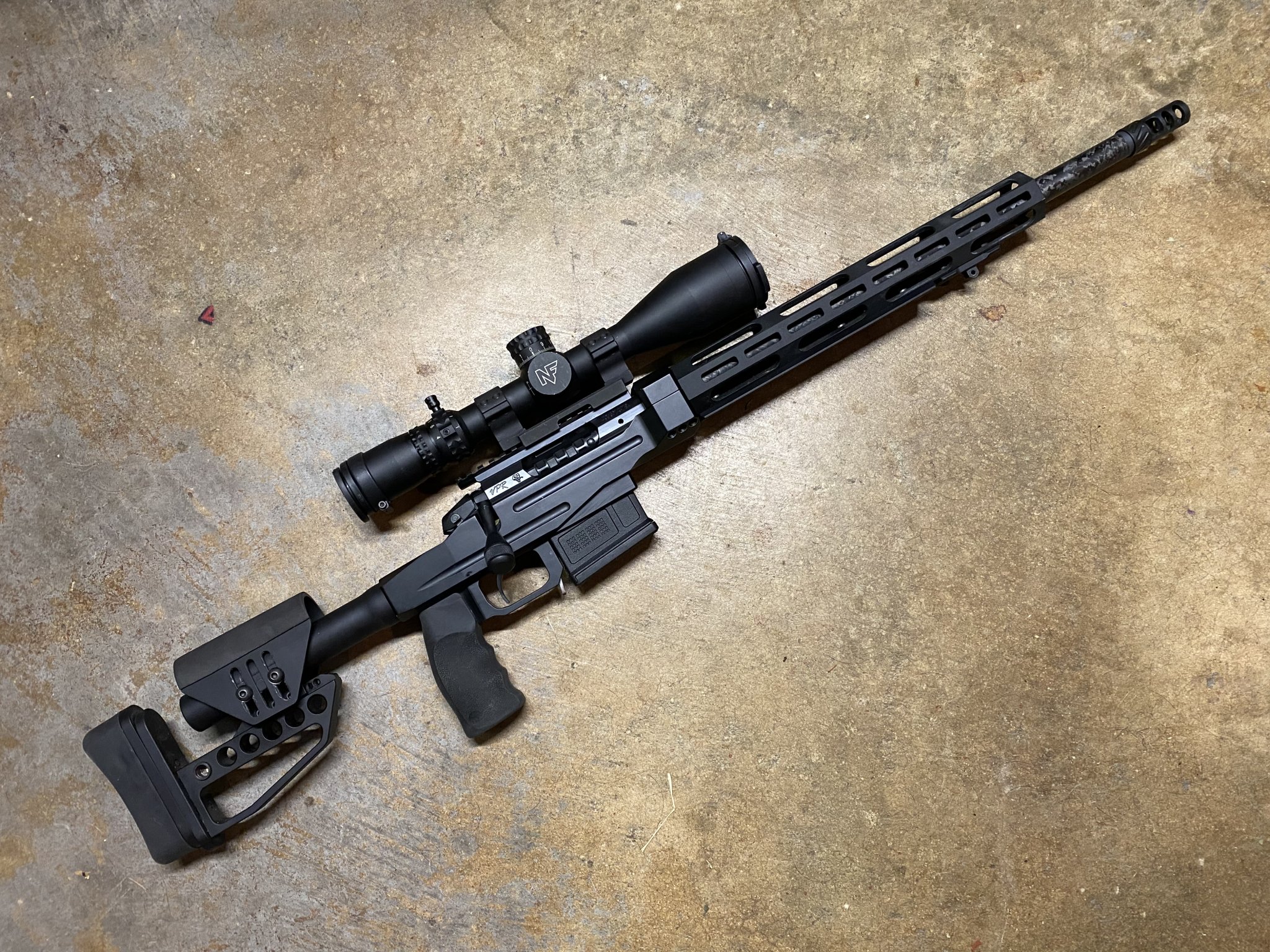

Not quite finished product, but getting close. Haven't torqued the barrel up yet as I need to find a gunsmith to throat it for longer bullets. Scope came in Monday, but its too close to the barrel for caps even with Hawkins highs.
What color Cerakote should I go with on the barrel ends and the action?
Looks good, how do you like that stock?

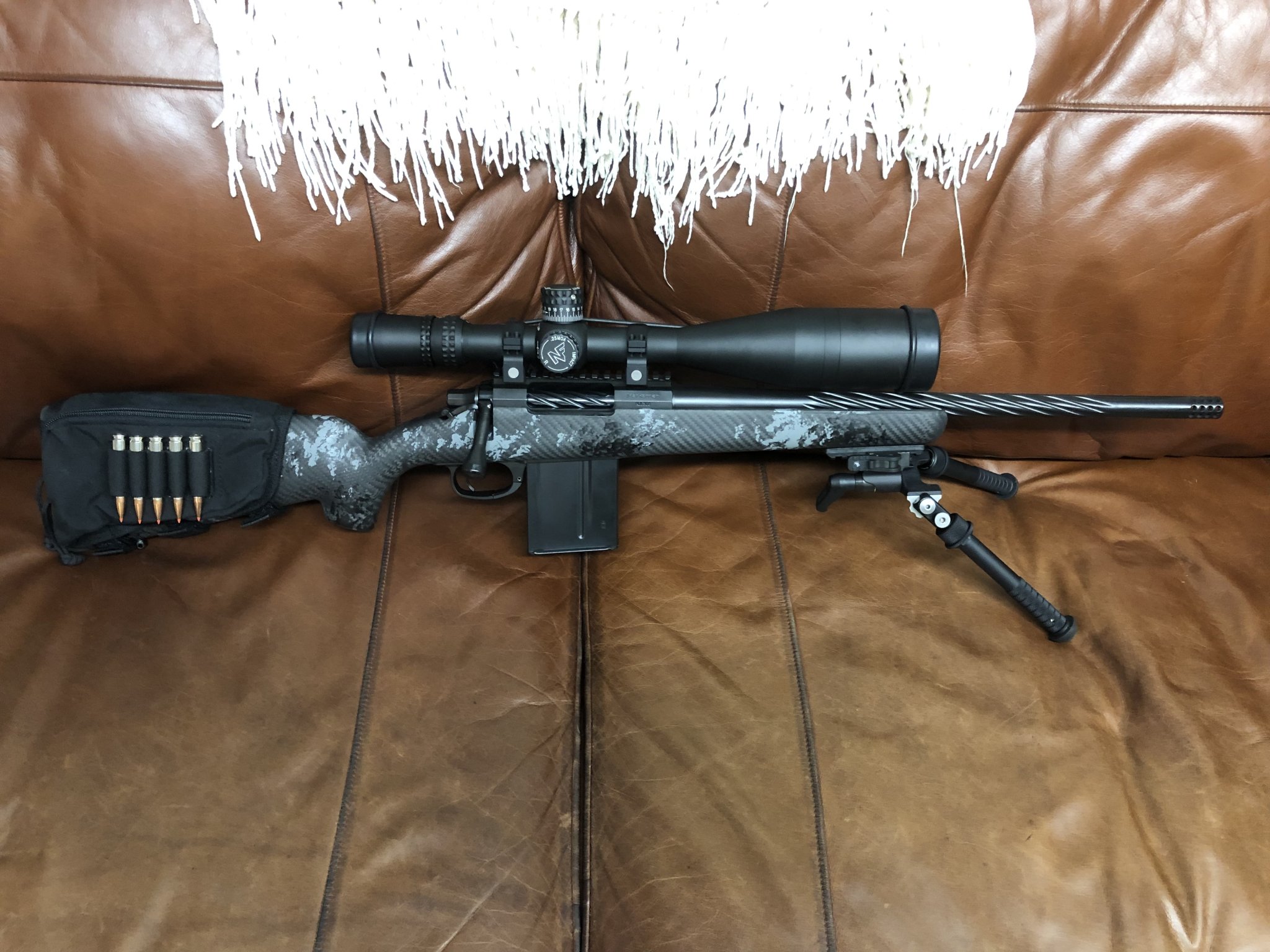

Great looking rifles in this thread - I'm acquiring parts at the moment for my own shorty 6 Creed. Longest wait will be the Manners CS2 stock w/ Mini-chassis, but so far I've got the following sitting in my safe:
- Terminus Zeus with QC
- Bartlein Carbon #13 19" blank (finish length of 18")
- Triggertech Diamond Flat blade
- NF NX8 2.5-20x
- Gunwerks 8ight suppressor
May end up tossing it into a cheaper stock or chassis while waiting on the Manners. I don't think I'll be able to wait several months to shoot it!
Man love that look! Really close to how I'll have mine setup except for a KRG Bravo. What is the barrel length/contour?

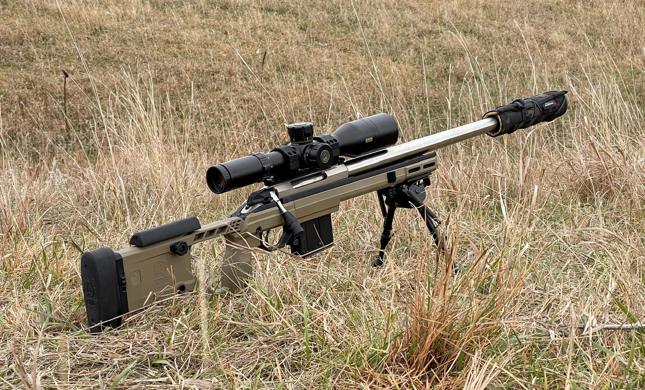

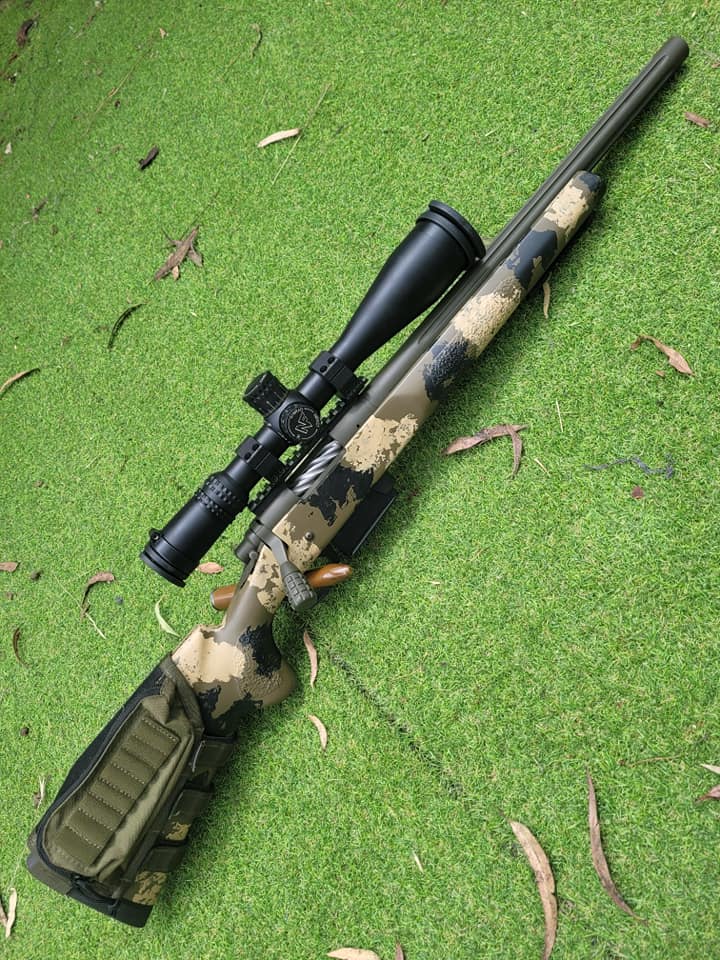

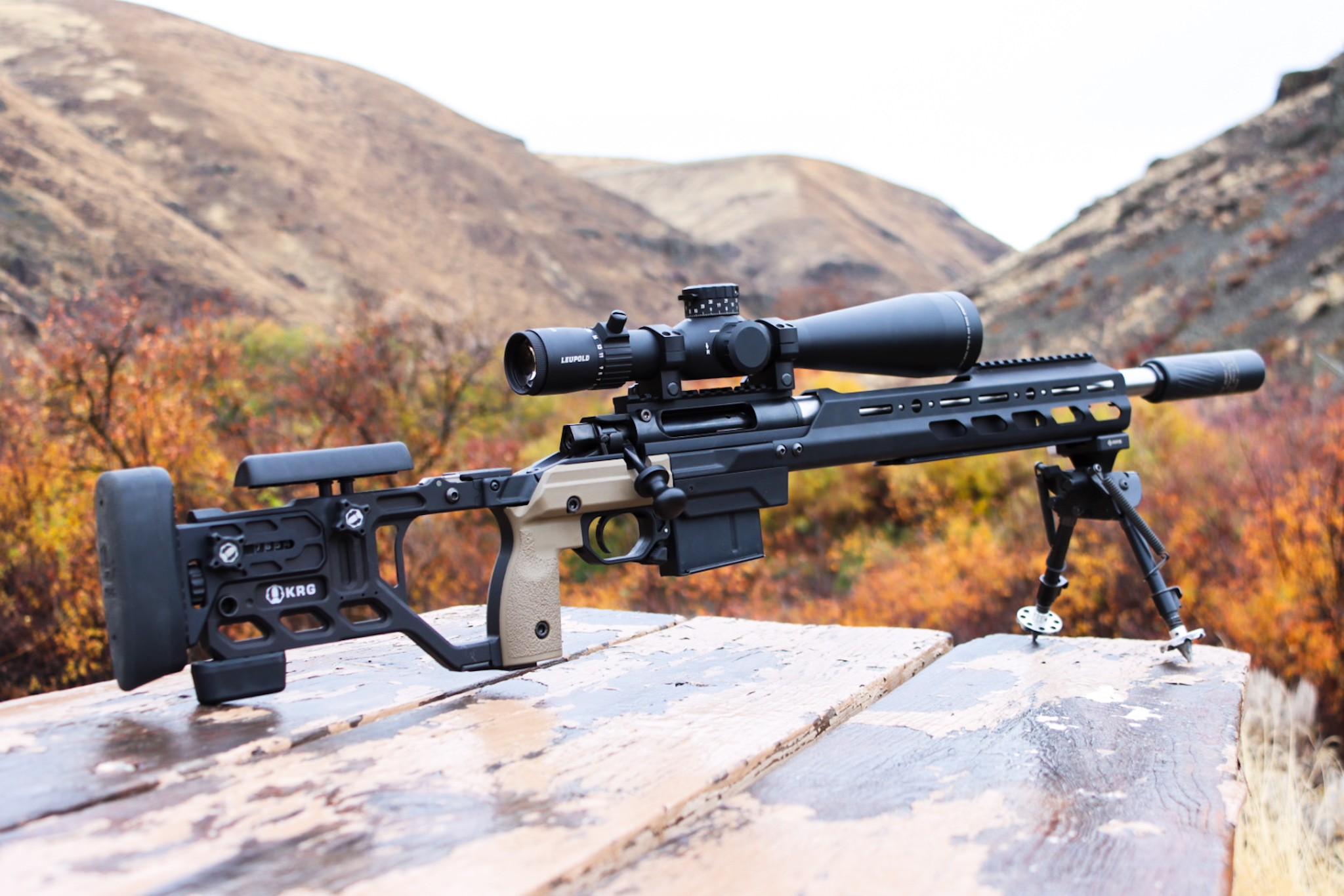

My new coyote gitter
22 brx
16.5 x-caliber 1:7 twist.
Tb 5" 6.5mm suppressor
Folding w3
Leupold mk5 tmr.
Will be working on making some ammo for it in the next few weeks as work let's me.
That looks really good. How’s the silencer sound? I’m still debating one of those 5’s for my 308 shorty.

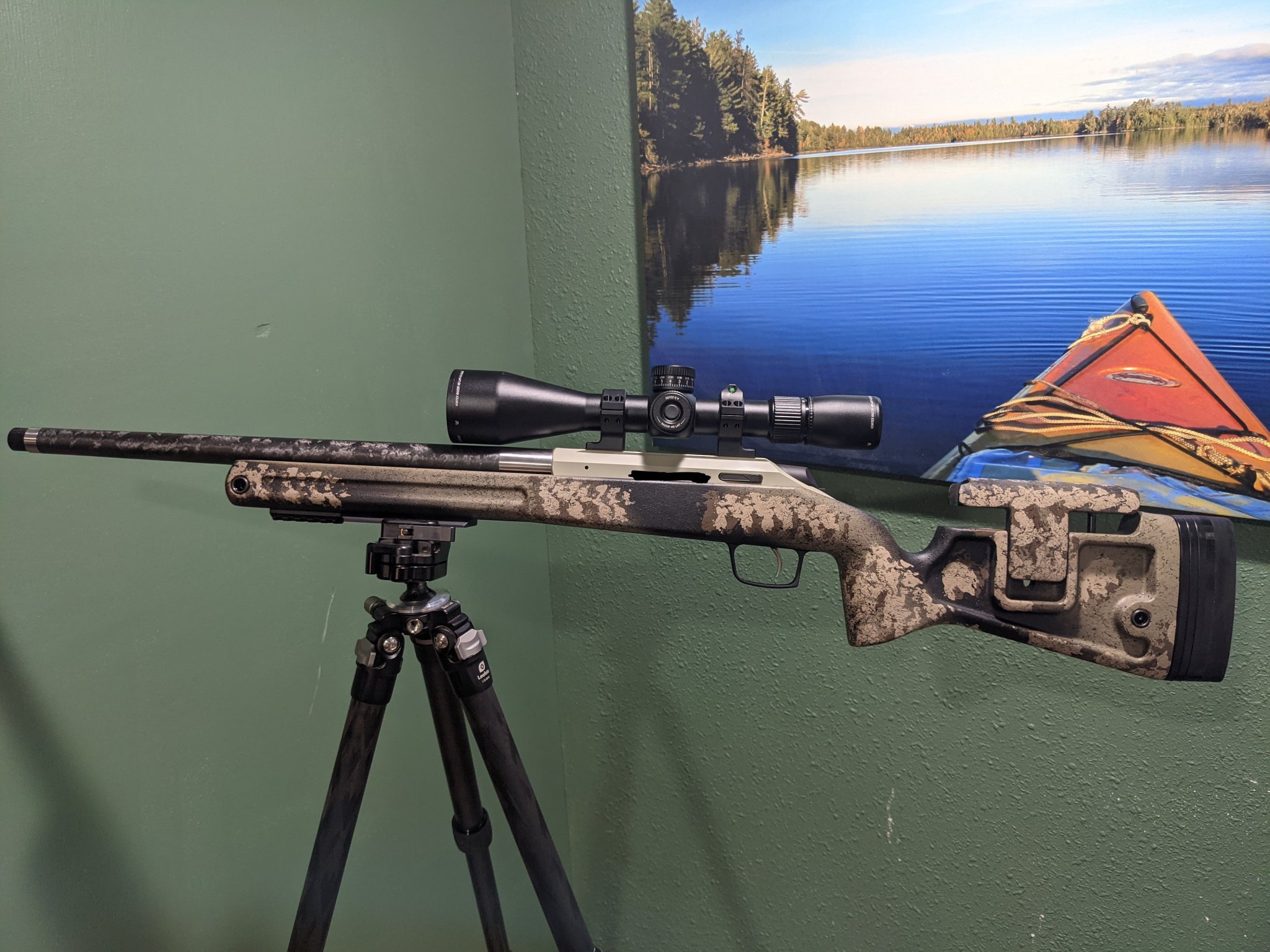

Tikka 8 twist 223.
Chopped and fluted by LRI.
Atacr in M10s on a 419 rail.
Turbo K til the ultra 7 is free.
Mathews riser keeps the blinker in line.
Tikka vertical grip.
Mountain tactical billet mags for extra coal.
Sterk shifter.
Needs a bipod.
Shoots 75 ELDMs at 2850.

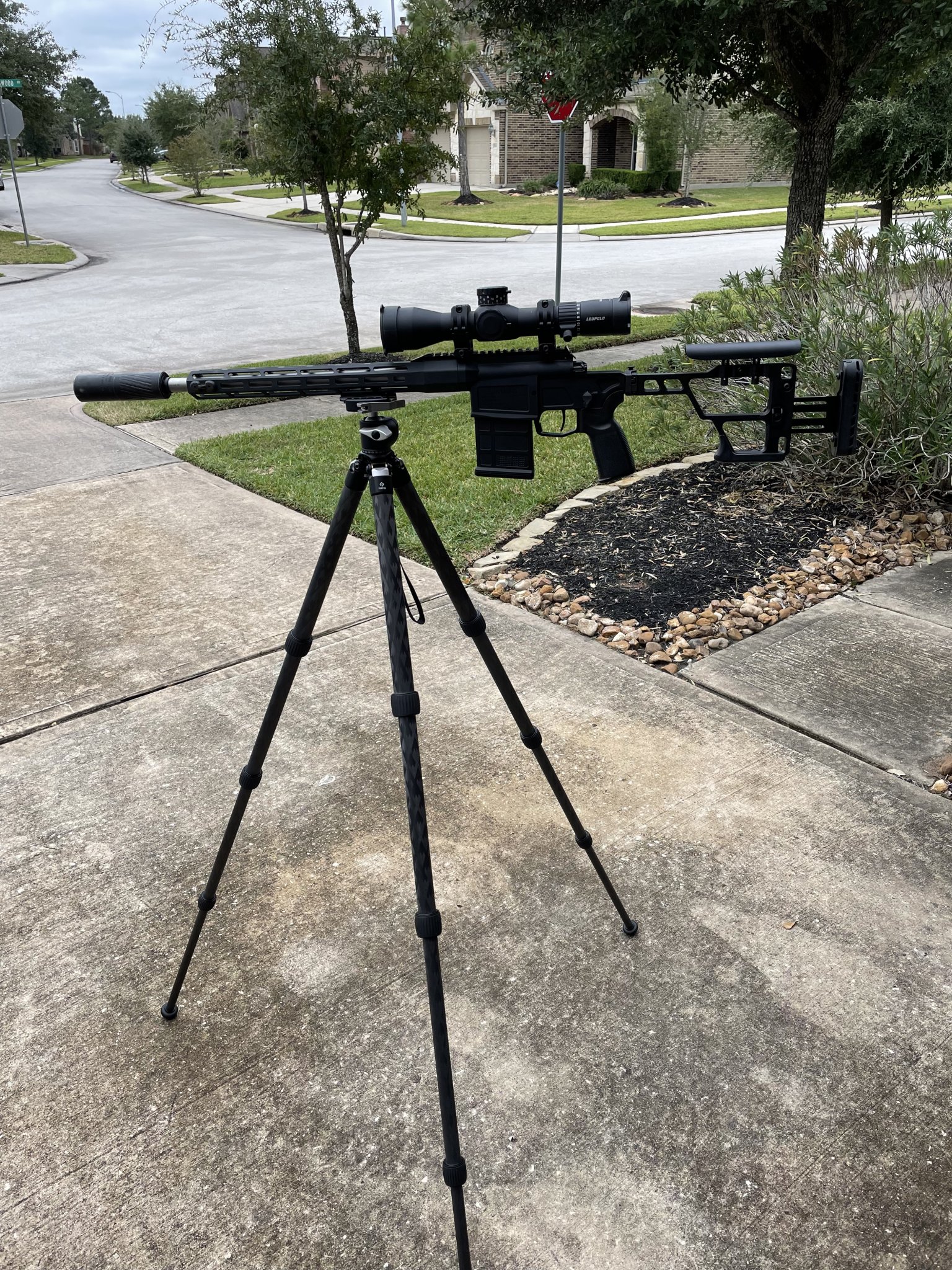

I have a 5 and a 9. The 9 makes stuff quite where ear pro is not needed. I mostly use it when at the range and don't want to use ear pro. Now the 5 I bought just for hunting when I just don't need my ears blown out. It is still loud. I love it for its shortness. Make movement a breeze. Not to mention. It fits in a pack really well.
As for the rifle, thanks for the kind words. I have built several dozen pr style of rifles, from shorty to big tanks and this is probably my favorite......just need to get thorough making cases and then see how it shoots.
As for the photo, I am lucky my wife is a photographer so I talk her into taking fun photos of my rifles for me.
Wherever you live, I wanna live there too. I miss being able to set a rifle up in the driveway and the neighbors don’t bat an eye. Lol
Everyone is welcome in Texas, so long as you don’t forget the reasons why you left wherever you left.
What kind of attachment are you using for your cross? I've got a cross and I'm looking into getting a tripod setup.
It’s just a RRS m-lok direct bolt on ARCA rail section. You can get one any number of places.

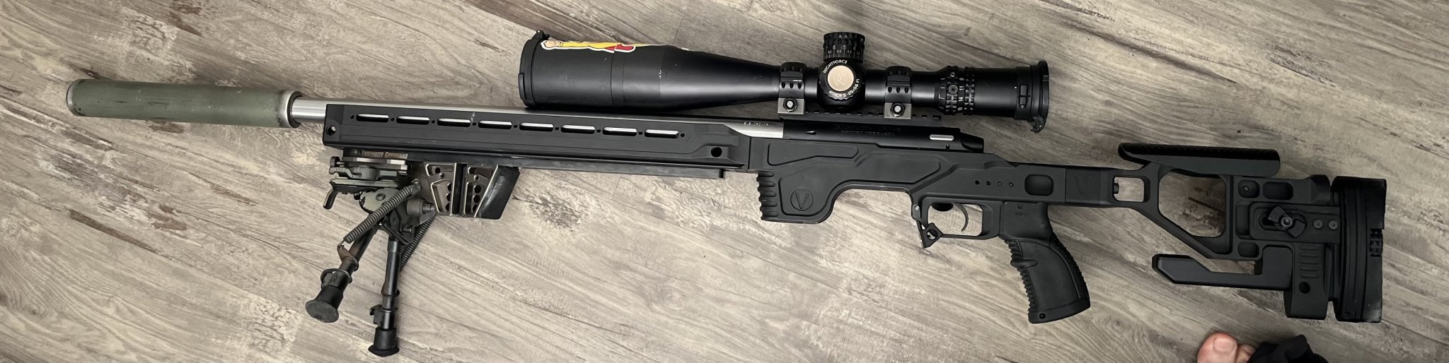

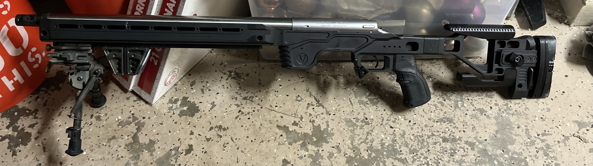

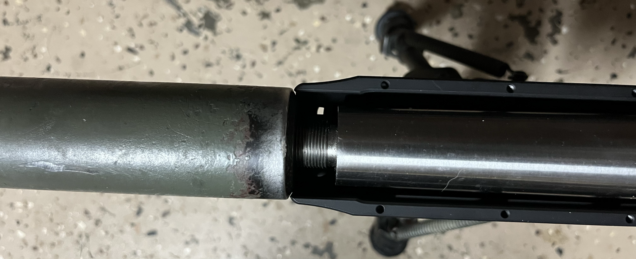

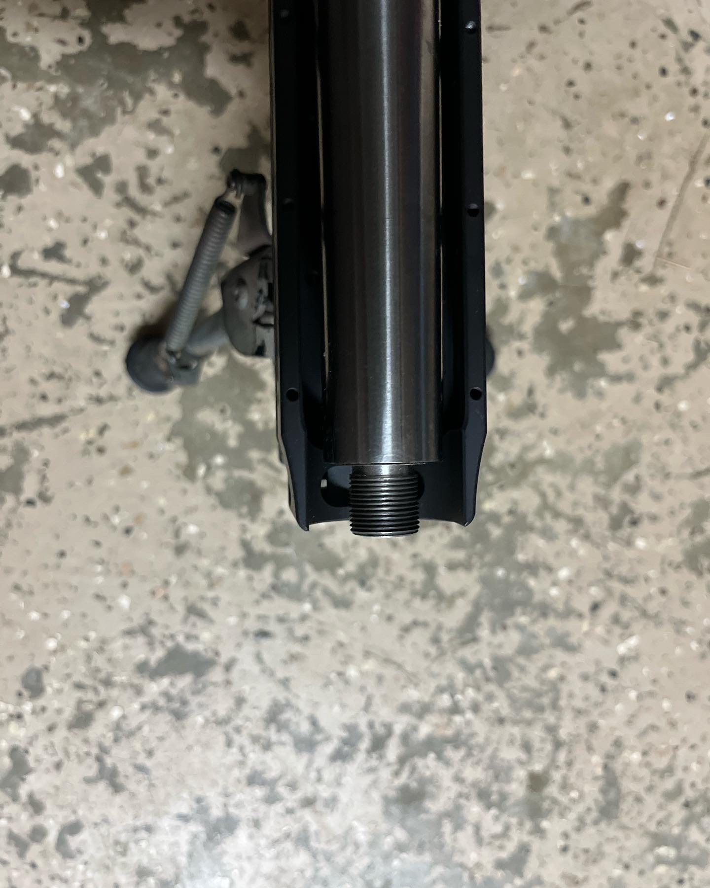

Ran into a rather unique problem. New chassis. Planned on switching out my 28" for one of my 18" 6.5 barrels. :ROFLMAO: I could get away with 19" but figured I'd round out at 20" for a slight buffer.

Haha. You should just go all AR hipster and put the 419 faux can flash bang forwarder thing on it under the rail.
