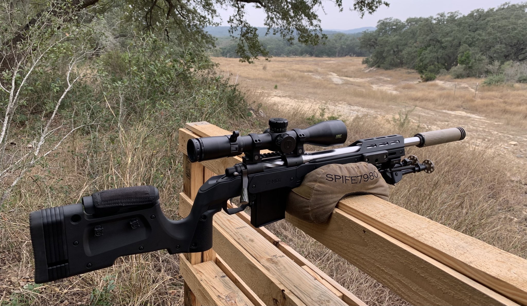

Well that makes me excited cause that's the exact barrel I have waiting for me at DST. DST is sponsored by Hart so I'm sure we can get the reamer as well. 2610 is solid though with that round. Did you do an XM3 clone? Was that the reason for sticking with the 175s? I thought about it but just wanted a bit of velocity gain and given the high BC of the 168gr TMK I figured 2650 would be relatively easy to hit.
Yeah, it's a spec XM3 built by Bill Corley, picture is up on the page 47. No particular reason why I went with the 175 SMK's, just cheap, available and lots of data on them. It being the projectile the XM3 was chambered for was just an added bonus. When I run out of them I might try something else but the gun hammers with the 175's so I'll probably just leave it be. This was a 3 shot group to check zero before I took out it hunting last week. Btw I made a correction on the powder charge that got me 2760fps, it was 45.5gr not 45.7gr, I was going off memory but I checked my book to confirm.

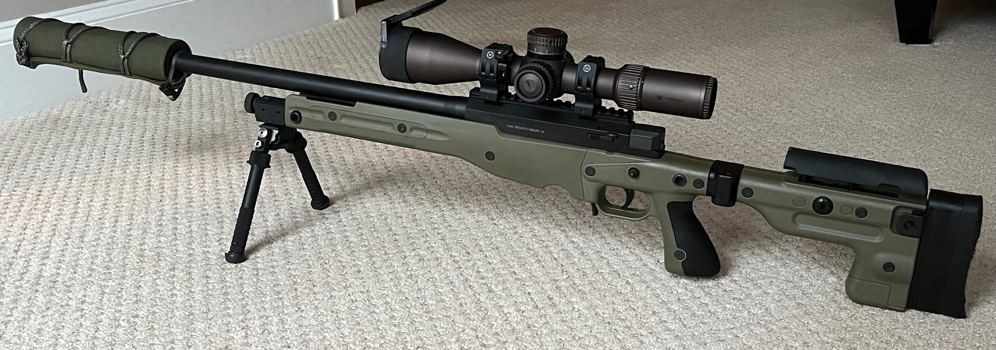

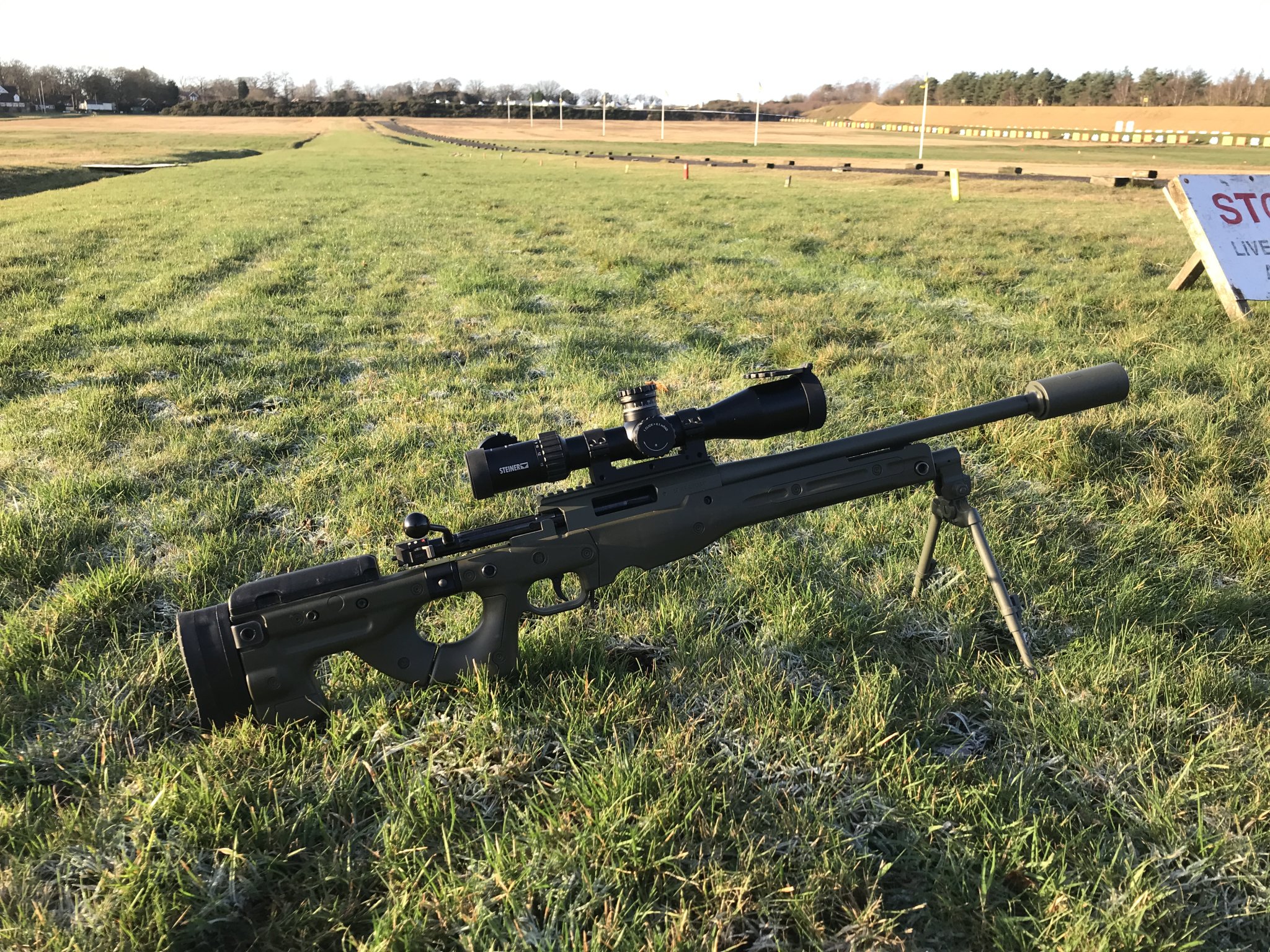

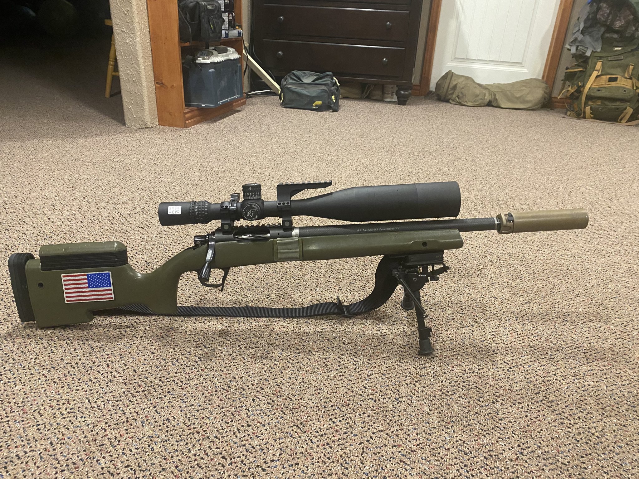

2015 AIAT folder, bought used, low round count
Factory .308 1/12 barrel
Barrel cut to 17.850" at Mile High, TB CB mount machine timed
Thunderbeast Ultra 9
Vortex Razor HD gen 2 3-18, mill
This thing hammers. I've shot it next to a GA Precision FBI HRT rifle with a 24" 308 barrel and it simply kicks it's ass in terms of ease of use and features. I can hang with him out to about 750yards then the wheels start to come off. I will be getting a 6.5CM barrel at some point.
Edited to add:
Prior to the barrel work I was at 2480fps with factory FGMM 175gr and no suppressor. Got a little over 2" cut off the barrel (2.150" to be exact) and added the Thunderbeast suppressor. Chronographed the exact same ammo at literally the exact same muzzle velocity, 2480fps with the shorter barrel and can. Funny anecdote.
Cold bore shot from last month, 101 yards:
3 shot group from previous outing, FGMM 175 or 168, I can't remember:

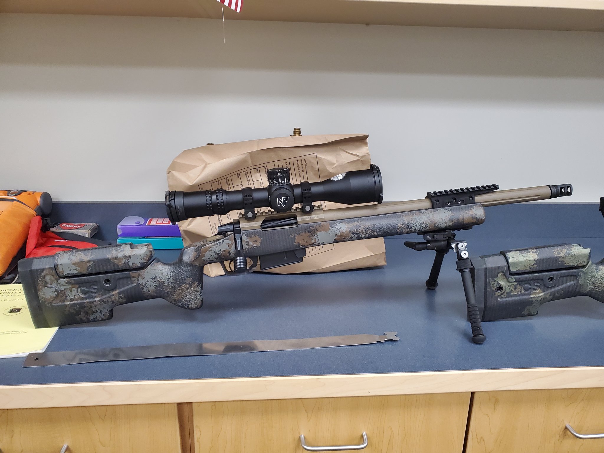

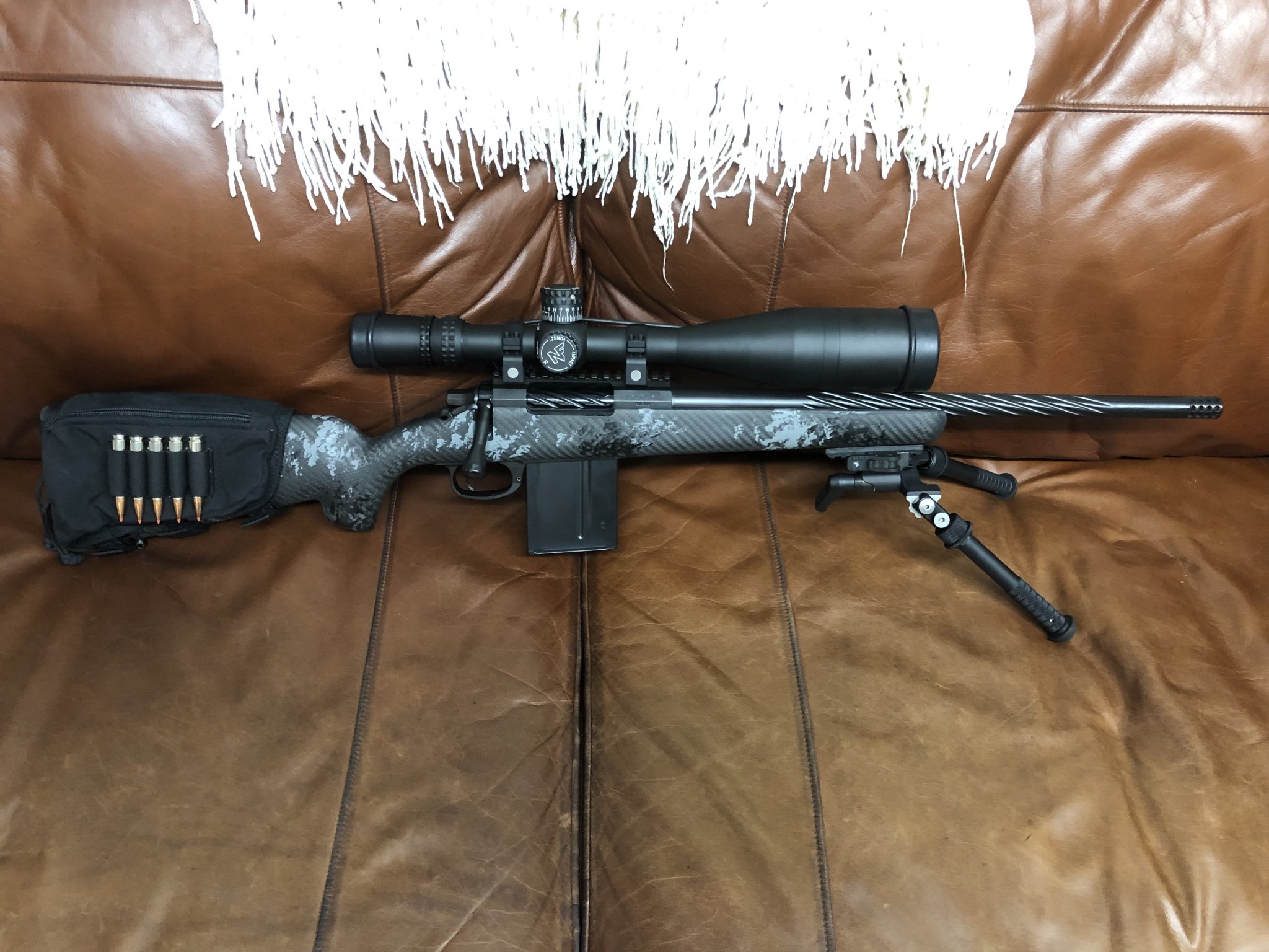

16” bolt guns is where it’s at for me with .308…sub 700 and in…factory Howa heavy 16” barreled action:
Features:
Oryx Chassis
MDT 20 MOA rail
MDT mags
YHM QD Brake with Resonator R2
Leupold Mark 4 Rings
Arken SH4 Gen 2 4-16 MRAD
Solid package and under the $1500 budget I had set.
