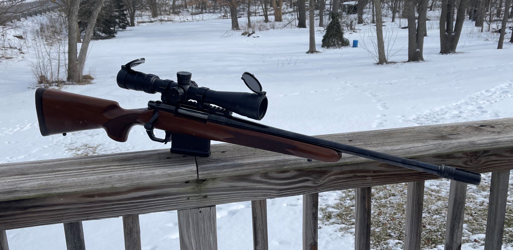

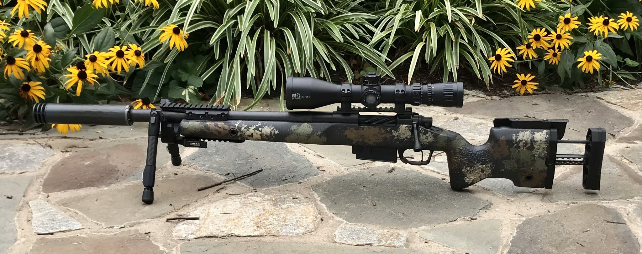

Remington 700 Classic in 7mm Mauser. The action is pillar bedded, and it uses the MagPul DBM bottom metal. (plastic, I know, but works perfect, and was way cheaper.) The free floated barrel is now 18" has a Surefire SOCOM three prong flash hider so it can fit a suppressor. (pending government permission of course)
Remington 700 Classic in 7mm Mauser. The action is pillar bedded, and it uses the MagPul DBM bottom metal. (plastic, I know, but works perfect, and was way cheaper.) The free floated barrel is now 18" has a Surefire SOCOM three prong flash hider so it can fit a suppressor. (pending government permission of course) View attachment 7807031
Good caliber - nice setup. (y)

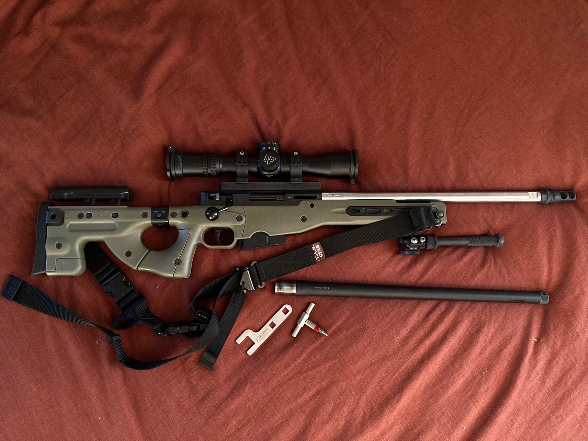

Has anyone done a short 16-18” 6.5x47? I’ve always been intrigued by the cartridge. Of course, I could just do another 6.5cm.
I have a 16" 6.5x47 built by Accurate Ordnance. It has a Bartlein #3 barrel topped off with a Thunderbeast 7" can, Manners EH2 stock. It's my whitetail rifle and has accounted for a bunch of deer with 123 Amax. Does well on steel out to 800yds. It's my favorite rifle by far.

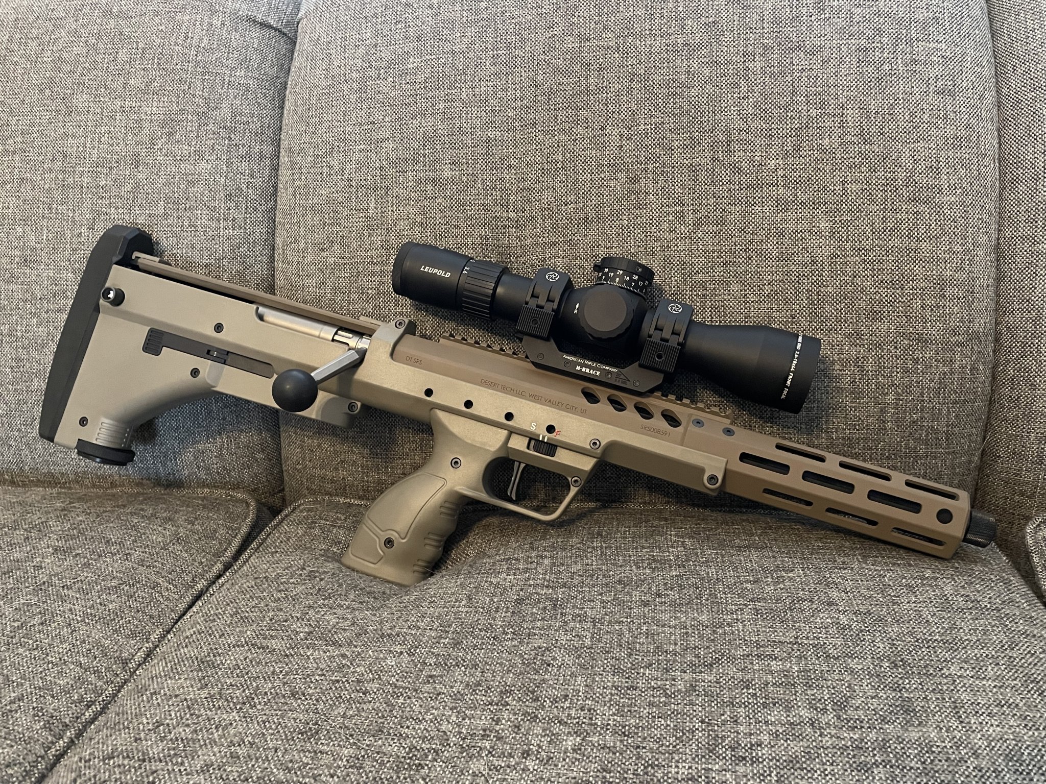

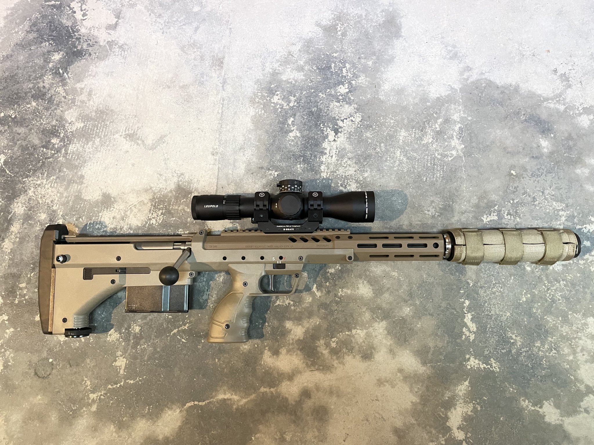

I know it’s not what you were asking about, but to give a reference my DT SRS A2 16” 308 is 11.2lbs as pictured. Maybe something to consider.
I really like that DT SRS rig.
For hunting, you even could get it under 11 lbs, if you used a hunting style scope (like a Vortex LHT) and light rings. As much as I love the ARC scope mount, they are pretty heavy. The mount alone likely adds at least 4 extra ounces compared to rings.
But I like it exactly as it is. Love the 3-18 Mk5.
Oh yeah. Could’ve saved 6oz going to the LHT and 4oz+ by switching to rings. Would’ve put me about 10.5lbs
