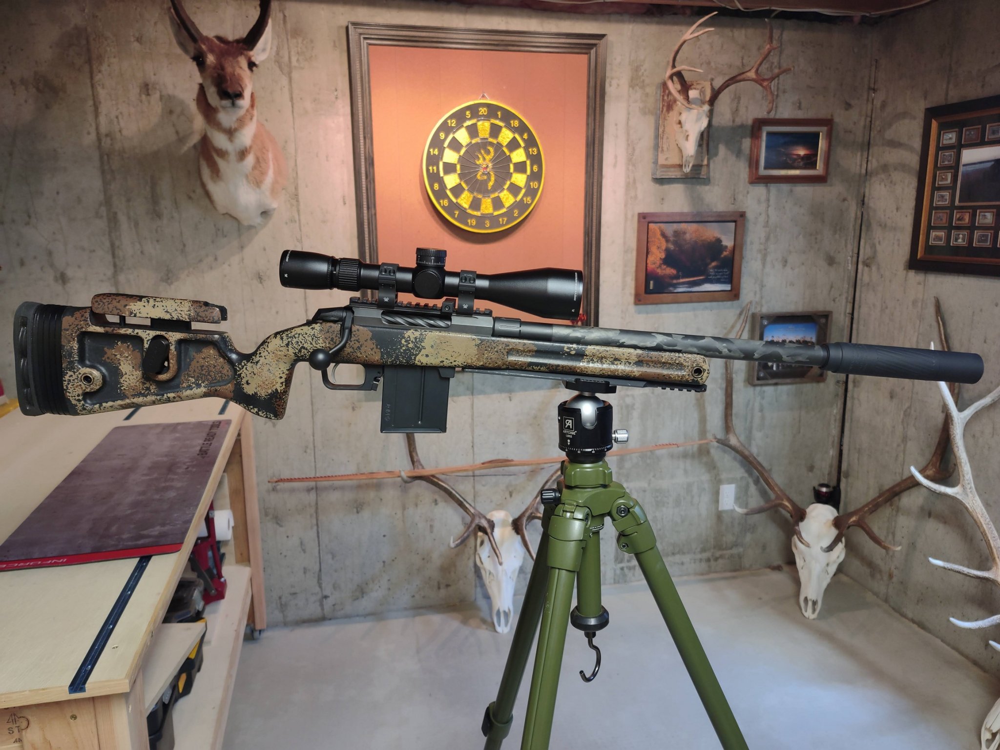

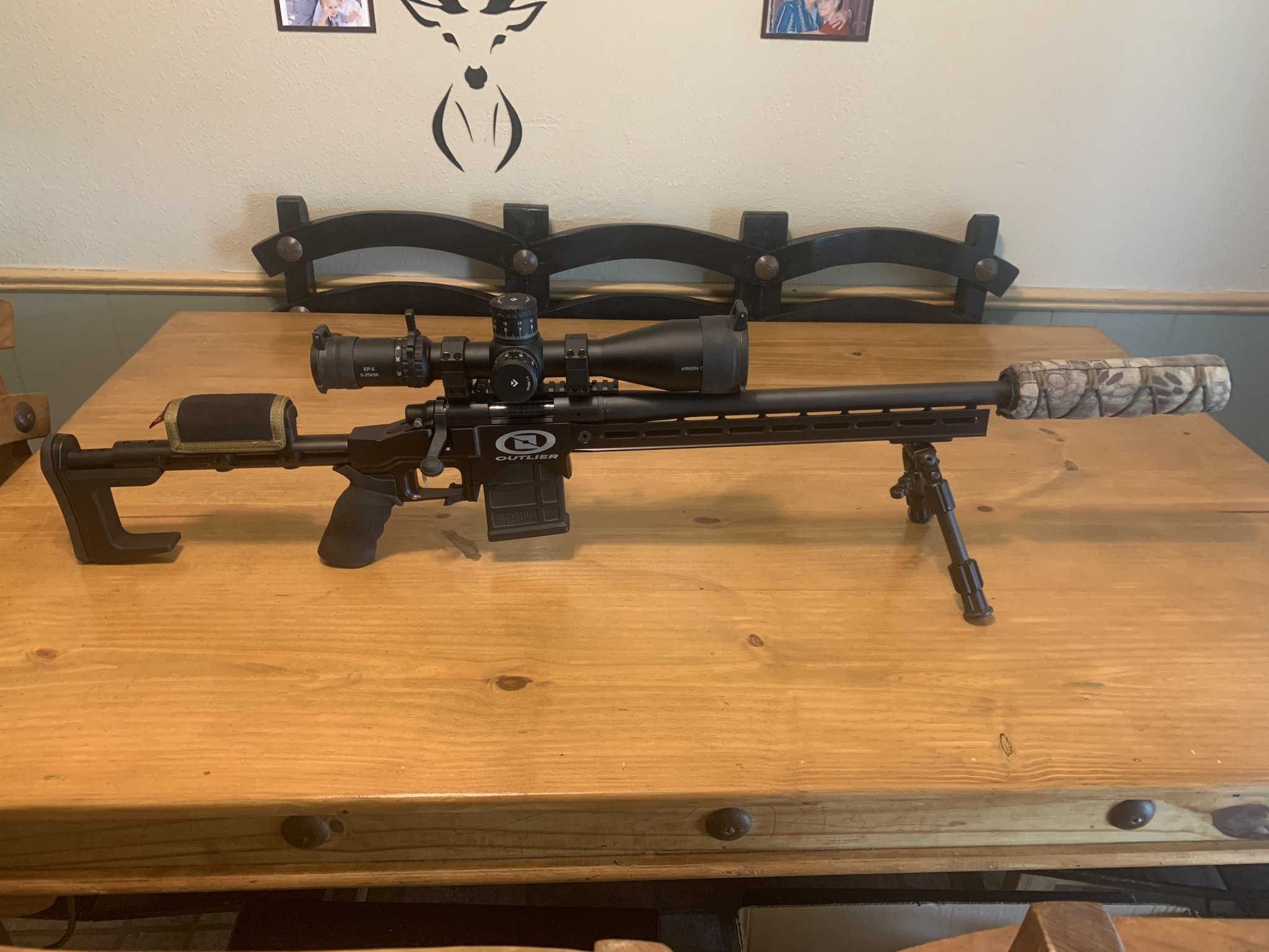

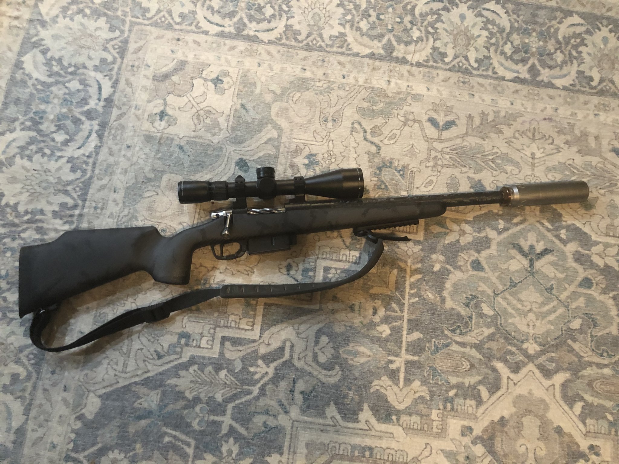

Remy 700 SPS Tactical, .308, 16.5”, Arken Optics EP5, Outlier chassis. Shoots great!

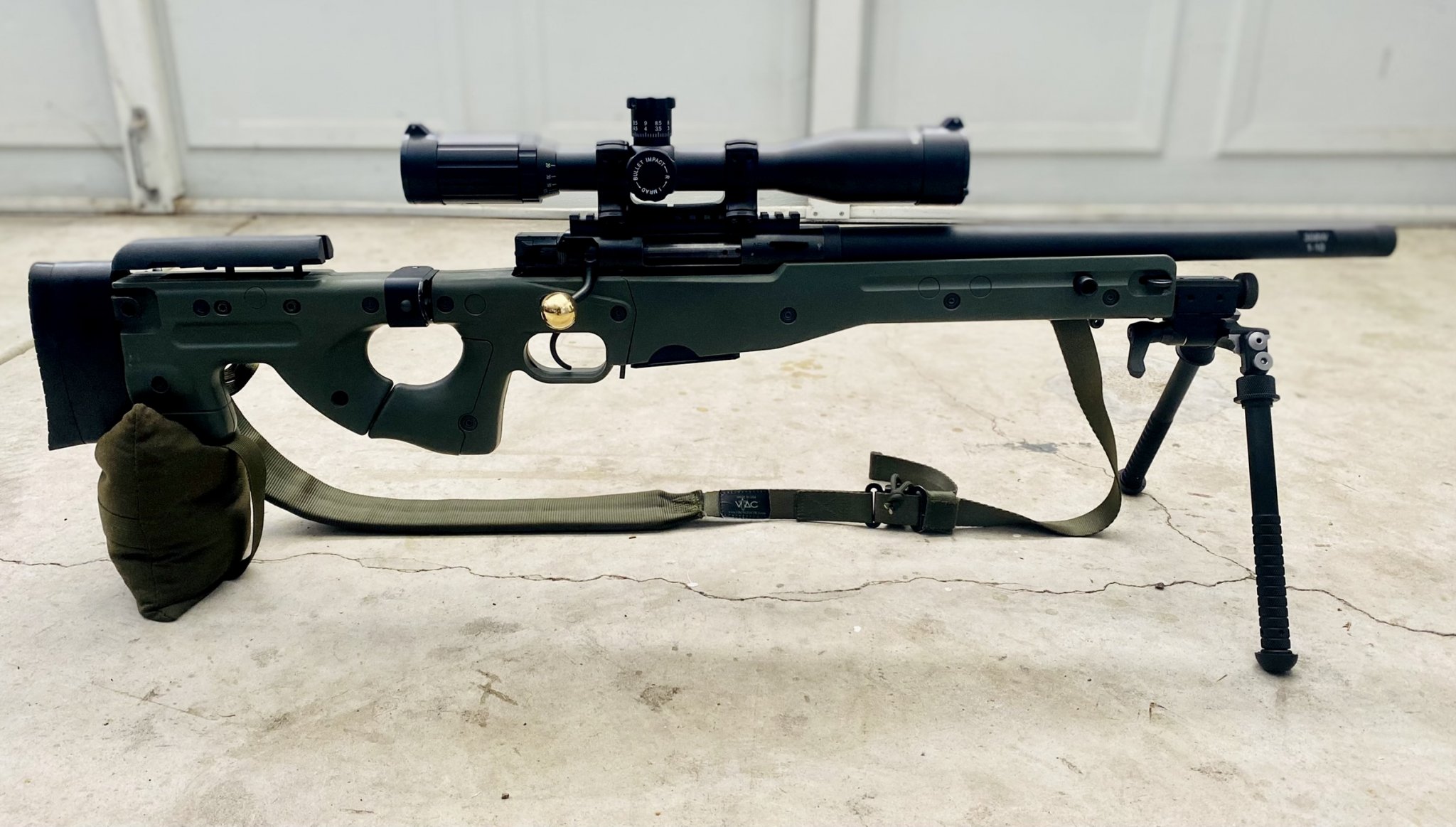

Got an 18" benchmark chambered in 6.5 Creedmoor by TS Customs, in their contour equivalent to a 3B.
Nice rig, dude! I'm of the opinion that a shorty should be a folder but that's just me, haha. I'm curious to hear what kinda speed you get out of it? I'm getting a med palma done up as a 18" 6.5 creed as well. Kinda figuring on mid 2600s with H4350 and 140 ELDMs.

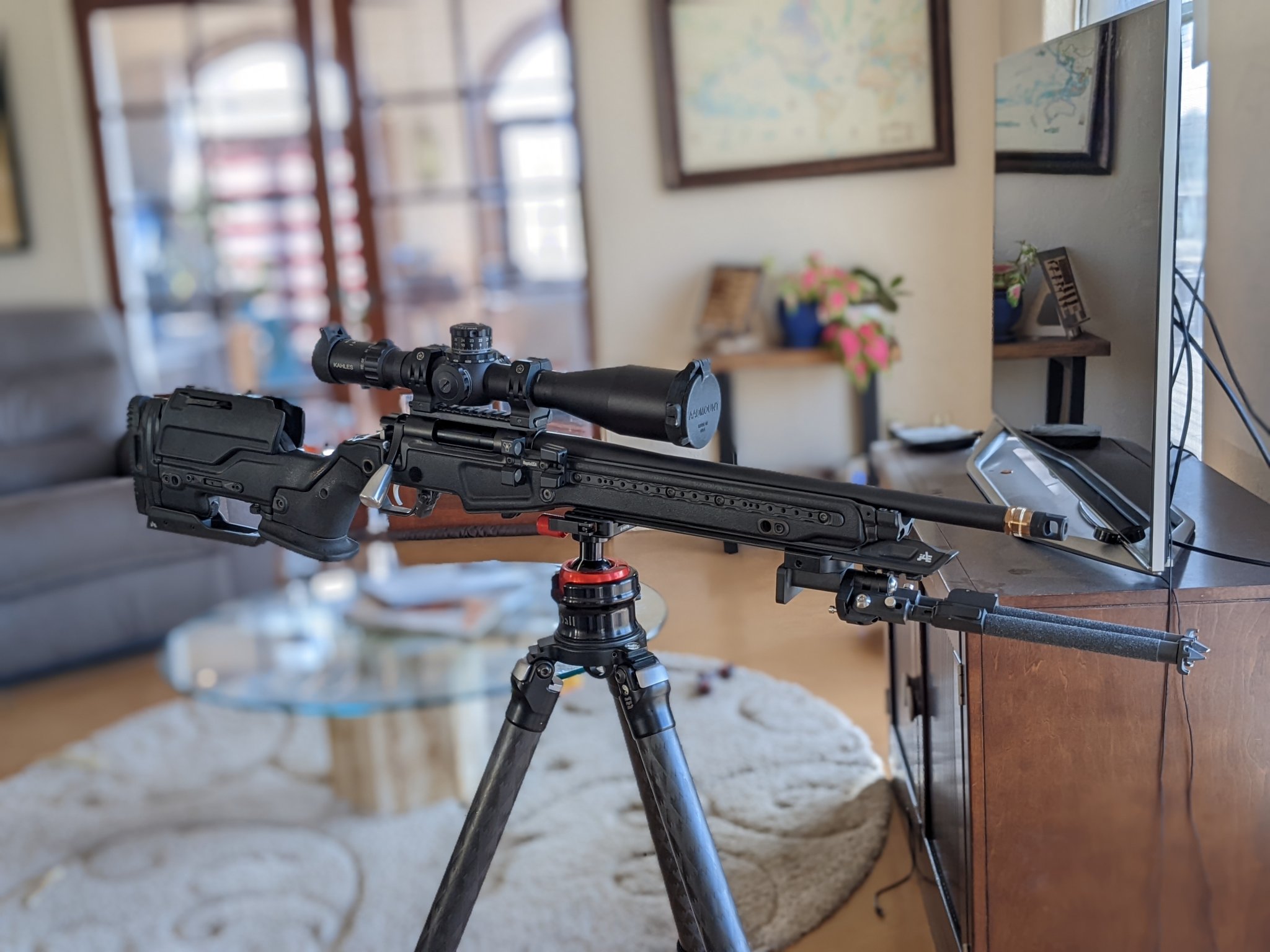

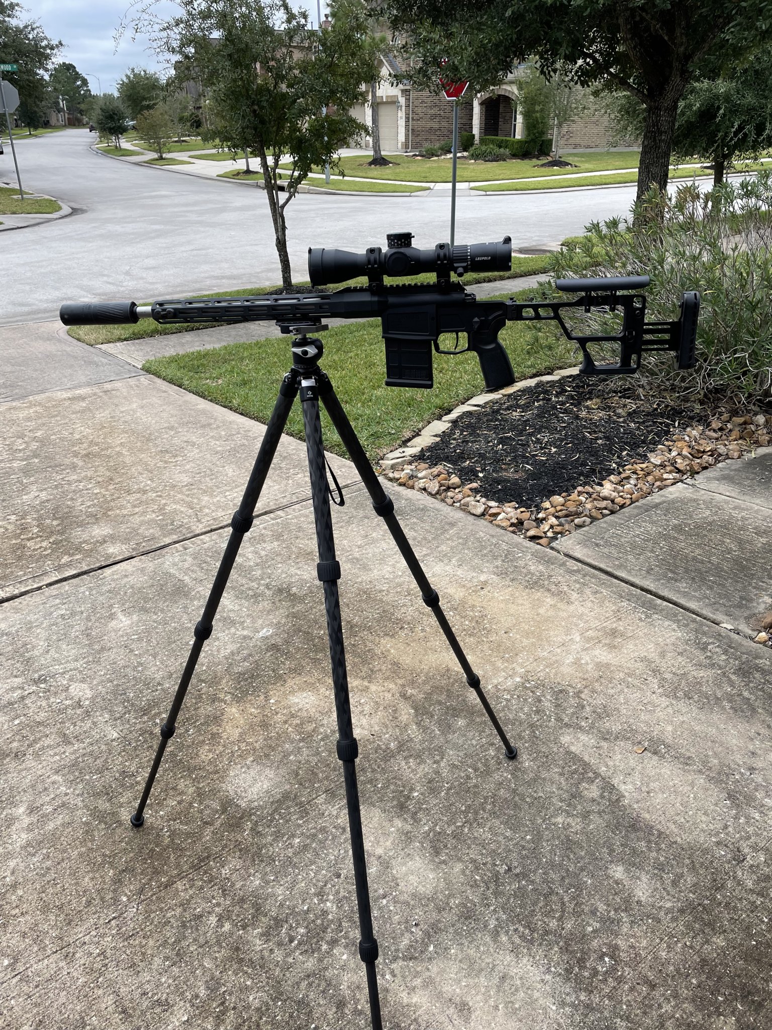

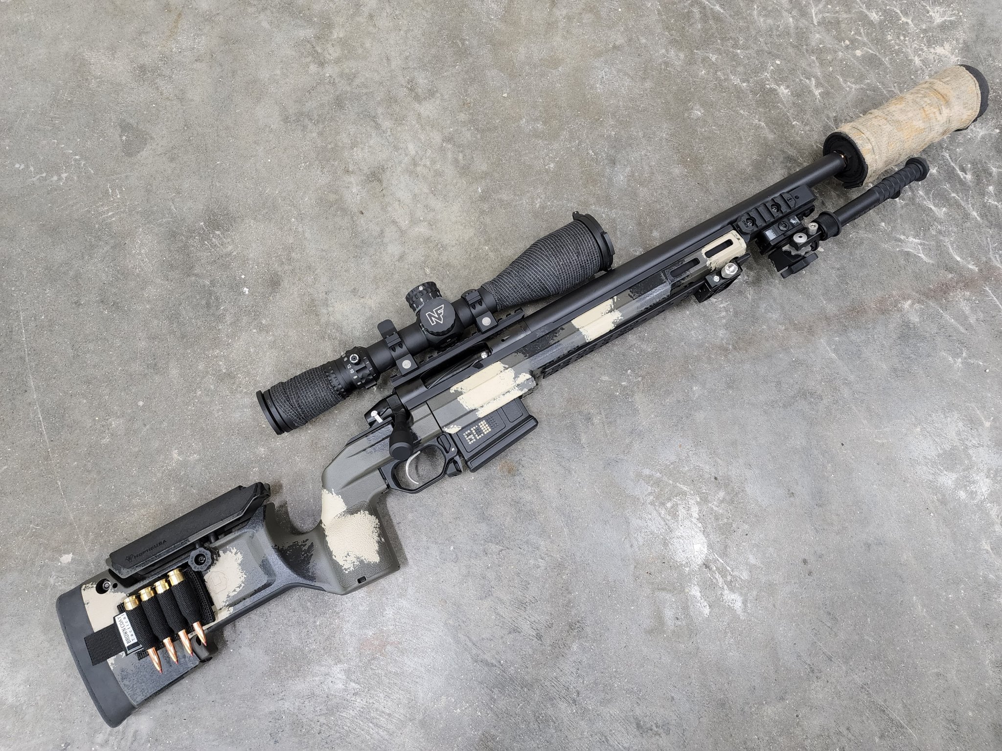

Now I can't wait to finish my anTi.
Need details, man. Caliber, length, weight.
anTi action
Badger m5 enhanced
16.5 proof sendero 1:7 6.5cm
Mesa precision altitude stock
TT special
Hawkins lr hybrid rings
Vortex razor lht 3-15x50
Dead air nomad ti/ plan b
5.6 lbs bare, around 9 w/ scope, silencer, atlas bipod.
You’ll love it man, awesome action for a short handy do it all hunting/ fun rig
Reactions: 260284 and PBWalsh

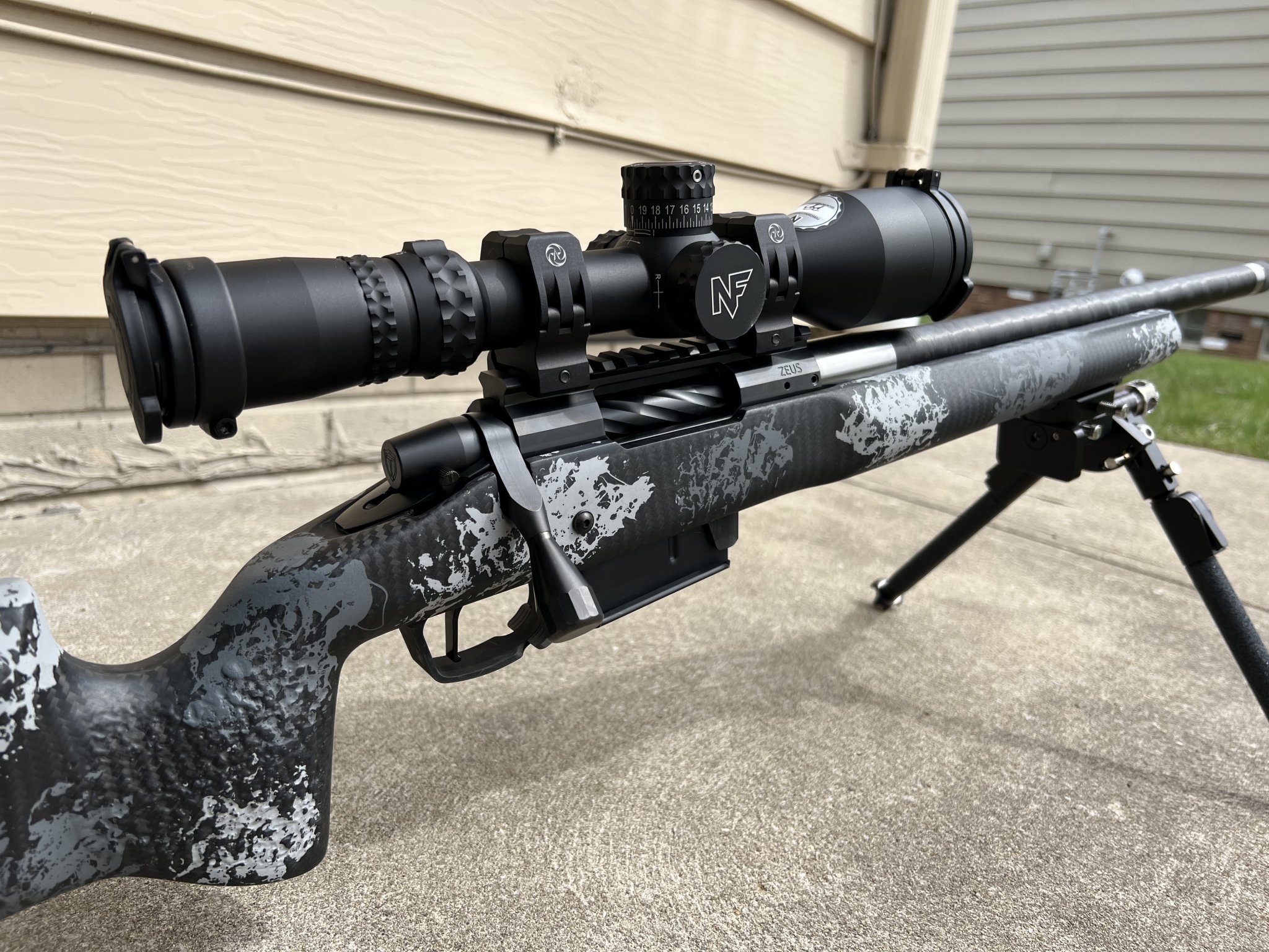

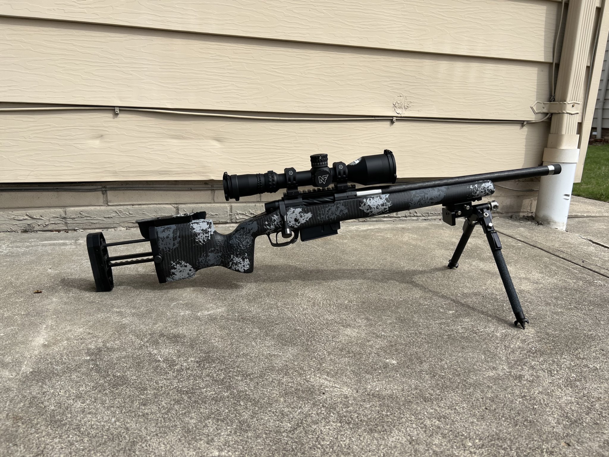

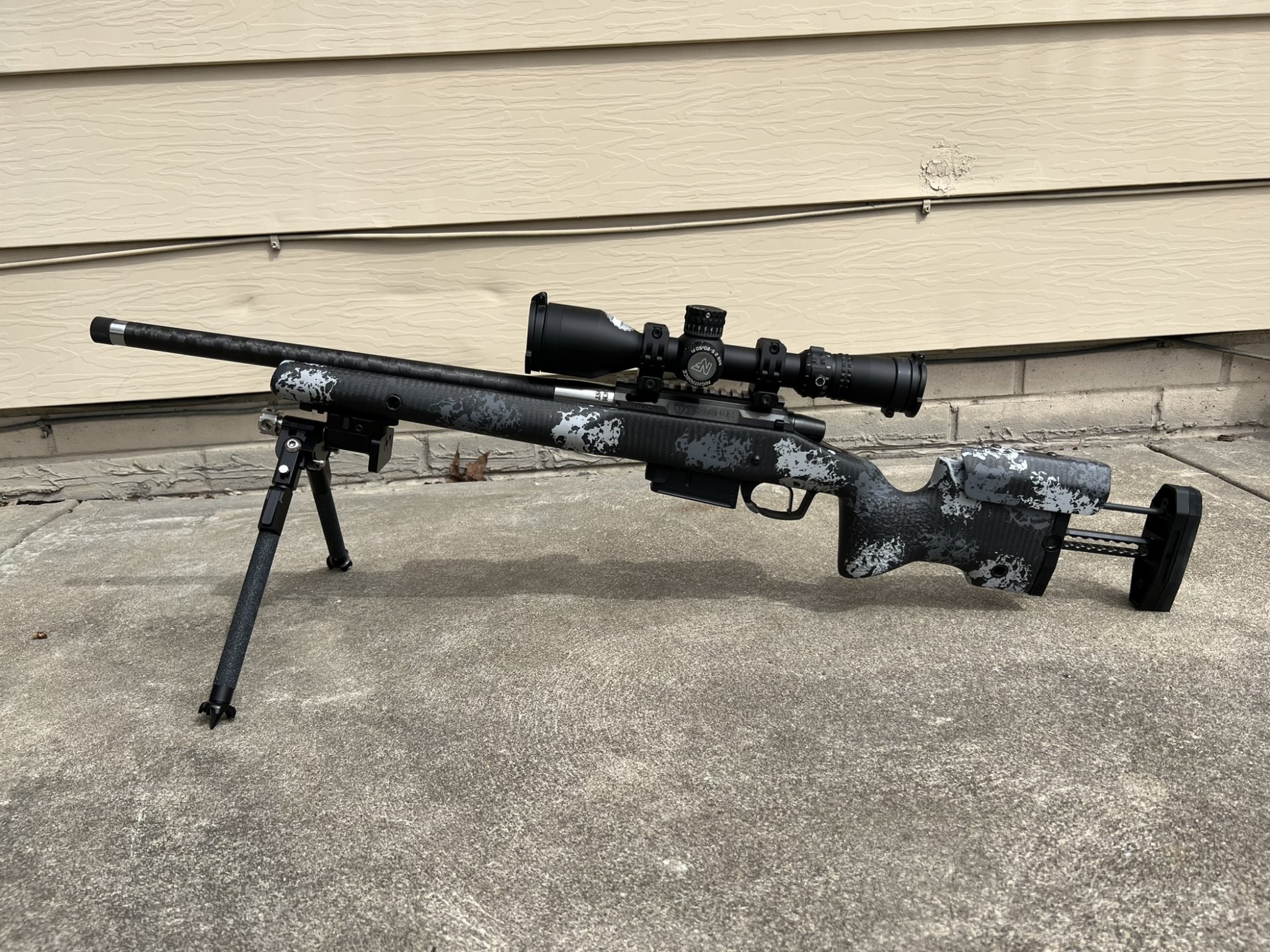

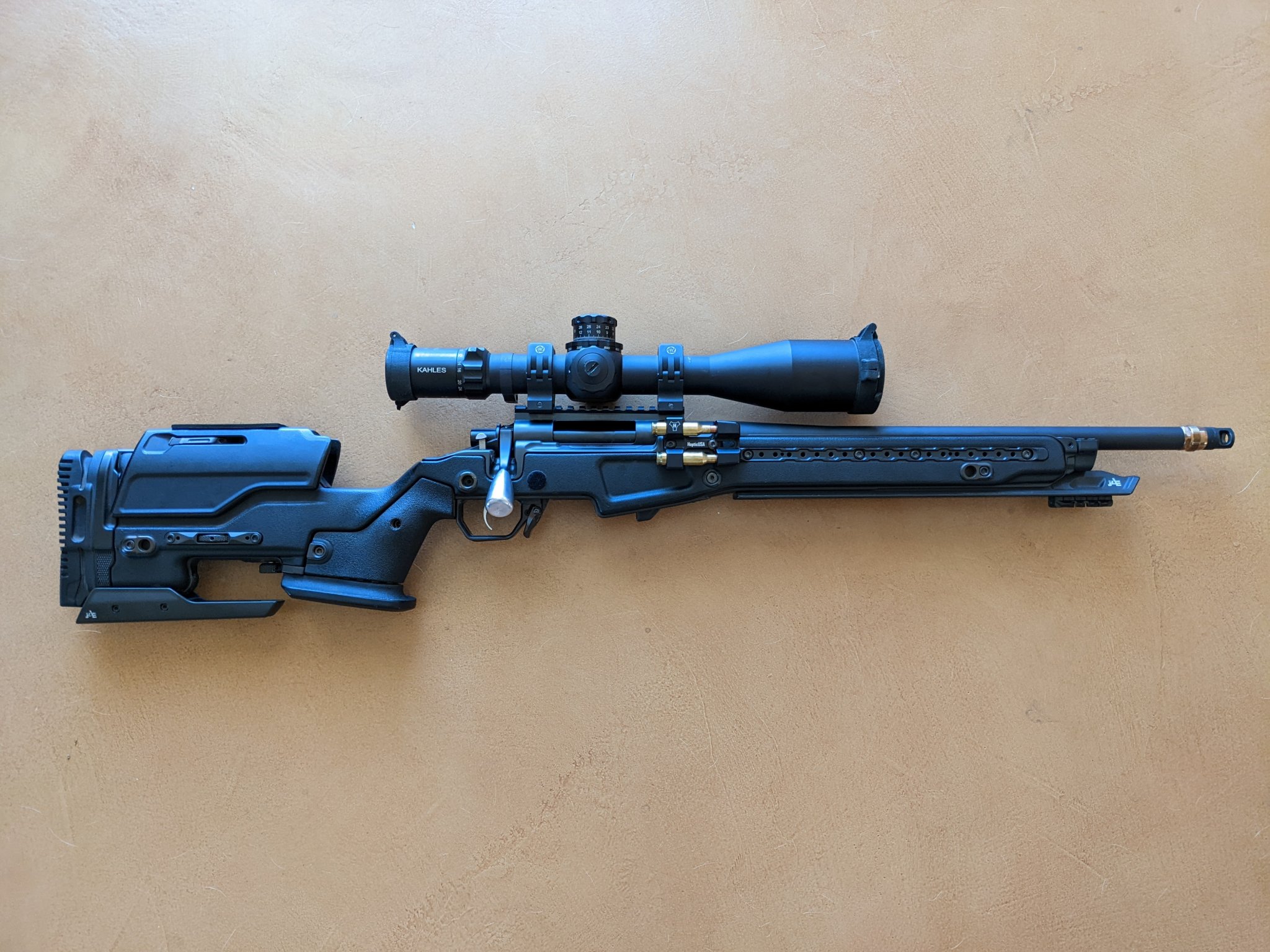

I've shared this rifle before but I've changed basically everything on it so i can't keep this from you!
Tikka T3x
17" X-caliber Carbon Fiber 6.5 Creedmoor
Grayboe Phoenix w/ my own paint job
Grayboe bottom metal
TBAC Ultra7 Gen II
Unknown Munitions Hunter Arca Rail
Vortex LHT 4.5-22
Sterk bolt handle
Nice! Does the x-caliber barrel use a nut? How was the wait time from them?
Tikka T3x
TBAC Ultra7 Gen II
Vortex LHT 4.5-22
Sterk bolt handle
What is the total weight? Nice build I’m looking for an 18in barrel for my tikka.
It does, it is one of their tikka prefits. I used an IBI barrel nut specifically but there are plenty of other options. I believe it took 8 weeks, they had quoted me 10-12 weeks so I was pretty happy with that. I did not pay extra to expedite it.
