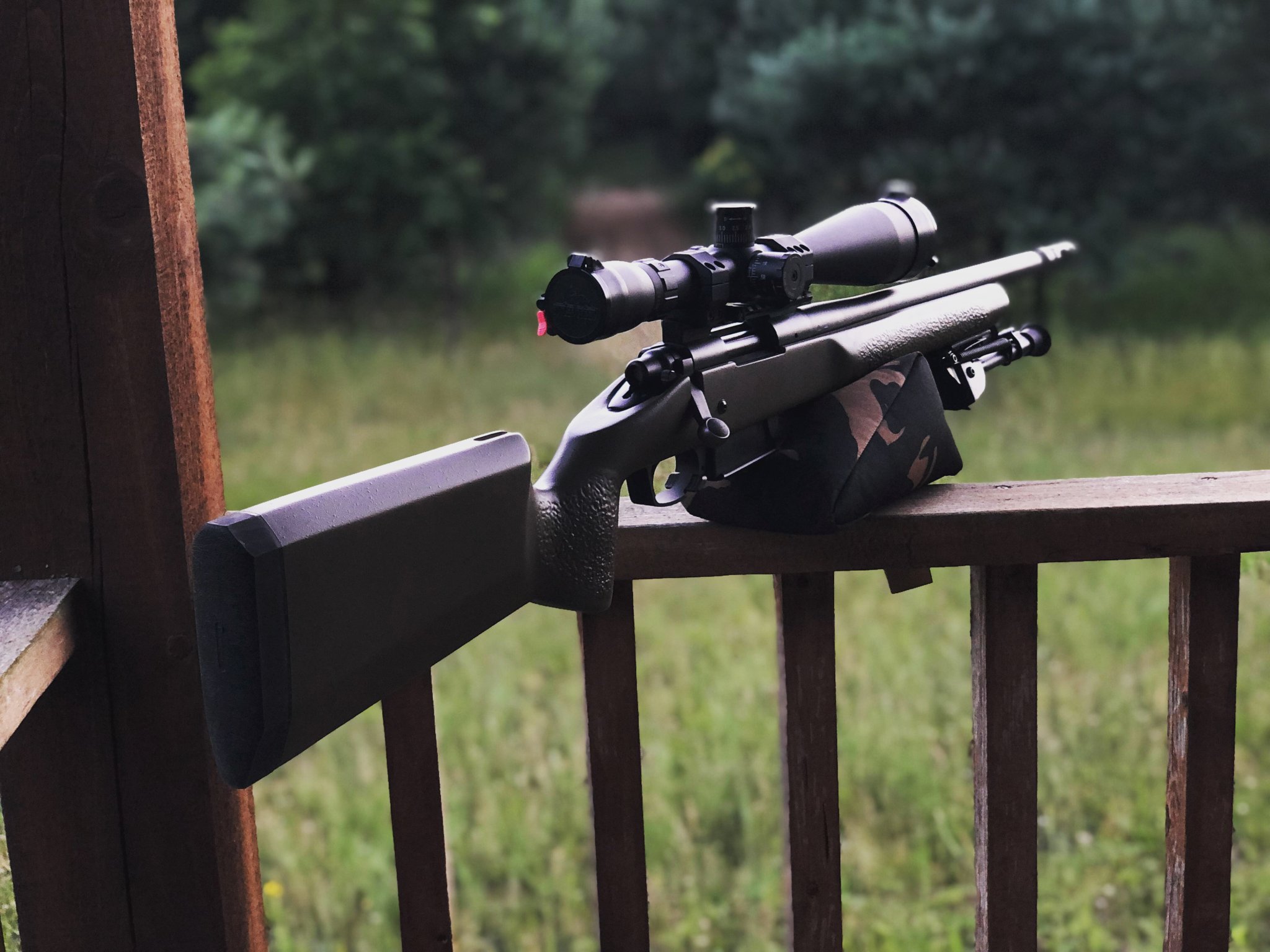

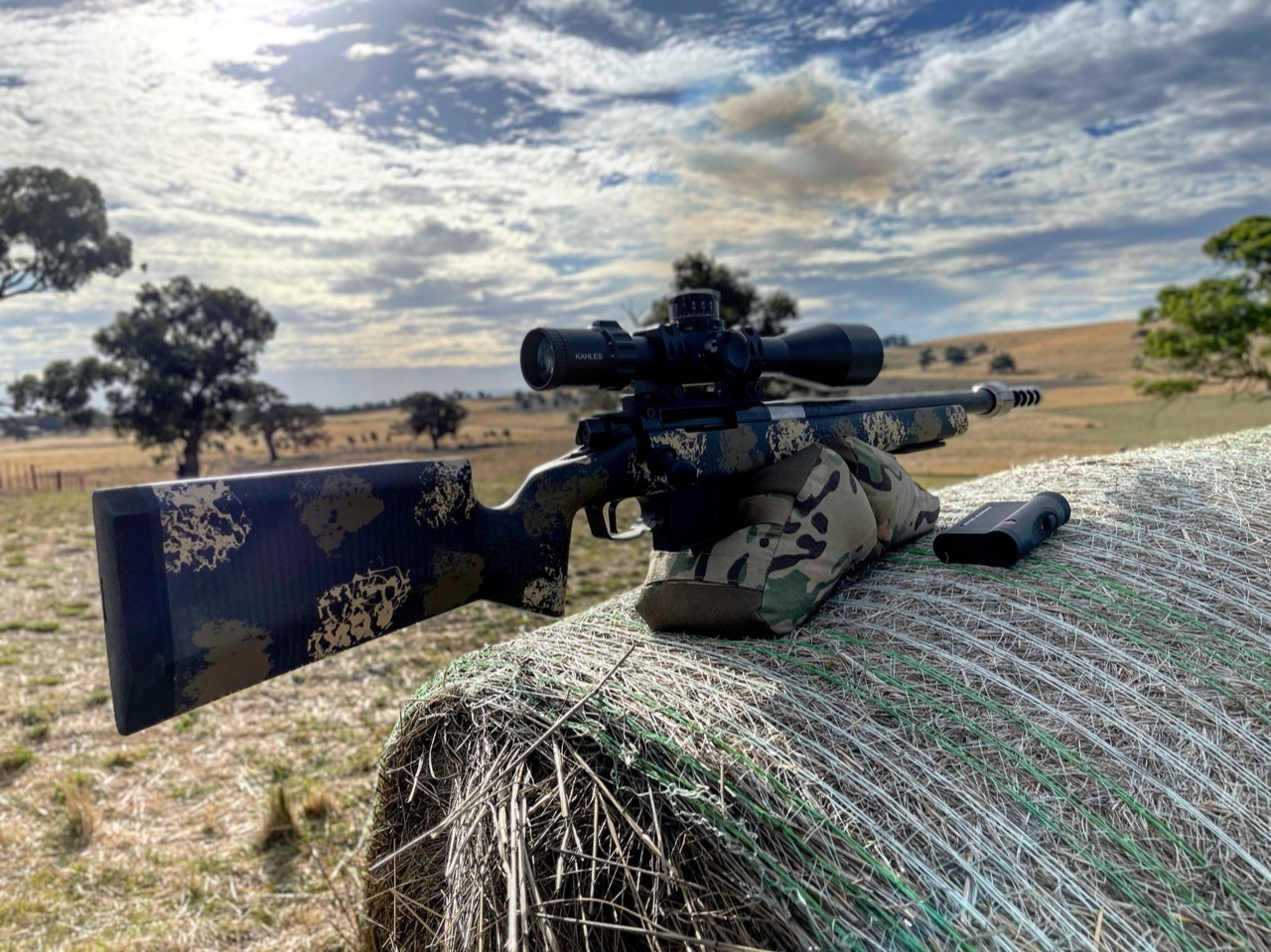

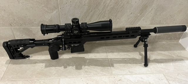

More specs and what do you mainly use it for?
Looks like an awesome hunting rig

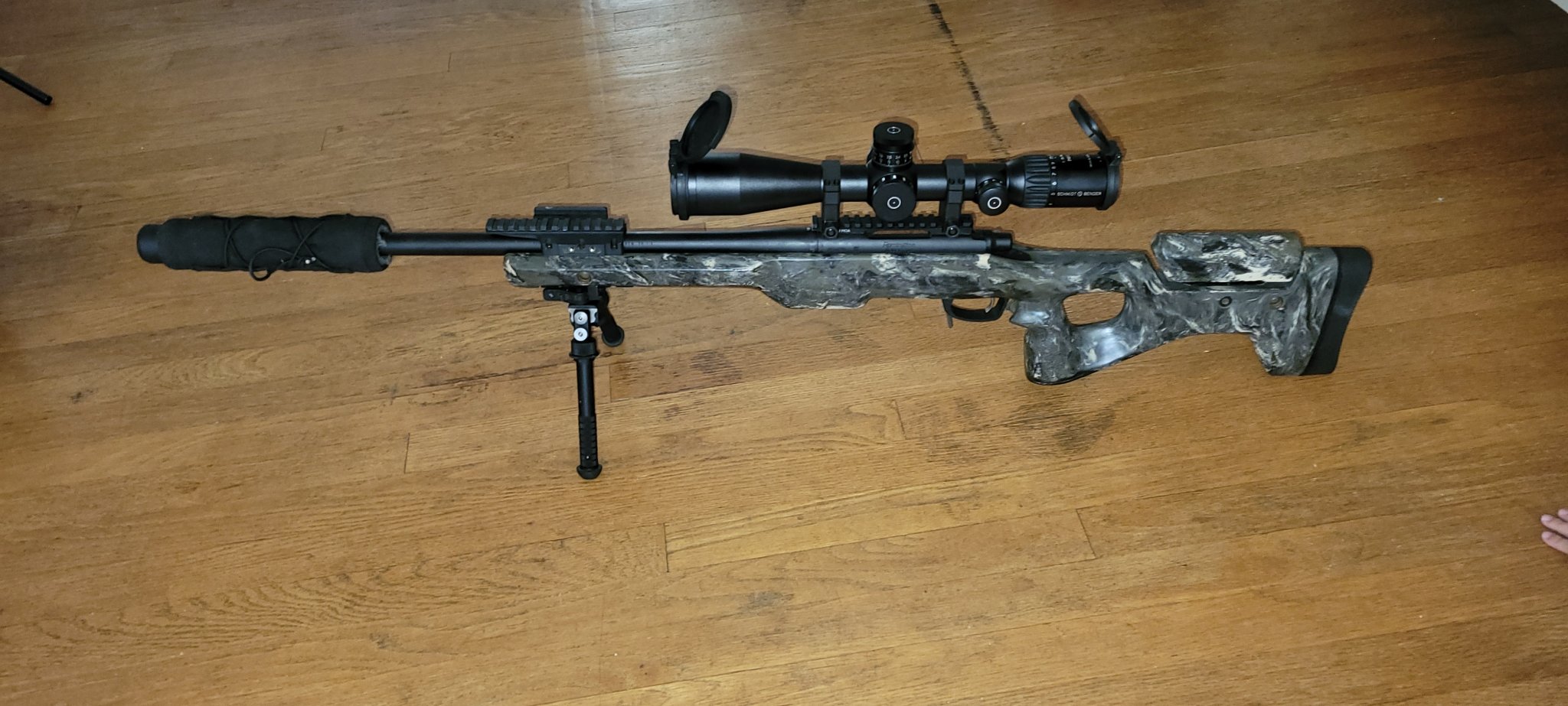

Origin, 16” proof chambered by crown ridge. TT diamond 2 stage, Manners EH1 bedded by Beanland and Hawkins hunter dmb
It looks like a great little toy. Just curious, with kind of purpose did you have in mind when you built it?
Something fun to shoot pigs with. Had a bunch of brass from my AR and wanted something cheap to load for.

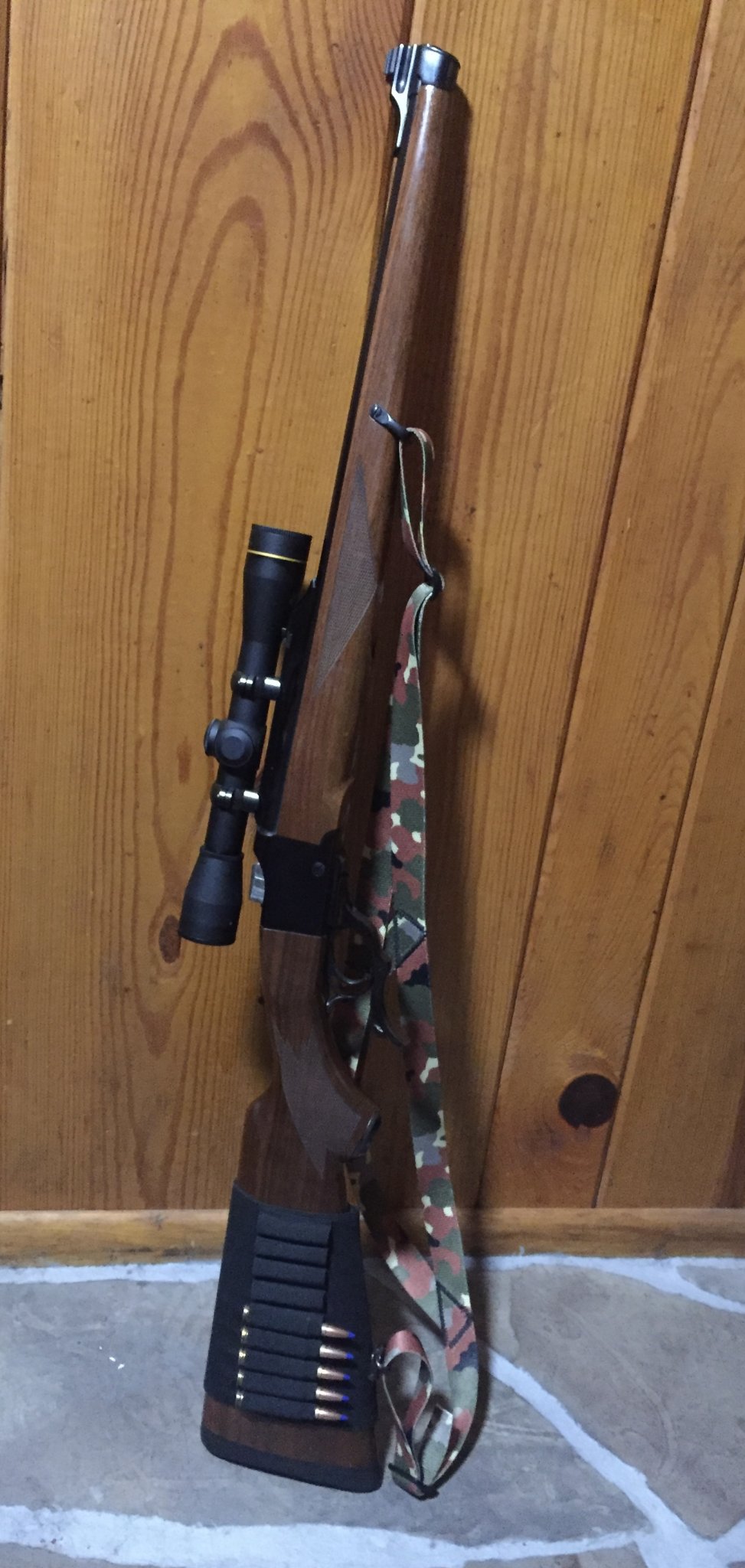

Just got a 17" .280ai Kimber Hunter that I'm going to run suppressed all the time for hunting. Don't have pics yet, haven't even mounted a scope, and still need to get it threaded, but I did Chrono some loads to get an idea of what it will do.
162gr SST (all I could find)

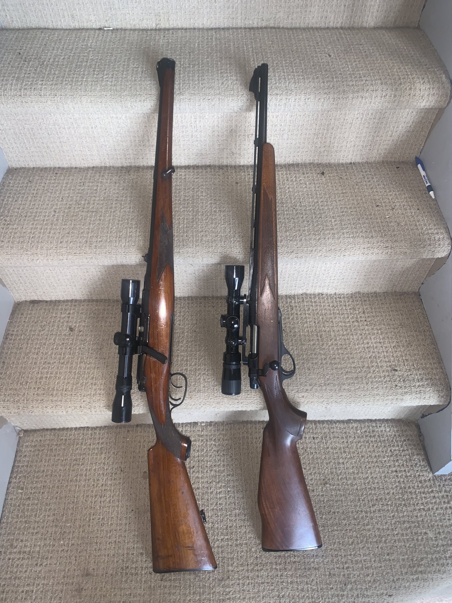

I’ve always been a fan of those. My old No. 1 is similar. 20” barrel but because it’s a single shot, it’s as about as short as most 16” barreled rifles.

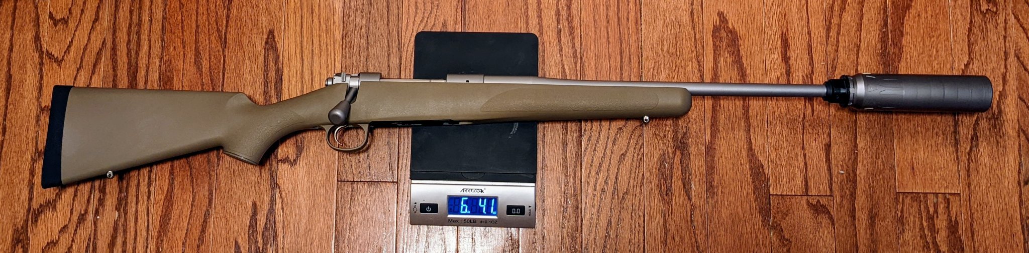

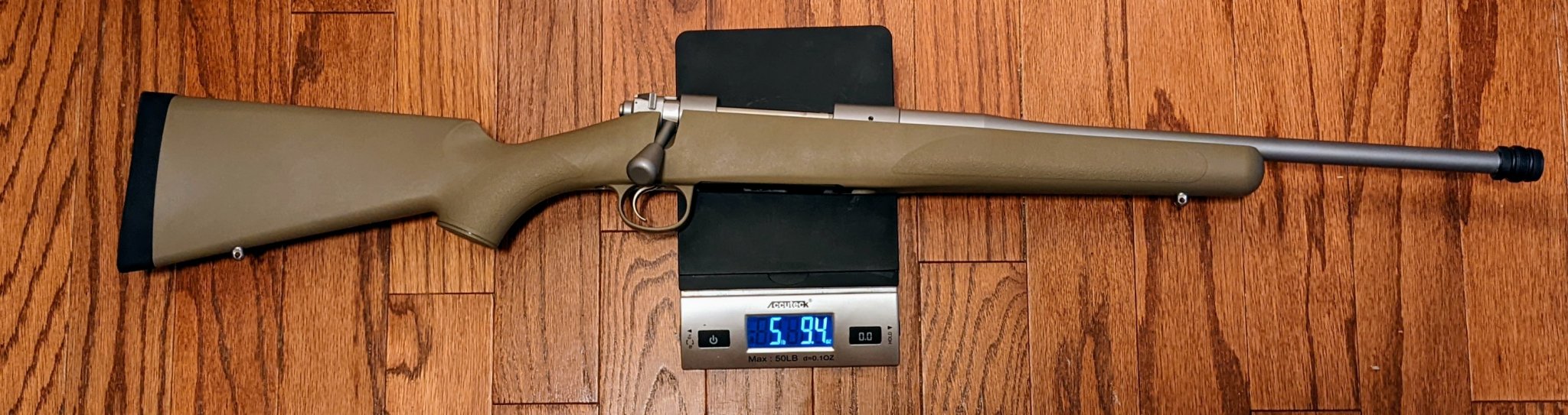

Time for an update on 16-18 inch shorty rifles - Plebe Edition.
I got my Kimber Hunter back from being threaded at Ecco machine, 1/2x28" was the only thread that would fit, but that's fine, I mounted a DA Xeno Xero and will be running my Nomad Ti (equivalent barrel length with can mounted is 23.75").
It's about 5.5lb with the Xero adapter and a mag, and 6.25lb with the can attached.
With the scope and mounts I'll be using, it should be ~7.5lb scoped and suppressed, and less than 8 lbs loaded, with sling and ready to hunt. I turned the trigger down from ~4.25lbs to a nice 2.75lbs. I picked up some 175gr ELDx from blue collar reloading last night, probably lose a little BC with the 9 twist, but it has a Bergara barrel like my other Kimber, so I hope it shoots as well, fingers crossed.
I shot one of those in 6.5 Creedmoor without a can and it was hands down one of the most unpleasant firearms I have ever shot just behind an 1895 in 30-06 with a steel carbine buttstock.
With how much the Nomad Ti takes the recoil and concussion on my PRC I’ve always wondered if it would make that rifle actually bearable to shoot.
Reactions: Boondoggle
I've got one of those (actually a Montana, but I also have a Hunter stock for it), but it has a 20" barrel, so doesn't strictly qualify for this thread:
It's not a heavy thumper without the can, but it's way more fun, and far easier to shoot well with a can on the end. 5-6 lb rifles are pretty difficult to shoot well, my whole intent starting with an ultralight rifle is to be able to be able to come in ~7 - 7.5lb suppressed and ready to hunt.
I'm guessing the last owner sold this 5.5lb, 17" .280ai because he couldn't shoot it very well, it (perhaps not coincidentally) walloped him pretty good with each trigger pull, and is preposterously loud. I'm counting on the can taking a lot of the punch out like they do for my other rifles, and I do plan on using the E-brake on my Nomad during load development for a little extra reduction.

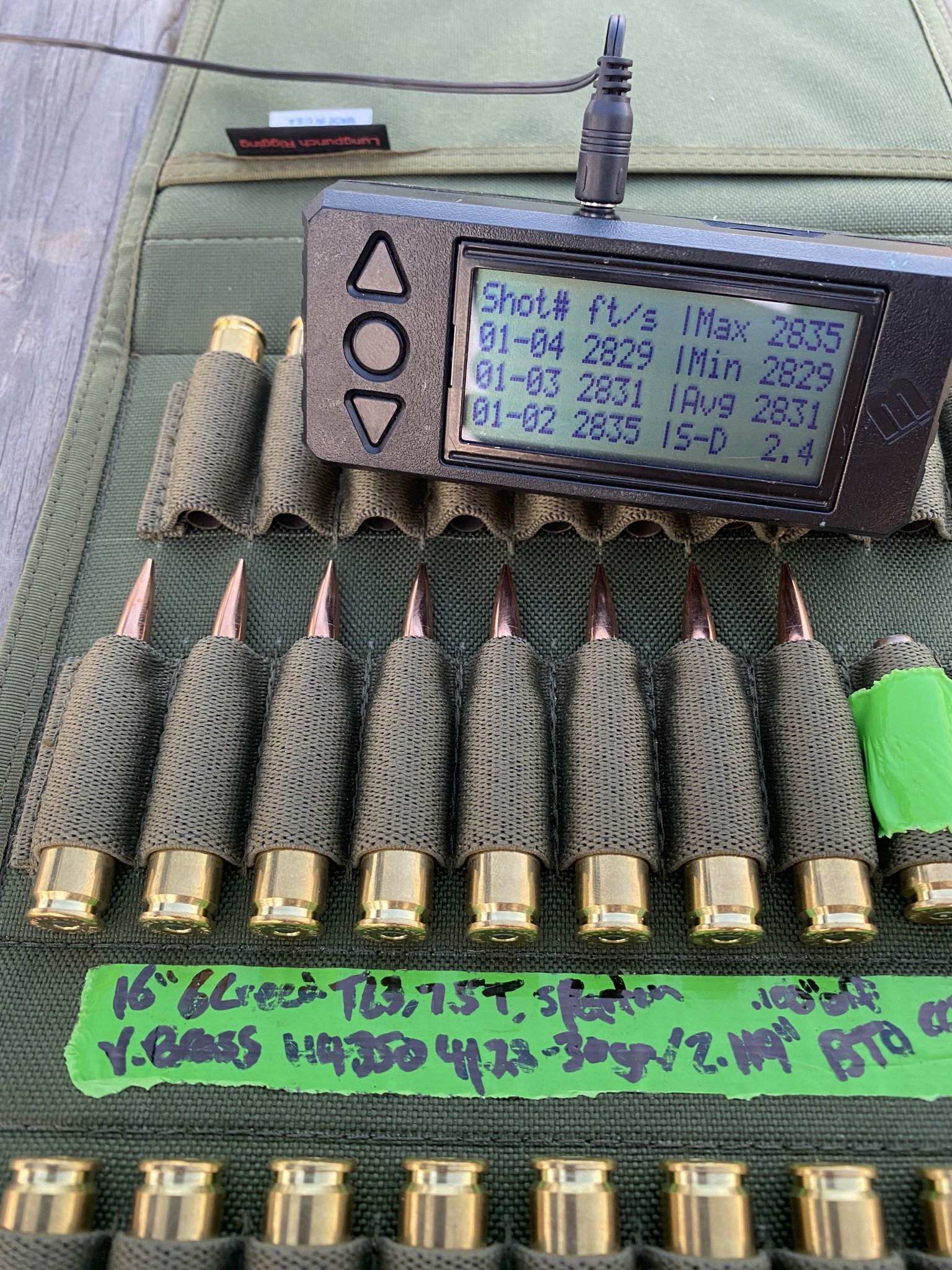

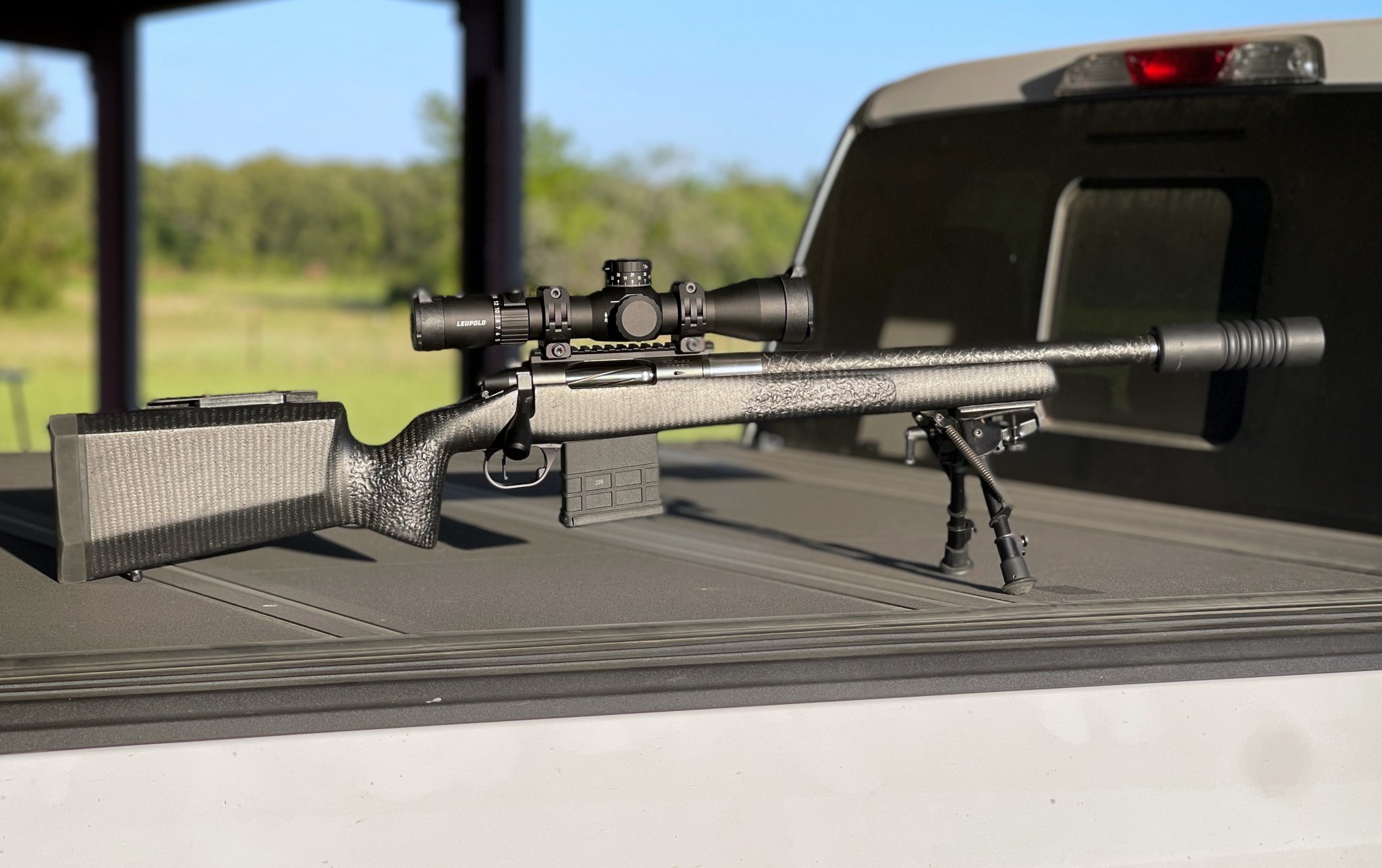

lil 16” 6 creed…. 10lb 4oz as pictured…

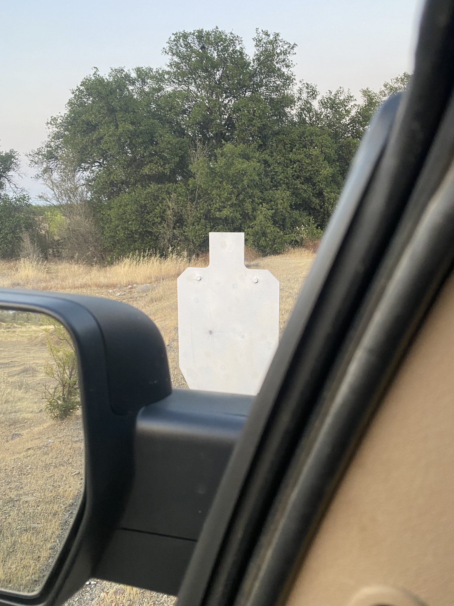

Update the 6 Creed is straight hammering. Waterline all day with 10.3 mil out too 1150 yds Is no slouch….

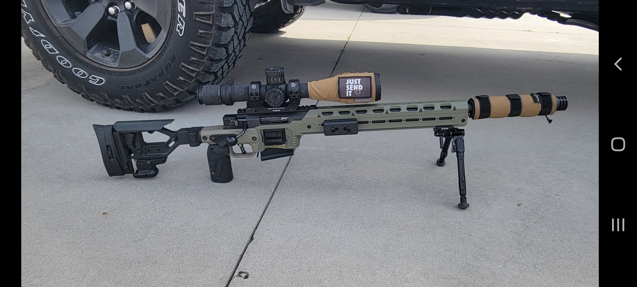

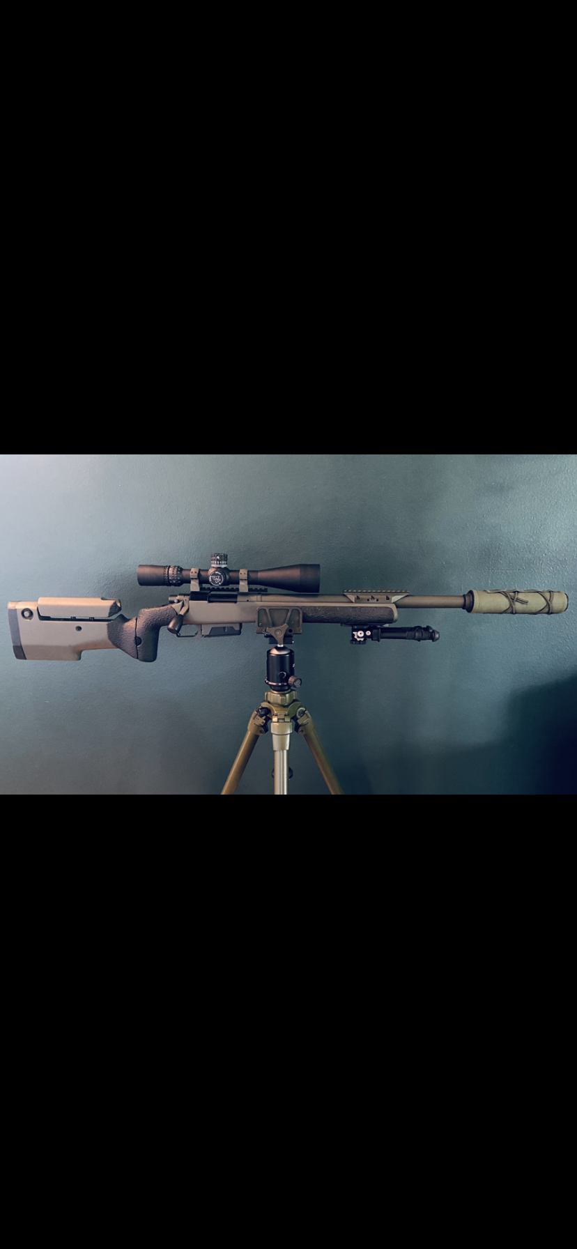

Not finished.
Still needs some cerakote on the barrel, the newer tuner brake and a Kahles 18i but it’s dropping roo’s like it’s nobodies business in the meantime out to 600m with just Hornady precision hunter ammo
Manners EH1 with mini chassis gap camo
ARC Archimedes action
Proof 16.5 inch 1-8 twist 308WIN
Withoutwarning tmb
ARC rings
Kahles 525i
Henderson arca rail
Triggertech 2 stage special
ARC mag
Nice setup…interesting choice in twist. What is the reason for the super fast twist for 308?
