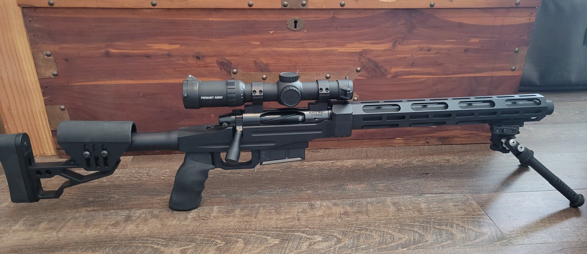

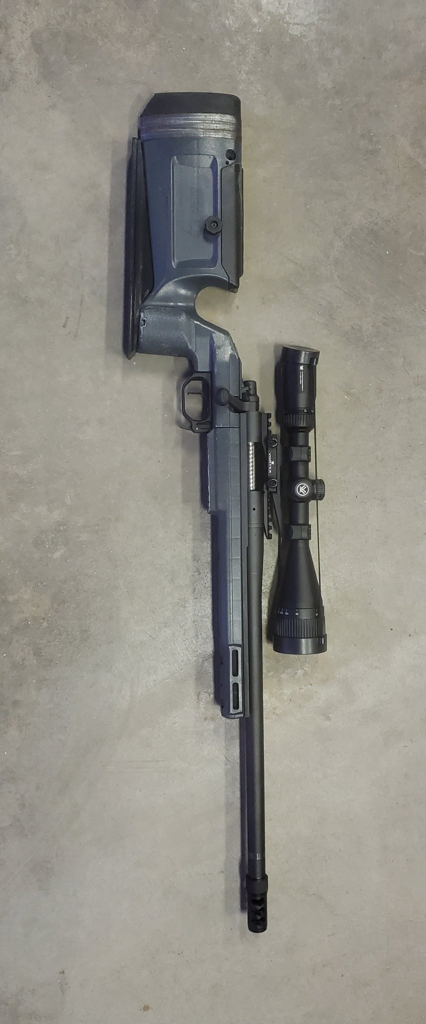

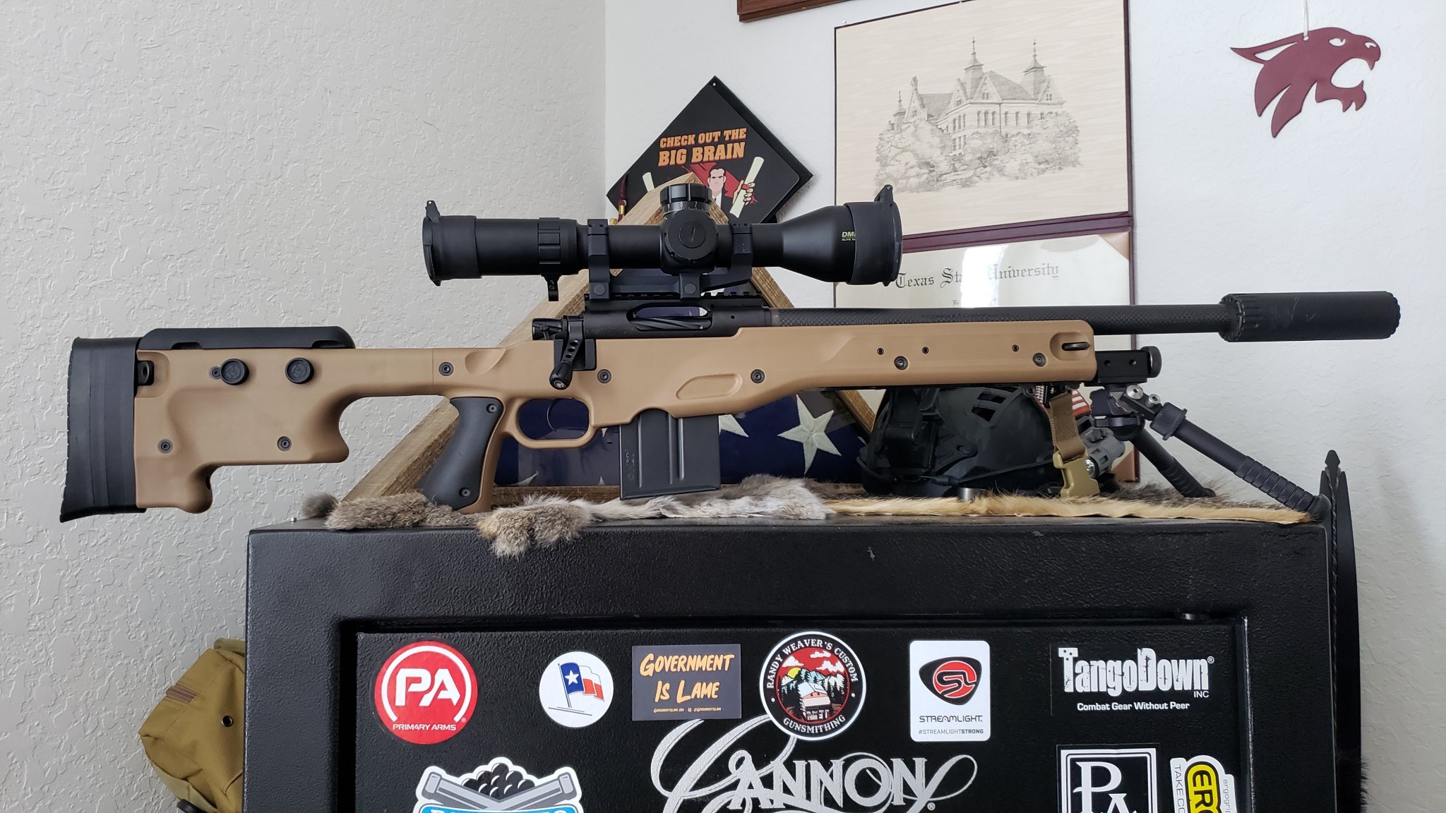

Threw together this budget build as a backup/ loaner rifle for any of my buddies/ family that go out with me.
-factory rem700 .308 sps varmint cut down to 18" and threaded.
- krg bravo from here on the hide
- area419 hellfire from here
- area419 curved scope base (20moa)
- vortex high cantilever mount
- vortex crossfire 2 (4-12x50)
- TT special flat.
built it pretty cheap and just going to run whatever factory ammo works good for it. Will probably thread the bolt handle and throw a knob on it this week.

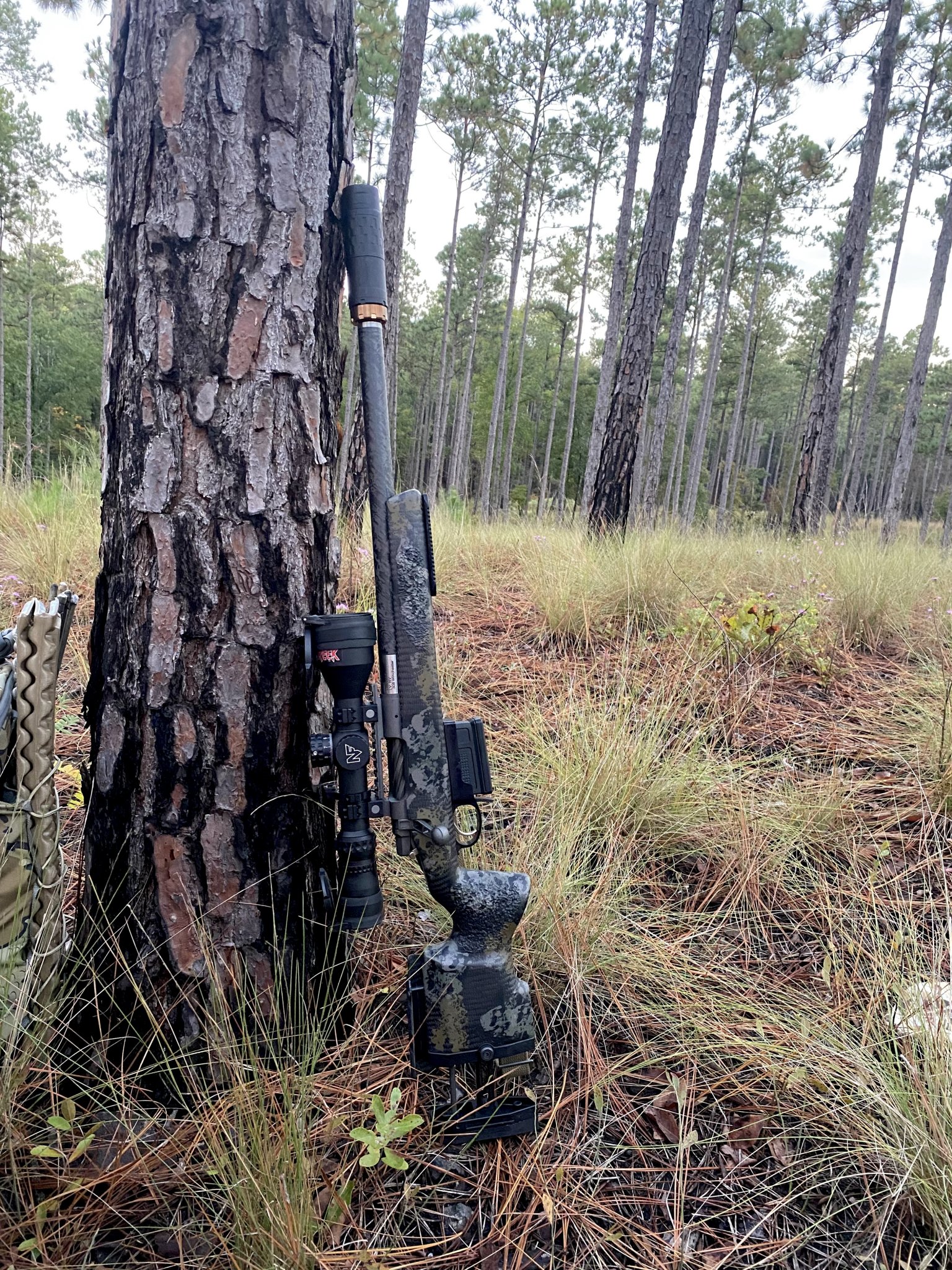

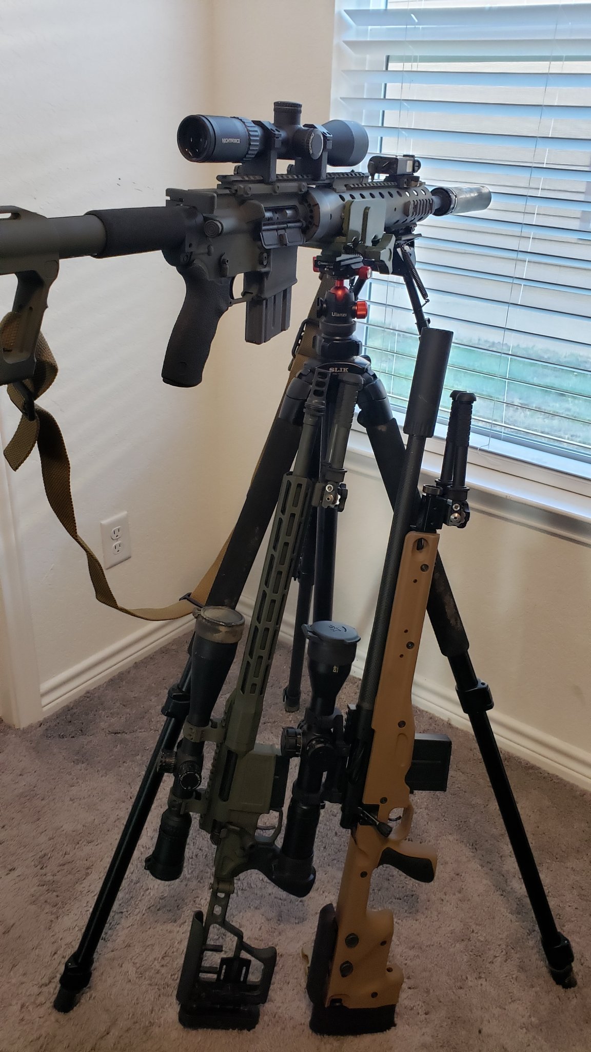

Just put together a new one for night hunting coyotes. Will be swapping out to the thermal after I get the loads worked out and barrel broke in. Plan on running 65vmax's fast and flat. Initial loads look like Berger 108's will be about 2775 fps and Hornady 65 VMax's will be about 3650fps.

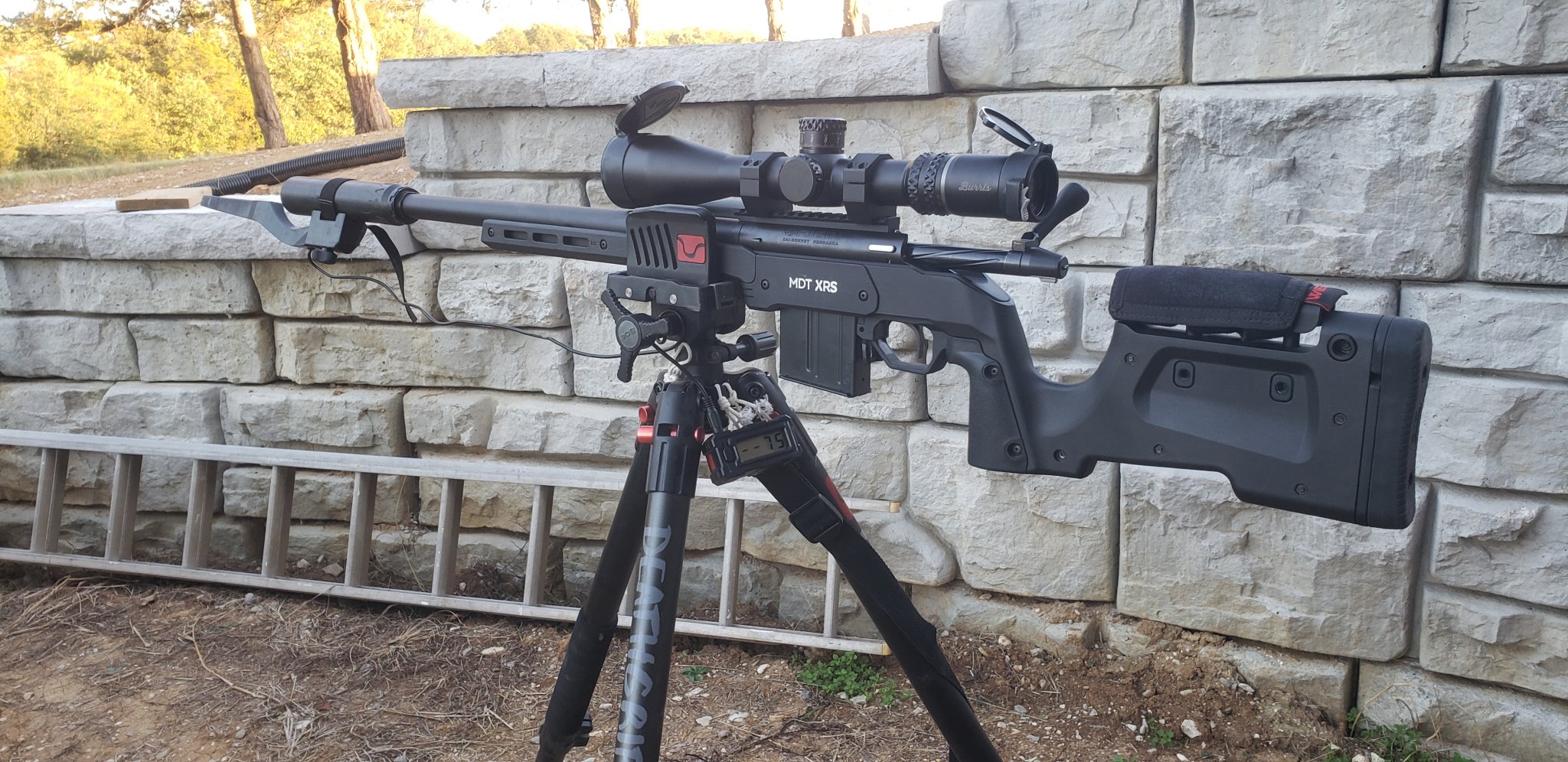

Bighorn Origin
MDT XRS
Timney 2 stage
18" 6 Creedmoor
Dead Air Nomad L
Burris XTRIII

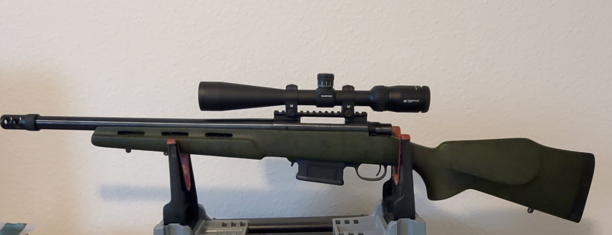

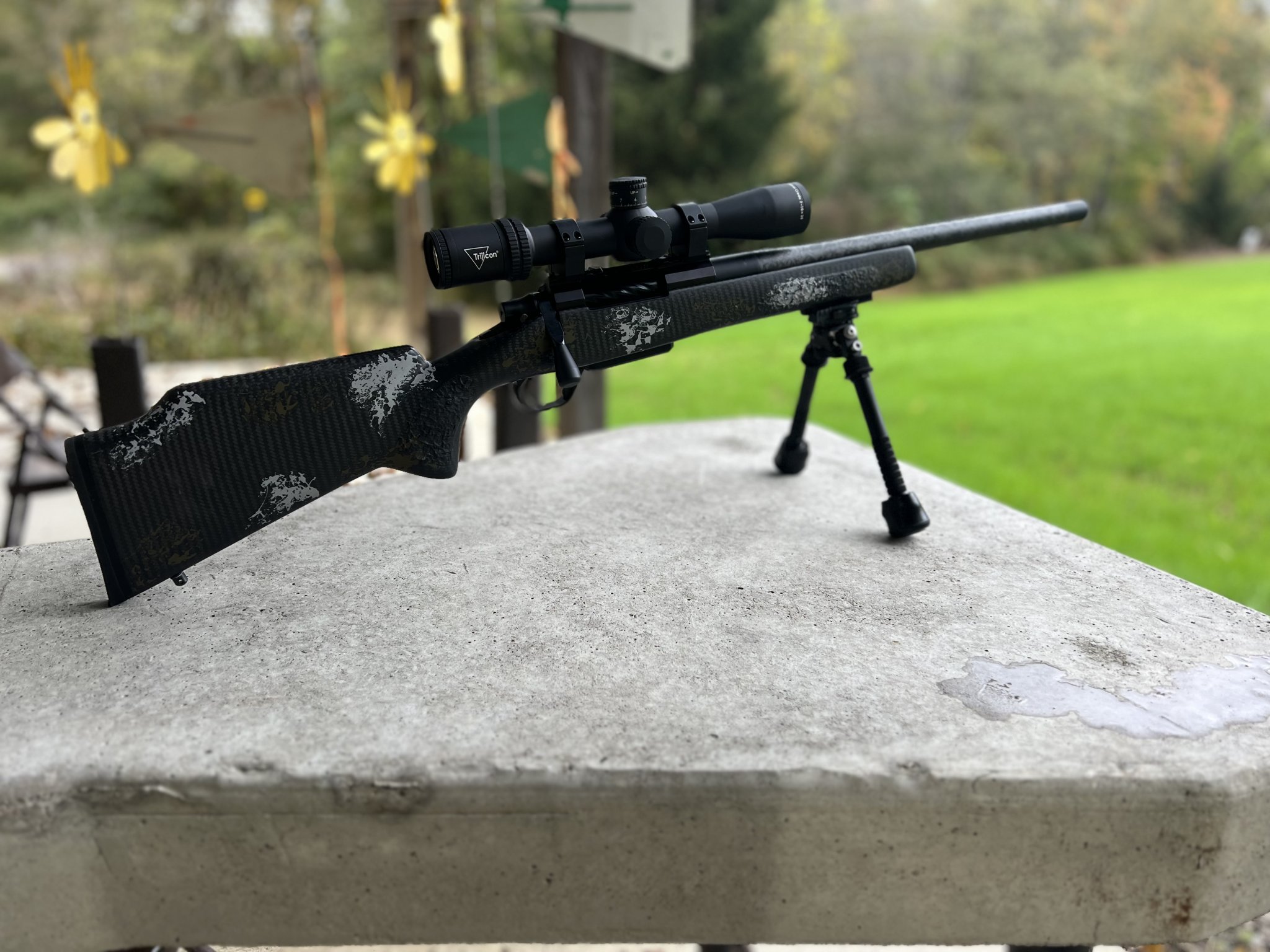

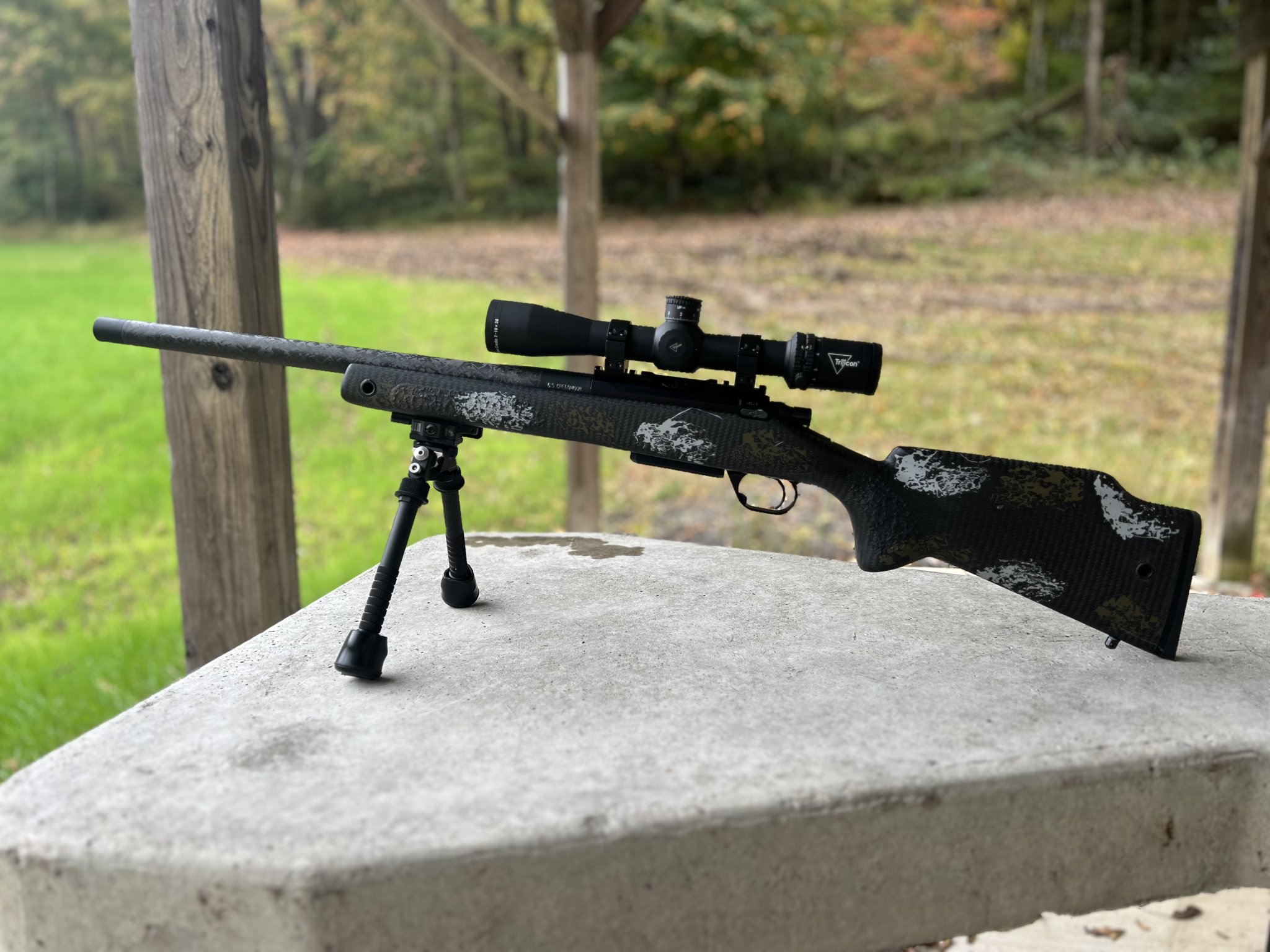

Howa 1500 HB cut down from 20" to 16.5". Was my first "precision" rifle a bunch of years ago. Shot good out of the box in the factory stock and then I dropped it in the B&C and it shot really good. It loved Berger 185 Juggernauts and with the 20" barrel it would them in at 1000 on a 12" plate very consistently at 2535fps.
After I had it cut down I tried almost a dozen bullets in the 165-168gr range and couldn't find anything it really liked especially at mag length. Stumbled into the Berger 155.5 and it shoots them lights out.
It shoots them so good I shake my head at it being almost as accurate as rifles I have that cost north of three times as much and so much so I've got a much better optic on the way for it.

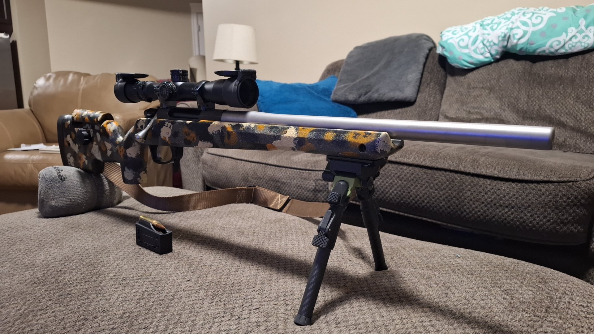

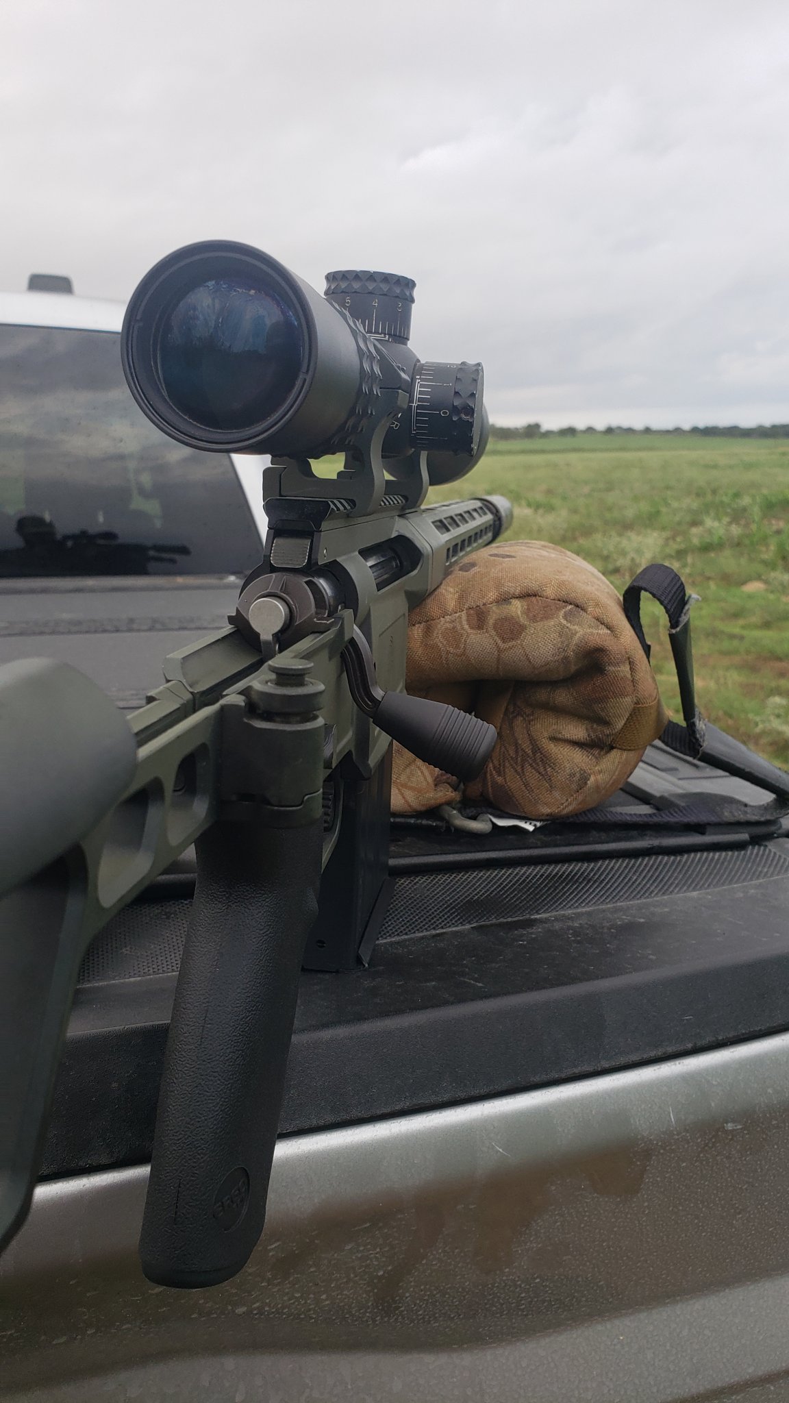

Finished this up finally
T3x action
18" Bartlein rv 11.25t 5r ss in 308w
PR Precision Bolt w/tikka handle
Atlasworx bolt shroud
NXS 2.5-10x32 w vortex caps
30mm optilock low ringmounts
PSE Etac stock
Atlasworx aics dbm
1lb trigger spring
Amazon arca plate on fore end
9lbs on the money without the bipod
Haven't shot it yet, this weekend I will. Got the typical 168 smks loaded up with some varget in petersen srp brass with br4s. Gonna try some 155 scenars, 110vmax and 125 nbt eventually too. Pushed fast of course lol
