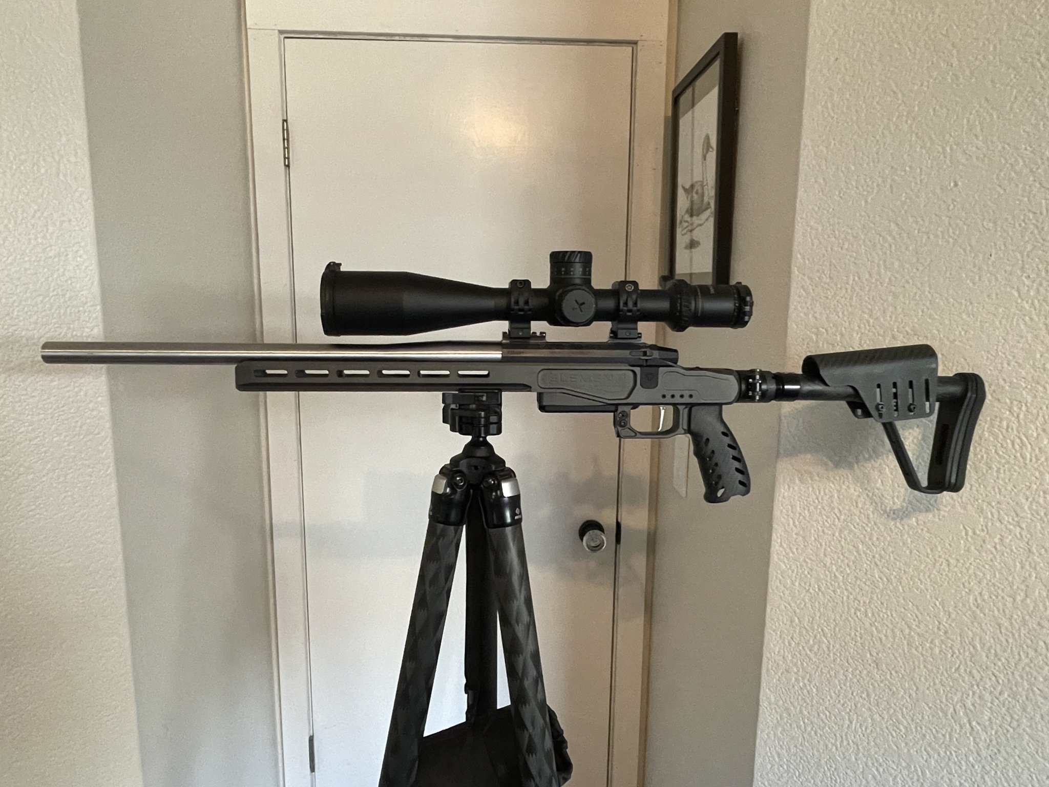

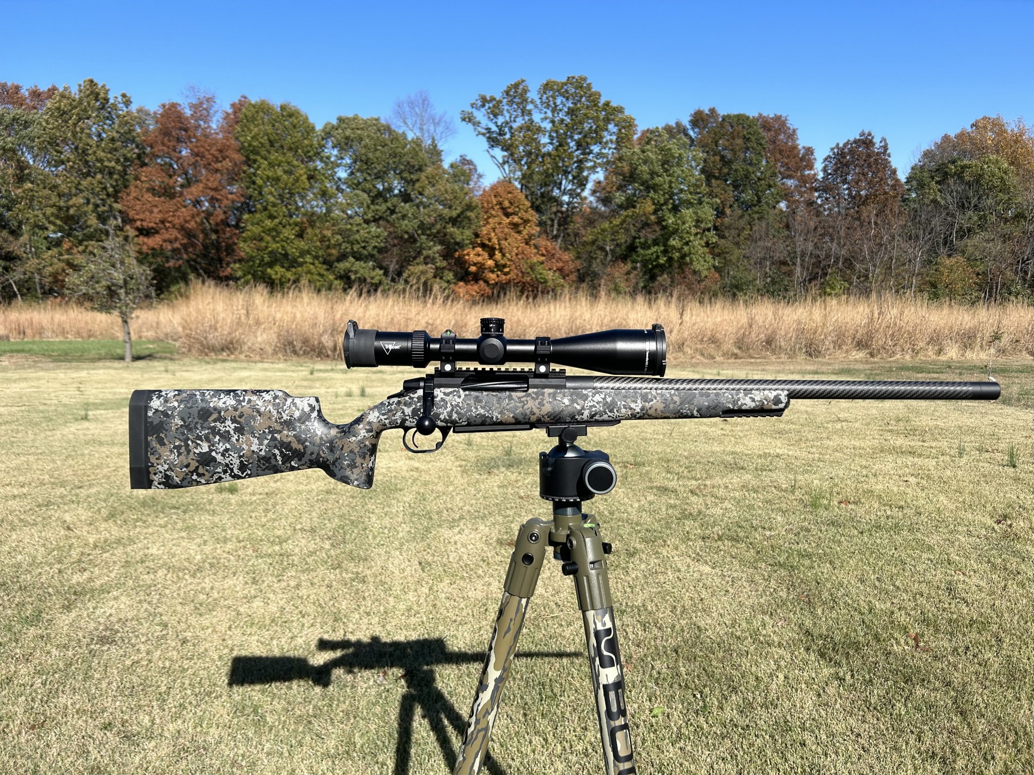

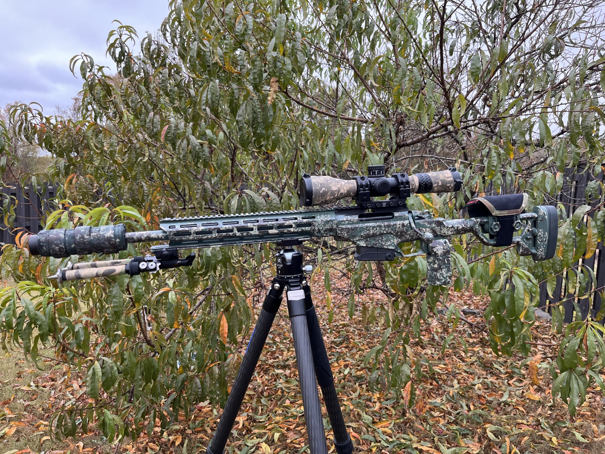

Not a build yet but its a start will be a 16in 6.5cm when complete will see what black friday brings aero solus action i picked up on here

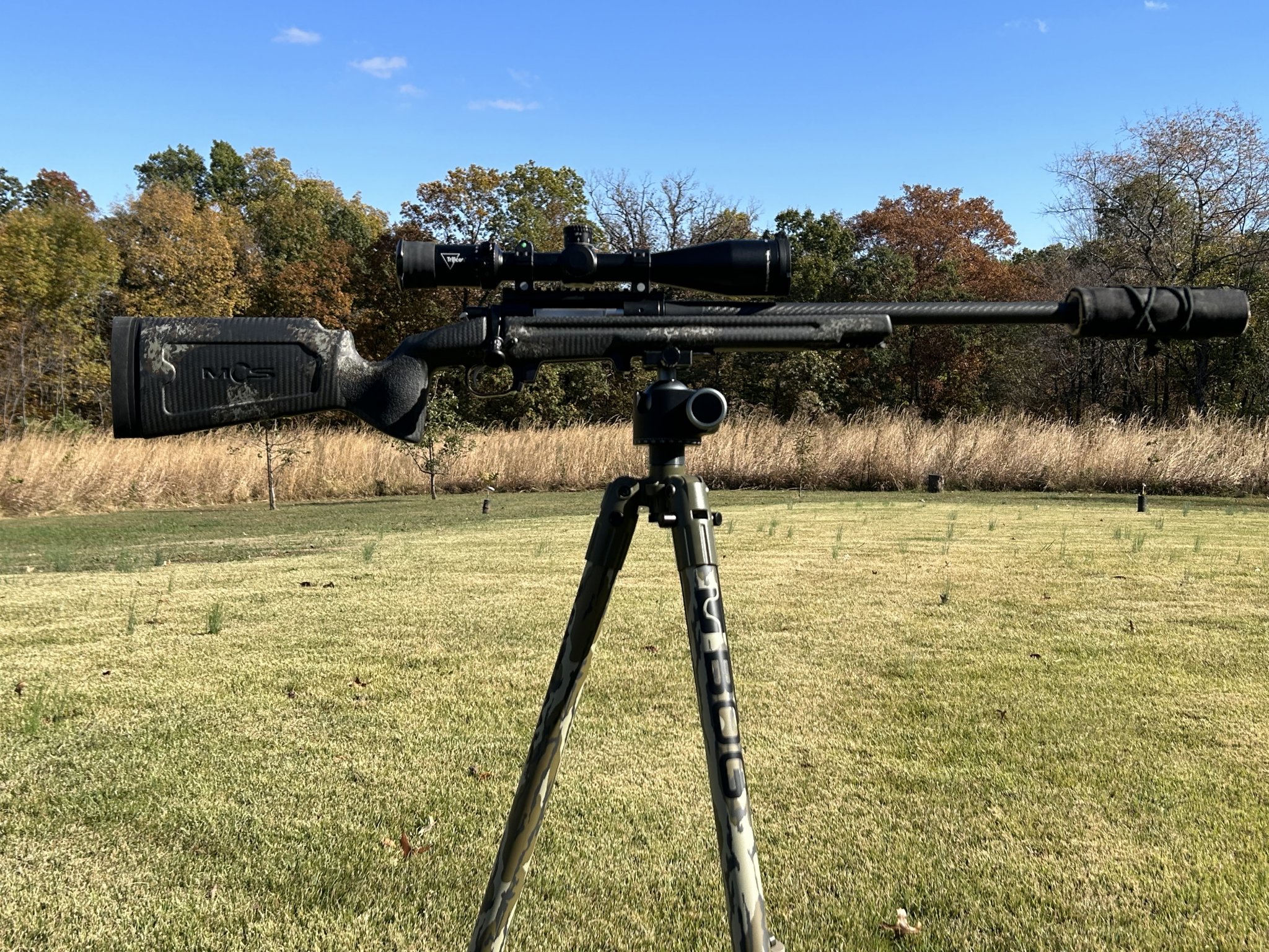

Finished this up finally

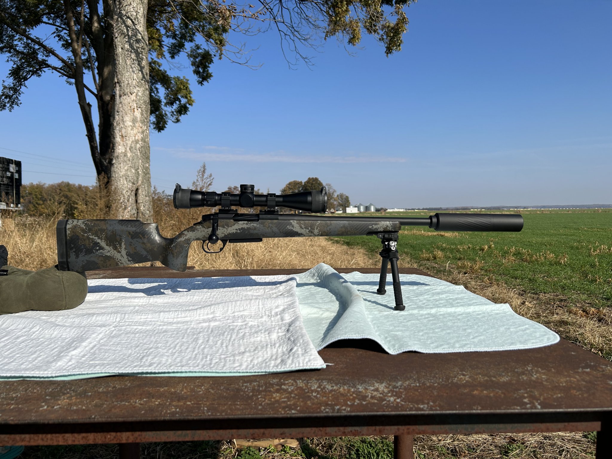

T3x action

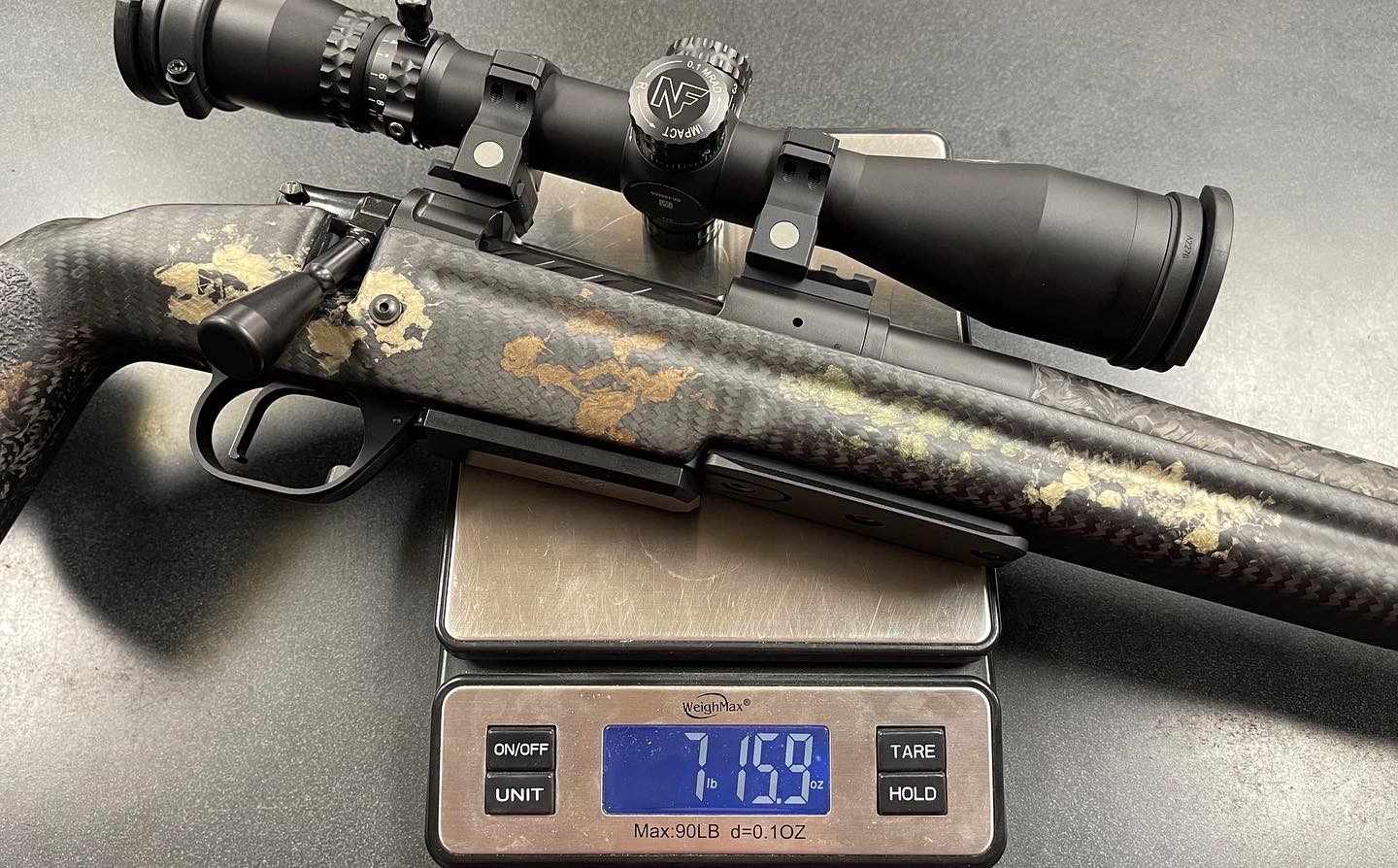

18" Bartlein rv 11.25t 5r ss in 308w
9lbs on the money without the bipod
Haven't shot it yet, this weekend I will. Got the typical 168 smks loaded up with some varget in petersen srp brass with br4s. Gonna try some 155 scenars, 110vmax and 125 nbt eventually too. Pushed fast of course lol

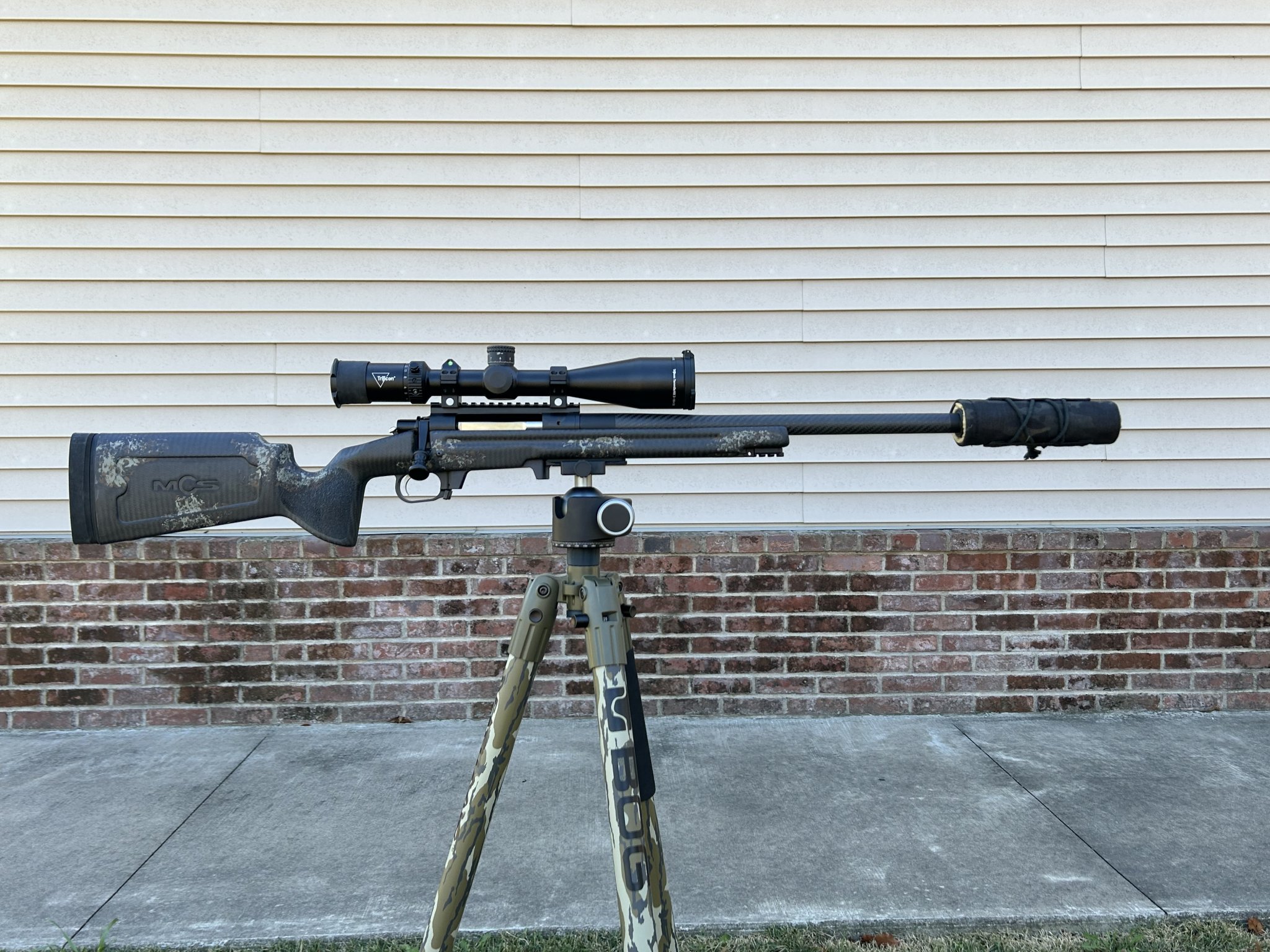

Nice! I have a 16" 11tw Tikka running 125gr Speer TNTs at 3075fps.
Reactions: noremorse92
Would you mind sharing the build specs of your rifle? Thank you.
I'm curious about the weight too, I have kind of a Walmart version of that rifle going together, Tikka with Stockys carbon stock and a 19" featherweight carbon-six barrel in 7 PRC. Bare rifle weight should probably be similar though.
Reactions: jmw

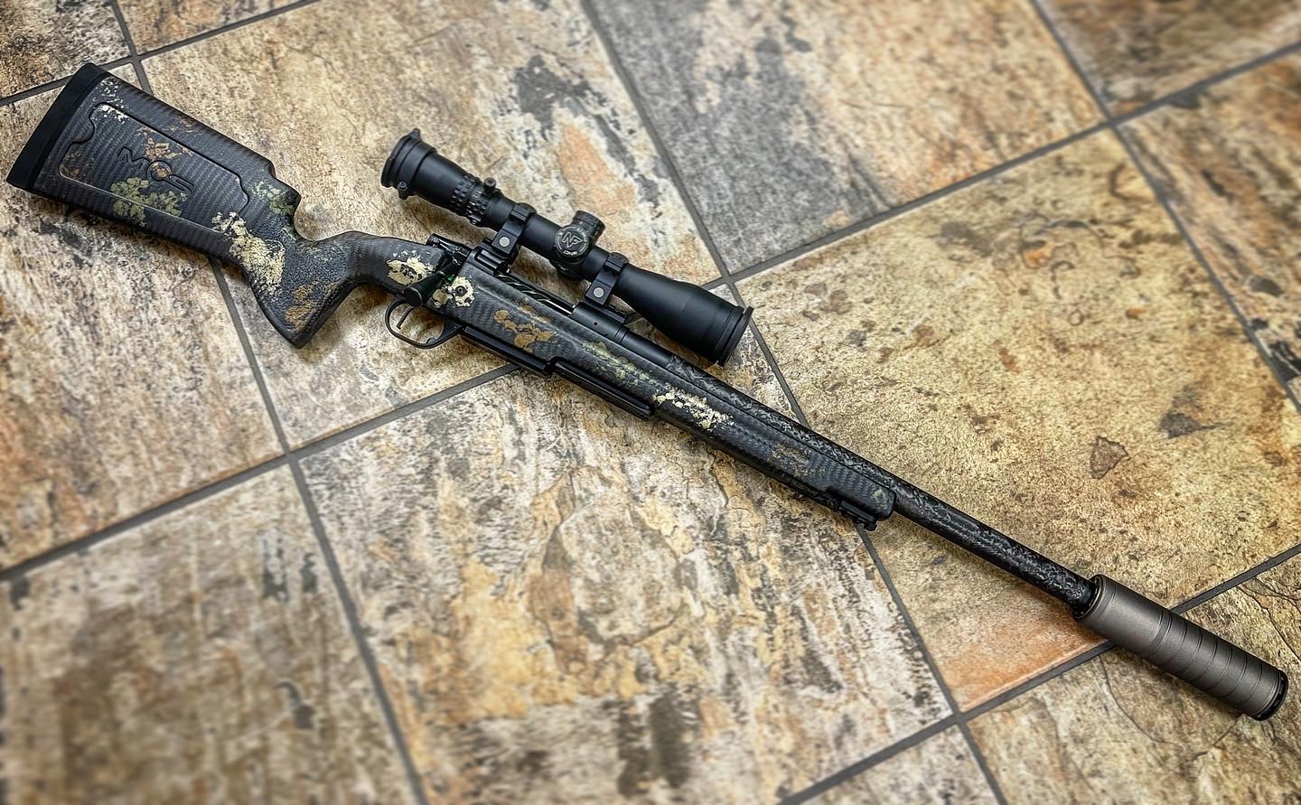

M5 mausingfield action
TS customs benchmark sendero 7prc 535 base reamer
Manners pro hunter
Bix n andy tacsport
Hawkins metal, will be switching to Hawkins hunter metal when it becomes available again
Trijjicon tenmile, Hawkins ultra light rings
Ultra 7, will be putting a Magnus on it if I ever get it out of jail
9.1 pounds the way it is in the pic, including magazine, edit: not counting suppresser. I did not weigh it without scope
First few shots with 175 elite hunter and re26 are 2680. Just what I threw together. So I would expect around 2800 when barrel breaks in and some load development. But may switch to 168 vld. I will update when I get time to actually play with this rifle

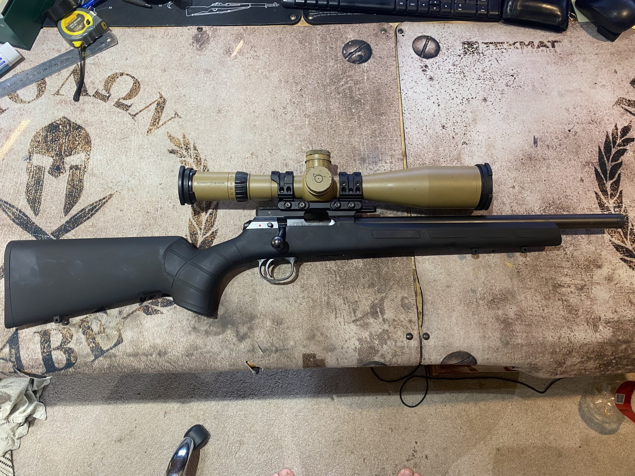

Here is a new rifle I just received yesterday
TS customs 7prc benchmark sendero 22”
Impact 777
TS customs ks1 stock
This one is waiting on a tbac magnus as well.
Trijjicon tenmile Hawkins ultra light rings
I will post the difference in the mv between the two new and when barrels are broke in
How's do you like the speer tnts? I did an initial load with their 168gr match bullets last weekend. 45gr varget, cci br4 in Peterson srp brass 2.8 coal got me half inch for 9 and the 10th at .76. Rounds 51 through 60 on this barrel.
I was quite impressed so loaded another 50 at that spec to test this weekend.
Also going to test repeatability with the 223 barrel and find scope offsets and test rtz from caliber switches.

Not handloads, but getting 2650fps with Factory Berger 156g ammo out of an 18" Proof Carbon.

I just put it together, actually waiting on another PH that doesn’t have the mini chassis. Going to bed and cerakote the suppressor at the same time.
Mack Bros EVO II TI
Proof 18” sendero
TT Diamond 2-stage
Hawkins hunter dbm and mag
Beanland chamber and cerakote.
Reactions: powdahound76
You gotta tell us what bullets and speed you are getting. Everyone secretly wants a short magnum like this.
18” 7 prc is getting 2868 with re26 and 168 Berger
22” 7 prc is getting 2941 with re 26 and 175 Berger.
Both are new with only about 15 rounds on each of them. So I would think the 18” should easily see the 2950 plus range, and the 22” 3050 plus range.

Just finished chopping this one to see if I’m OK moving forward with a hunting rifle this short. Want to swap the 5-25 for a 3-15 or a NXS 2.5-10 and a thinner contour barrel if I like it. Even with the barrel, scope (2.5lbs), and rings it’s 10lbs 10oz.
Lone Peak Fuzion SA in 6.5 creedmoor. Will shoot this and get a 7mm of some type (debating SAUM vs Sherman Short) should I enjoy the shorty. Not sure why I wouldn’t, it’s fantastic when folded.
What length did you chop it to?
I think it came out to 18.5”. In California so no supresor option. Started as a 26” and the cut piece weighs 1lb 1oz. Balance is off, but for now it’s an experiment.
Looks good, hate to hear you can’t have a suppressor. I have two and have my eye on a few/couple more as we speak 😂
I have only shot them with ultra 7, and the recoil is not bad at all, nothing like a 300 win mag. I just pick up my tbac Magnus today and I am curious how the recoil feels with it, I would think a little less recoil. I would suspect that without suppressor it would be like a 7mm rem mag as they basically have same powder capacity
Reactions: shields shtr
