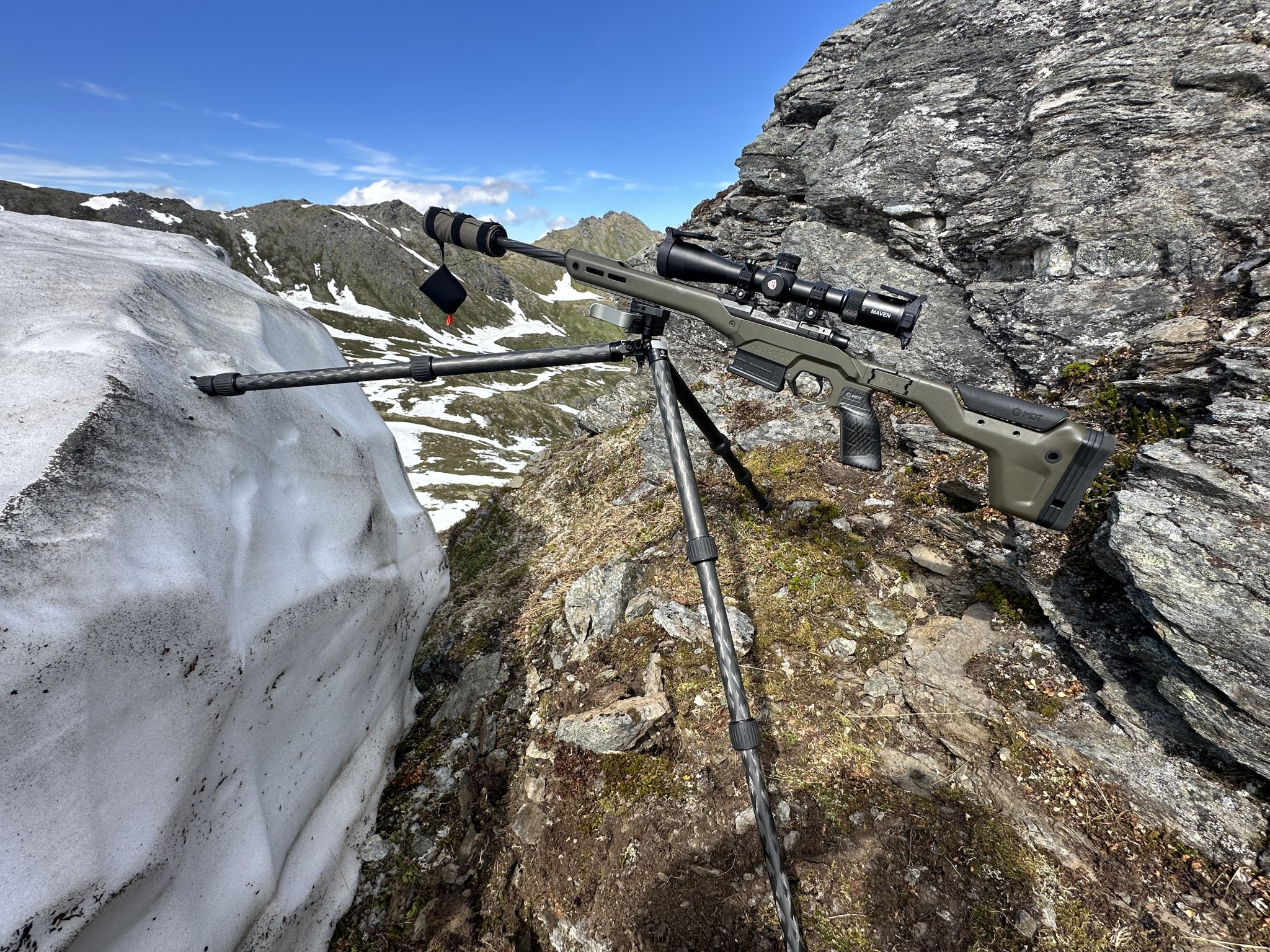

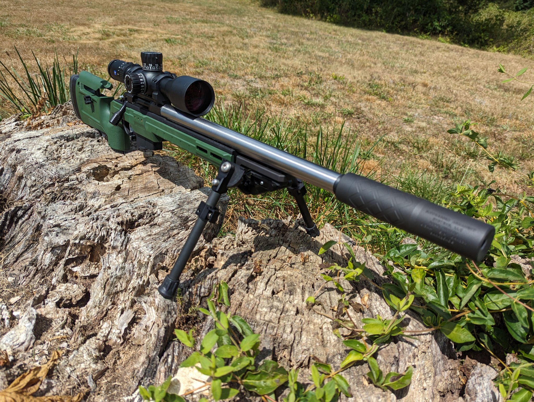

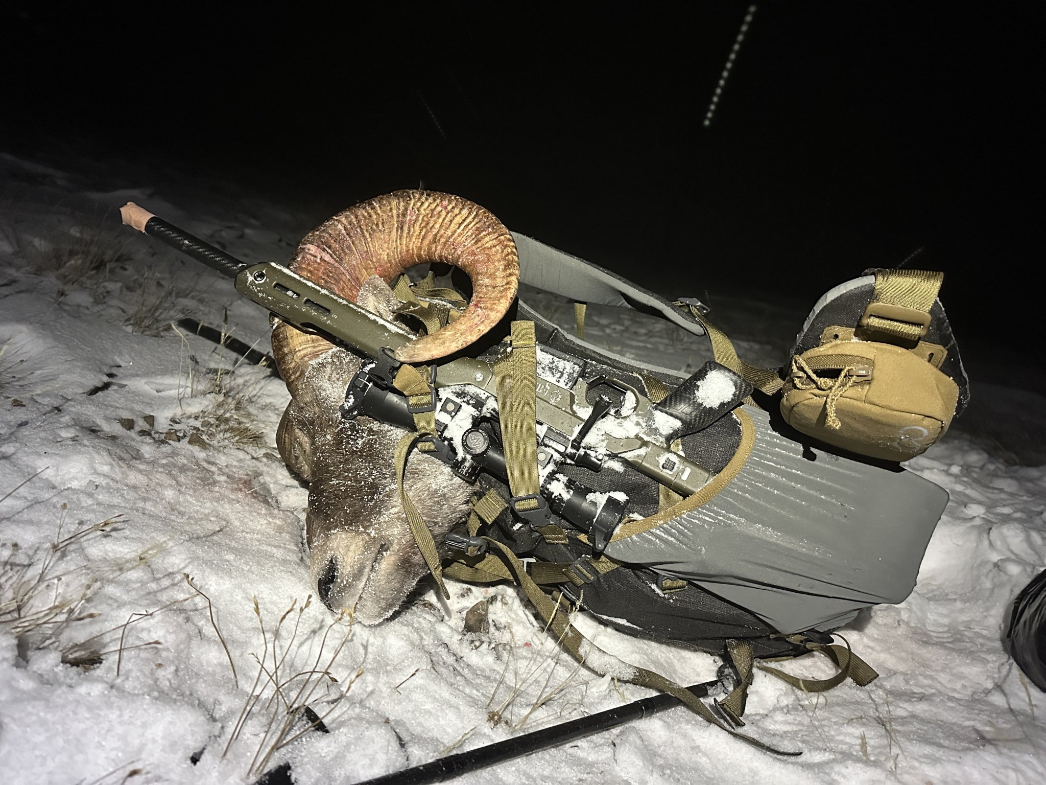

The latest configuration on the sheep rifle.
18” 6 CM. PVA Osprey Prefit. .750 Taperless Contour that a few of us championed here on the Hide. 39 oz for the barrel and 8 lbs total with the Scythe-Ti.
Can I ask about your decision to go with the HNT 26 over a stock? Was it purely weight? I couldn't take it anymore and am starting my short/hunting build and can't decide between the two. Other than traditional hunting rifles, all of my customs are in chassis and I'm drawn to the HNT26.
Not purely weight. The ergo’s are great for me when shooting long range in field positions, shooting in awkward positions from a tripod and compact size when folded and on a pack while bushwhacking & carrying big loads.
9lbs on the nose without the can, 9lb 8oz with the TBAC Gen 2 Ultra 7. Added the FlatLine Ops HALO-X Accu/Level, I think she's Elk hunt ready.
Nice!!
Can you drop the details again?
(I am old and forgot….)
Mine cant be here (24” barrel”) and currently sits at 8 lbs 7 oz with unloaded mag.
No bipod, no can.
I shoot off my pack or tripod.
Nice!!
No bipod, no can.
Zermatt Arms Bighorn TL3 SA
Proof Carbon 308 and 6.5 PRC
Manners Pro Hunter
Hawkins M5 DBM
TT Special
ARC M10 rings
ATACR 4-16x42 F1 Mil-XT
TBAC Gen 2 Ultra 7 .30cal
I'll take the bipod and tripod but might ultimately end up shooting from the pack as well, just depends.

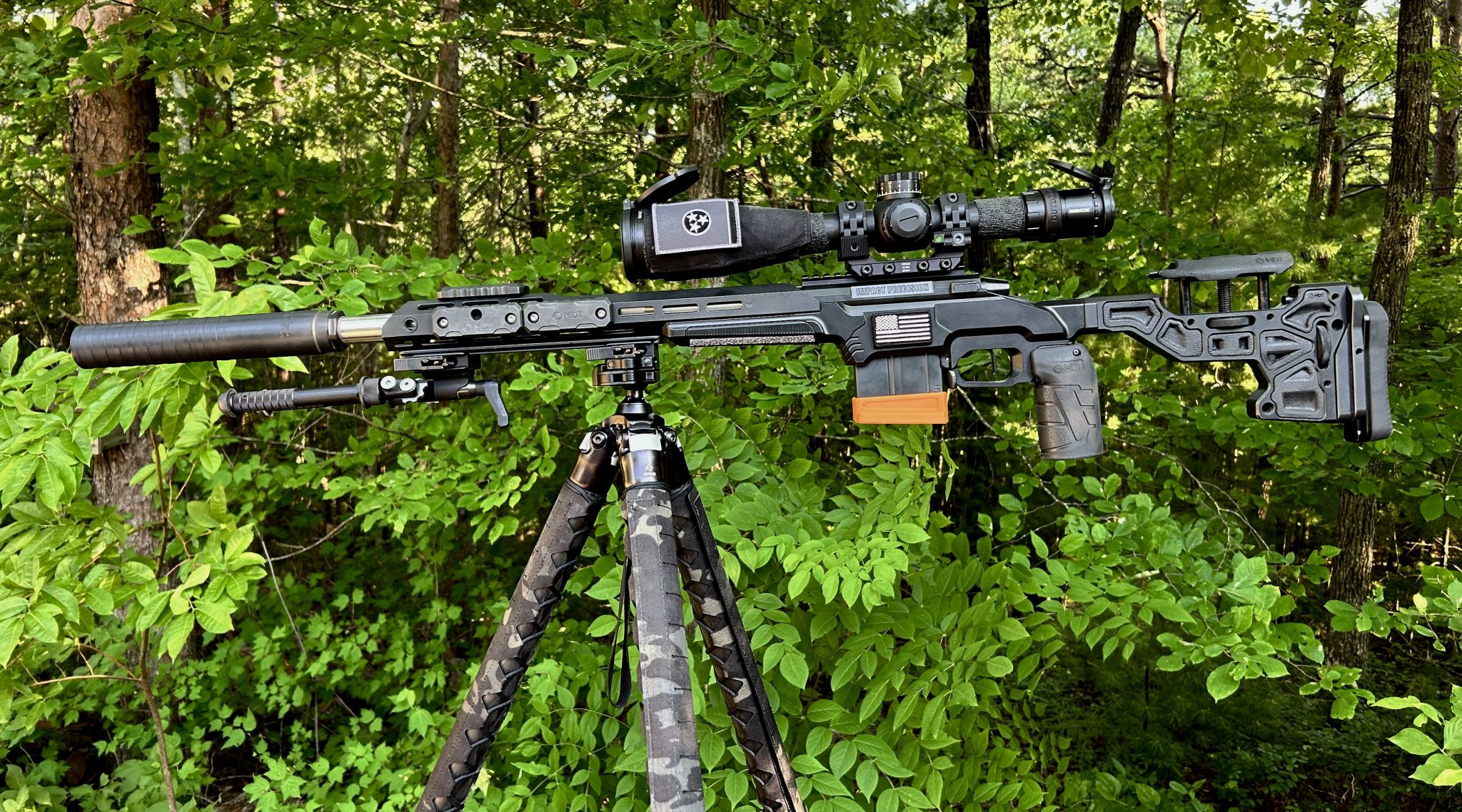

Aero Precision Solus action
18" Keystone Accuracy barrel in 6GT
Bix N Andy Tacsport Pro 2 stage
KRG Bravo chassis
AIAW mags
Zeiss LRP S3 4-25X50
APA rings
Suppressed Armament Barricade can
LRA Scout bipod
How do you like that can? Suppress well? Shot it around any others you would compare to or think it’s better or just as good as?
It's really been my go to can for anything under 6.5mm since I bought it way back in 2016, I've run it extensively on .260, 6.5CM, 5.56 18", 16", 14.5", 10.3" and now 6GT & it has done extremely well on all of them. I feel like it's performance for it's size/weight is still pretty damn impressive. I'm no expert but to my ear it's no louder than some full size 30 cal cans (Surefire & my old SAS stainless) & definitely quieter than any of the "K" size cans that I have heard in person. Sure it's probably old technology compared to some of the newer suppressors out there but honestly I haven't felt the need to look around for the "new hotness" since this can still works so well for me.
Reactions: levi8599 and lash
Nice. I have had a resistor for about 5-6 years and love it but was looking for something shorter and lighter for the 6.5mm calibers I have.
Reactions: Overwatch260
Very cool, I'm on the back order for a folder--and I might've just figured out a reference for a 6Arc build or moving my 18" 6.5cm from the Bravo to the ATX chassis.
Would like to find a second folder used though.
That 18" just clears for a muzzle attachment and suppressor!
Dang, what LOP do you have there?
One click in from fully extended. Im 6'4"
