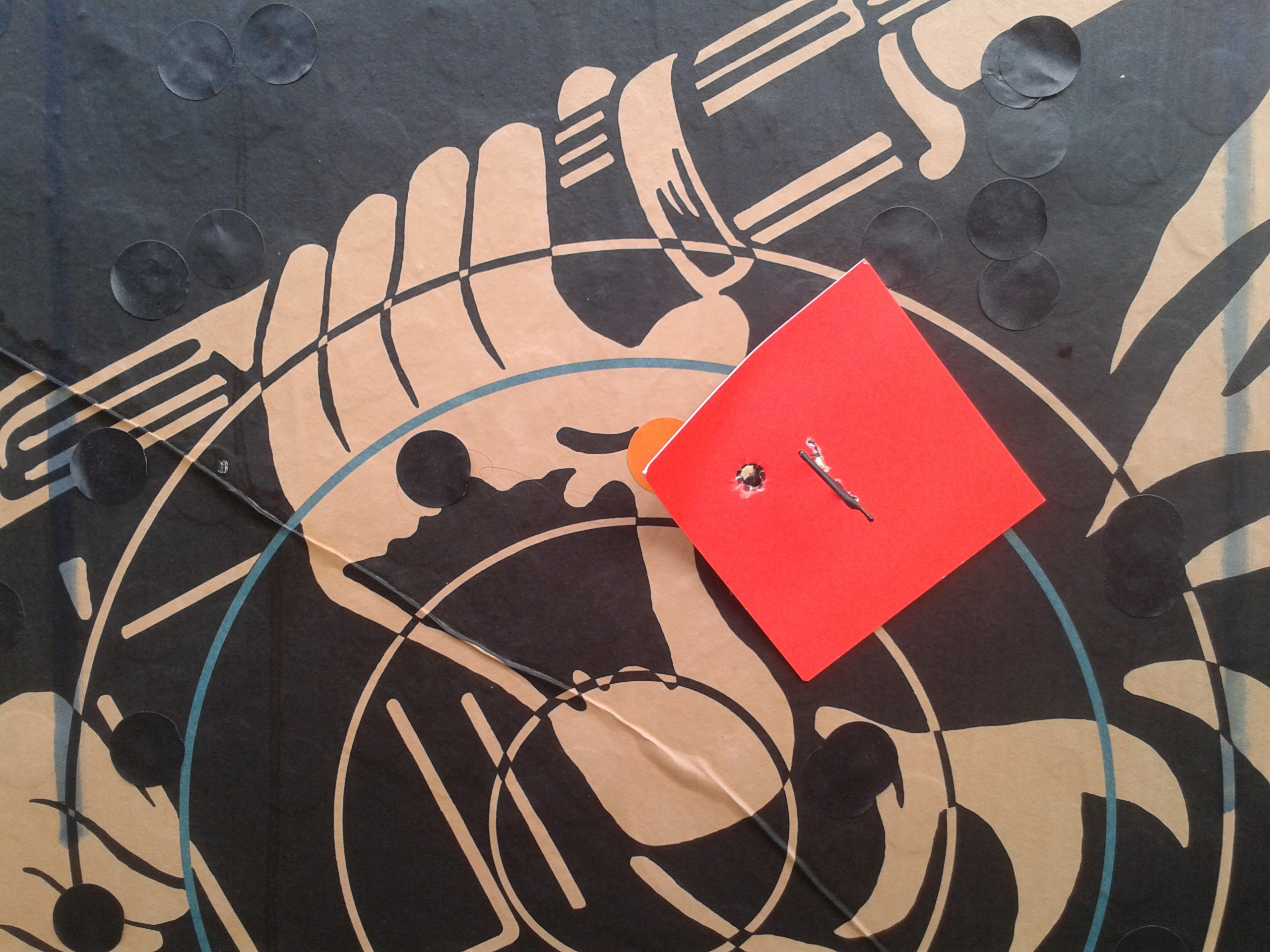

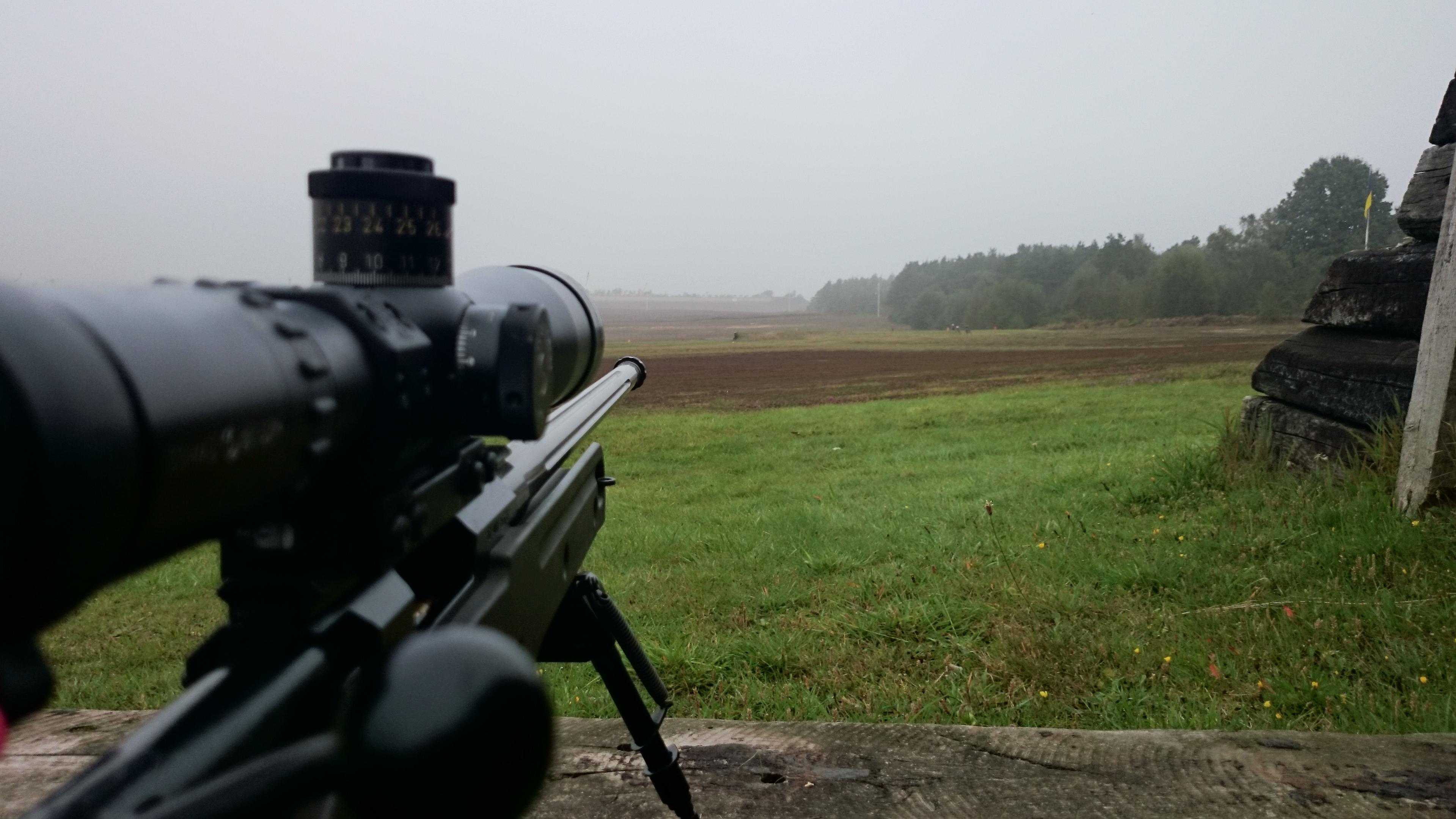

DSC_0017.jpg As requested,..the SSG08 yesterday on the 1,000 yard point at Bisley, wearing an IOR scope. Another excellent day out with the 175 Scenar L's
DSC_0015.jpgAnother pic,..again at 1,000yard mark. Next week we will try at 1100yards, again on the fig 11 targets. At 2780fps ( from the AIAW) reaching that far should be no problem. The altitude from the FFP is just 73m above sea level.

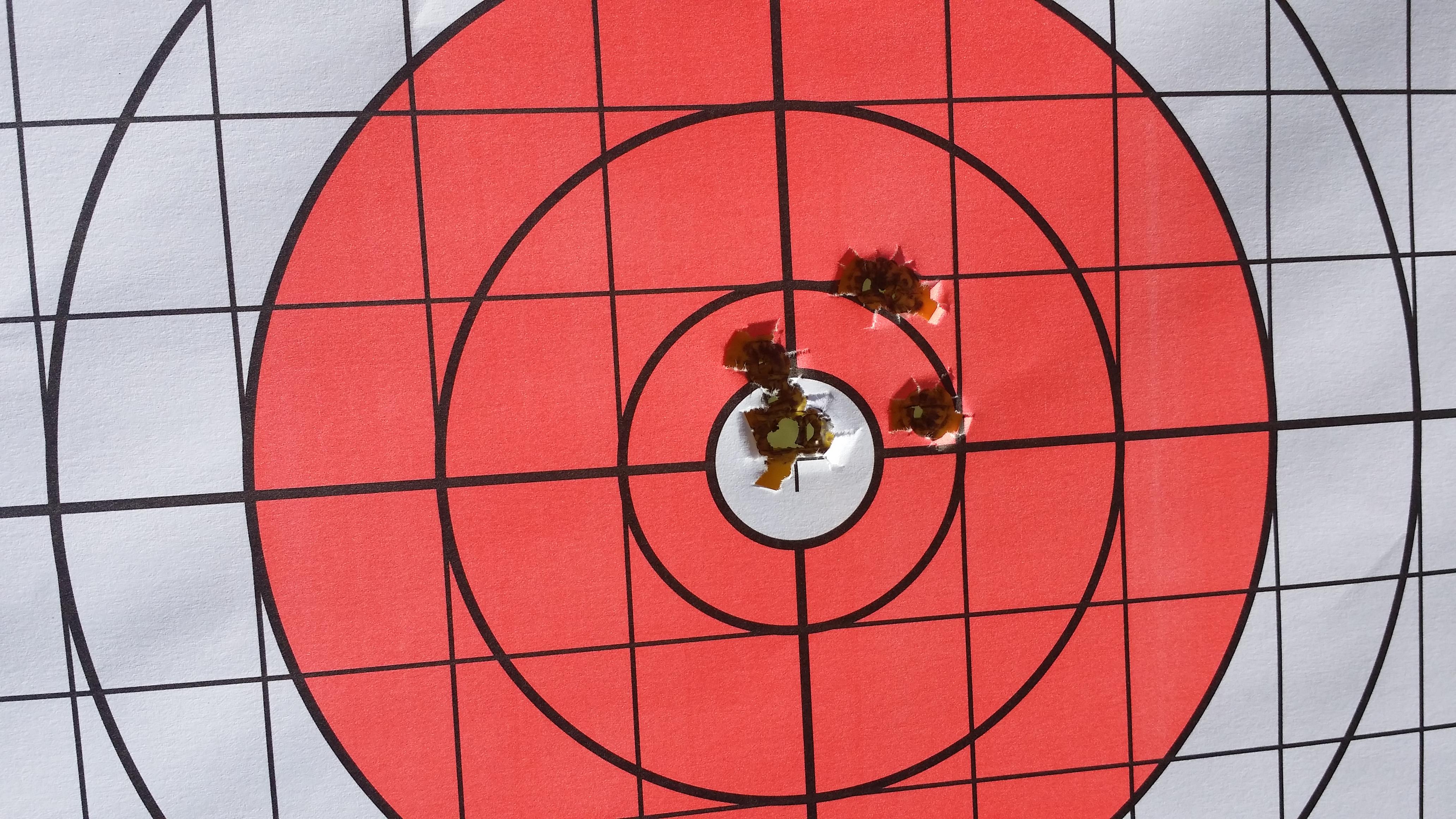

Went out Monday as scheduled and was able to do some more 500yd testing with the N540.
The first pic is a recap of the 100yd results, the second is 500 yds with the same load as from the 100yd position, on this picture is a second load which appears to have done better. I am going to retry the .165 length and also shorten two more new loads setting at .160 and .155 to see if I can get the same group size as the AA2495 and Varget or better.

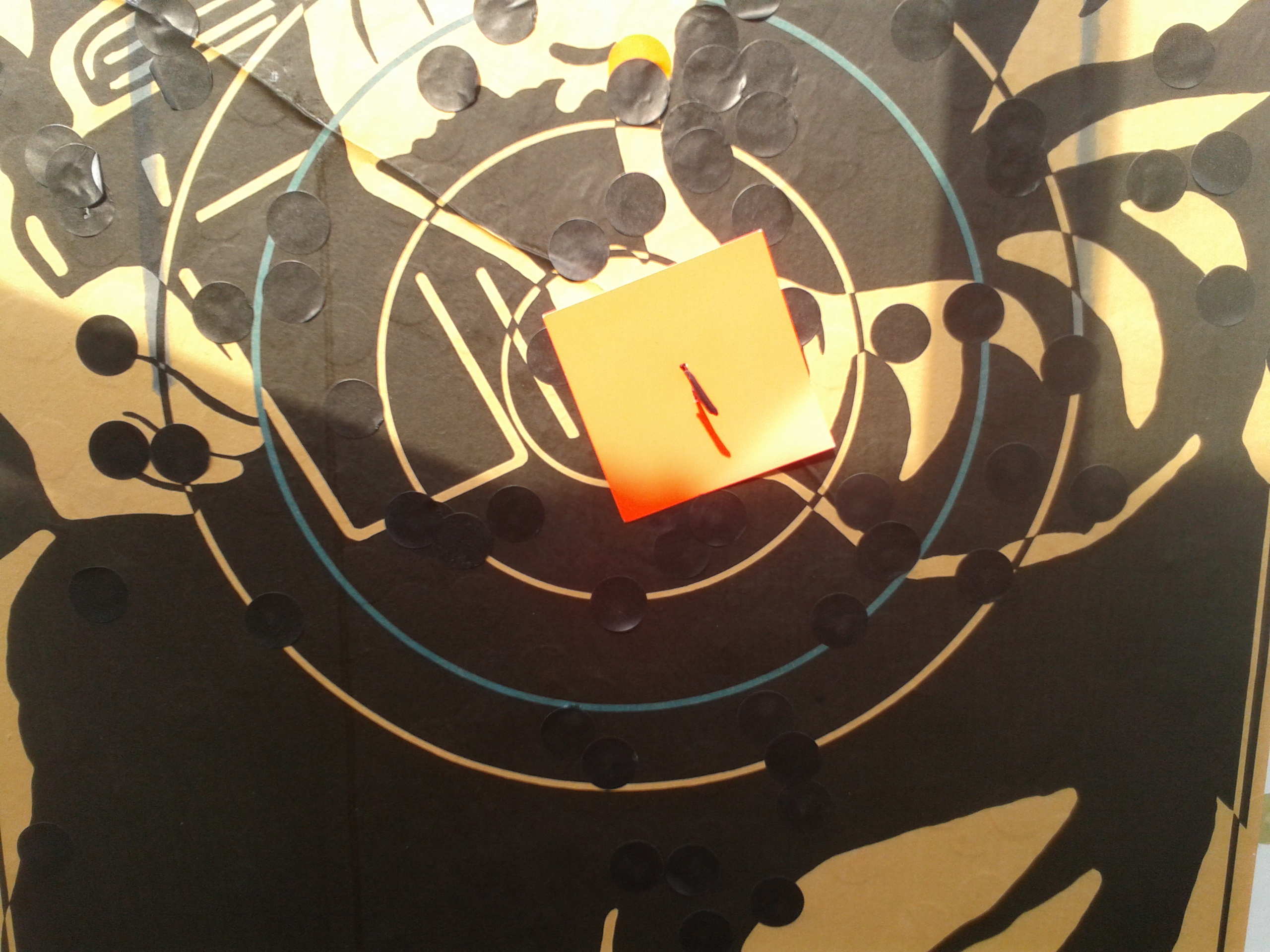

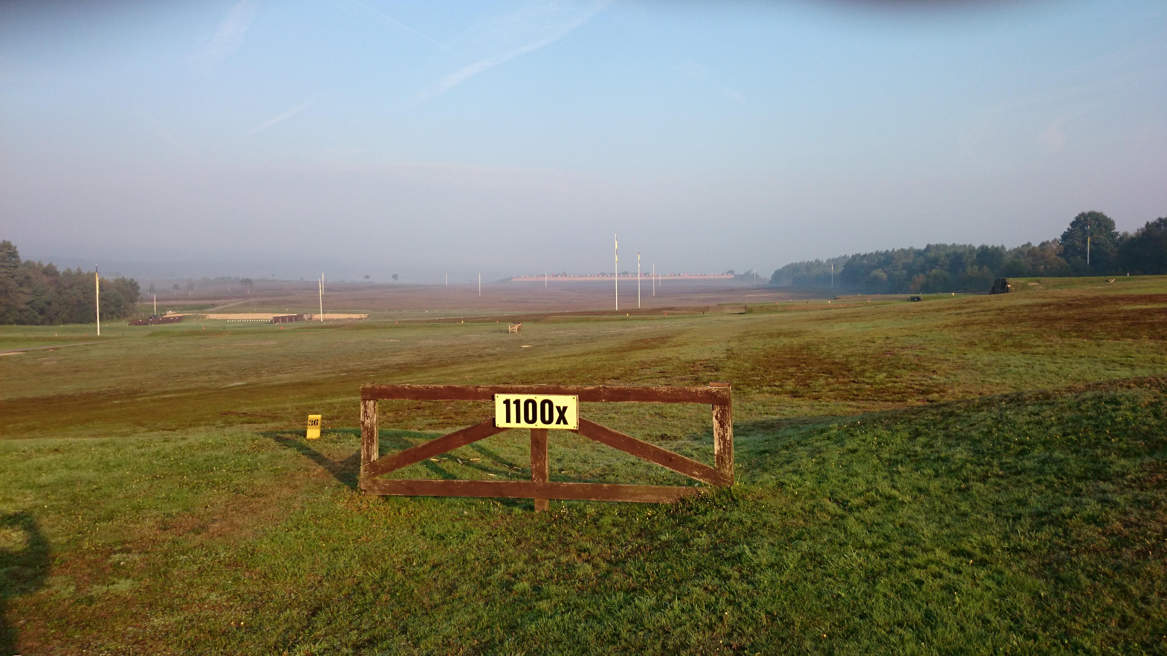

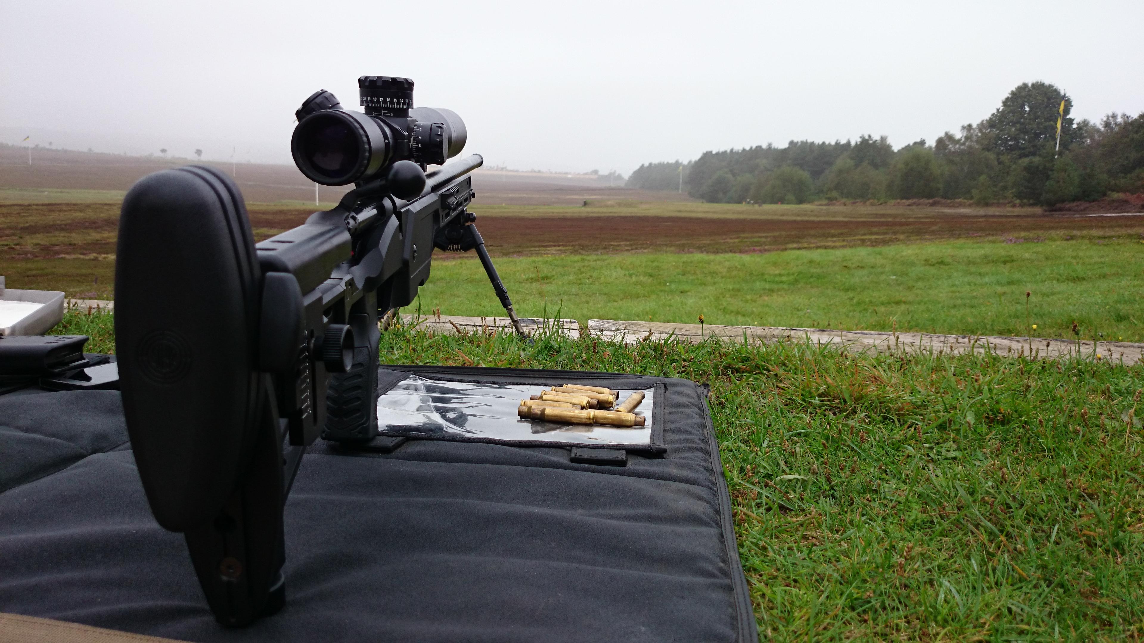

Good results AZ! We got out as planned again this morning at Bisley onto the 1100 yard mark. Weather was to start near flat calm, 10 degrees celsius with a little mist still to burn off. The SSG08 and the Stiller SPECTRE both turned out with two of us shooting the Scenar DSC_0028.jpg
With minimal wind to start and an easy 5-8mph breeze from 9 o'clock later hits on the standard fig 11 came quickly in succession,..
For reference, the orange marker is 3 inches square. We shot on several target frames to speed things up.
All agreed we would under same conditions be happy to engage targets at 1200+ with confidence. If we can get range space we will try same again but on fig 12 ( half size) and also fig 11 at 1200 yards,

Here is a short work up on the 6mm .243 Winchester I put together from another box stock Savage.
1 mile shoot 12-13
1st shot top left, 2nd shot bottom left, 3&4 are the two in the right hand lower corner, number 5 is the one closest to center and number 6 is the one at bottom center.
Savage .243 Winchester
Factory Savage action, with accutrigger.
Choate stock.
26" Shilen Barrel, stainless match grade, 1:8 twist, 11 degree crown.
Harris bipod, bottom swivel type.
NF 5x25-56 ATACR MOA reticle, 1/4" adjustments, 120 moa vertical scope adjustment.
Murphy Precision 40 moa rail, stainless steel, black coated.
Barrett EX-rings, adjustable to 20 or 30 moa, set at 20moa.
Vortex bubble level, scope side mount.
107 SMK Match King 6 mm, my loads.
Nosler .243 Winchester brass, trimmed and re-sized prior to loading.
H4831sc powder.
Wolf large rifle primers.
Strelok + used for dope, within 1 moa first time out, used same dope this time out which was from last hit from last shot from previous outing, 89.1 moa vertical, 5 moa left to compensate for SD and coriolis effect with lite wind 1-2mph, ended up with wind 3-6mph from L to R with frontal gusts. Last two shot's 5&6 with vertical of 91.2 moa and horizontal of 10 moa left.
Roughly 135 ft vertical arc and 14 ft horizontal from center of target. Total rounds fired 16 for 6 hits on 40"X37" target. That wind does play hell with my little bitty bullets. On the good side, you could see where they were coming in at an approximate 30-35 degree angle by the top part of the bullet hole showing more black on paper from coming down and moving forward at the same time, with no key holes. Bullet is going subsonic at a little over 1300 yards. Some one said you can't shoot a 6mm, .243 Win. one mile and hit anything, guess he was wrong. Target is 40" X 37". 1 moa would be 35.2 ", big circle is 30", not a sub moa but pretty close.
AZ

Here are the pictures of the current 100yd results.
They all look like they should do fairly well @ 500yds and here are the results.
The N540 actually measured 1 3/4" X 3/4"
The vertical dispersion was actually much better with the N540 than the AA2495 and Varget.
What I am seeing is the AA2495 and Varget are very good at 100 yds, but for some reason are spreading vertically and horizontally out to 500 yds. It appears with this rifle, happy speed is between 2650 and 2680, for this short length barrel and short chamber. Jump is now at .050", which for the most part is huge. ( It also is the thickness of the thrust bushing for the main shaft of an older model Harley Davidson 4 speed transmission.):p
The 500 yd target showing the N540 hitting high, was a scope adjustment to compensate for the low poi when the 100yd testing was done, as you can see all three would have came in at close to the same elevation @ 500 yds, without having adjusted the scope.
One other factor, the temperature was 20 degrees lower and the pressure a bit higher when these test were done compared to the previous ones, which was 100 degrees and lower pressure. Bullets were kept in a covered case and shielded from direct sunlight prior to shooting.
Plan B, I am going to reduce the powder load and reduce the length and try to tune the AA2495 and Varget to the happy speed and see what happens then retry the 500yd tests.
