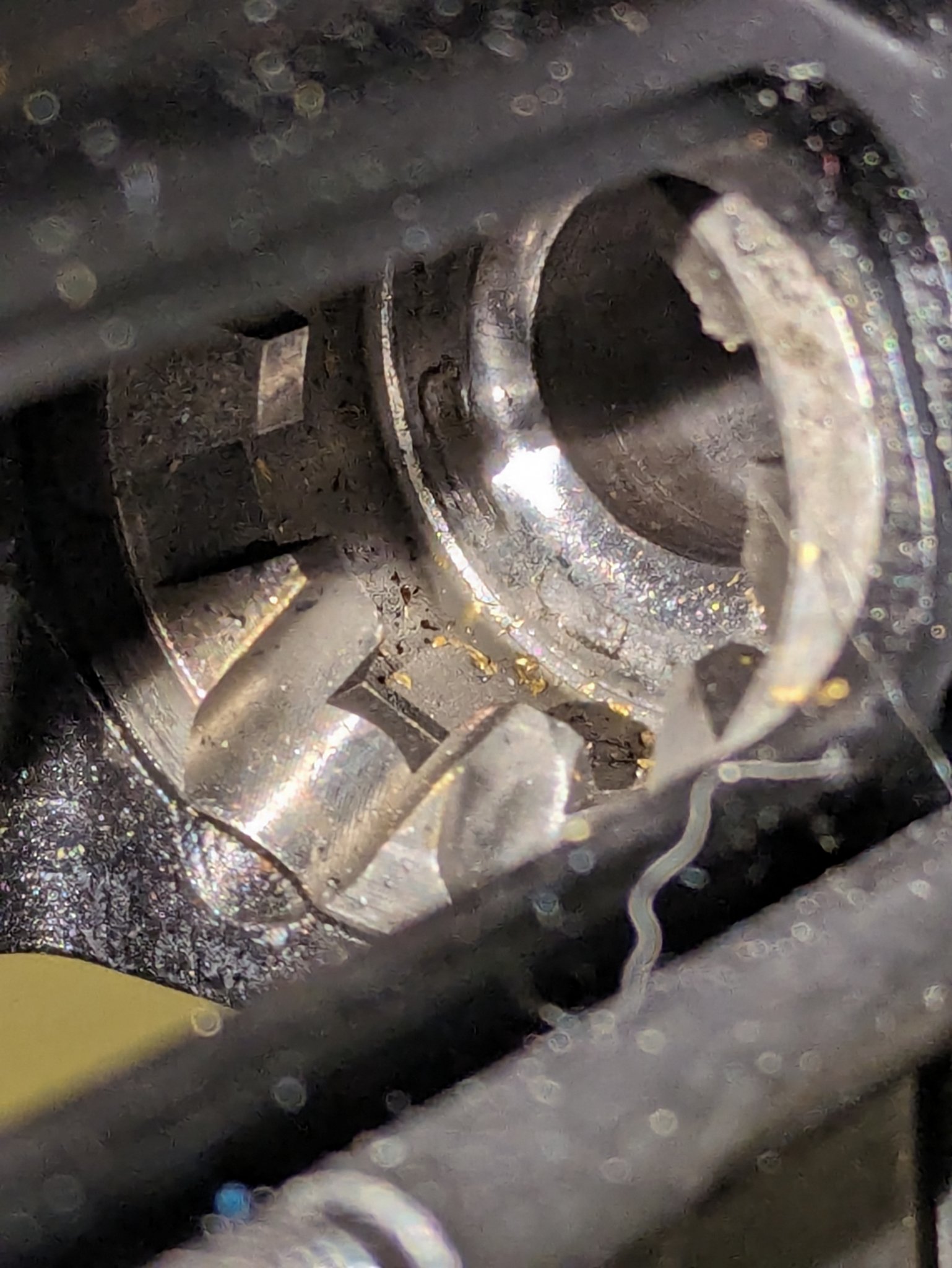

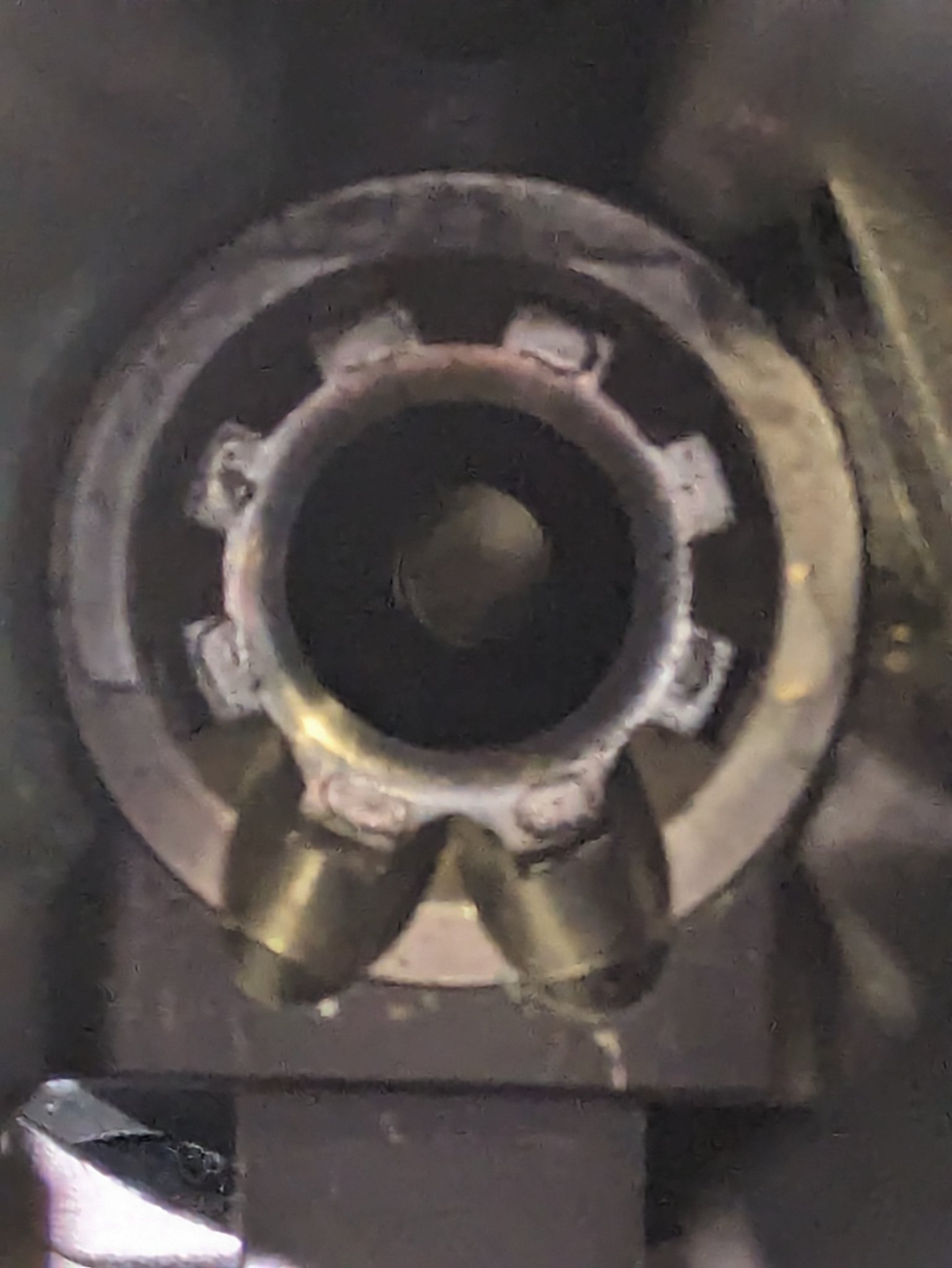

Any chance you could get me a good picture of the feed ramps on that Rainer 6 arc barrel?

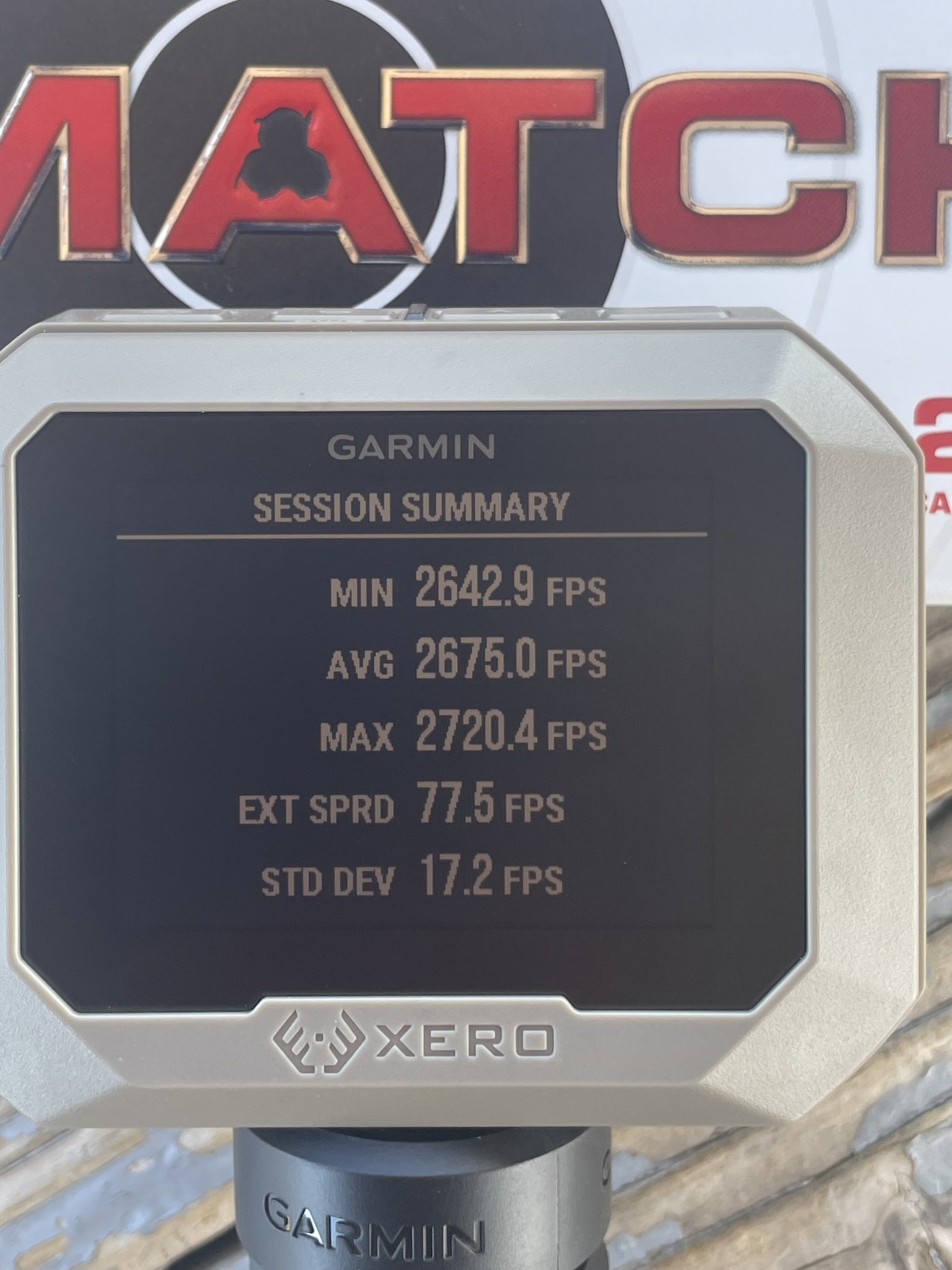

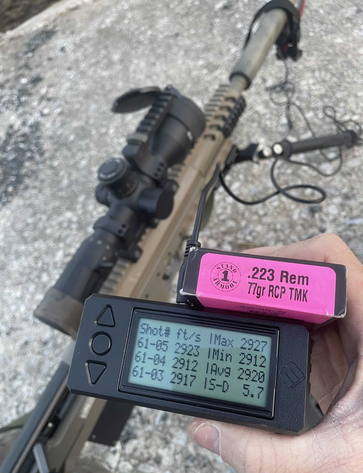

Curious on 22ARC velocities also. I’m thinking of picking up a ready to rock barrel from Craddock.
Max charge for CFE gave me 2690 fps
LVR 2710
TAC 2600
Staball 6.5 2450
I still want to try varget and staball match. I really wish someone would spec a powder with CFE223's burn rate with the temp coatings on it like staball. That would be best of both worlds.

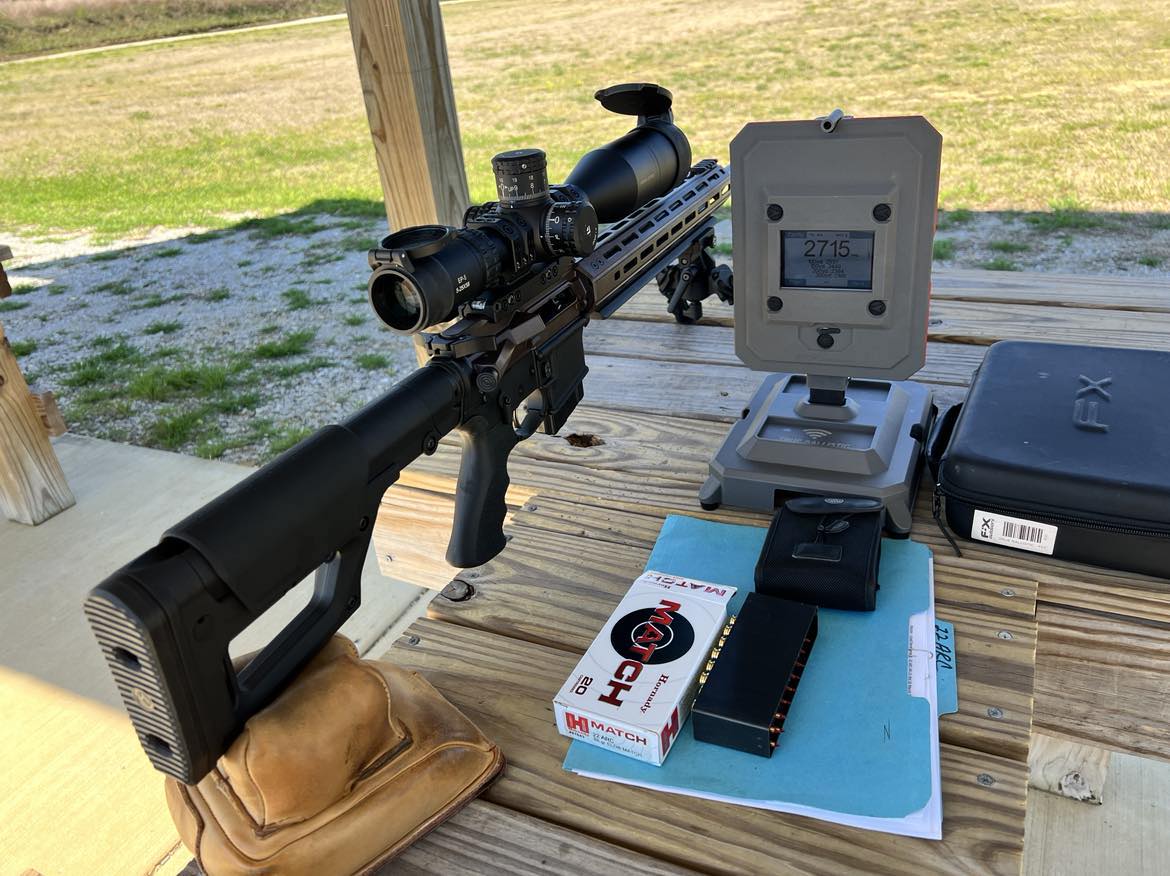

Just fired my 20" SOA Barrel for the first time this weekend.
Round count: shooting two days: 85 rounds total (including 15 rounds of reloaded 52gr SMK HPBT).
62gr ELD-VT: Avg FPS: 3176 with ES/SD (29/9.7)
75gr ELD Match: Avg FPS: 2993 with ES/SD (33/11.4)
88gr ELD Match: Avg FPS: 2716 with ES/SD (25/8.6)

Not an 18”, but for velocity comparison I’m running the Hornady 88’s in a Rainier Ultramatch 22” at 2764fps. In the factory offerings, there’s not a huge difference between the 18-22” barrels.
Hope to test the 85.5’s out with H4895 later this week. That combo should up the velocity just a bit.
