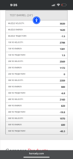

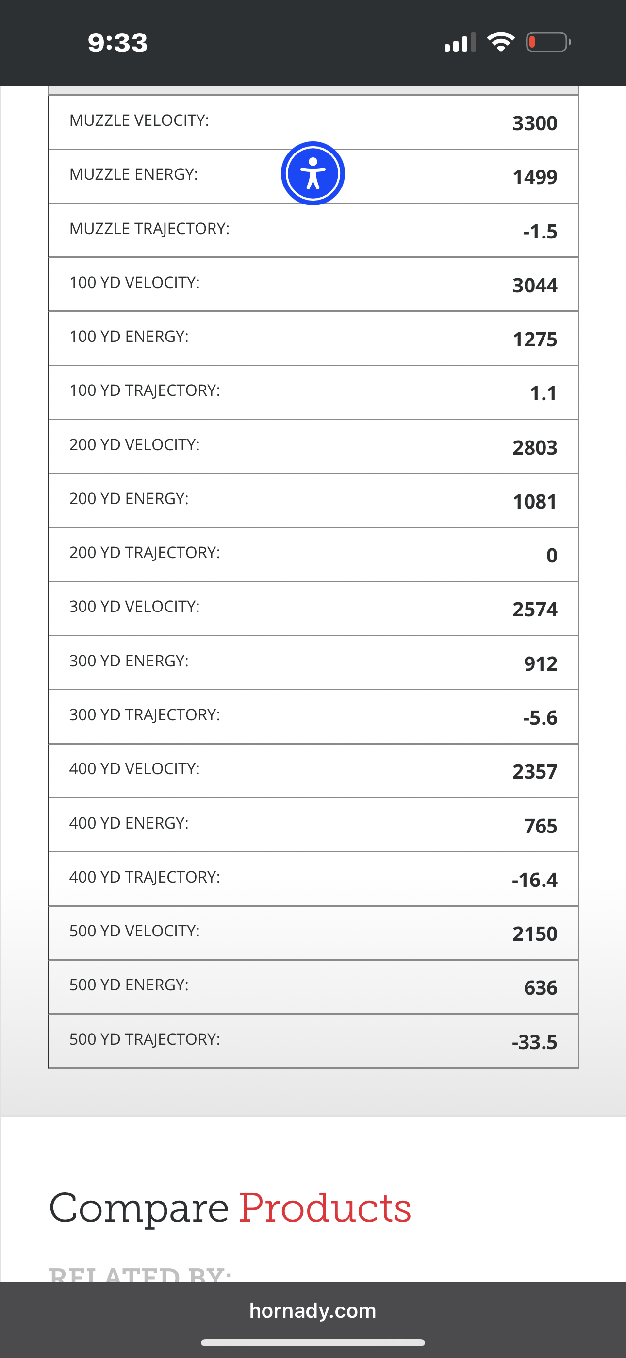

I realize this is an older post yet I looked at this very question of 22 ARC versus 6 ARC
If you look at Hornady‘s newest bullet
ELD-VT
According to the 6 mm or 22 they are almost identical even energy on target are very similar according to their website
This is with FACTORY AMMO… Velocities in the real world hand loads -have not personally loaded this bullet up yet but my rifle will be mainly used for varmints and target and steel. That’s where the ELDEVT seems to fit.
300 yrd energy=. 998 for 6arc. 912 for 22-arc
Energy on target is almost identical with this bullet velocity about 150 to 200 FPS difference
Bullet drop is going to be a little bit more with the 6 mm. Have not looked at the V-max bullets to compare.
Obviously, there’s so many different variables if you roll your own
If you’re looking for just pure drop correction 22 ARC will be your huckleberry..
Pictures below first picture is 6 arc the second pict. 22ARC
The bullets for both the 6 mm and 22 are ELDVT in the pictures below
I have plenty of cases that you don’t have to mess with in the 6 mm ARC….. i’m sure someone will say there’s nothing to it. Just put it through a full length sizer and you turn your 6 mm into a 22 ARC… in my experience it’s never that simple and knocking down a neck can introduce thickness variances and I don’t want to neck turn 1000 cases right now perhaps if I had a $800 neck Turner I would feel different.
The 22ARC Will not be for me, yet it is still a great cartridge
ELD-VT
Pictures below first picture is 22 arc the second picture —6ARC
Is the document on the right the 22 ARC?
if most people can’t tell the difference between 200 FPS and 100 FPS on their computer screenwhile playing counterstrike, I doubt you’ll be able to tell the difference between 200 FPS when shooting at a moving target…. that would be something that would have to be thought out mathematically.
How much lead hold -on a moving target at 100 yards between 200fps? is the lead the same what does 200 FPS make? Perhaps I’ll make a remote control base that allows target to be attached and see what the hit percentages would be in real life…that be pretty cool.
Even if out of 500 yards the difference will still be 200 FPS with the example I posted..
Mother nature is a real bitch and I don’t like putting an animal through anymore discomfort or hardship than necessary. They’ve got a hard enough life the way it is. God created all animals and I try go respect his creation at all cost.
That 100 & 200fps could make the difference between fragmentation and just penciling through.
at 300 yards. The difference in FPS between 6arc and 22ARC ..= 215ft./s
this is with factory loads. Obviously, when you roll your own, there’s many other factors that could make the the same
2,574fps@300yrds = time to target /bullet fight. = 0.35 sec. With the 22ARC
2,359fps@300yrds = time to target /bullet flight = 0.38 secs. With the 6ARC
Will 0.03 secs cause you to miss a moving target @300yrds?
this using it online calculator app, assuming it is correct
Reactions: BurtG and 232593
ELD-VT
