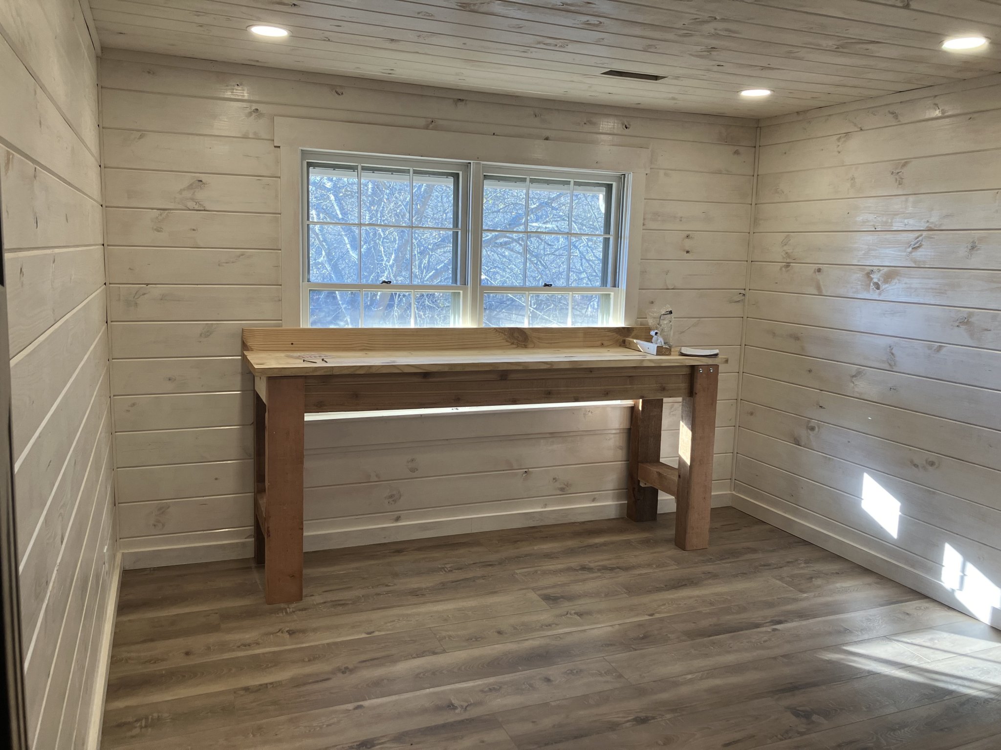

I can't stand it not having my reloading equipment set up yet
I am putting the finishing touches on this room and need to build another table and some shelving in the closet and a couple of sets of shelving and it will be my reloading space
it is taking me a long time learning how to do all of this myself lol remodeling a house from the 1950's but I'm single so it gives me a healthy hobby lol

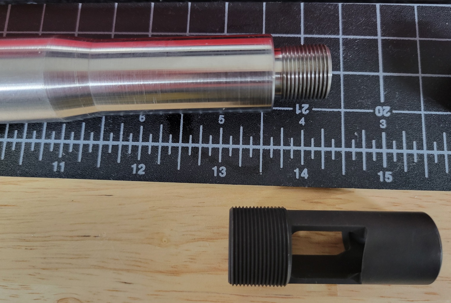

That's the OPS Inc 12th and M24 models. I'd rather the barrel threaded 5/8-24 because the OPS brake outer threads are not commonly used for anything else firearms related. The brakes takes a lot of abuse too.
I’m missing the point i think. You want a 12th model taper threaded in 5/8x24 to not use a aem5 or 12th model?
No, unless I'm missunderstanding, Craddock is proposing a 3rd model profile and thread with a 12th model spacing. The threads on the exterior of the brake are instead cut onto the muzzle of the barrel, instead of using the brake.

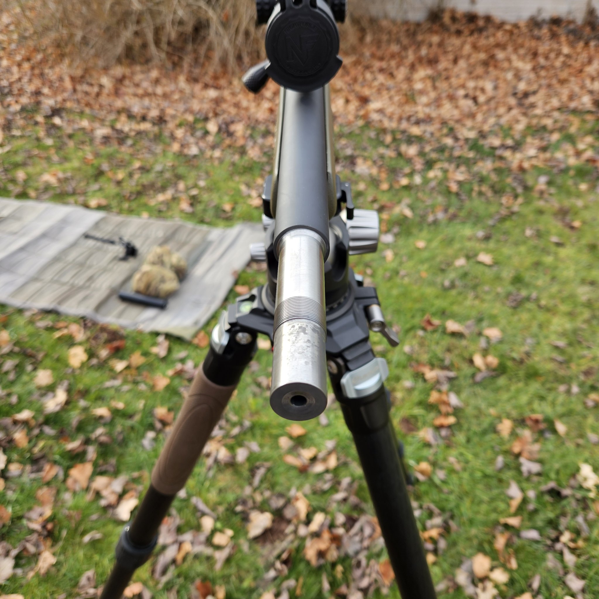

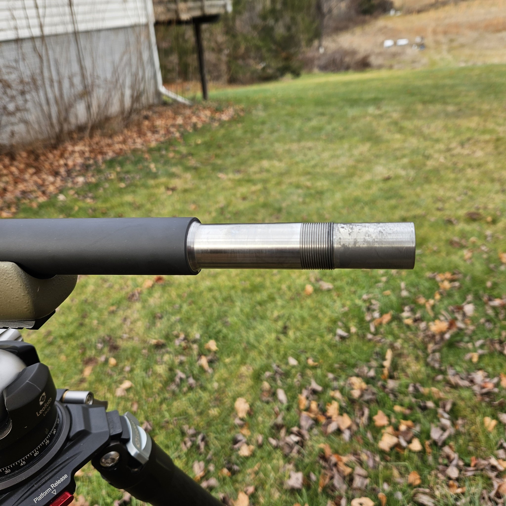

Here is what I'm talking about; a barrel with the taper machined directly and 5/8 threads for the brake.

I wonder if it's going to be something like this but for gasguns. I love this for my OCM5 but you're going to need a .936" gas block to make it work.
It's cut wrong. The threads are supposed to be at the muzzle. The end of your barrel is reducing the blast chamber volume.
No it's cut exactly how I asked. It adds over an inch of barrel length with no added overall length to the gun with the suppressor added. It simply replaces the muzzle brake with added barrel length.
The volume difference between the brake and the solid barrel is small and likely makes little to no difference in suppression. If it's a big deal for someone he could turn down the portion in front of the threads to a thinner diameter to get that tiny increase in volume.

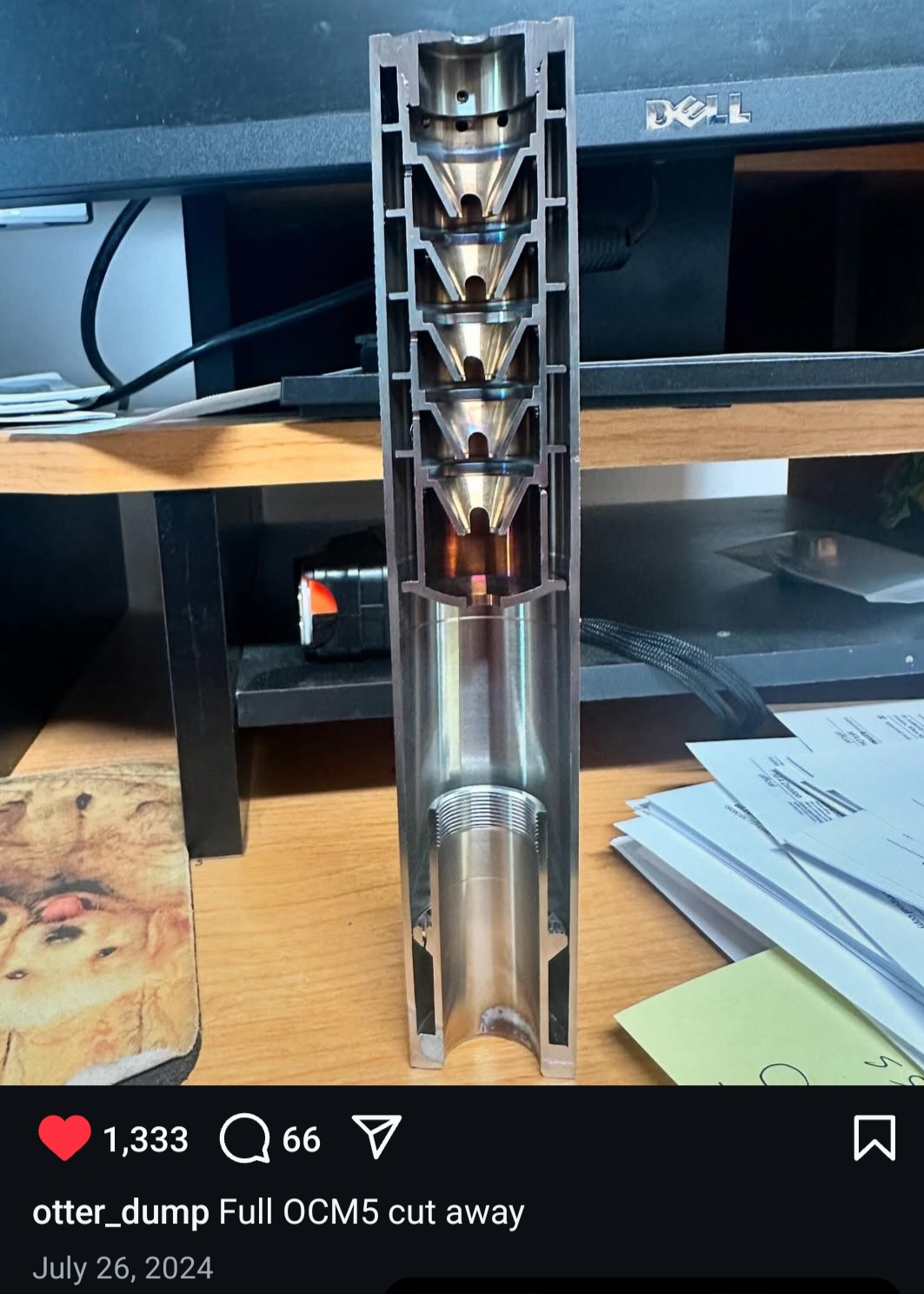

View attachment 8611883View attachment 8611884
Probably but I’m really not interested in the direct mount platform is heavy already for an AR15 with a medium contour MK12 barrel. I just want a 22 arc mod 0/1 barrel so i can make a mod 0 in 22 arc and use my aem5

There would definitely be some weight added. Not that I'm itching for one but a Mod H style 22 ARC would be fun.
If you're happy with the performance that is all that matters. I can't remember if OCL retained the chamber over the barrel in the OCM5. OPS/AEM silencers have ports right after the threads that correspond to the brake ports. If you move the barrel forward of the threads you will block the ports. It probably isn't super critical to bolt gun applications but it adds back pressure. Blast chamber volume does have a significant effect on sound performance too.

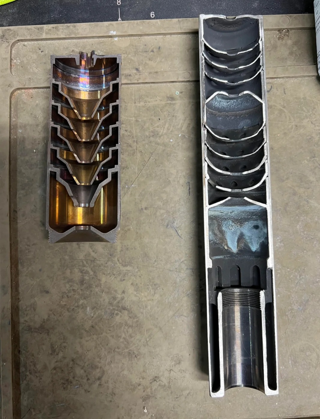

On the OCM5 it doesn't block the opening that leads to the additional volume towards the back of the can. Just forces the gas coming off the blast baffle down the gap between the additional barrel length and the suppressor tube. The AEM5 is different... That gap is smaller at a point but not closed off completely. That may make a difference but IDK.
I just know that on my 16" 223 bolt guns the OCM5 with that machined in mount sounds great for as little length that's added. If someone wanted to stop the barrel at the threads for that additional volume they could but Idk how much additional suppression you'd get.
Also, if you're trying to meet the minimum 16" to avoid SBR like I was you'll be adding 1.3" to the overall length of the setup which for me defeats the idea of the build. Which is keep the build as short as possible while using the OCM5 or OCM HUB mount.

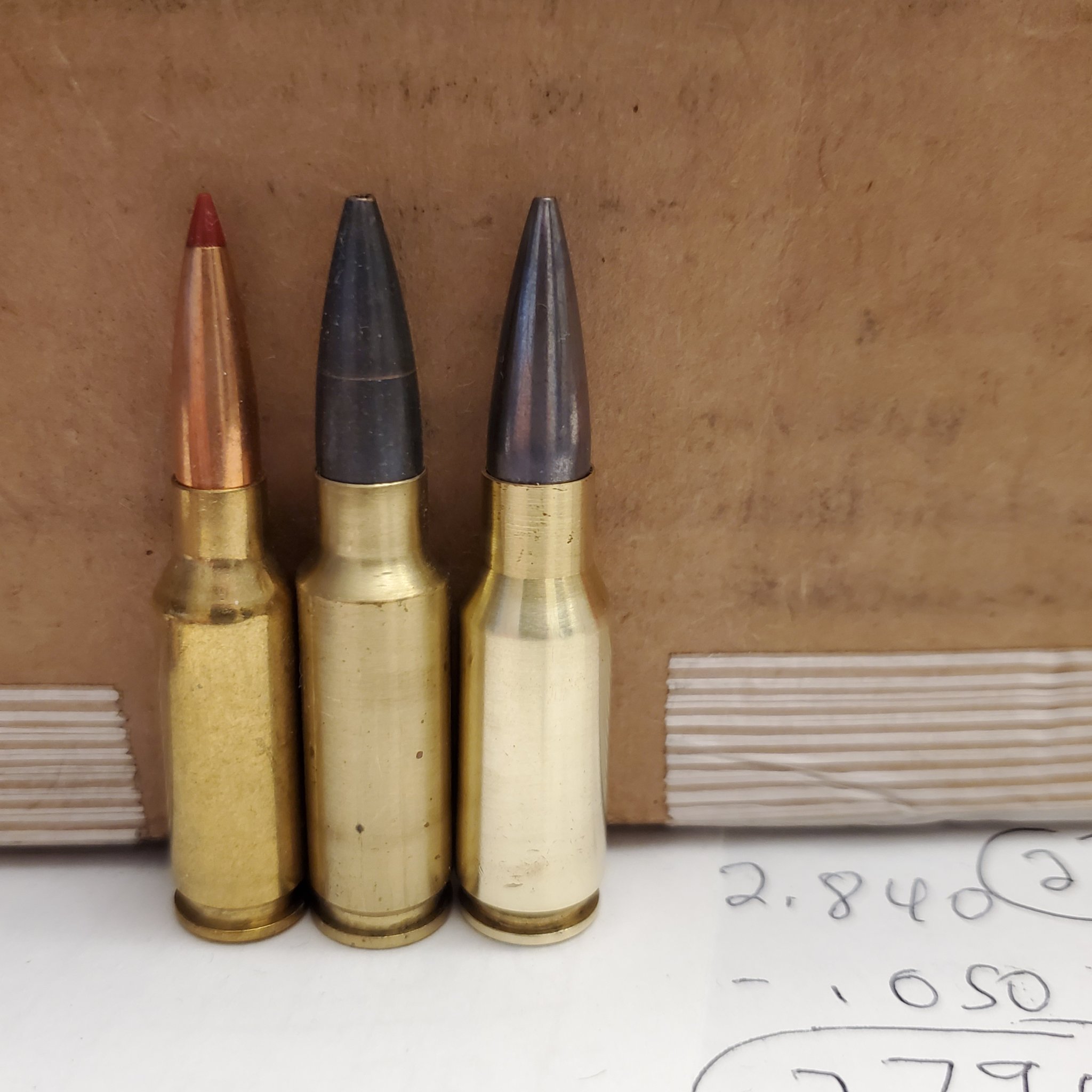

.030” shoulder set-back on the 6mm ARC due to the tight COL restrictions of the Elander mags and a specific long ogive projectile for the initial customers. Hornady said something about one of the mags making it so that COL had to be adjusted due to tolerance variations in production of magazines. That screamed Elander to me, since you can’t load long with them.
Alexander Arms even changed their COLs on Grendel ammo from 2.260” to 2.245” because of the Elanders. They switched from CProducts mags to Elanders a while back.
The thing I don’t like about setting the shoulder back any more from an already front-heavy cartridge is the cartridge stack behavior during lifting into presentation. Momentum of the stack is centered around the mass of the projectiles, teetering on the shoulders.
The 6mm AR Turbo 40 Improved moves the shoulder forward and adds at least 2 grains of case capacity over 6mm AR, but sacrificed neck length.
All of this is shows why it’s important for the rifle, ammo, and magazine specs to all be dictated by a single engineering team working together, even if they’re in different companies. Everyone needs to "sit at the same table" and visit it frequently during the RDT&E process.
You can go larger in case diameter in the AR 15 but keep pressures low.
A 6mm ARC grendel head dia, 30 Dasher 308 head dia, and a 30 RAR .500 head dia.
I have the 6 mm ARC and made a 30 RAR, because the reamer was instock for 30 RAR, the 30 Dasher may take 6 months...or more. Everything is slow theses days.
Problem here is you have to be able to make your own AR 15 barrel from a blank.
Unless you have someone else do the machining making it a very expensive project.
The 30 RAR feeds great out of 450 Bushmaster mags, and its accurate.
If you can do the machining you can make these calibers fairly cheap.
Even a free long barrel off a bolt gun, that's shot out, but cut out the chamber area, then shorten, profile, thread, chamber, barrel extension, gas journal, and port etc. Plus a finish reamer of your choice.
With a bit of labor ya got a wildcat AR 15 .500" case head dia, any caliber ya want, .17 to .45.
