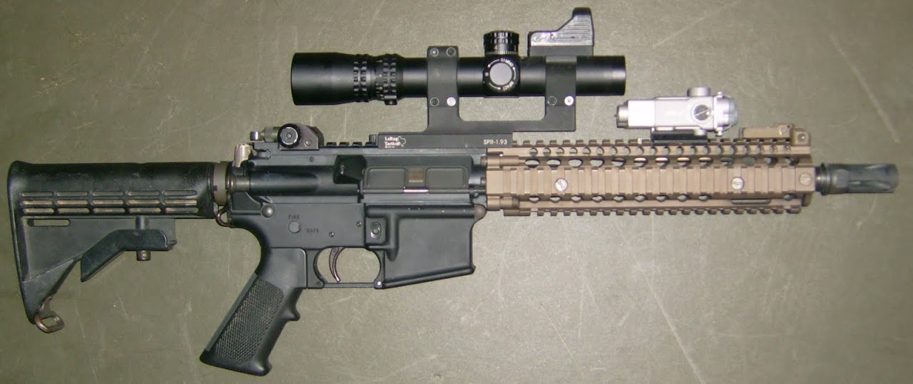

The small objective is best for when you need to clear something else mounted on the rifle. For example:
Other then that, the x32 is probably the better choice.
