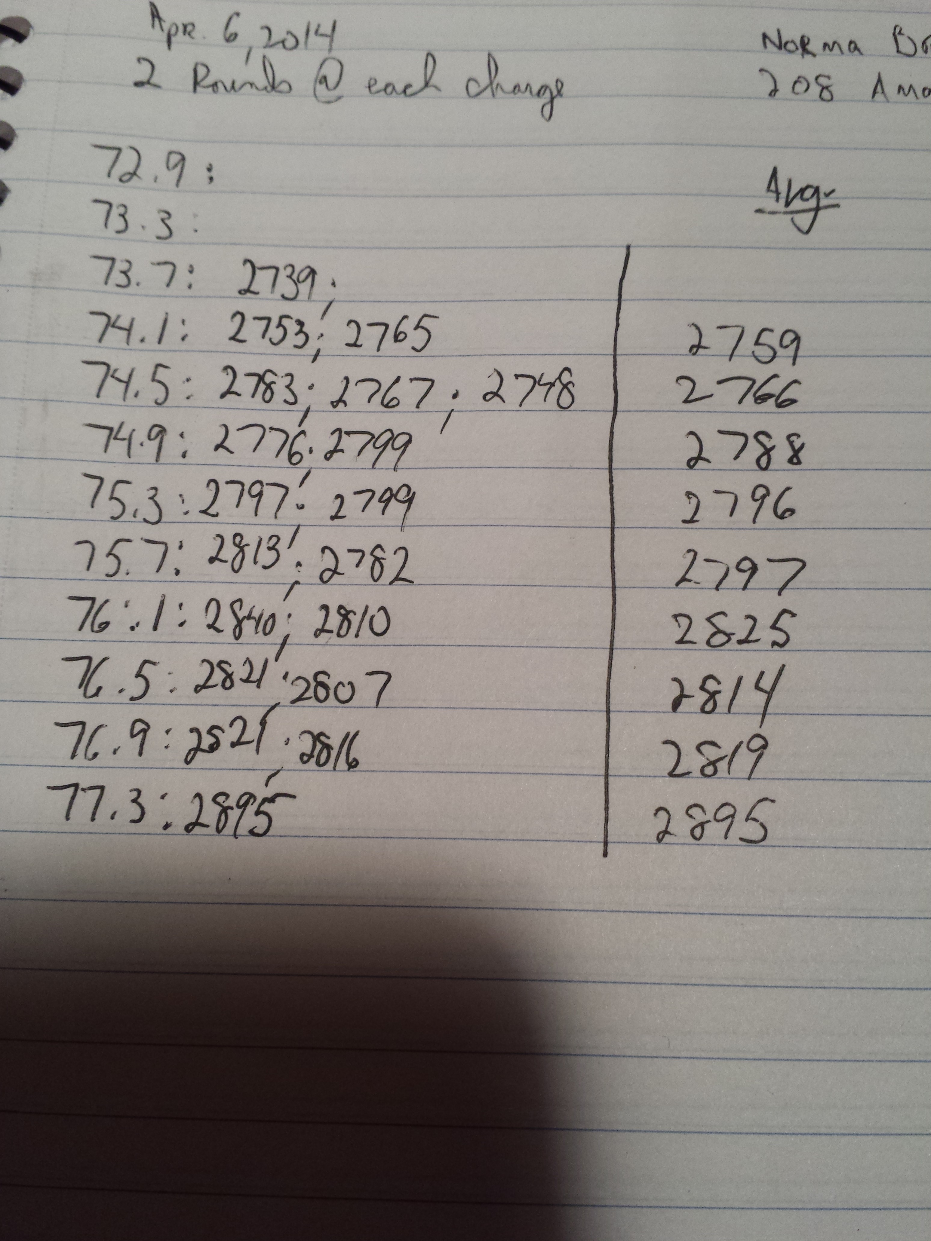

Bubb:
What do you think on these velocities? The impacts didn't help because I was only at 275 yds. and they were tight. I went up in .4 grains with 2 shots. I thought maybe using 76.5, and maybe another around 75.3-ish? Not sure why the first shot at 76.1 was so fast, but it threw off the average.

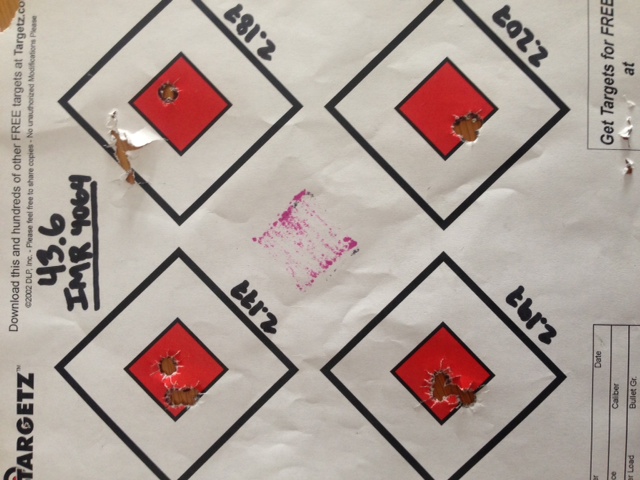

Results from OAL testing:
On my second group (2.187), my second two shot were accidentally deflected ever so slightly from my chronograph sunshield post. I reshot the group on another sheet which was decent but nothing compared to the last seating (2.207).
I also conducted a separate OCW test which gave me a few different nodes with a little better velocity. 45.1 and 45.7 grains worked just as good, but were faster. Looking at the results of both test, I would say either would work! Being that im shooting out to 900 yards, the faster round was a better selection for me.
Thanks for the fun experiment Bubb, it actually worked pretty well!
