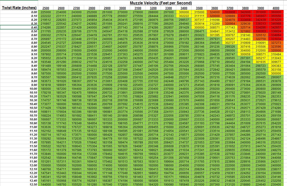

OP, I've attached a quick reference on RPM per speed. May be of some use.
Thanks for the chart. It looks like my 223 load rpm is in the danger might explode part of the chart. I might look into a heavier bullet and see how it shoots. Thanks

You're right about the chart being a finite answer. It's a guidline, and quick reference on RPM.
