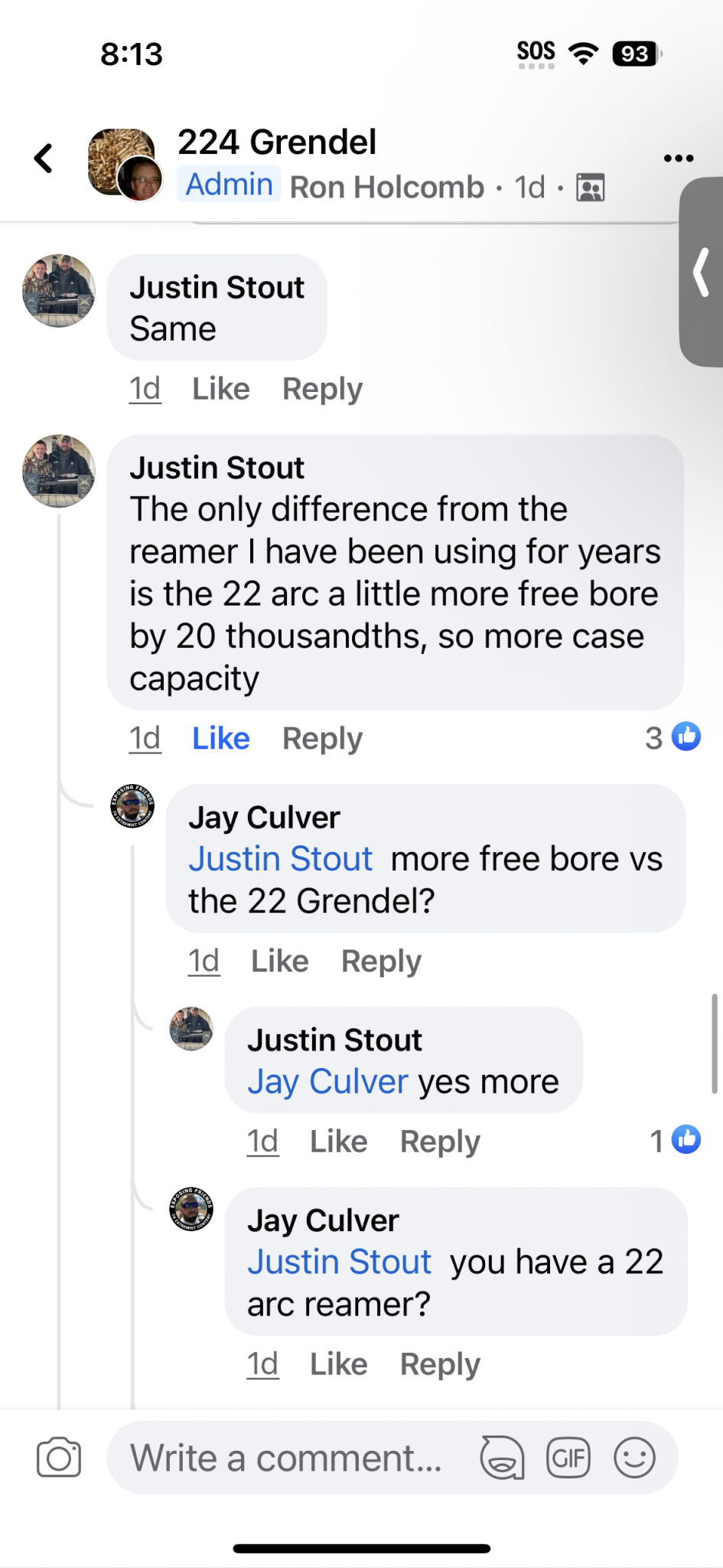

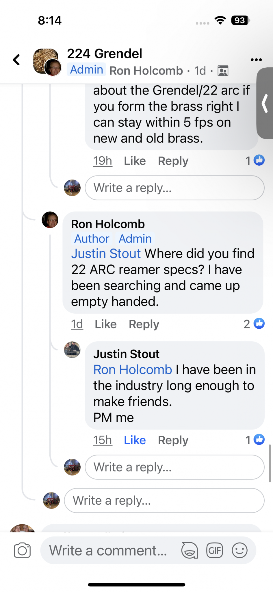

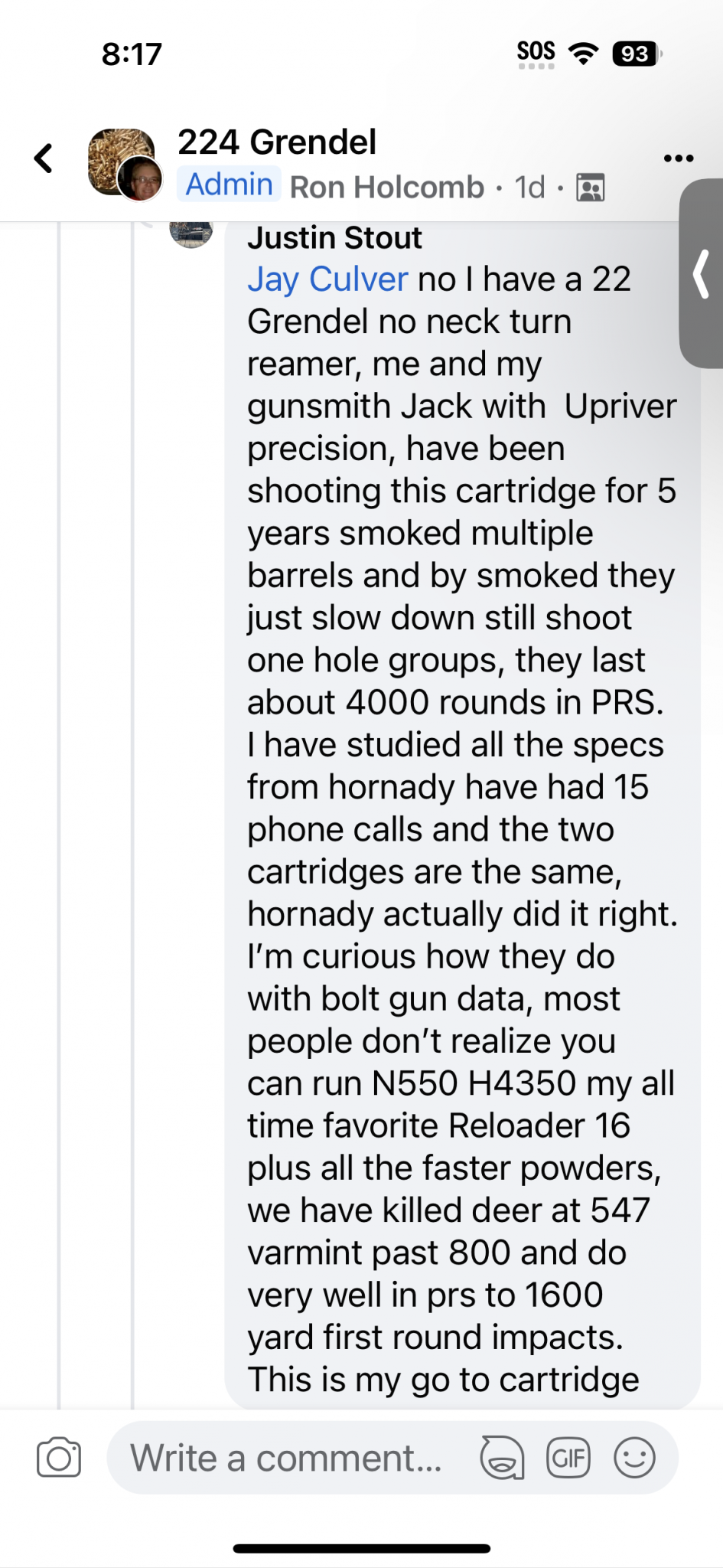

From a .224 grendel group on fuckbook, someone on there supposedly has resources and he said the freebore is like .020” longer than his smiths 22 grendel reamer.

22ARC chamber dimensions are able to be released as of yesterday. I can confirm 6.5 Grendel gauges are used for headspacing

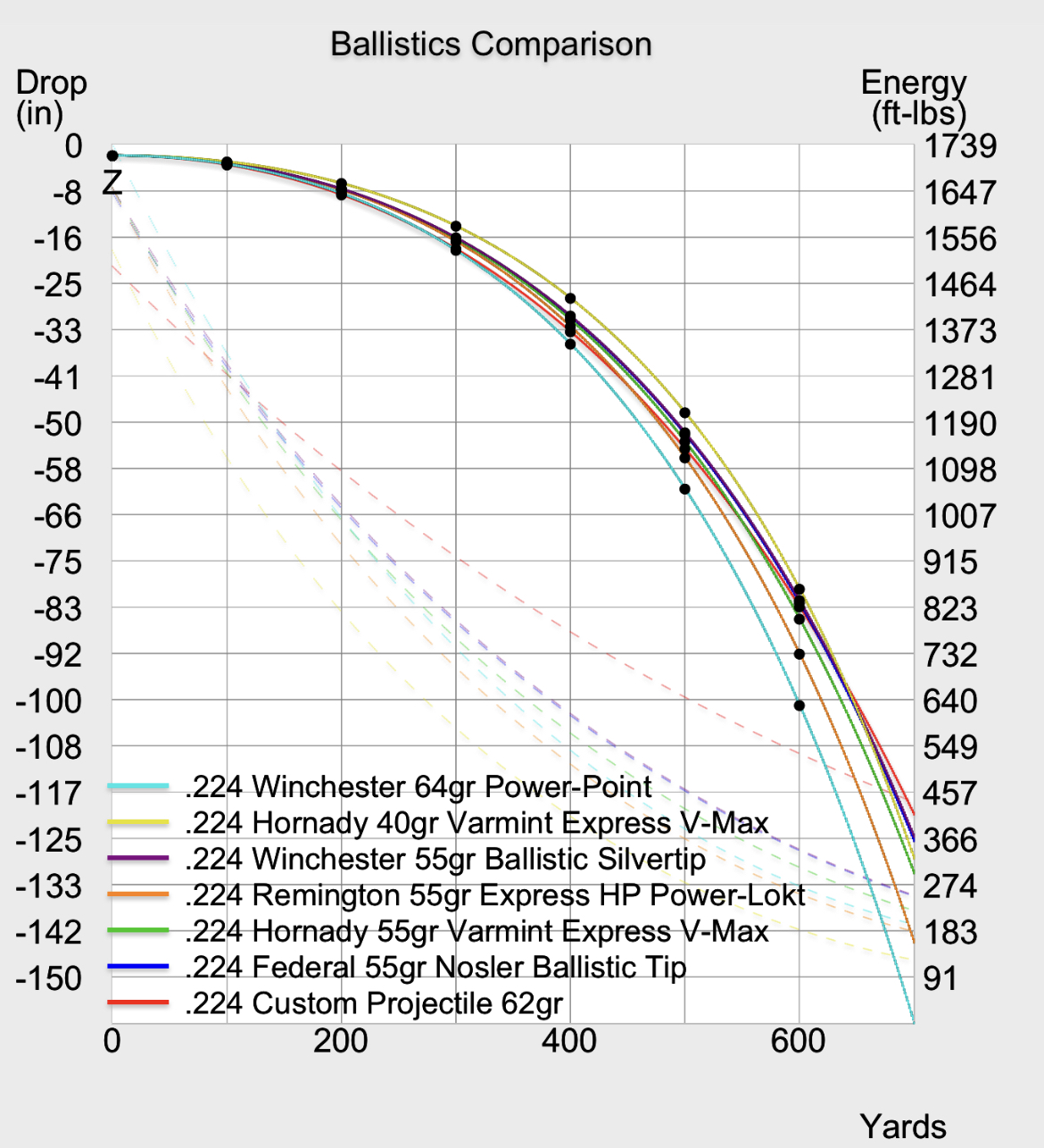

So here you go, here is a half dozen .22-250 varmint factory loads compared to the 22 ARC varmint factory load.

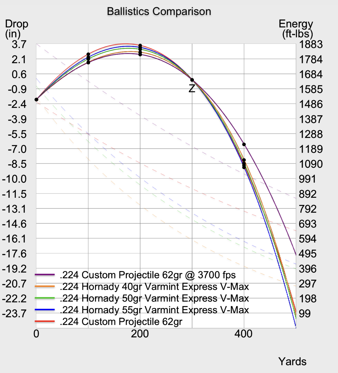

And here is them with a 300 yard zero. I also threw in the same 62gr bullet hot hand loaded in a .22-250 that requires a custom barrel.

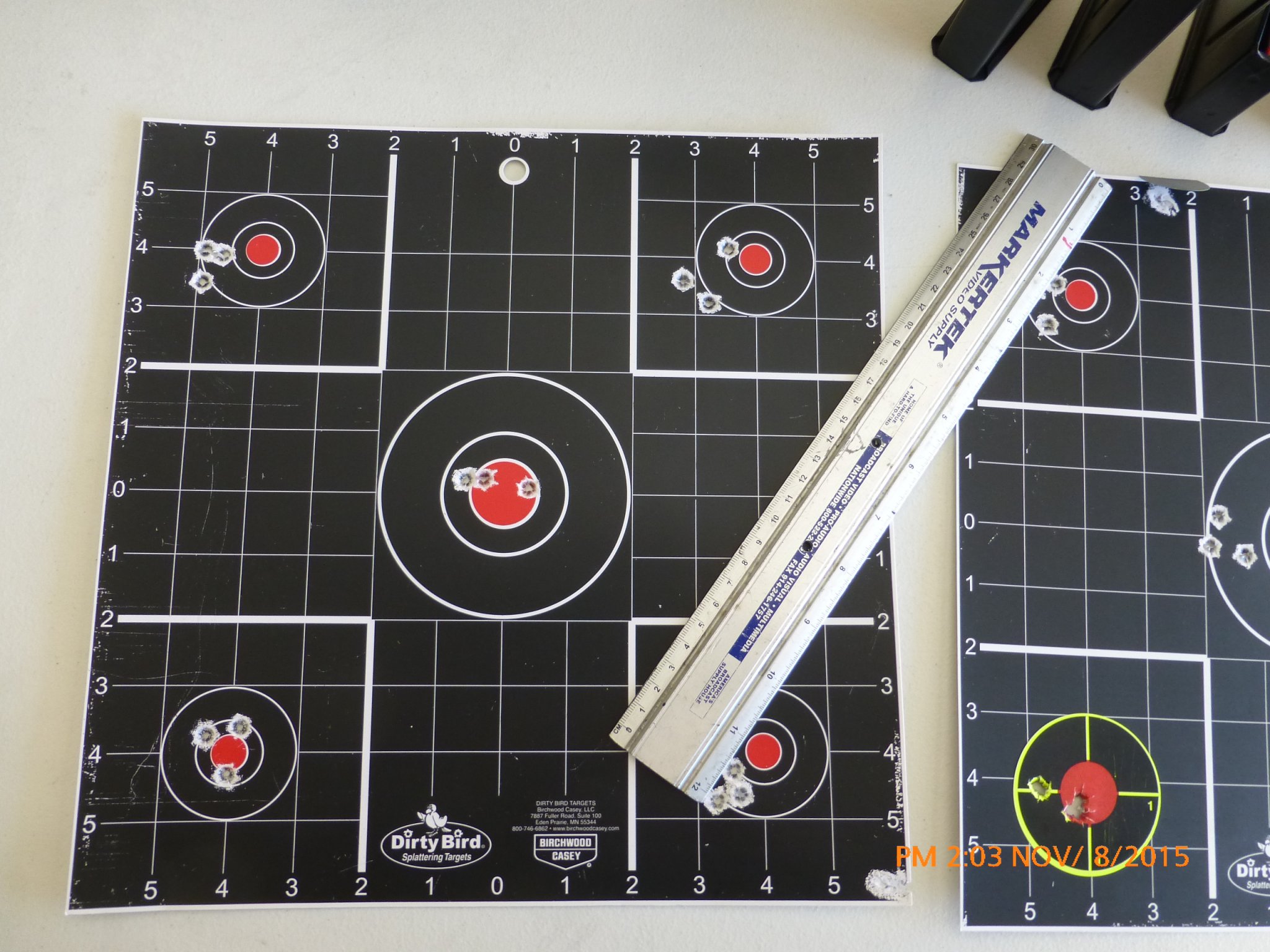

These groups I shot a few years ago with Factory 140g AMAX rounds, at 200 yards. Blaming a lack of precision on the bullets is ignorant.
