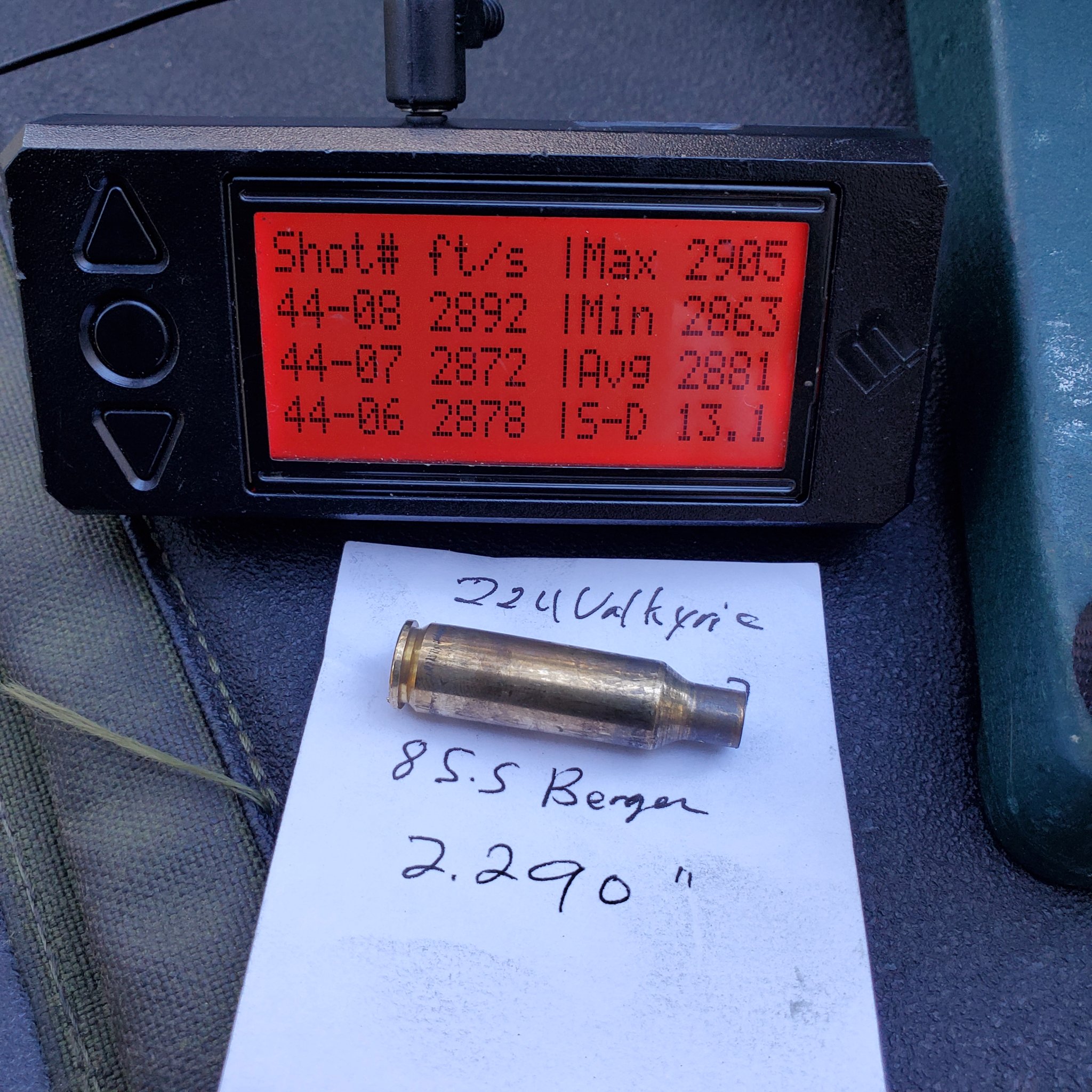

Berger 85.5gr Hybrid. .524 G1 $0.39 a piece. 2900fps in a 20" 22 ARCIs there really that much of an advantage 22 ARC over 6mm ARC?
