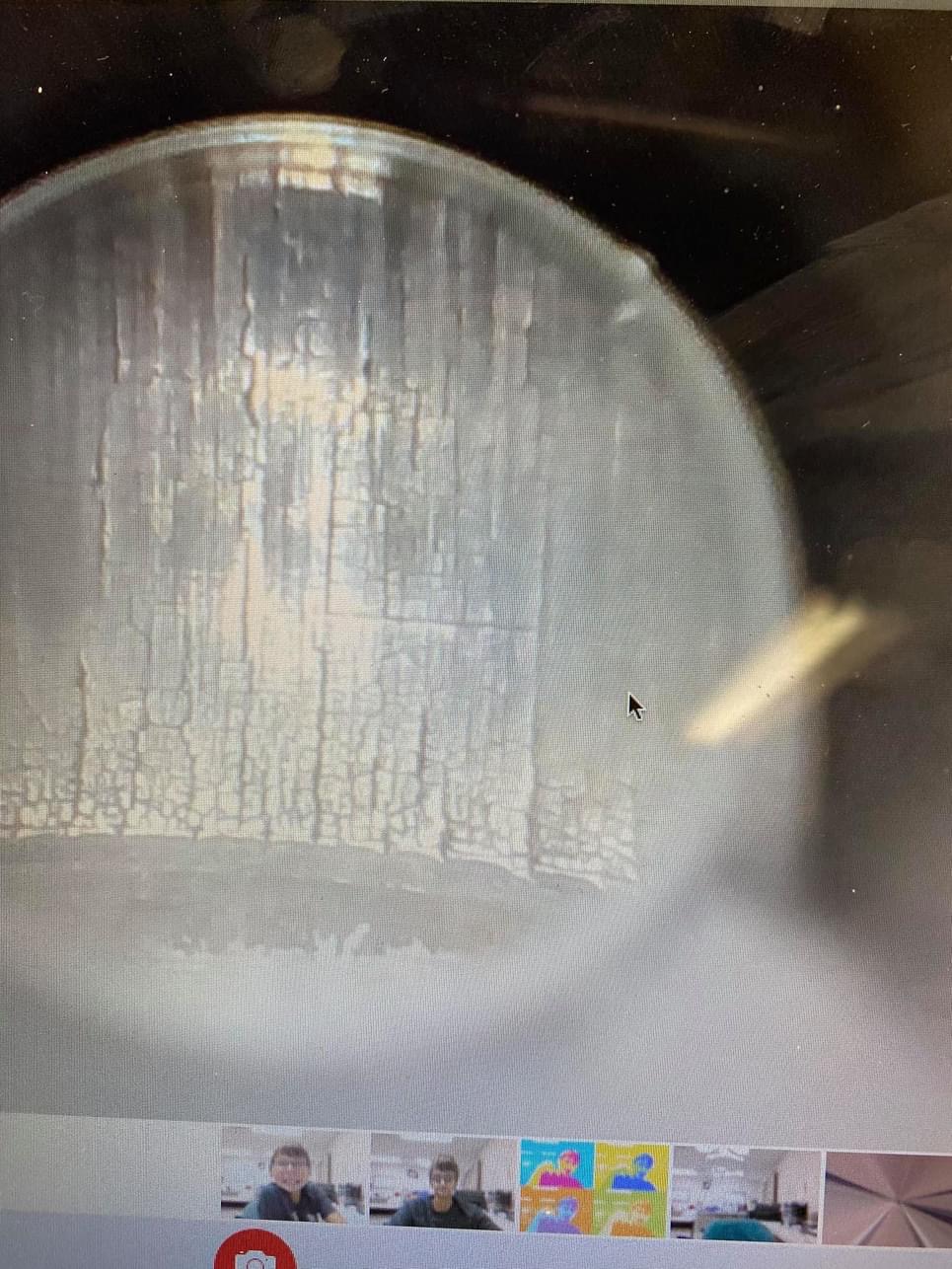

I shot the Berger 77gr OTM’s with 42.2 of H4350, average of 3390fps from a 22” 7 twist. It was on the edge, some swipe and minimal cratering but bolt lift wasn’t noticeable. So you like Retumbo over H4350 With this bullet? Its hard to turn away from a load that shoots excellent to chase improvement with a different powder, for me. CCI450 and Alpha ocd brass, for anyone wondering.
I was getting bad carbon ring with 4350. I switched to retumbo being the slower burning powder to help alleviate the problem. So far so good but only a couple hundred rounds down the tube.

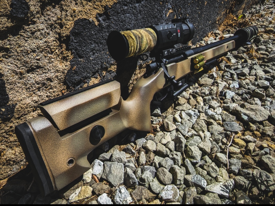

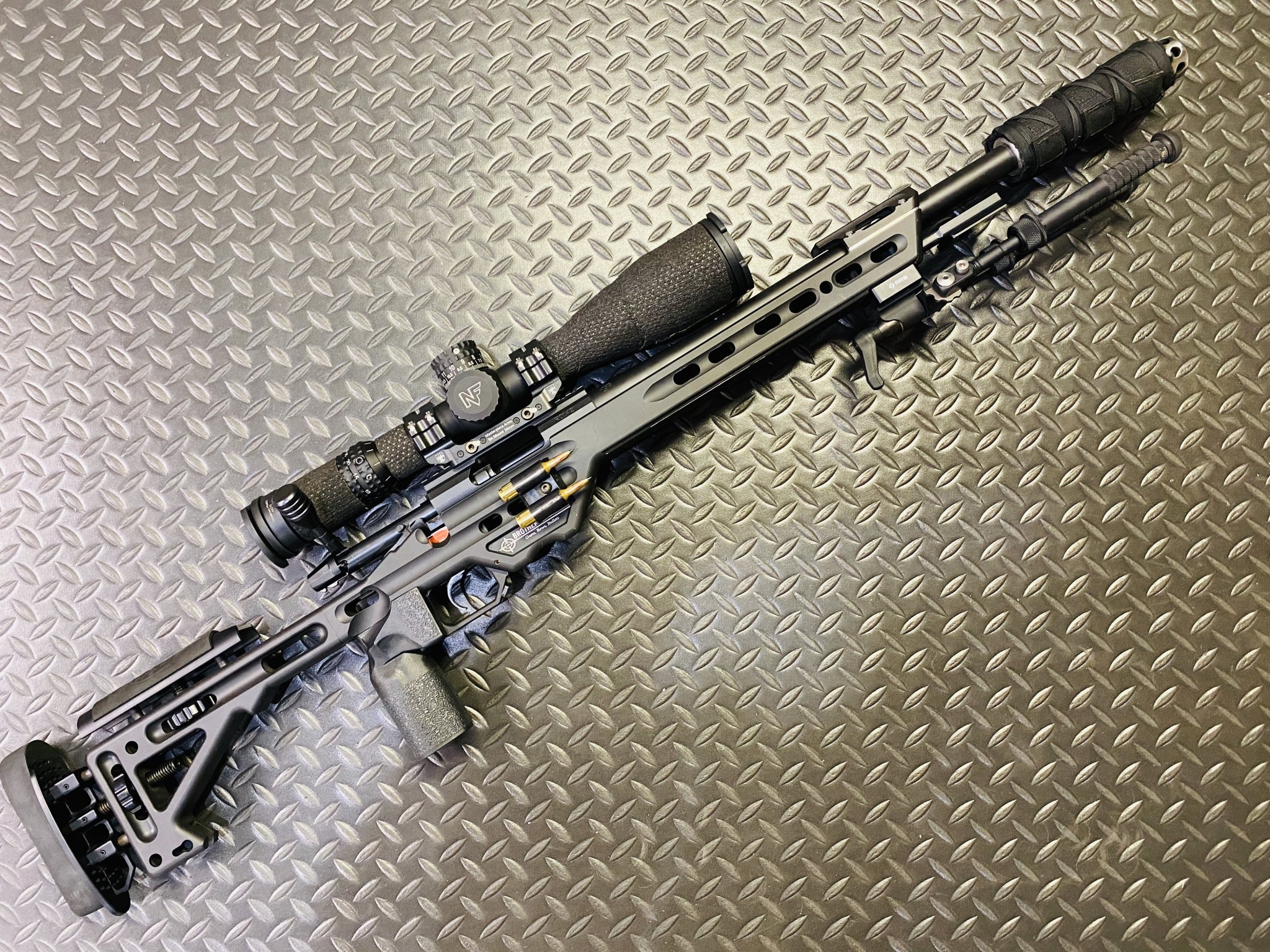

16” 22 creed
88’s @ 3040 fps
80.5 @ 3090 fps
75 eld’s @ 3110 fps
H4350 used. I’m not home to pull actual charge weights. I jump them all .050”
This barrel has roughly 900 rds down the tube and is still performing at acceptable levels (no bleed off and 3/4” moa with the occasional 1/2” moa.

Solid numbers from a 16"! Do you know how much freebore your chamber was cut with?

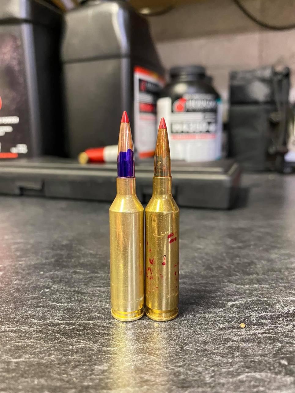

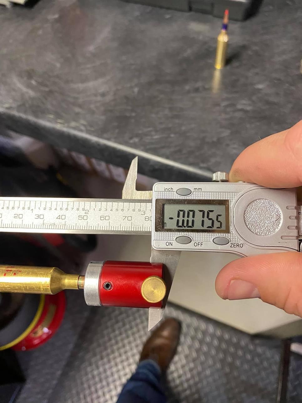

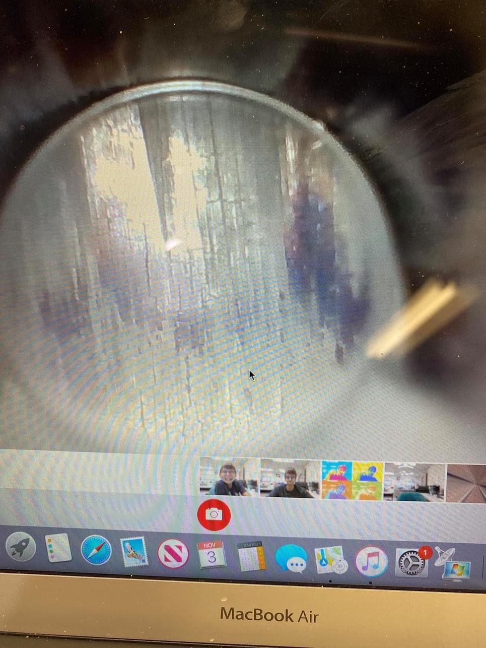

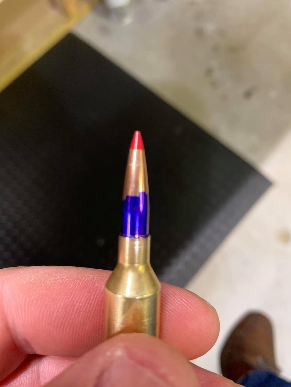

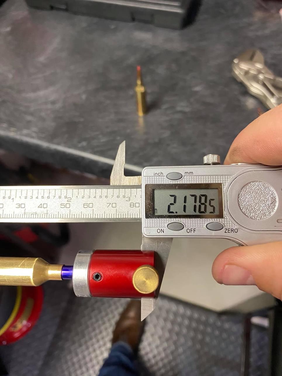

I took these measurements back when my barrel had 400 rds on it. Thought I’d share…
22 creed data
400 rds down the pipe.
Projectile with the blue is just touching. The projectile without sharpie is a dummy round .015” off the lands from the barrel when it was fresh. Roughly .060” throat erosion. Typically from what I’ve seen with less aggressive cartridges (non overbore chambers) and what I’ve read, .010” is typical every 100 or so rounds.
So essentially my findings bring me to .015” erosion ever 100 rounds. You gotta pay to play.

0.015 per hundred is quite aggressive, truthfully, the worst I've heard. A 28 Nosler running N570 is around 0.011/per hundred in findings with 2 barrels burnt. I didn't notice near as much as youre measuring on my first 22 creed barrel. I think I burnt maybe 0.025 in the first 400 rounds and just quit measuring as it still shot the 77s extremely well at what was 20k off at 400 round mark. I will have to pay closer attention to my new barrel.
I’m limited on resources (I.e measuring equipment that would provide an absolute). That said .004” difference (essentially the thickness of a piece of loose leaf paper) from your 28 Nosler seems logical….
One to many variables at play to say my results are typically. Cadence of shooting, barrel composition, etc. I believe for my intended use without neutering the cartridges capabilities, an 18” with a slightly slower powder would be the ticket (3125-3175 ft ps with a 75/85grain pill).

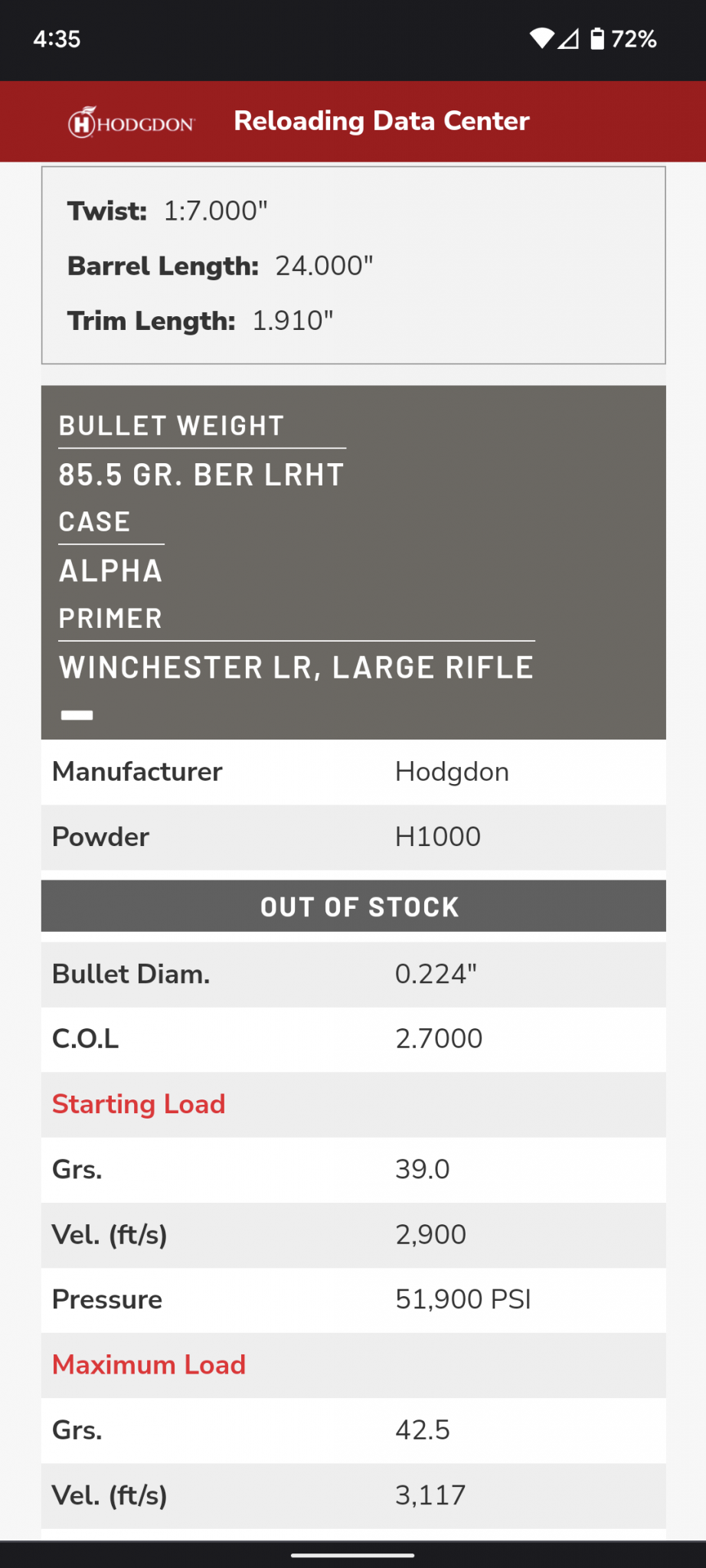

I have a 22 Creed coming. Here are my components. Curious where you all would start?
Alpha SRP brass.
CCI 450's
Berger 85.5's
The powders I have that I would like to use are H4350 or H1000. I have RL 26 also. But I use a lot of that for a few other cartridges and would rather not use it for the 22 Creed.
Any suggestions on starting points with H4350 or H1000?
