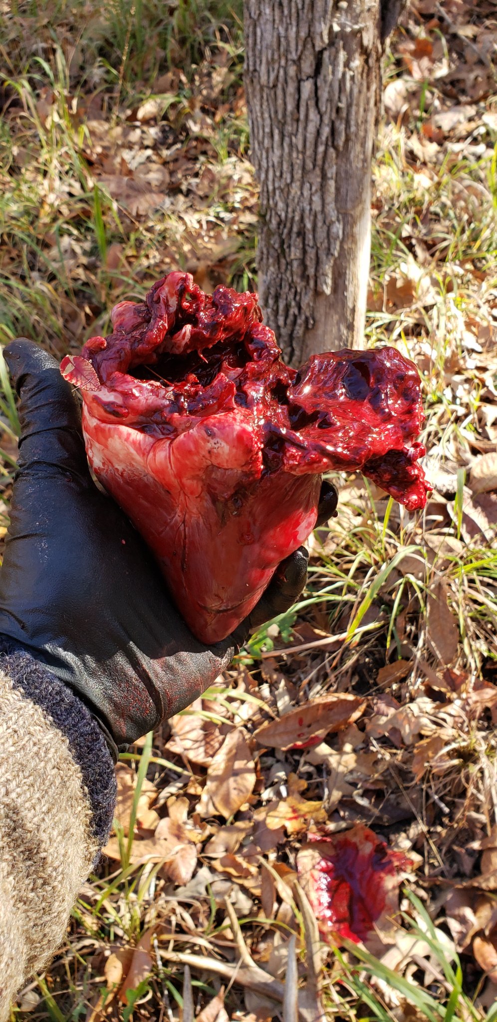

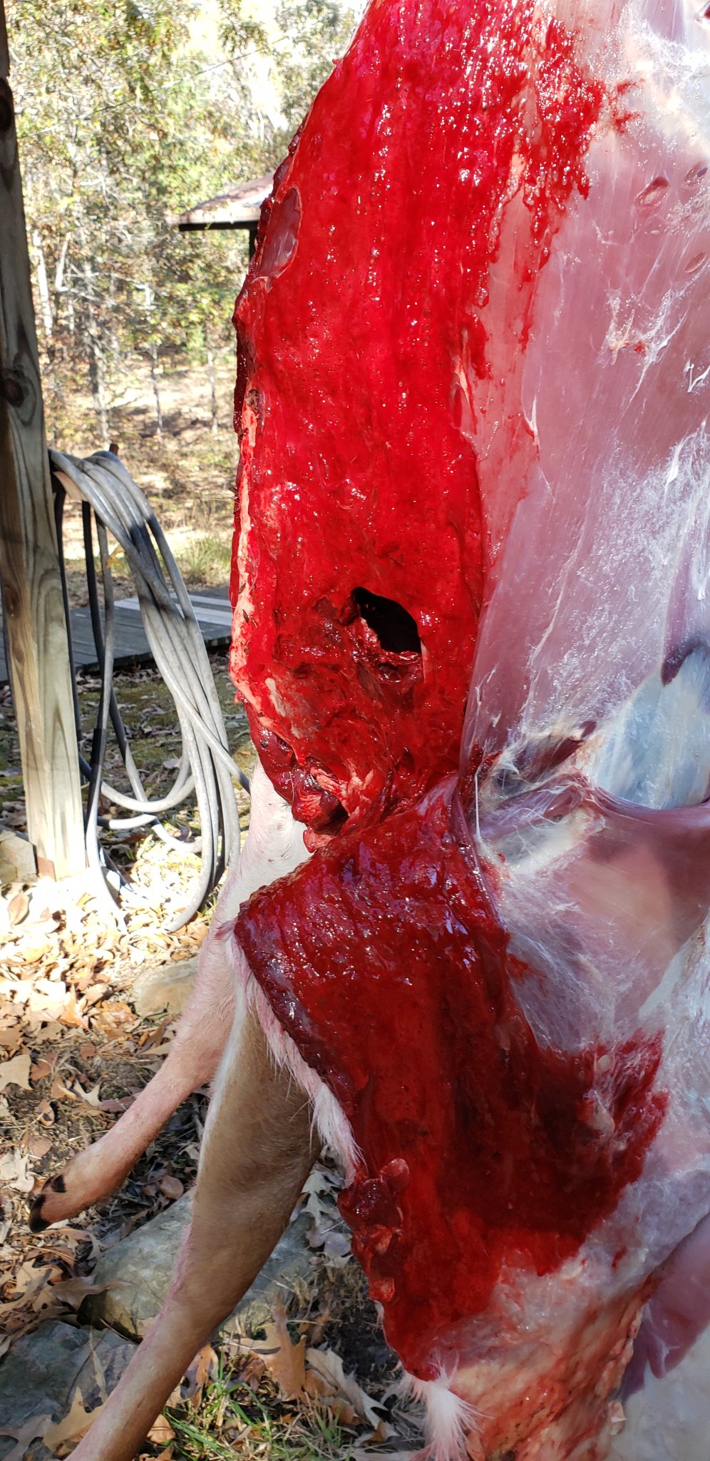

88gr ELD-Ms were “splashy” on my Montana bull elk. Impact velocity was >2900. Bullet entered shoulder and completely shattered/separated the scapula from the rest of the leg bones. Led to a noticeable amount of meat loss. Heart/lungs destroyed. No exit. He didn’t even make it 20y after being shot.
Running 75eldm from an 18" 22cm. Loads sub moa at 400y with minimal load development. Running 3100fps. Shot two mulies yesterday . First was large body buck at 275y(2600fps impact), in the shoulder crease, did a 50y death sprint and piled up, massive lung trauma, deer bleed out profusely from the mouth before I got to him, no blood as I cut neck, it was all in the boiler room and on ground. Nickel entrance through a rib, exit was quarter size throug a rib. Next was another medium body buck, 475y(2250fps impact), strong crosswind, but my nephew who's never killed a deer, put the bullet at the neck shoulder junction, pencil entrance, quarter exit. That deer was lights out. I was impressed. I have quite a lot of the 77s as well, and may try some. This load is no pressure, and is only 40gr H4350 I feel another 150fps is on the table. I only have 65 rounds down the pipe so will likely gain more speed, however initial 20 rounds were 3050, now its at 3100.

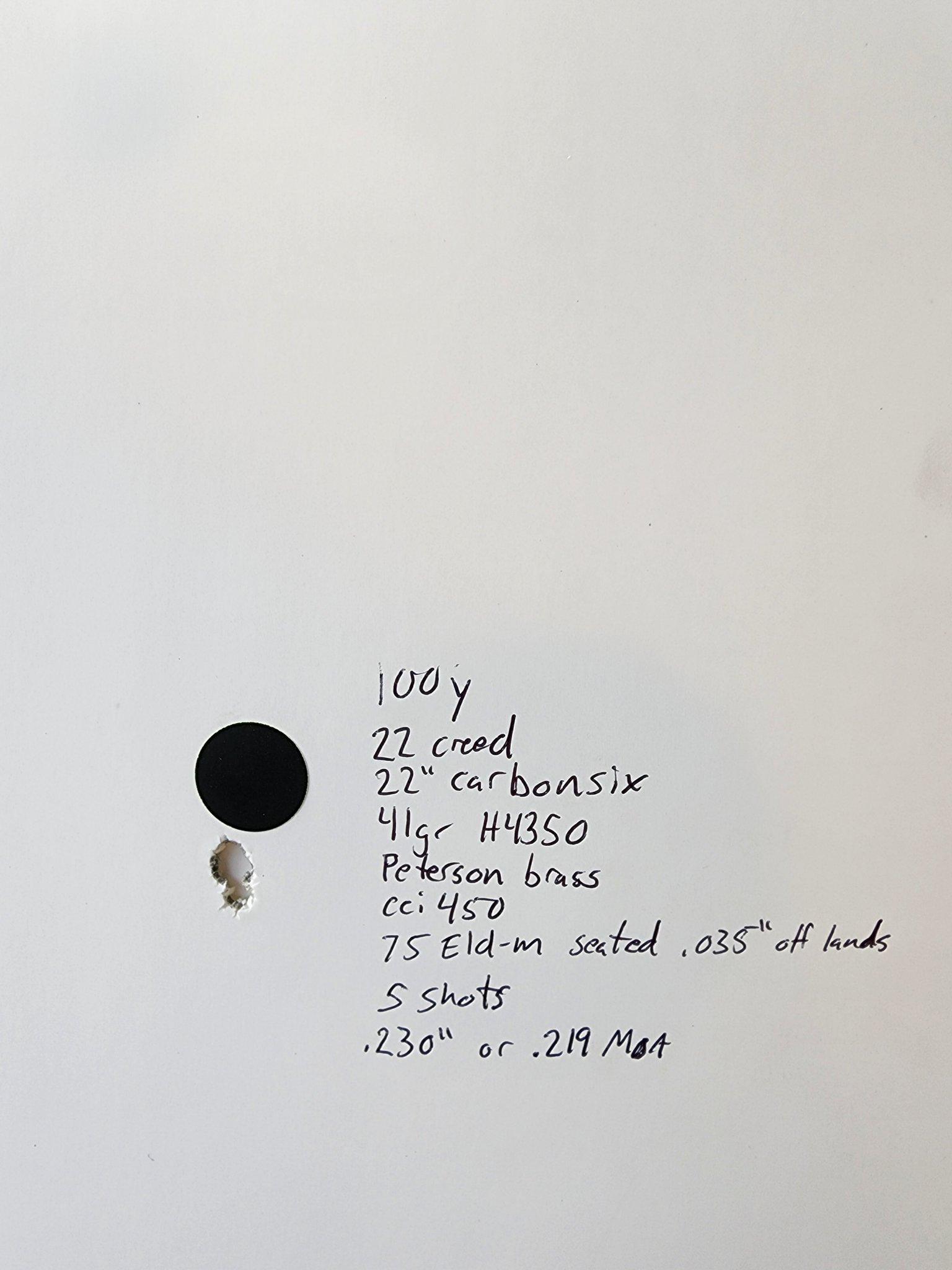

Needing some assistance with selecting a bullet and powder. I have a 22" carbonsix 7.7 twist I bought for coyote hunting. I have 53vmax, 60vmax, 69smk, 75eldm, 77smk, and 85.5 bergers. I'd really like to stick with something that will run fast and flat if they won't blow up. Powders I have varget, 4350, and h1000. So far it's looking like 75eldm and h1000 would work pretty good from what I'm reading. I'd definitely like a full case with good speeds.
Ive ran 77tmk above 3600 with rl26 in a 7.9tw, no blowups.
The 69smk with 39.0gn of Varget from your 22" bll should net you around 3525fps and it does bad things to critters. Its special brother, the 69gn Tipped Matchking is nastier, and an excellent choice for coyotes. The poly tip TMK tends to upset more violently than the SMK. The rib cage pic was after it had come through the near side shoulder as it entered the thoracic cavity. Jacket and core were found under the hide on the off side. This was appx a 110# Oklahoma whitetail that my son shot. Deer went about 30feet, most of which was sideways after he stood back up...his compass didn't really work right after the impact. Lol.

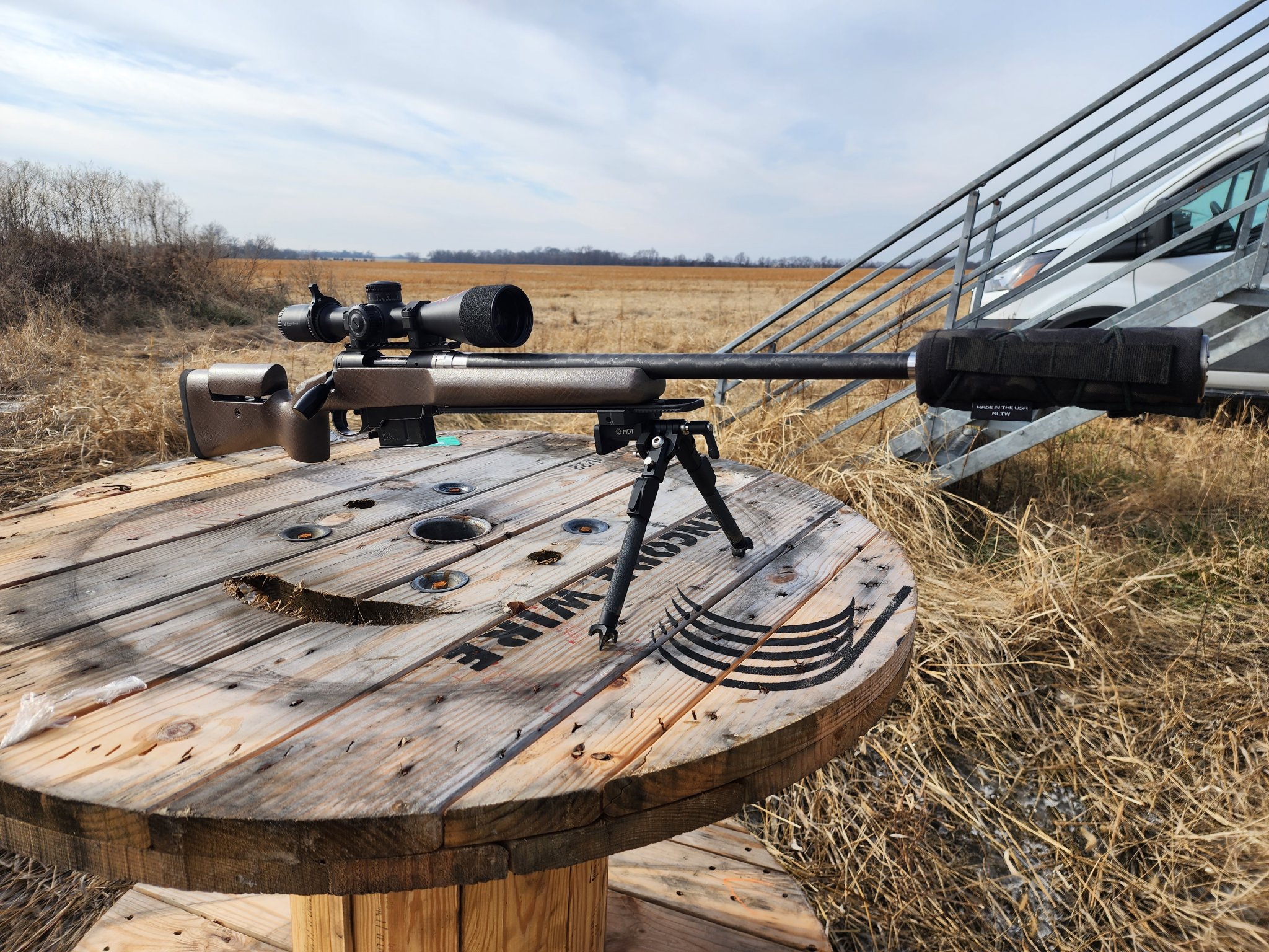

Got the first 20rd down the barrel with a starting load. Theyre running 3320fps in a 22" barrel with suppressor
Saw your post on fb. Lol. Wonder what the velocity jump to rl26 would be? It's a longer barrel then I ordered, but I am a short barrel snob, ill sacrifice velocity, although with rl26 I might not be.
Looks good, and plenty of room to move up. My 22" runs 3393fps with 42.2gn of h4350 pushing the Berger 80.5's in lapua sRP brass. I could easily lean on it some more to get over 3400fps, but this load is easy on brass and does everything I need it to, and a few more fps wouldn't gain anything worth the cost.

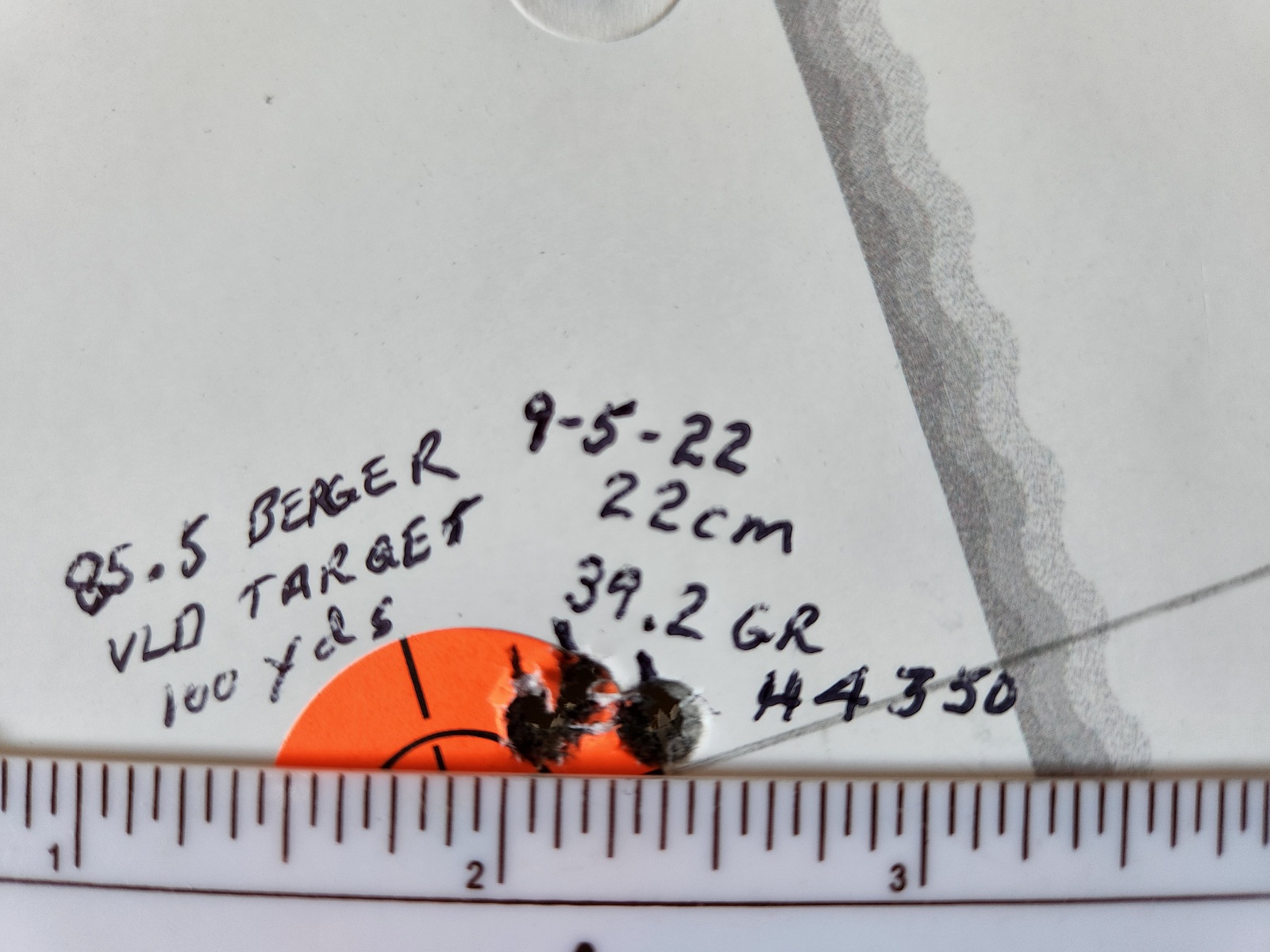

I picked up a used 6.5CM Bergara B14 Ridge and had my gunsmith rebarrel to 22CM. Staying with the stats originally requested on this post::
Berger / 85.5 gr / Long Range Hybrid Target
H4350
39.2gr
CCI 450 magnum SRP
3137 avg Velocity (3142, 3136, 3134): SD=4, ES=8
Benchmark SS #5 / 1:8 / 22" / fluted / threaded / coated
69 rounds from 9/4/22 - 1/1/23
6mm Lapua brass necked down to .263, then .253 with Redding bushing dies
Advanced Armament CO 762-sdn-6 suppressor
VLD is wrong in the picture
Devastating on Coyotes

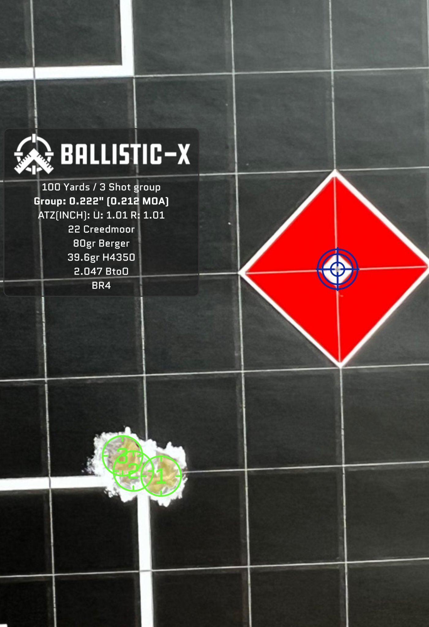

Brand new Wilson 1:8 twist 22"
39 grains of Varget and 69 TMK's did 3,530 FPS with Alpha SRP brass. No pressure signs yet but sometimes those show up more after a few loading cycles on the brass. Going to try this on a coyote or 2.
40.0 grains of H4350 gave me 3,250 fps with an 80 ELD-M. I didn't load any higher charges but I imagine I could push this to 42.0 grains and ~3,400 FPS.
