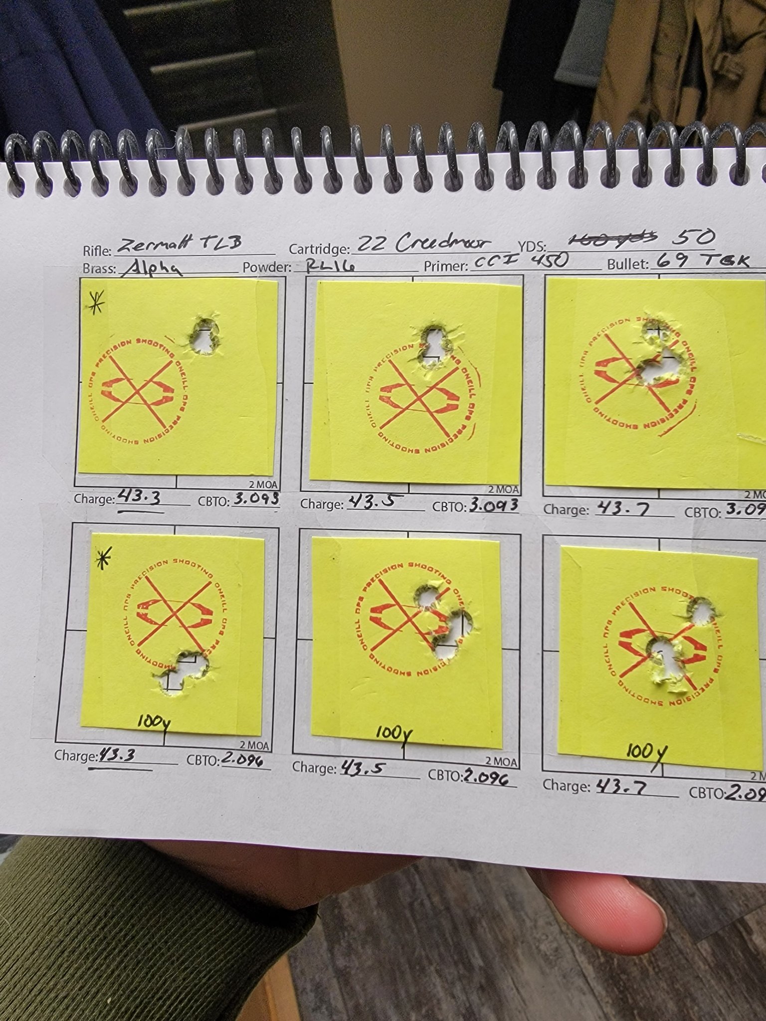

Well I'm just a pinch over broken in and I settled on a load...just in time to pull the barrel, drop the stock, yank the glass and rebuild it for shooting match season.
Disregard the CBTO on the top row, it should be 2.093"
50 you on the top, confirmed on the bottom a few days later at 100.

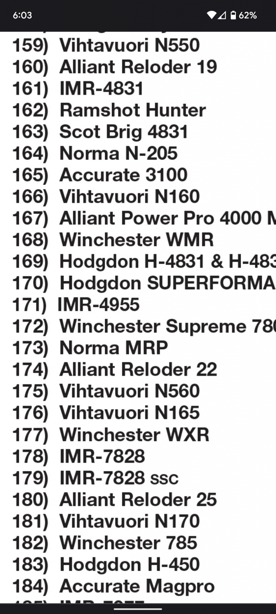

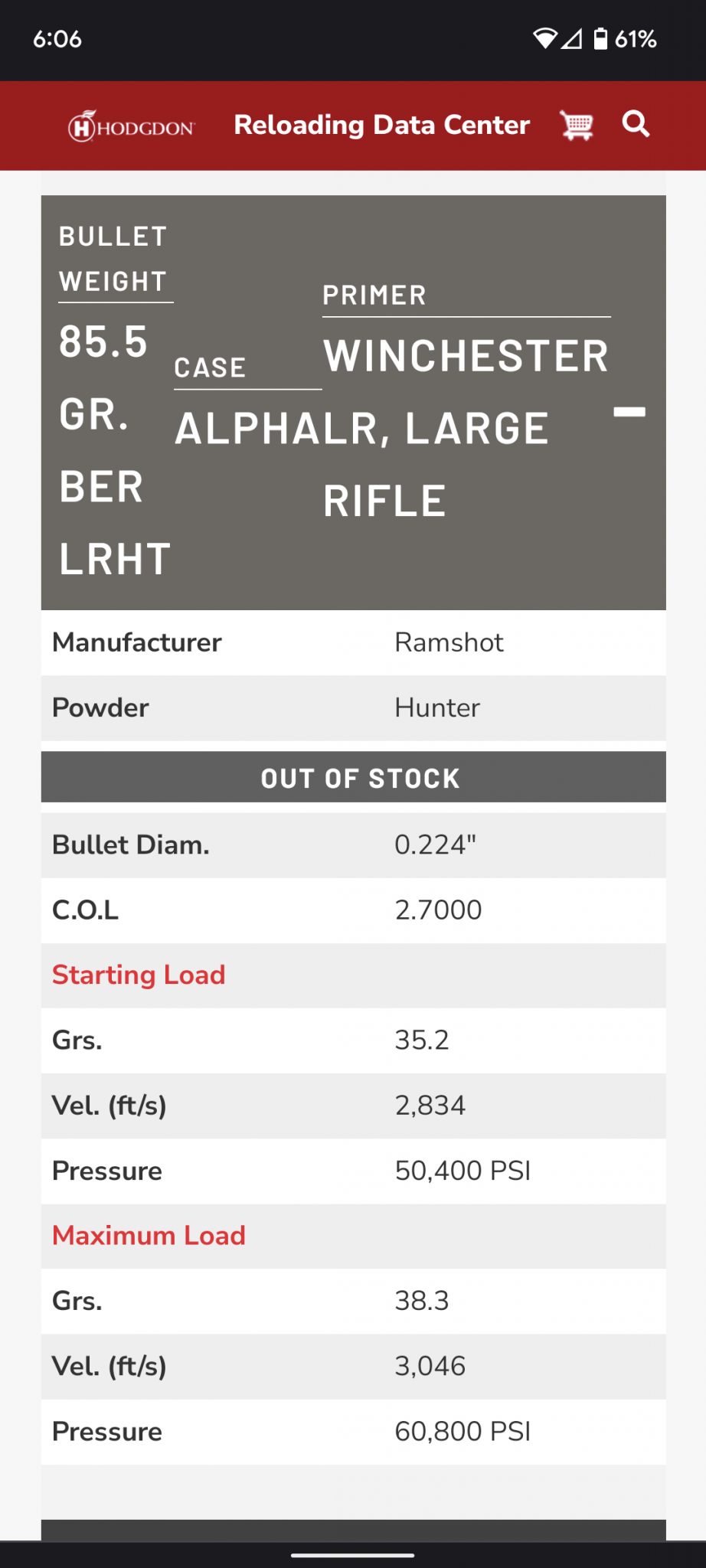

I don't even shoot this cartridge but it has my attention. Extrapolating some data points . . .
N555 is right between n550 and n160.
See burn rate chart. That puts it right around hunter.
Hodgdon says a max load of hunter at 60.8k is 38.3 with the 85.5 Berger.
A max load of super, which is a couple rungs slower is 39.3.
I'd say you're at pressure and might consider a different powder.

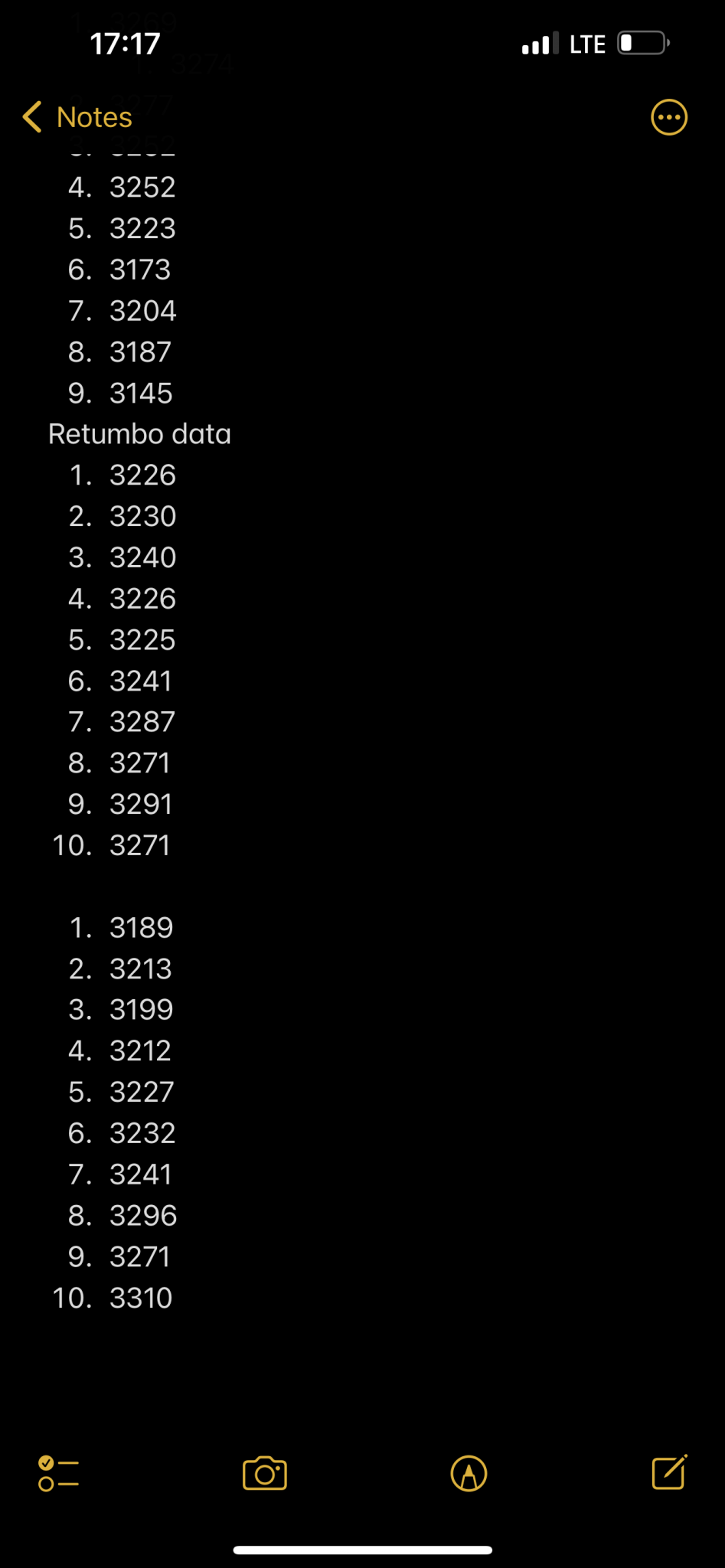

Has anyone tried h1000 or retumbo with an 80gr Berger or hornady bullet with a 1:8 twist?
I tried it with 77tmk, full case with a drop tube, believe around 46.5-47gr was only getting 3320 from a 22" barrel. It'd work better with heavier bullets I feel. H4350 pressured out arpund the same velocity, rl16 was near 3400. N555 shoots very well at 3400 and 3500. 3500 is too warm to run on hot days, but anything below 75 its good to go. Rl26 will flat out scream near 3600, rl23 does well around 3400 as well.

10 shots
Says my photos are too large to upload, but the groups are really nice. Will be switching to Superformance I need my RL26 for a 7SAUM upcoming. It's in a Petersen load data sheet for 80.5's so I'll try it out. 88's fly nice, no problems with jackets or anything else. Very accurate. One of the most accurate rifles I have, satisfying to shoot and low recoil. I don't even run a brake it's threaded and capped on the muzzle.
