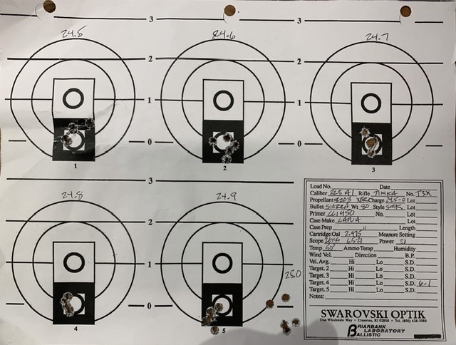

I have a Tikka 223 Varmint that I rebarreled with a shouldered PVA prefit in 223AI. Sierra 80SMK, Lapua brass, 24.8gr 8208XBR, CCI450, 2.475”, 2883fps SD6.1. Wide node from 24.7-24.9gr powder, which allows me to load on the Dillon fairly easily. This is key for me, as I need a practice Gun+Load that I do not have to spend time on.
