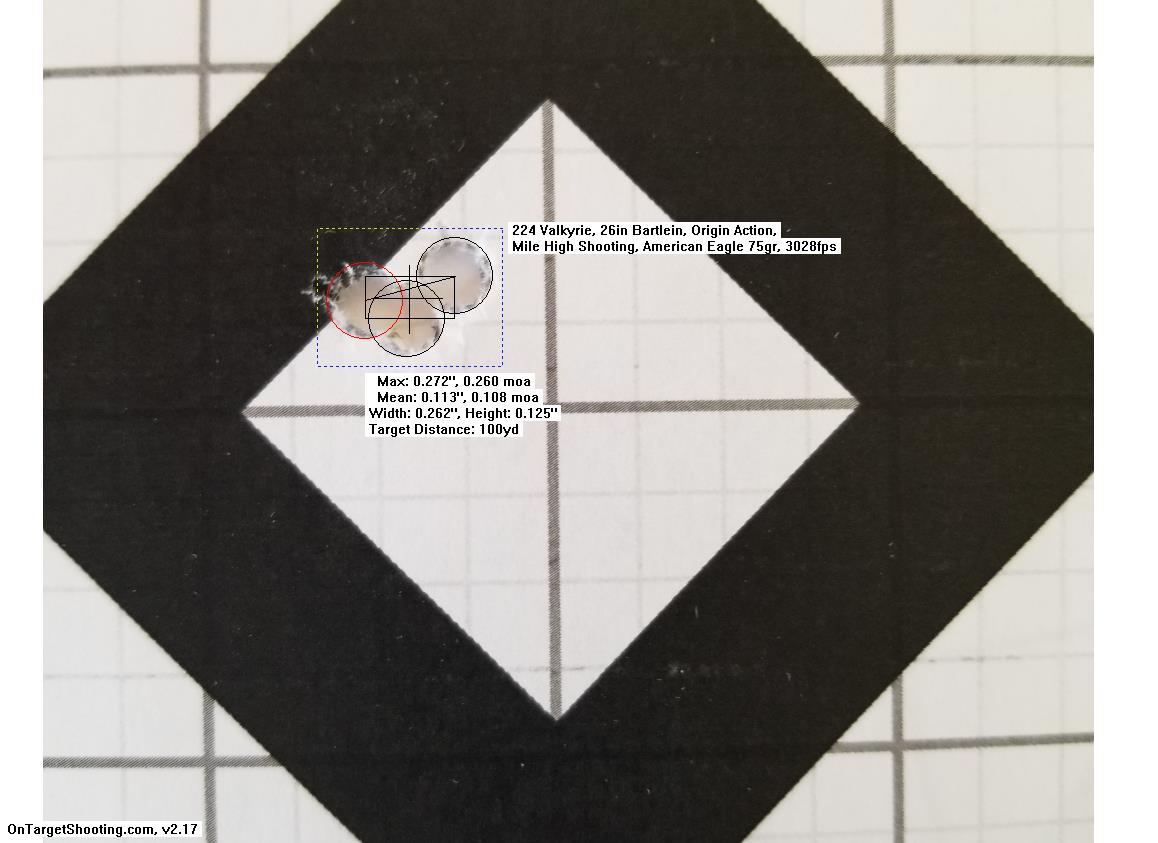

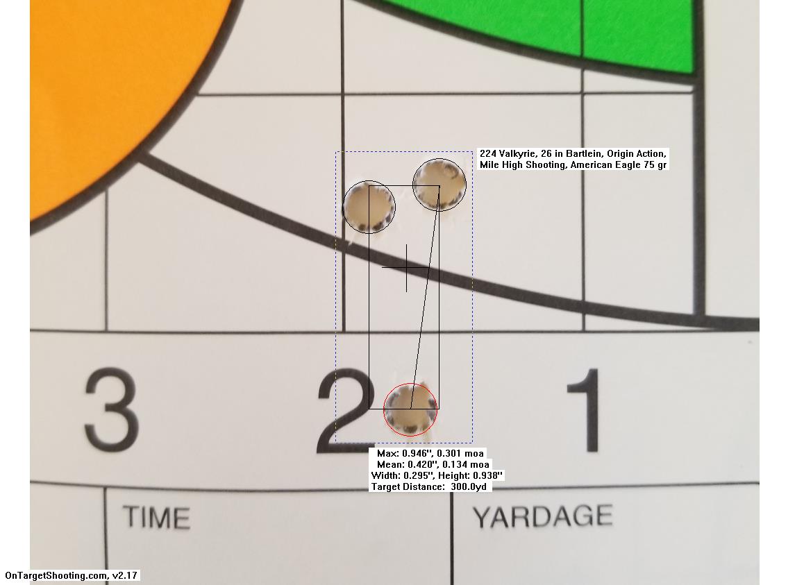

Bighorn Origin, Bartlein LH GT, Timney CE trigger, JAE 700 chassis, MDT mags with 6BR conversion kit, and APA LB brake. Ironically, I ordered a Revic PMR 4-27 scope yesterday morning before being notified of shipment of the rifle, so it should arrive about the same time (if not the same day) as the rifle.
