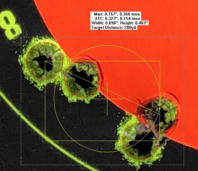

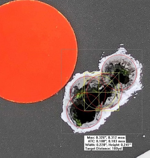

Did a little load confirmation today with the 88 ELD-M / 26.1gr CFE223 load today using the data from my seating depth test.
I loaded up 20rd each of both the 1.816" and 1.833" rounds to test since they both shot pretty darn good during the seating depth test. I selected the 1.833" base to ogive as my optimal seating depth but wanted to test the 1.816" for the hell of it. Of course, the 1.833" rounds shot the best.
I shot a 5 shot group of each at 100yd then shot 2 steel swingers at 635yd. A 6" and a 3". They both did well on the 6" but the 1.833" rounds didnt miss a beat on the 3" and it was a gusty ass day out there today. I was very impressed. About a 30F degree difference today than when I developed these loads and no issues with the load...
