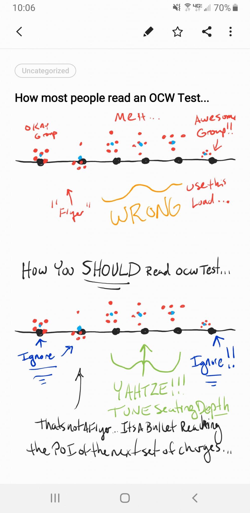

I do similar "ladder tests" ....but 5 shots each load, and use a Magnetospeed Riflekuhl to more quckly reduce barrel temp. I find I can often shoot a good 3-shot group with a decent load. But only a great load can be shot 5 times and get a good group.
Once I find my node, I come back a differnet day to try to repeat it. That might be problematic, if atmospherics are significantly different, but then again.... I can't really wait till everything is perfect to shoot.

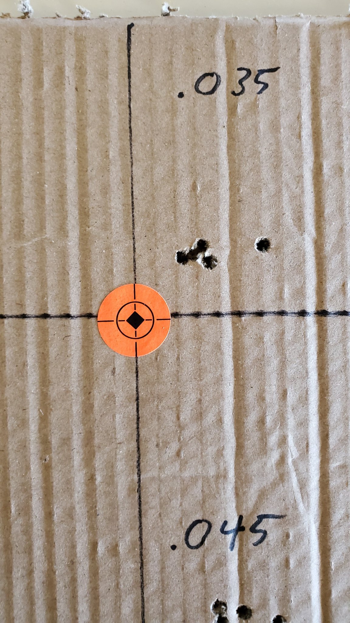

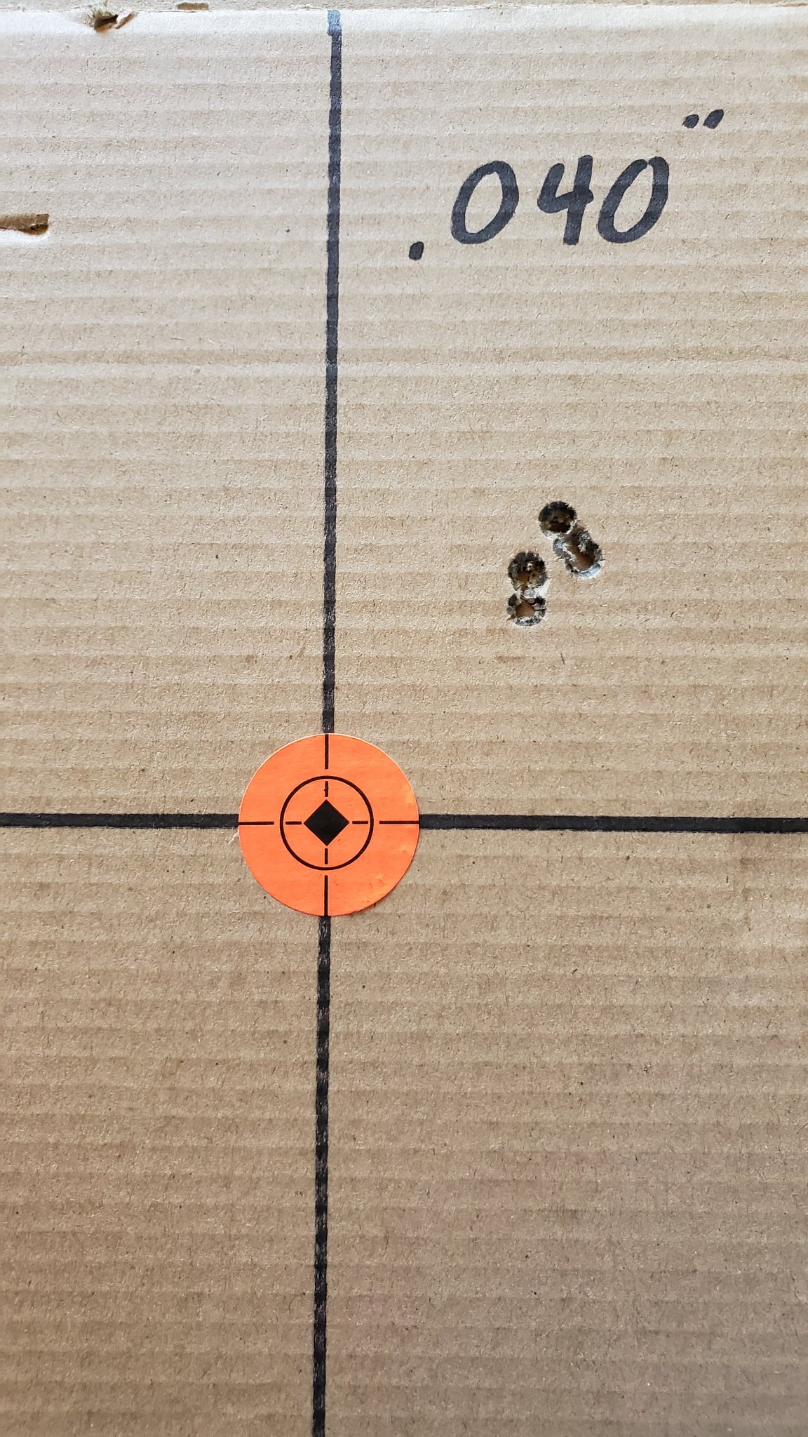

Thought I'd throw out some of the info I've gathered.
Same Smith, blank mfg and reamer.

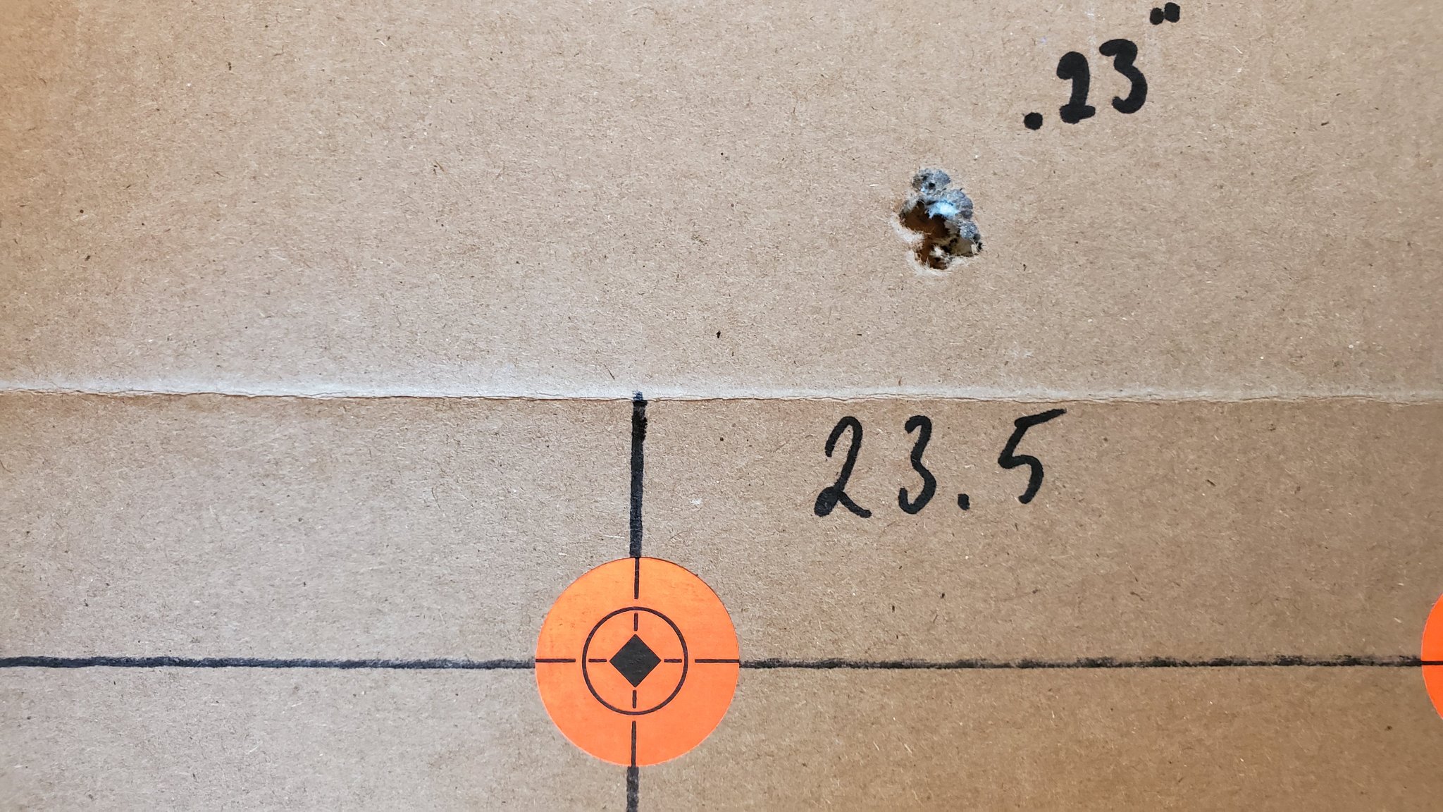

I got the 80gr ELDm up to 2940 and on a decent node with h4895
I ran a seating depth test and lost about 50fps but the group still was under 1/2". I'll probably run powder back up to the 2950 area and see what happens.
Next my load with the 80.5gr Berger fullbore was showing promise with the starting load @ 23.5gr (only 2727fps)
I found the same velocity (2950 fps)had a decent node so anticipating the velocity drop with the seating depth test I bumped the charge up. This time the velocity dropped 120 fps so I will have to run that charge up too but still a promising group with decent SD/ES numbers.
Pulled one pretty bad.
Definatly a 1/2" gun on any given day and with the right load this thing hammers.
